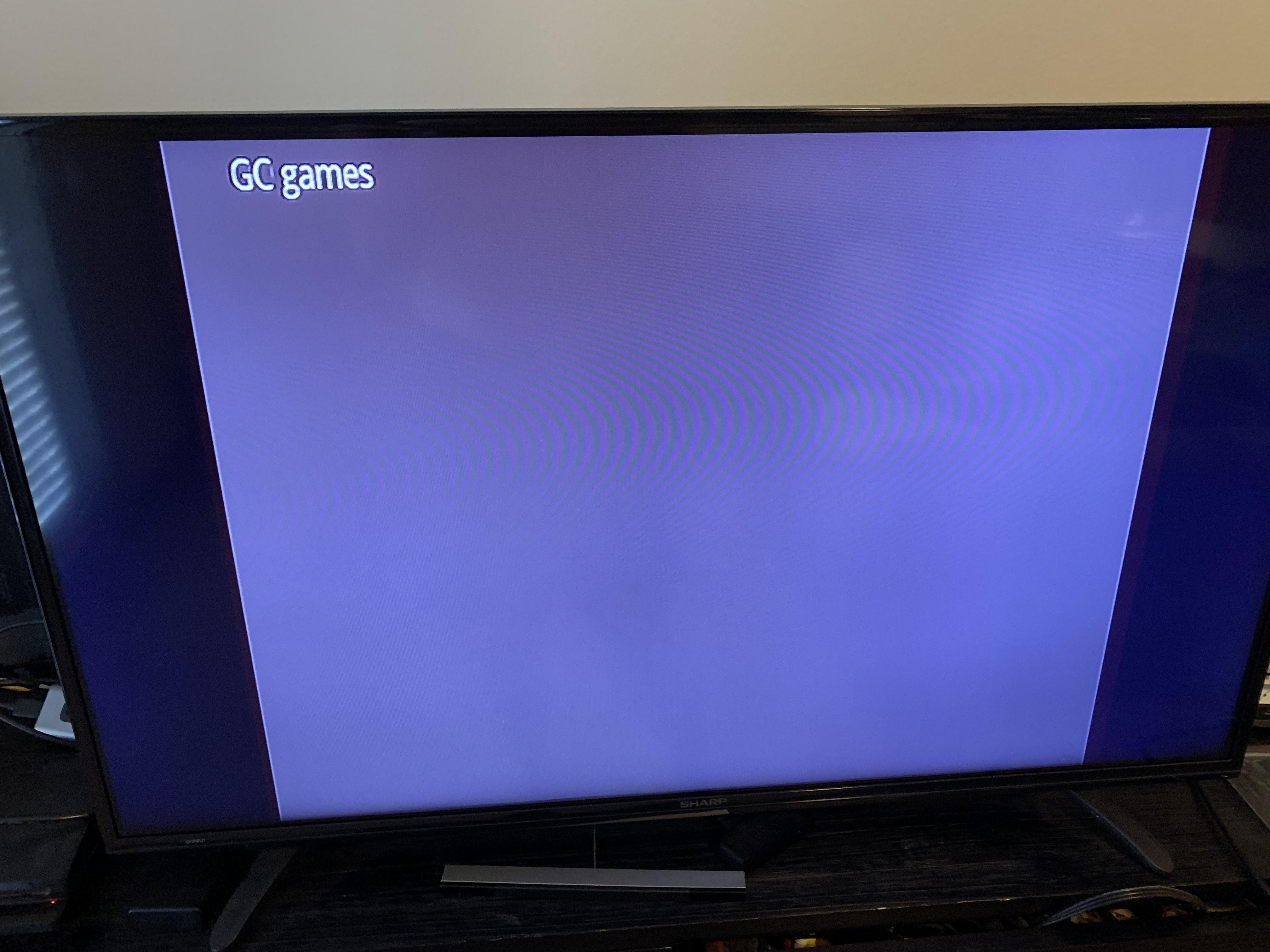

So good news! I dug the wifi and bluetooth chips out of the bin and got the wii to boot as well as got BBLoader installed. BBLoader didnt do much with a wiimote or even with a gamecube controller plugged into the GC ports on the wii. (Wii untrimmed at this time) With the screen shot below, am I good to go, ready to trim? BBLoader installed pretty easy.
Thanks again
Noah

If you selected to patch out Wi-Fi when installing BBloader then you're good to go.
You don't see anything much because you don't have any games on your flash drive. You could also move around BBLoader with the GameCube C-Stick.
I tried moving with the GC c stick but nothing happened, I figured it just needed to be soldered up in the G boy to work?
