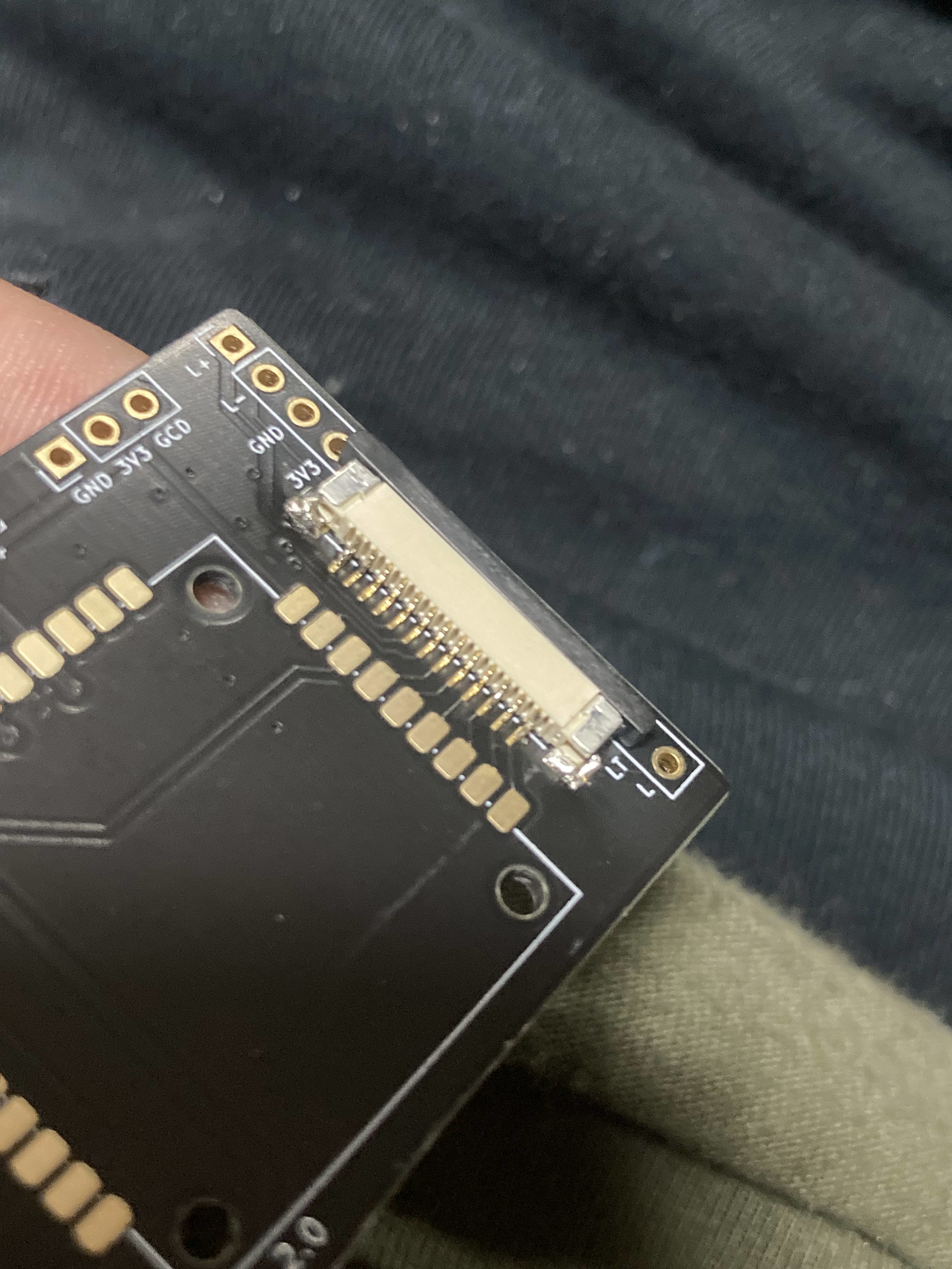

Hey thanks for the response but I am not including bluetooth. I am using this button for menu controls, and it does not seem to be working. From what I can gather normally buttons when pressed short to ground? I am testing mine and that is not happening.
Yeah you need to sever the 3.3v trace to the button, then connect a ground wire to that leg to make it work like a normal button
