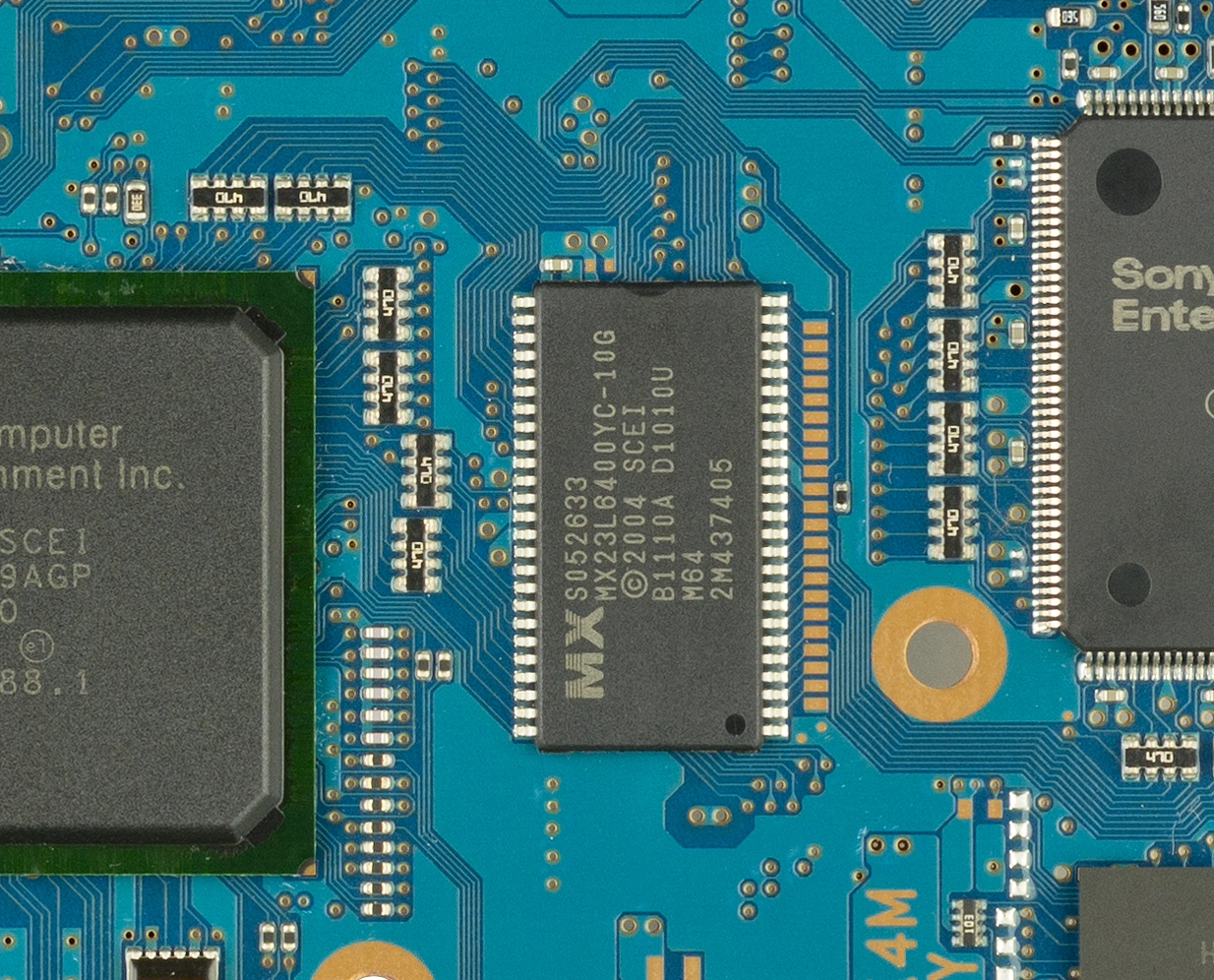

Flash Tool would be software tools for building new ROM images. A new application for this is currently under development. However, to have this on the console, the original BIOS chip must be replaced with a new chip with a custom ROM. Examples of chips that work are: MX29LV320, MX29LV640. These are the ones I use, but I believe others can also be used. You have to check the datasheet.
The original PS2 ROM chip cannot be re-flashed.

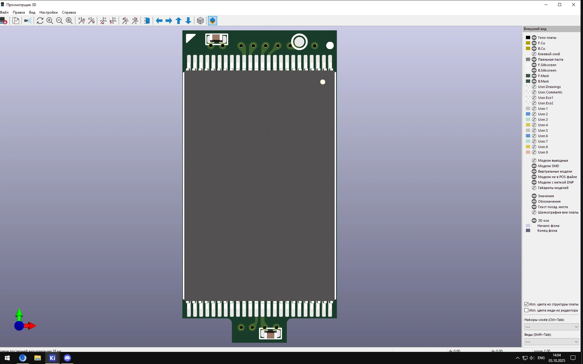

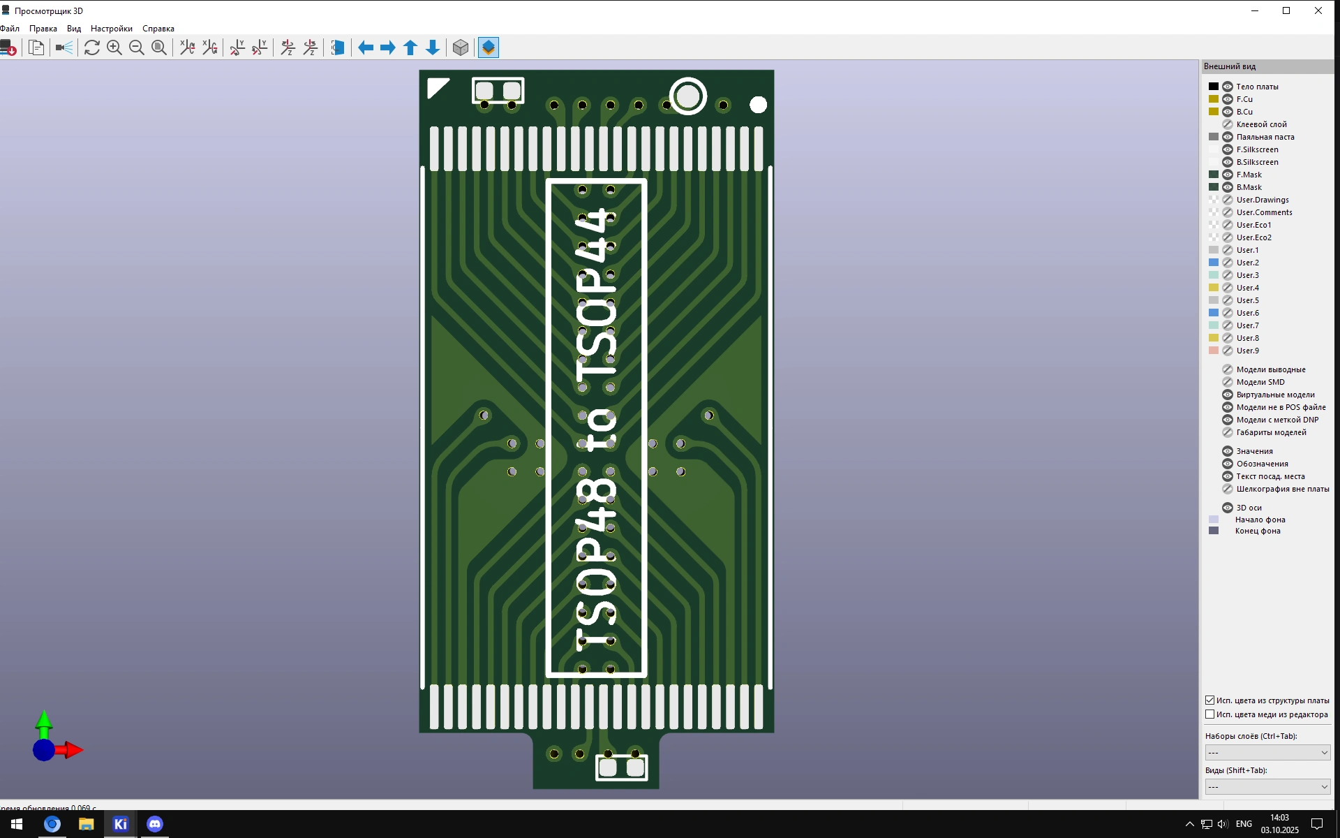

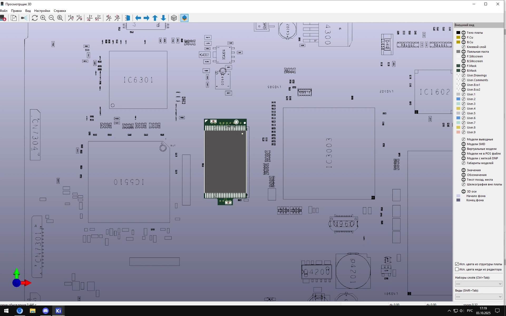

DO NOT USE THAT DESIGN!
IT WORKS on 70k - yes, but that one is complex and do need another extra PCB to work.

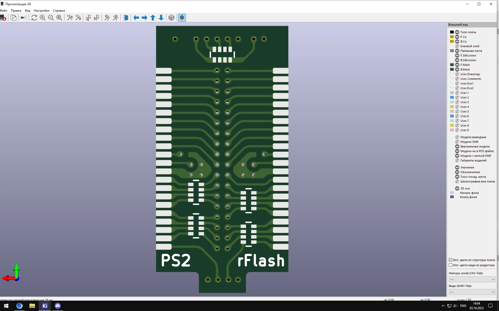

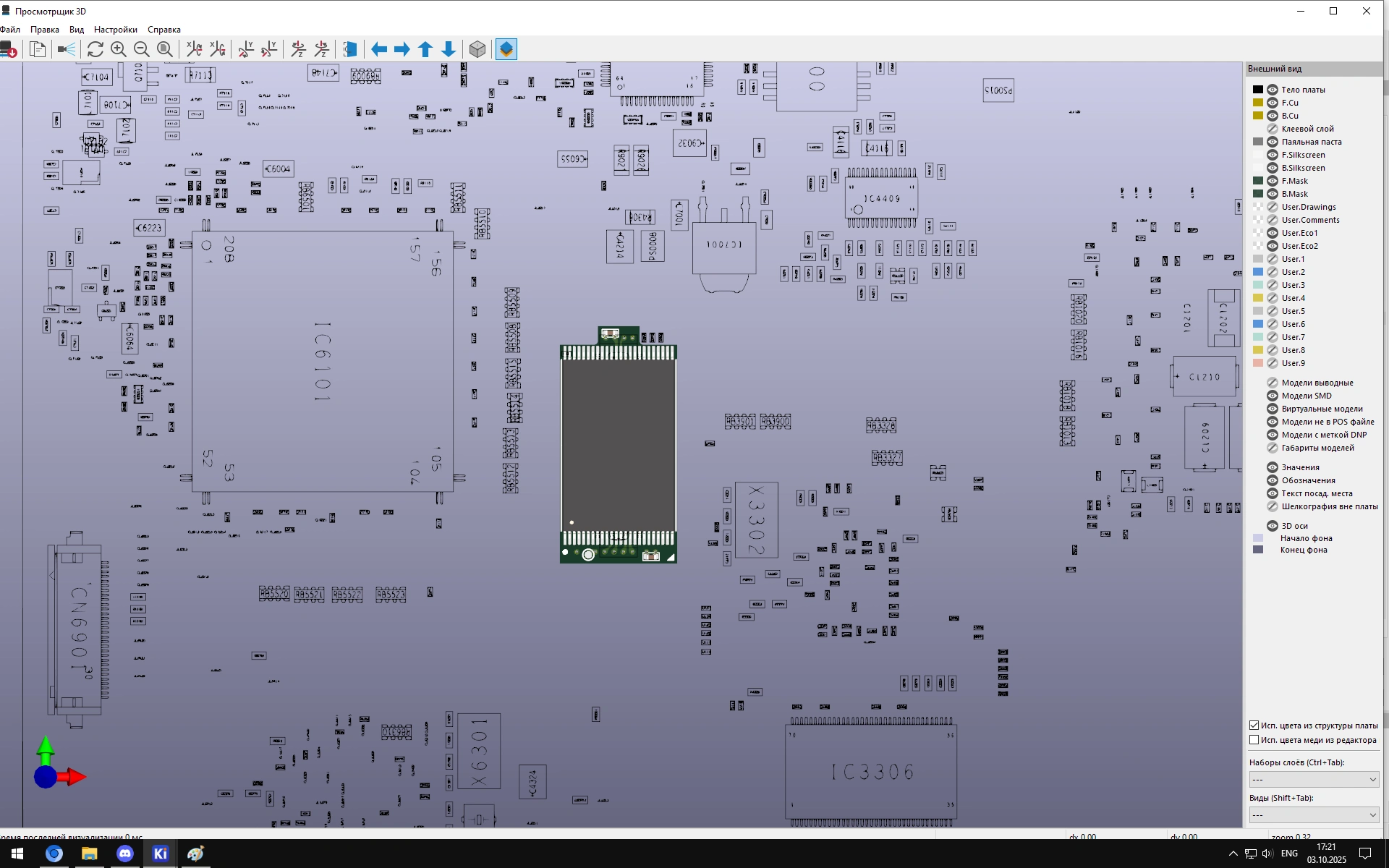

Designed to be installed on unpopulated TSOP-2-44 footprints (separate BOOT and DVD flashes). Mostly for GH-032/035, maybe 037. I hope that by using a 1.90 NTSC-U bios I would restore FHDB for 70k (confirmed) and get pros for MechaPWN'ed PAL consoles (not confirmed).
To install you need to remove TSOP-2-50 combined BOOTROM, tin the TSOP-2-44 pads both on PS2 and adapter side, align and solder as any BGA component by hot air station. It's better to use a small piece of capton tape to cover pads at PS2 side in the middle of TSOP-2-44.
PCB stack-up:4 layer, choose 0.6-0.8mm thickness at JLCPCB. Spacing between PS2 MOBO and top RF shield is 2.0mm, so we have 0.2+0.8+1.0mm limit (resistor arrays/PCB/flash). Better to choose 0.6mm (to do that select LeadFreeHASL or ENIG option)
To enable write operations connect circle pad to SWR signal (could be found at 70k SM)
MX29LV320/640 were kept in mind during making.

Wording is confusing. So you install it on unpopulated area where a ROM goes...but you have to remove and reinstall?
I assume you just mean desolder the BOOTROM and solder this on once MX29LV320/640 TSOP is flashed? Because on 70k that spot is already populated with the sony BOOTROM
I am curious...besides package, what is the difference between this and Tschicki's bootrom flex? This doesnt have AND gates I see...
I wouldnt mind ordereing some, already have 5 of Tschicki's flex to try. Looking also to add other drivers like mmce, hdd, etc for my crystal chip modchip fun. IE I already have the crystal chip booting BootManager (its interface/scripting interpreter) from hdd, mmce and usb but those drivers need to be on memcard, so having in rom would be nice.

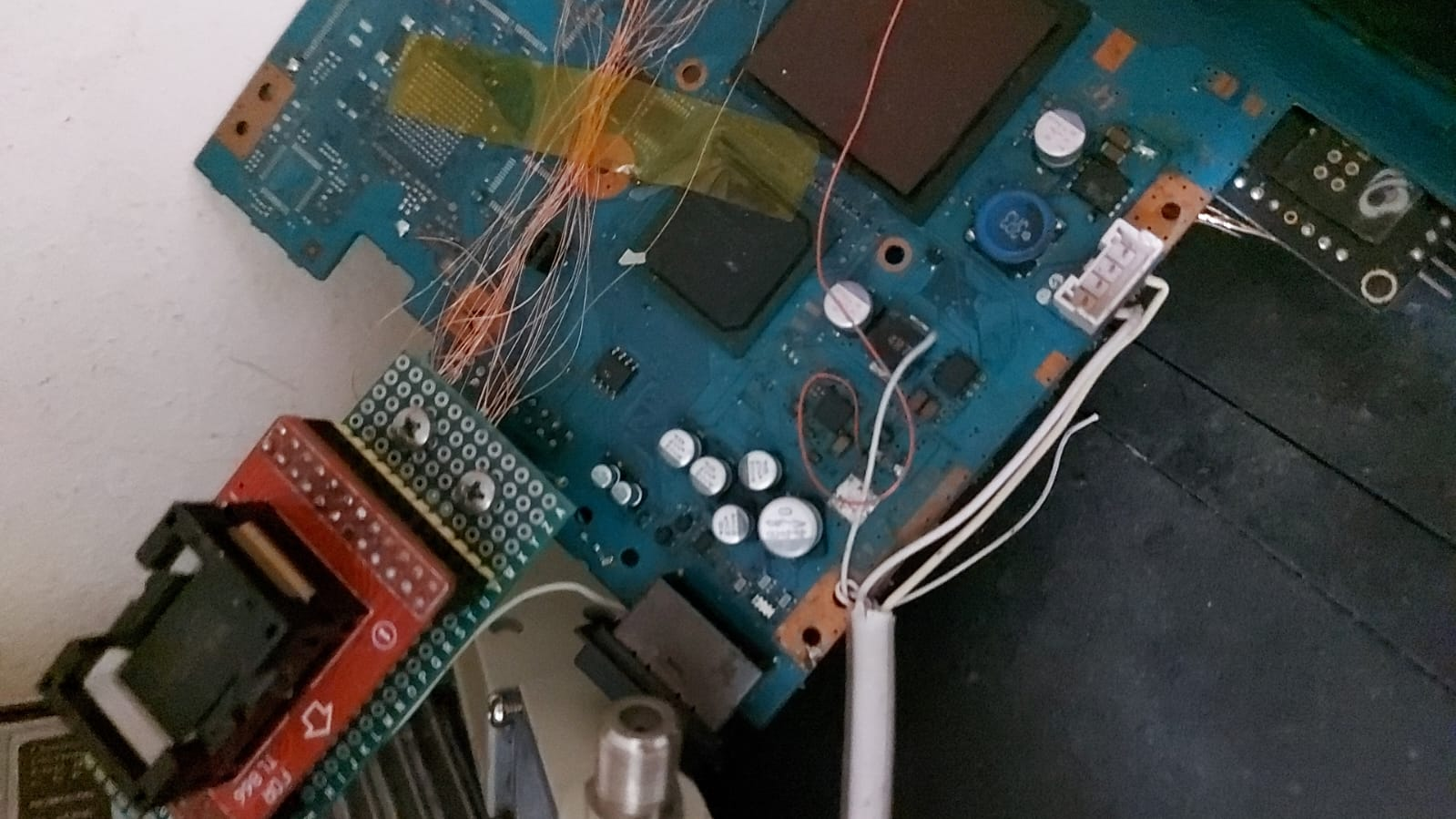

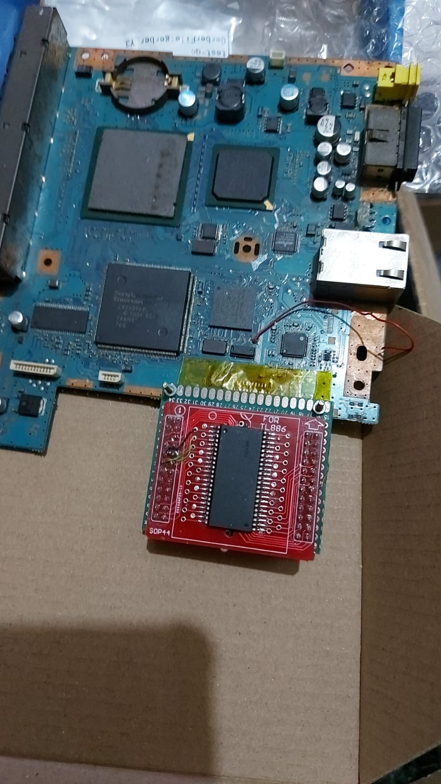

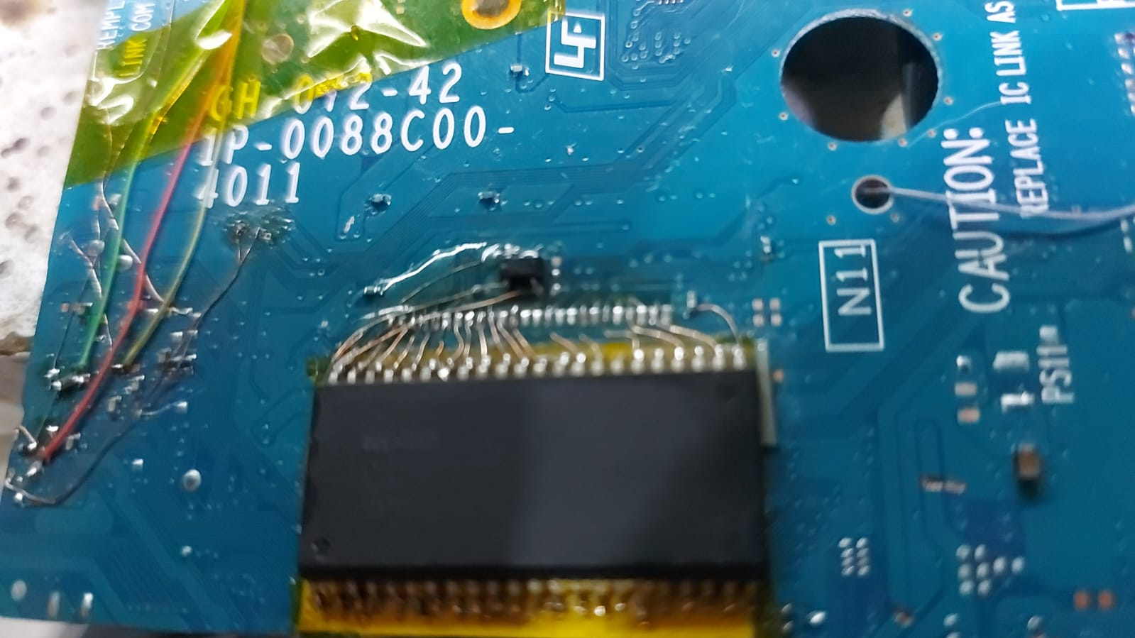

GH-032/035: TSOP-2-50 (combined BOOTROM) is installed and to the right of it you might see a half of TSOP-2-44 footprint. There is exactly the same at the bottom as well. My goal is to use 2 separate flashes, the Tschicki aims to replace that unified TSOP-2-50 BOOTROM which is harder, but also that is the only solutin for 79k-90k IIRC

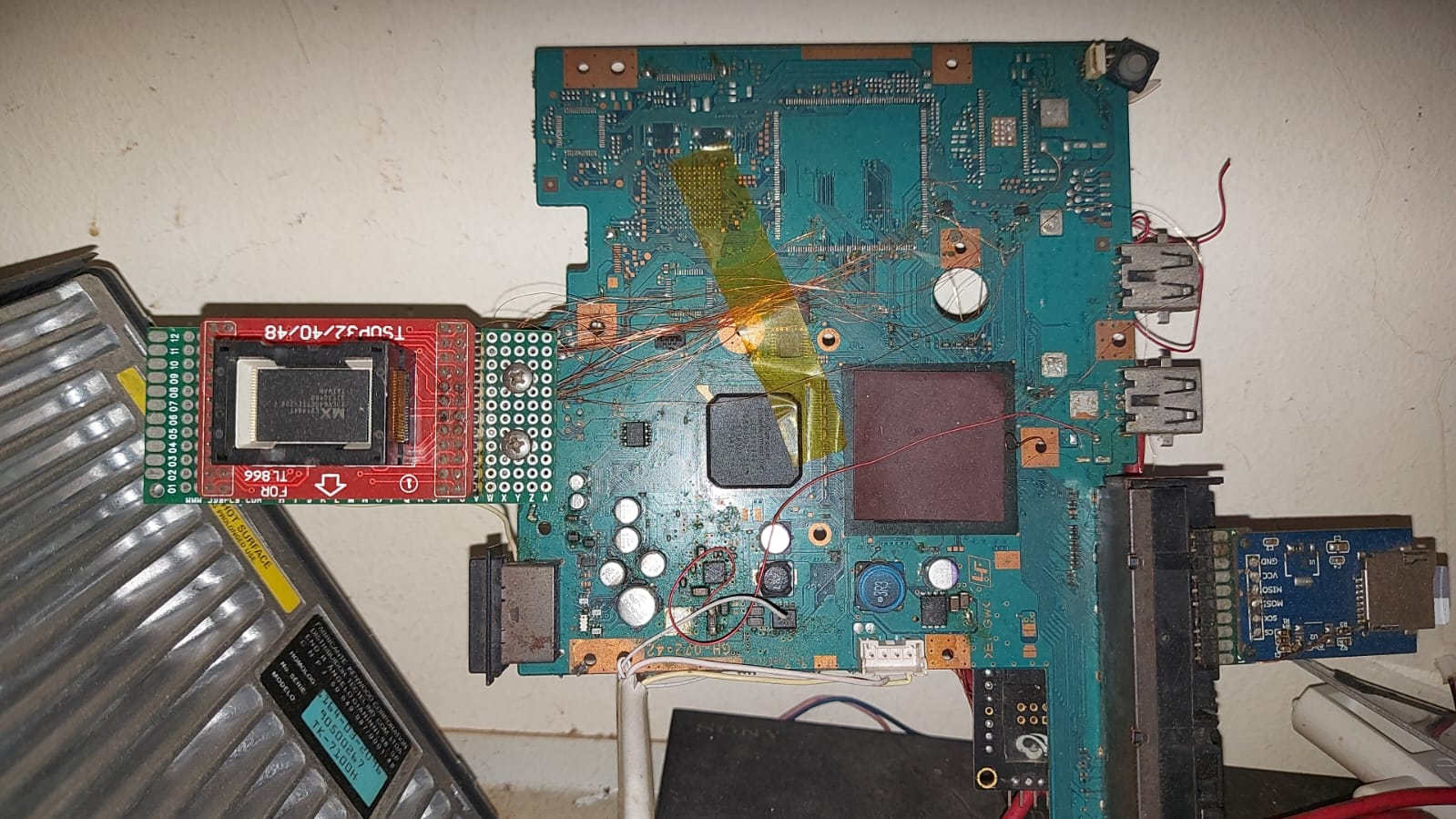

How did you initially flash the memory chip? I don't have any expensive programmers, is it possible to use anything DIY here?
If I understand correctly with the SWR pin connected, later it can be reprogrammed using a software directly from the console, but I have to get there somehow.

I will remove the gerber files from the message, you shouldn't use them, it's not a convenient option, it's difficult to install, although it works.
Currently, there is no way to upload BOOT/DVD images directly by the PlayStation 2 iyself. You will need to use a programmer (for example, the XGECU T48 with the ADP_F48_EX_1 adapter).
