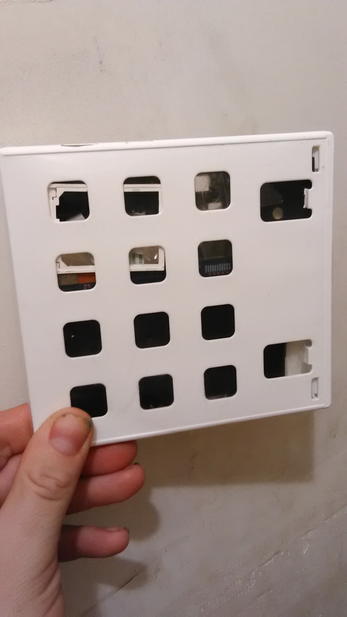

Today I picked up the casing pieces from my desk, and realized how much of a pain it's going to be to cut the bottom and top layers by hand in order to fashion a new housing. (I have not any power tools or the such to simplify this process)
And while mulling it over I had to pick up around the house (children cannot be trusted to keep the place clean), and I found a box I got ages ago filled with empty DS and 3DS game cases.
Thus comes on idea to use a 3DS game case as a new housing for my little Lenovo.
The thickness of the board and it's components are actually slimmer than the game case, so this works extraordinarily well.
However now the battery will not fit inside this case, and thus I have decided that the battery will no longer be included. Seeing as it is going to be directly attached to a television at all times, this is not going to make as much of a difference.

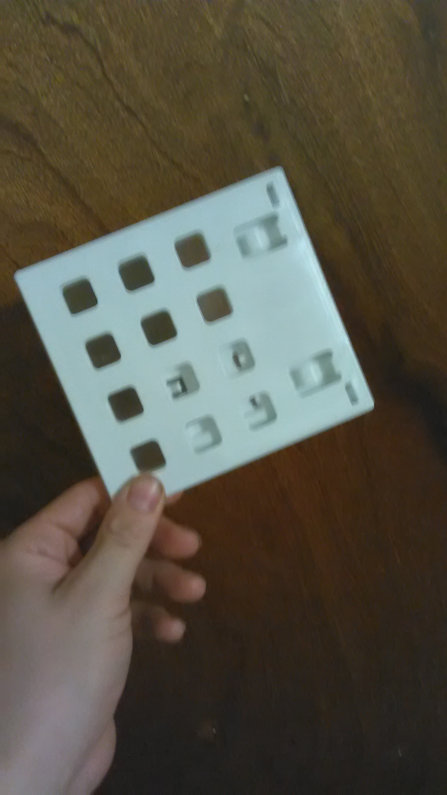

I am currently removing the tabs that hold in the instruction manuals and caution papers, so as to place the ports of the board where you would open the case from.
I will be getting someone to print a custom case insert so it will cover the plastic holes in the case, and make it more easily disguised as an actual game case, rather than it being a computer. Plus it makes for easy storage.

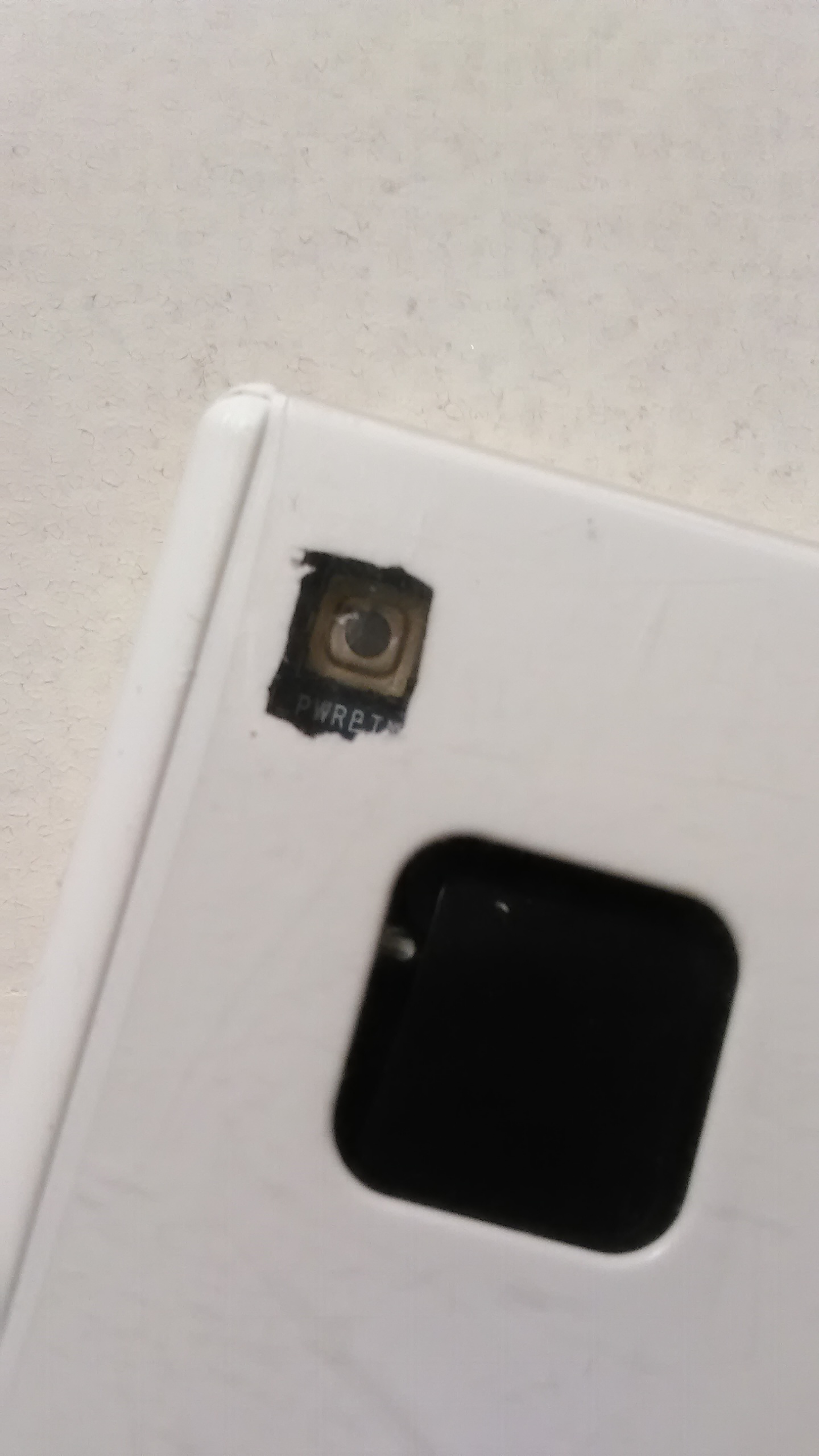

I have still not found something small, yet solid enough, to use as a power button, though I did make sure to cut a spot in the case to allow the eventual button to be placed,

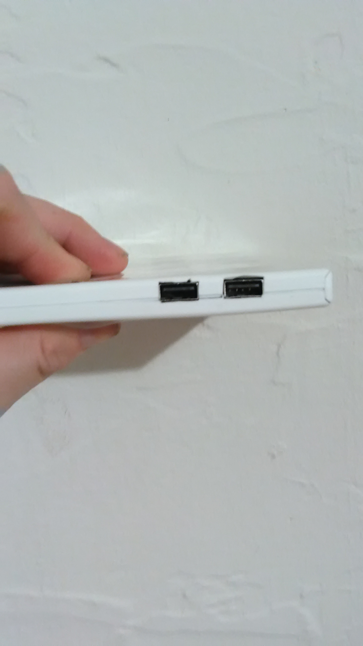

Here we can see the finished product:
Ünd here are the port shots:
USB ports:

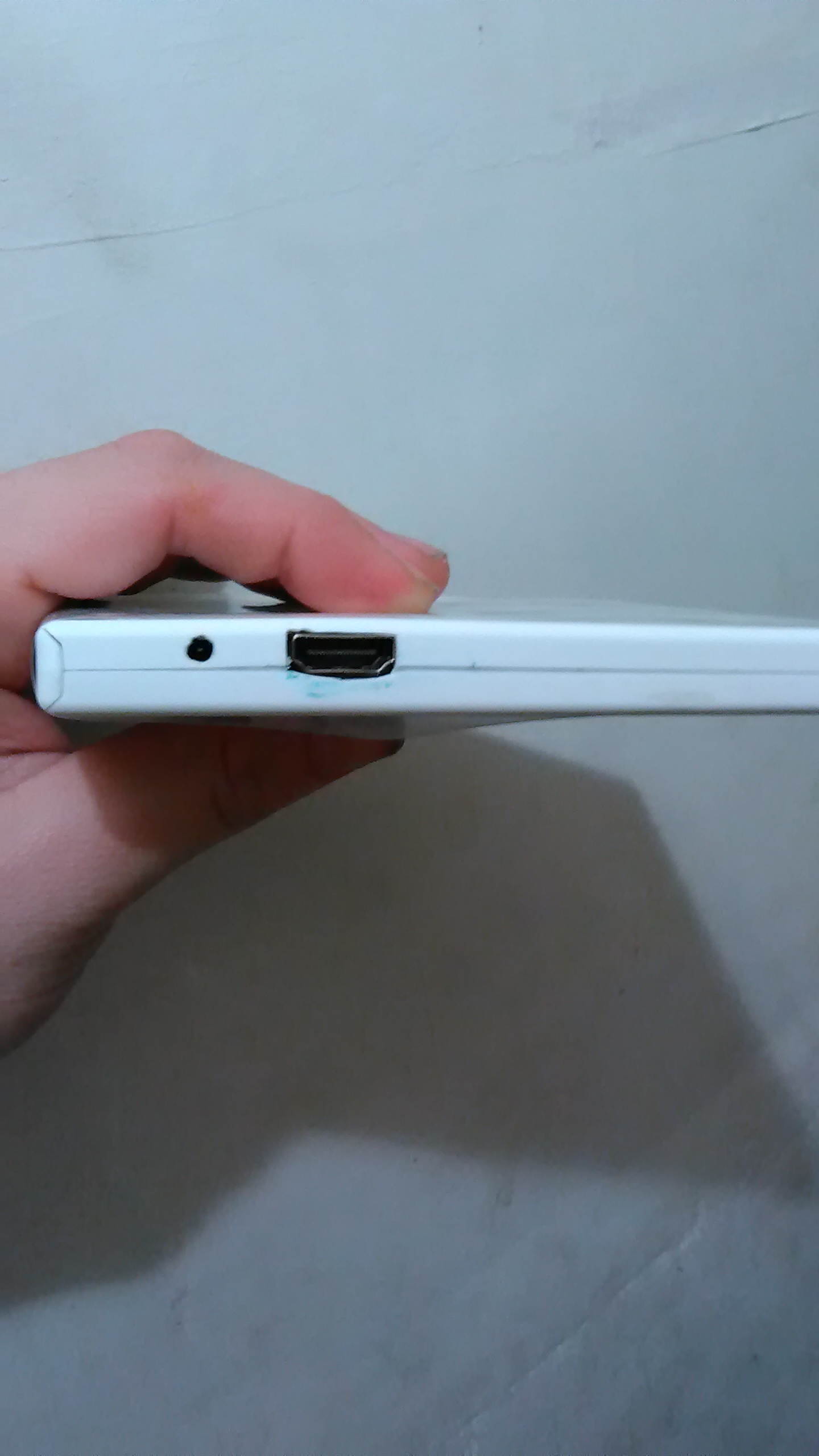

HDMI ünd DC ports:

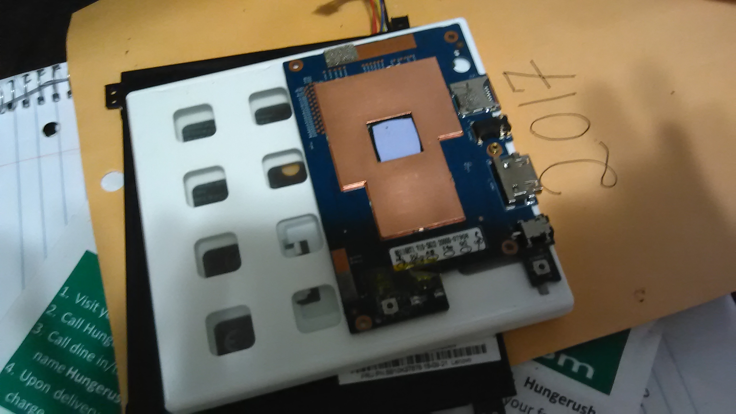

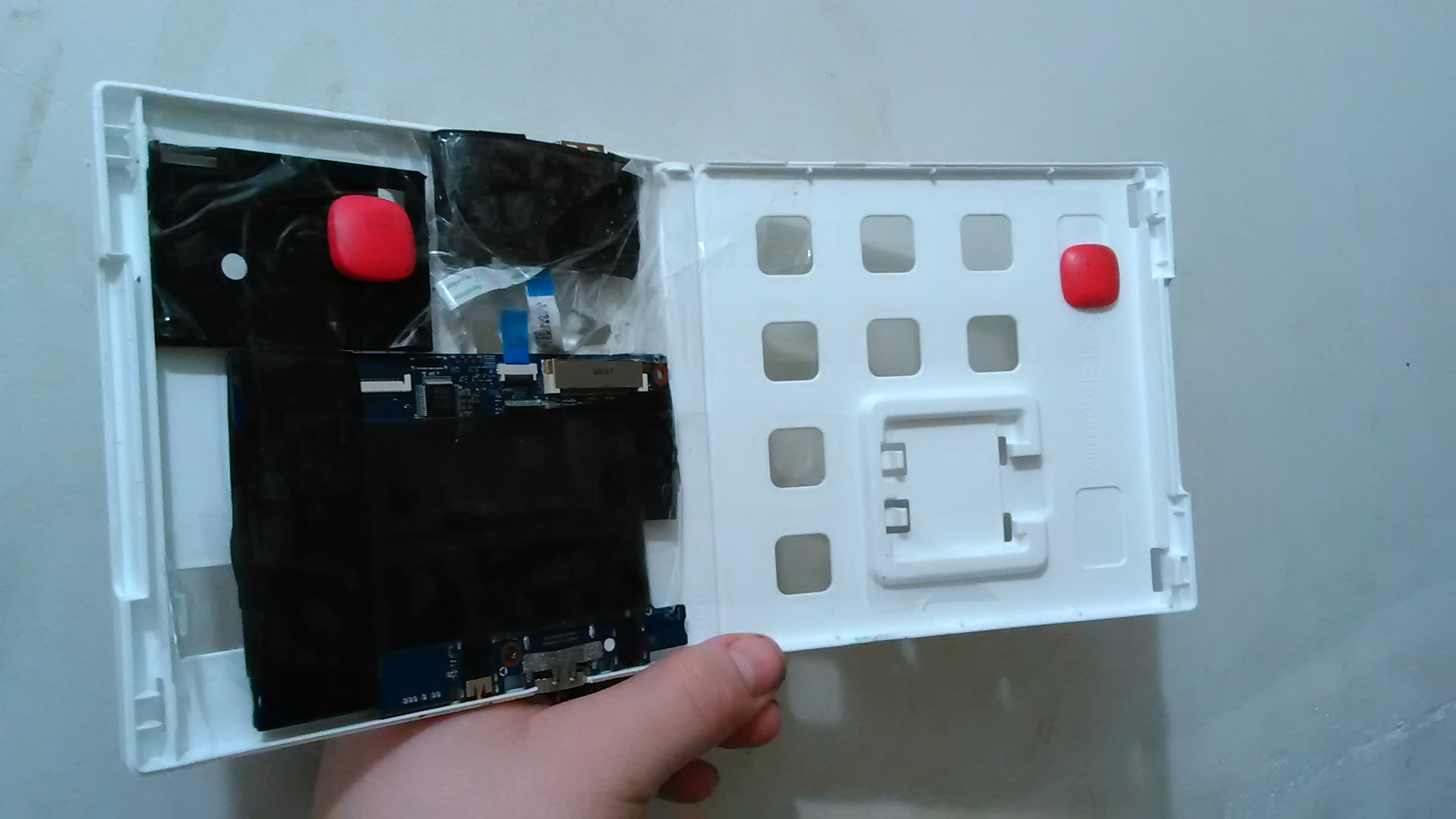

Now we open her up:
In order to protect the boards, and the case itself, I used self adhesive electrical wrap around each board.
I used the original rubber stubs as spacers to keep the boards from moving up and down in the case.
Then I used the battery holster from a Dual shock 4 controller as a spacer to keep the main board from moving horizontally in the case. I'm not sure where the DS4 battery itself actually landed.
I also used the plastic back panel of a broken 1.5inch LCD to level the USB board, so as to make sure it wouldn't wiggle around when putting in flash drives or other USB peripherals.
I decided that having this connected to the TV all the time would mean that I wouldn't be needing the 3.5mm audio output, so I didn't make a port hole for it, nor did I make a slot in the case to make use of the microSD card slot.
