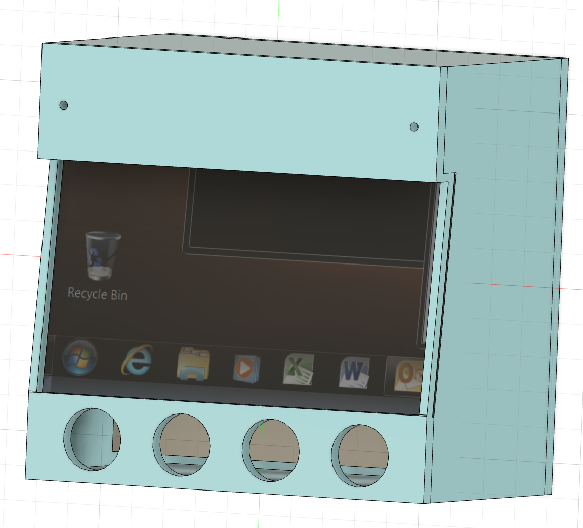

The idea is to make a desktop arcade "cabinet" - a Wii with a modified Miicro trim (as I have a 4 layer board) wired up to a screen and speakers built into a custom case. I don't plan on doing any relocations to simplify this first project, and focus on this mostly as a GameCube machine and an emulator. Also accepting name suggestions, "Desktop Arcade Wii" is a bit wordy.
As for the case itself, I have mocked up a concept as a first attempt as I'm also learning Fusion 360. I may just end up frankencasing this into a box to start. I really liked the idea of adding a sensor bar into the cabinet and being able to play Wii games, but trying to prevent scope creep. See the attached photo.

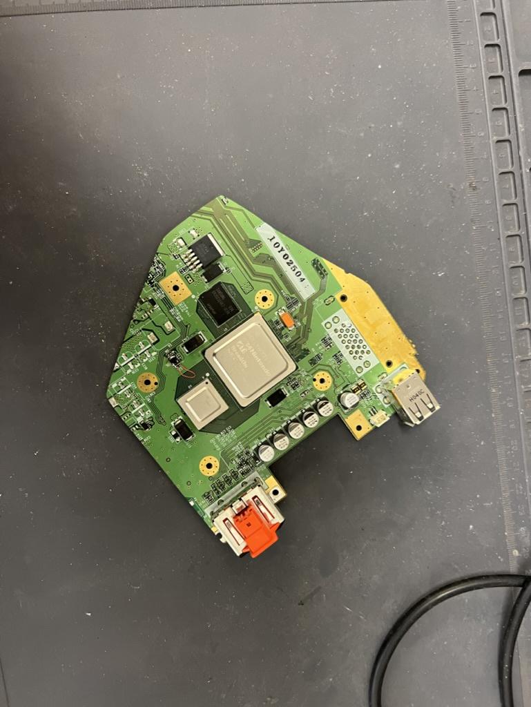

I'll posts some pics of the trim hopefully tomorrow. I realize doing a custom trim is ambitious for a first project, but I figured since the Miicro (and the adapted version I planned for the 4 layer) is well outuside the OMGWTF trim, if I am not successful I can retry with a proper OMGWTF trim. Once I know I can actually get the trim working, I'll feel a lot more confident about concrete plans for the rest of the project (screen, dimensions, etc).

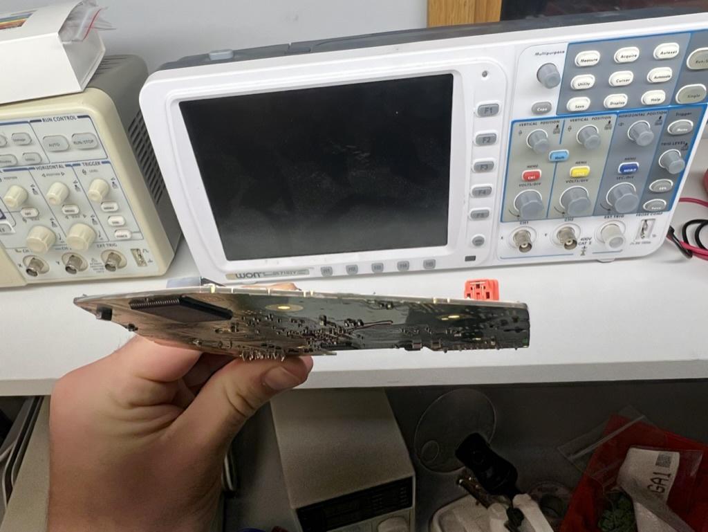

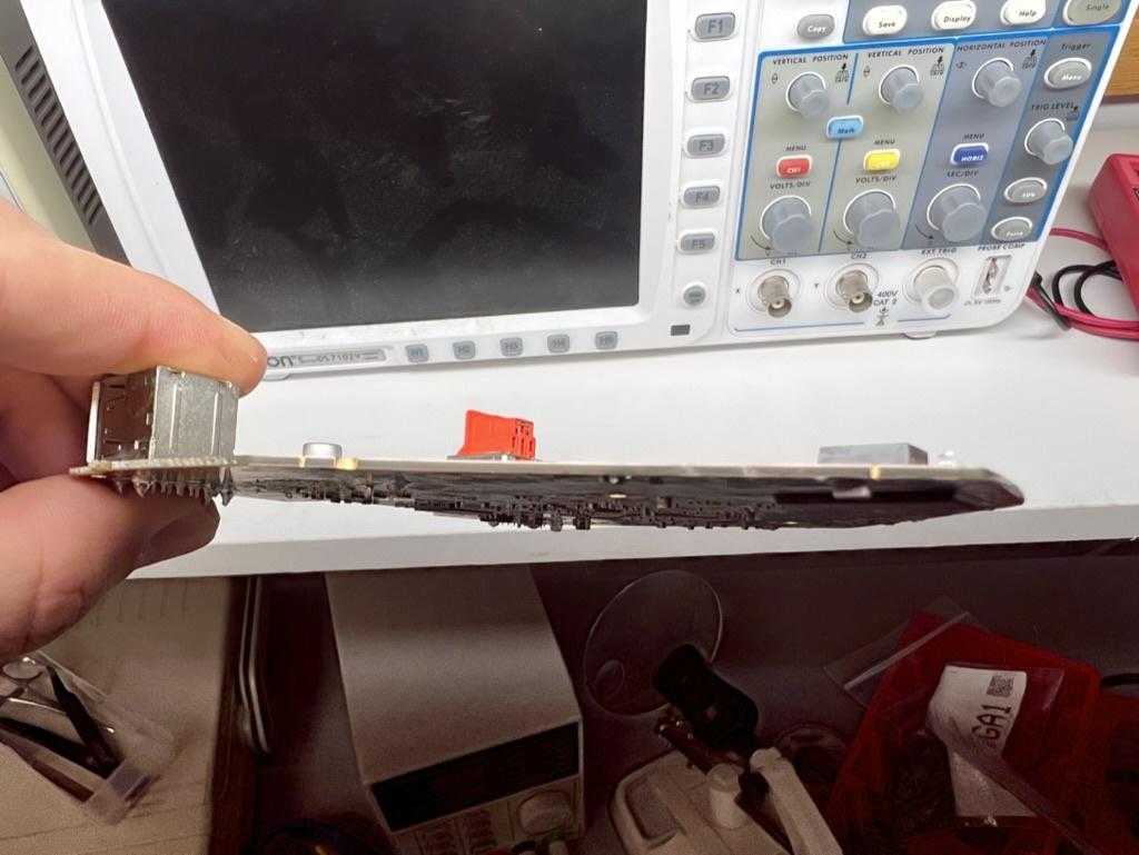

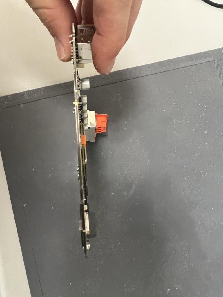

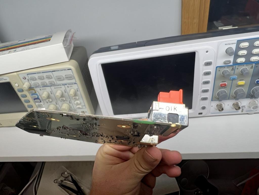

Did my first trim today. Tested resistances and it looks like I have a short on the 3.3v line. Tried removing components on the edges and retesting but no dice. Assume that it's a problem with the trim - either I need to sand more, or the trim itself is bad and I'm shorting something that way.
I did cover the CPU and GPU with kapton tape, but forgot to do so for the NAND. Thinking cleaning up everything with isopropyl is probably not a bad idea post trim and desoldering anyways, and after that see if more sanding solves this problem. If neither of those help I'm going to try and cut this to an OMGWTF trim.
Otherwise, any feedback would be appreciated.

Hi drum! I hope this tip can help you
-I'm not sure how did you finish the board's edges while sanding, but try to reach this shape to ensure that layers doesn't touch each other (the layers are the yellow ones):
My first two boards where shorted until I reached this shape on the edges
You know, I’ve never trimmed a 6 layer board, but for the 4 layer board I trimmed I would sand the edges at a small angle. This puts just a little bit more space between the edges for preventing shorts. Just make sure you don’t accidentally sand down one of those large capacitors like I almost did.

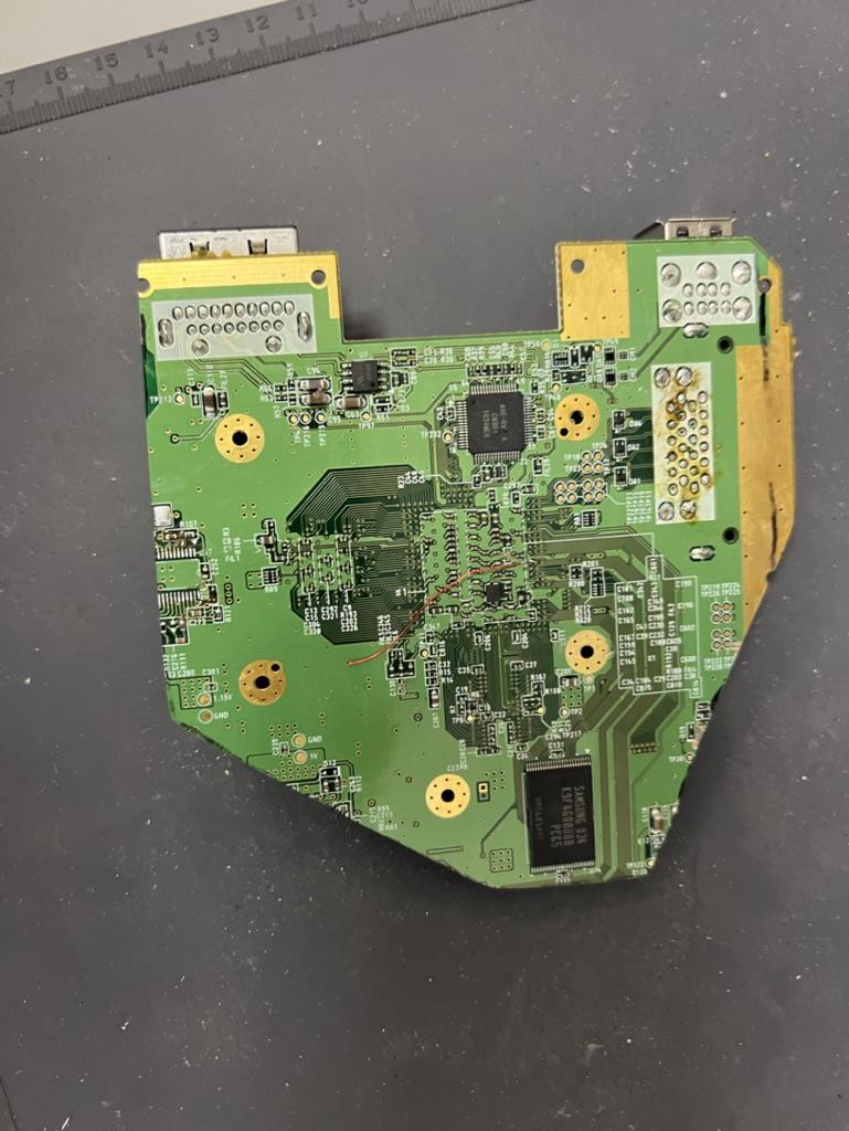

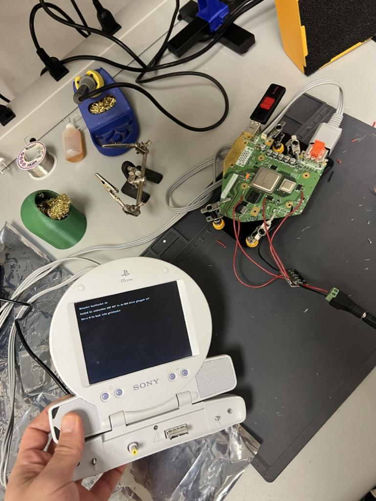

Thanks for the suggestions all! As it turns out, some scrubbing with IPA and a toothbrush fixed everything right up. And in exciting news, it boots! I wasn't able to get USB working (the picture is missing the 5v wiring), but the fact that everything else works fine leads me to believe I'm just missing a step.
Once I fix up the USB, I'll wire up the controller ports next. I also plan on probably redoing this wiring as it's a bit shoddy. I'll also need to start finalizing my case plans, now that I know this works trimmed.
Were you able to get USB working?
I saw that twisting the USB data+ and data- cables helps a lot (considering that you have the right polarity)
Also check if you’re receiving more or less than 5v on USB port
Yup - so I didn't relocate USB, since the intention was to do a Wii Micro-style "portable". The issue was twofold - first, I didn't power the USB with 5v, and second, I didn't actually enable the 5v regulator on my RVL-PSU. After doing both, I was able to get it to work.

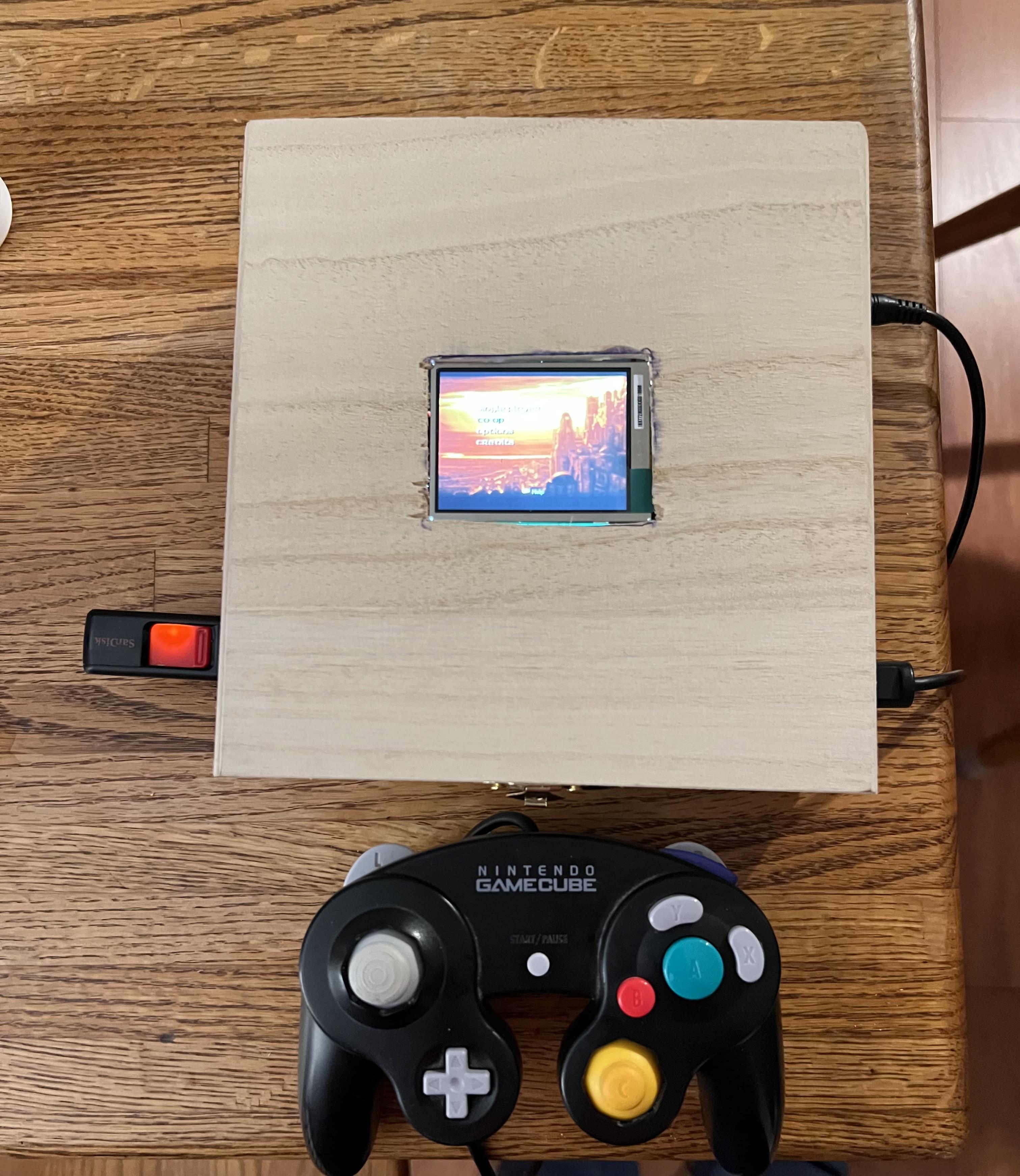

I wired up the controller, attached it to a tiny screen I had handy, and attached heatsinks, and now I have a playable Wii Micro! I put it into a wooden project box to give myself something playable while I wait for the remaining parts (bigger screen, RVL-AMP) to come in.
It looks so goofy with the tiny screen but I love it. I want to find some sort of project using this tiny screen.
Great
Looks amazing as it is!
In my first portable I had a 4” screen and looked really good even without trimming the wii

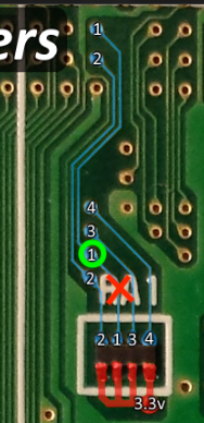

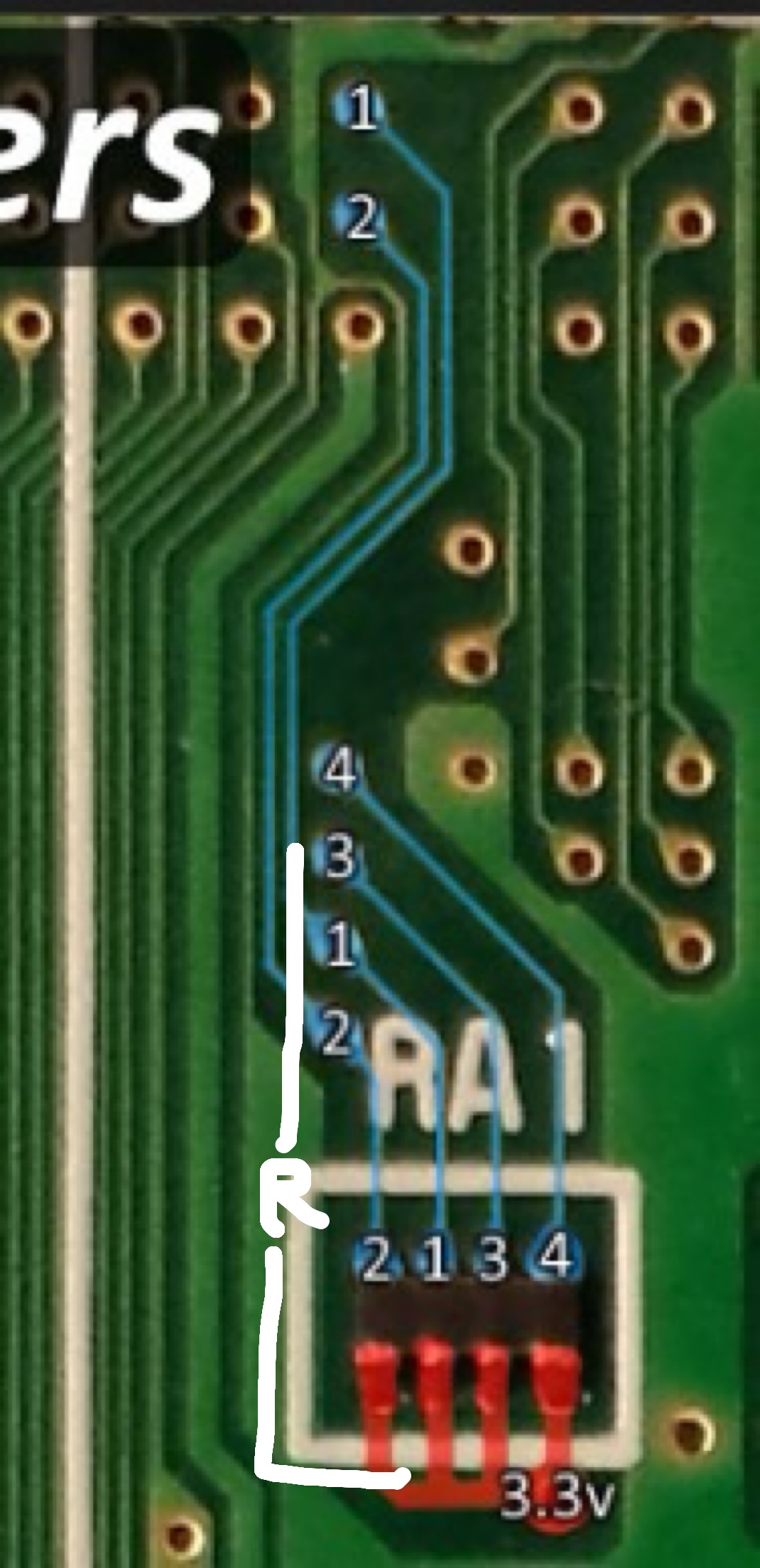

Update, this board is dead. I managed to sever the connection between the P1 controller rewiring via and the RA1. Not exactly sure how it happened, but the magnet wire I was using was way too thick, so I re-did the connections over and over again - ended up using way too much heat, being sloppy with the iron, etc. I tried a few ways to work around it and eventually burnt off the pads under RA1, which at that point I realized I wasn't going to be able to salvage this.
Disappointing, but it doesn't feel like such a huge setback. I learned some good lessons (and also going to switch over to leaded versus lead free solder, another reason I was using too much heat). And I can harvest the broken board for parts - I'm going to make keychains out of the CPU/GPU.
Luckily I have another board handy. I'm going to try a full OMGWTF trim now, since I feel way more confident about both my trimming and wiring abilities.
Do you mean that you have severed the whole blue trace for P1?
I severed the trace where the red X is. The via circled in green was also heavily scratched up, and I might have burnt the via in itself - trying to test the connection between that via and the via above showed no continuity.

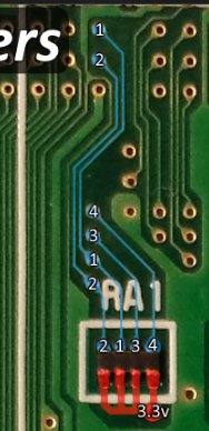

From my understanding of searching the forum, RA1 serves as a resistor array as a 750(?) ohm resistor connecting the controller vias to 3.3v. So I tried to work around the above with these methods:
- I tried to wire output from another pin on RA1 to the P1 via, in an effort to connect power to it, but that didn't work.
- I tried to connect 3.3v and a 750 ohm resistor to P1 via, but that also didn't work.
- For the above two, I tried the circled green via as well as the P1 via above.
The controller ports themselves measured with the correct voltage and showed continuity when I tested them.
I think my problem was using _way_ too much heat, both in factor of using lead-free solder and setting the iron temperature hotter, as well as redoing the joint enough touching the iron to the board for far too long.
Edit: I can post a picture of the board for posterity, at least as a lesson in what not to do.
If the via itself is still in tact, that can absolutely be salvaged. Even if the P1 via you circled is toast, you can still use the other P1 via in that image (that's the one that actually goes to the GPU). As for the severed trace to the pullup resistor, you can add a separate pullup on the port-end of the line (I know you mentioned already trying that but it's worth another shot). Doing it on the port side will give you more meat to solder the resistor to.
