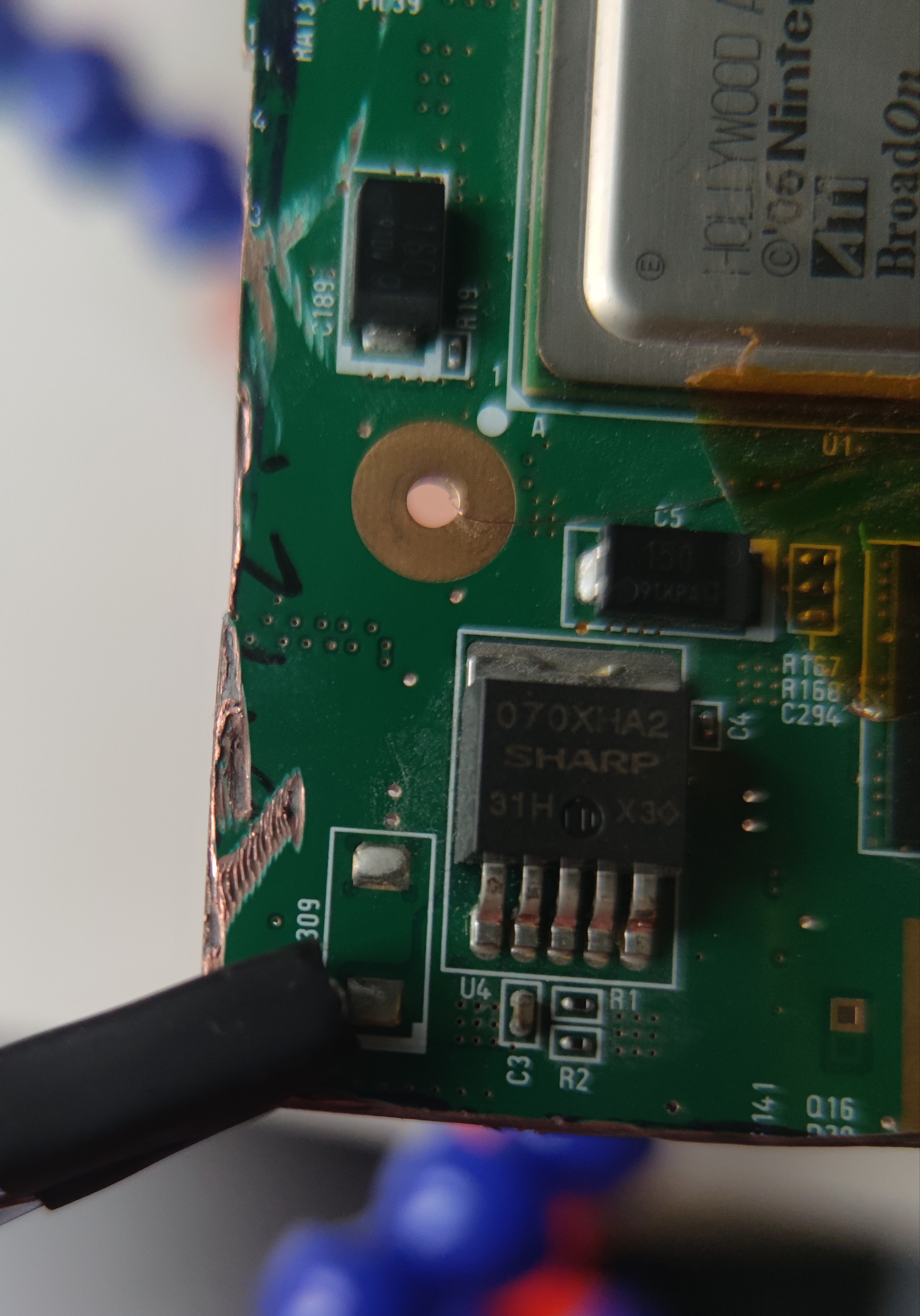

While performing the OM6 trim for this 6 layer RVL-CPU-30 unit I accidently shot out with my dremel and it removed some solder mask and what looks like a few traces at this part of the board. All traces on the back including the RAM (?) chip are still completely intact. Will the board still function with this damage, or do I have to cut up another one?
I would suggest sanding where it looks like it went into the board (as opposed to just taking off the solder mask) to make sure the layers aren't shorting, but other than that you should be fine.
