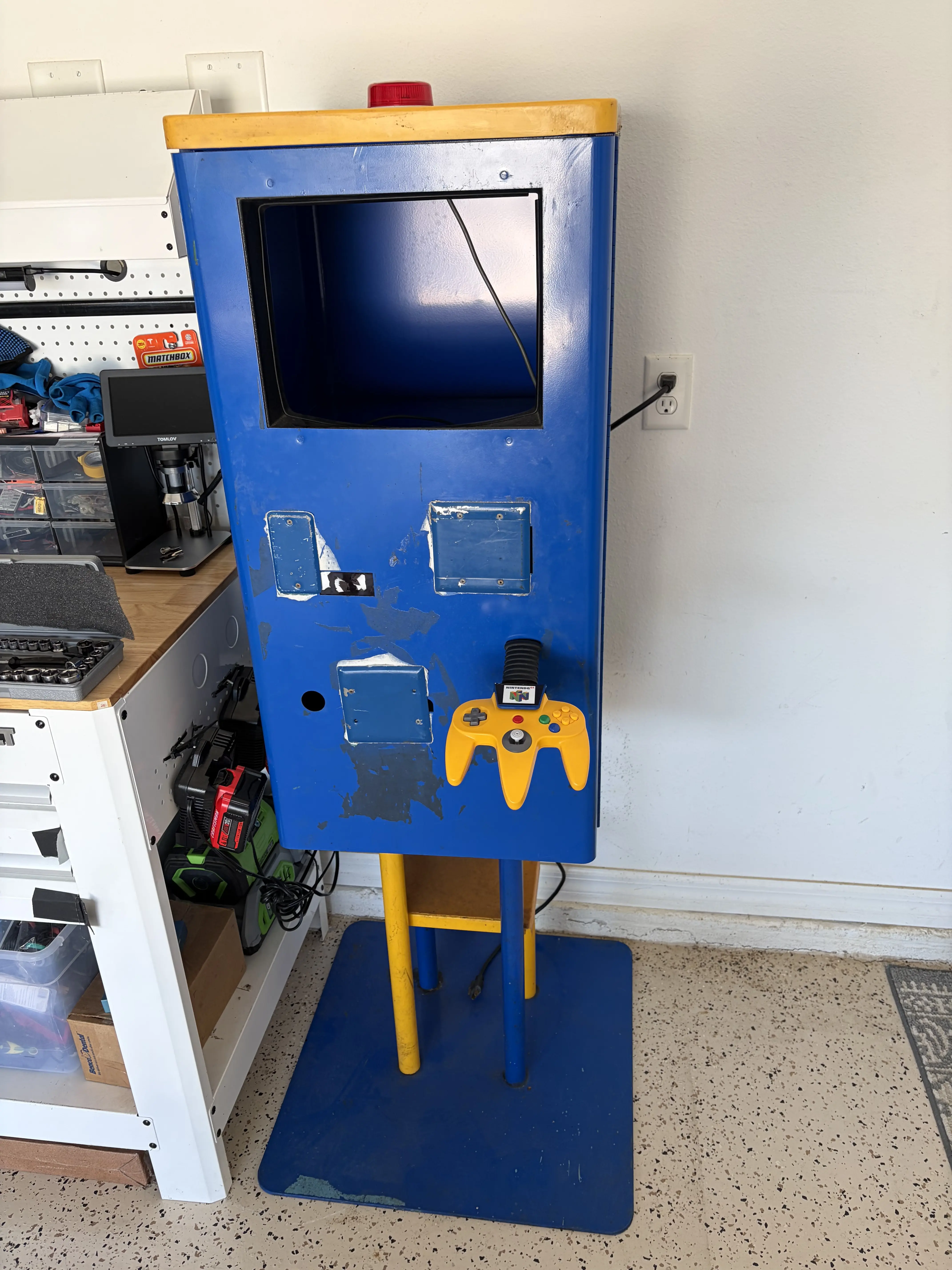

I recently bought a snap kiosk for a pretty good price. I have a friend who lives near me and owns a car wrap shop. He said he could print me the decals if I can make them and size them correctly. I used some references online and chatgpt to recreate the decals. This unit came with the tv and controller but no system. I plan on hooking up a N64 and splitting the video to the TV and to a PC inside. The PC will then take a screenshot and print to a Brother VC-500W sticker printer when the button on the front of the kiosk is pressed. I got all the programming done for that part. I’m currently removing the glue residue on the sides which is super stuck. I have one side done but it used a whole bottle of goo gone and my fingernails haha. For the N64, I know the original kiosk had a port on the front which you could plug your own game into. If I add second cartridge slot, how would I wire that up so I can make it run 2 games? The original kiosk would reboot if a game was plugged in…

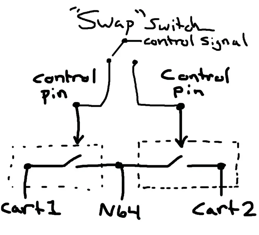

But with my background in analog audio (specifically modular synthesizer design) I've used a lot of bilateral switch chips like the 74HC4066 before. I believe there's similar chips that contain more than 4 switches so possibly look into that as well. But you could use multiple of those wired up to each cart connector's data lines and then have a primary switch that supplies the control signal to all of the switches of the cart you'd like to select, and cuts off the switches from the second cart (so that only one of the carts is active at any given time).
Something like this crude diagram I drew up:
I'm sure you could probably also automate that primary switch with some simple code or something that swaps the cart connector upon inserting a game if you're trying to get as close as possible to the original behavior you mentioned.

Looking at the slot most are ground connections, I would need pin 2, 6, 17, 22, 23, 25, 26, 27, 31, 34, 42, 45 (for ever drive support), 47, 48 and 50. That’s a total of 15 data lines. So would need 4 of those chips set up. I will do some research and see.
