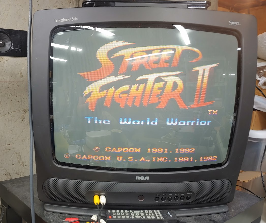

INITIAL PHOTOS

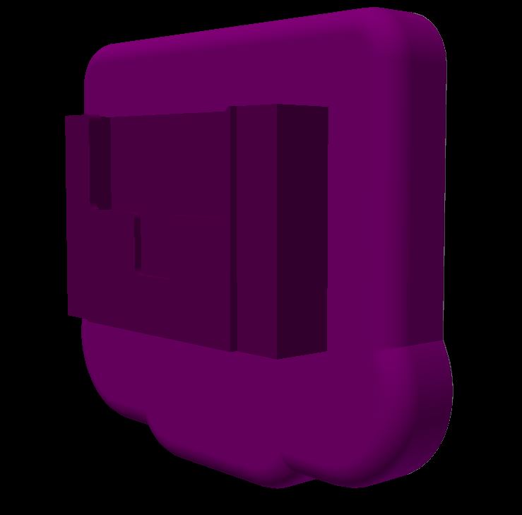

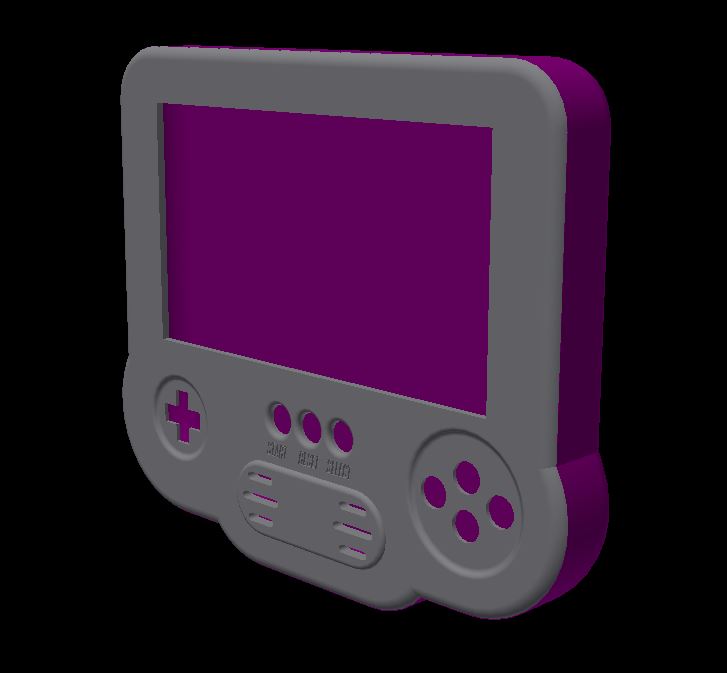

CAD RENDERS
Front - Subject to change (guaranteed to change)
Rear - Absolutely going to change
This wraps up my intro post for the 2021 Summer Building Contest.
It's THICC. It'll probably slim a bit, as the TiGER handhelds were also very thin and the SNES board has very few-if any-tall components.
The case is going to go through multiple iterations, both because I'll hate something and completely redo it and I hope that some of you will have ideas and tips to throw at me and I'll change it so it looks even more appealing.
I want to do controller outs as well and I'll probably need to make a breakout box via some kind of plug because the SNES controller ports are a solid piece of plastic with a backer PCB and they're going to be hard to shoehorn into the case design without crowding things.
The L and R buttons need to go on the back and I want to keep trigger style big boys, not the 11mm SFC/SNES/DMG buttons I'll be using everywhere else. That design will come.
Thank you for coming to my Ted Talk.

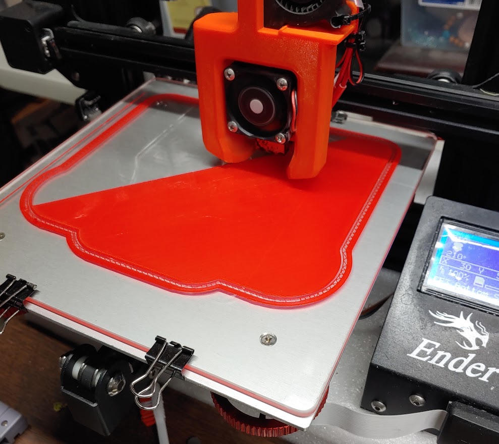

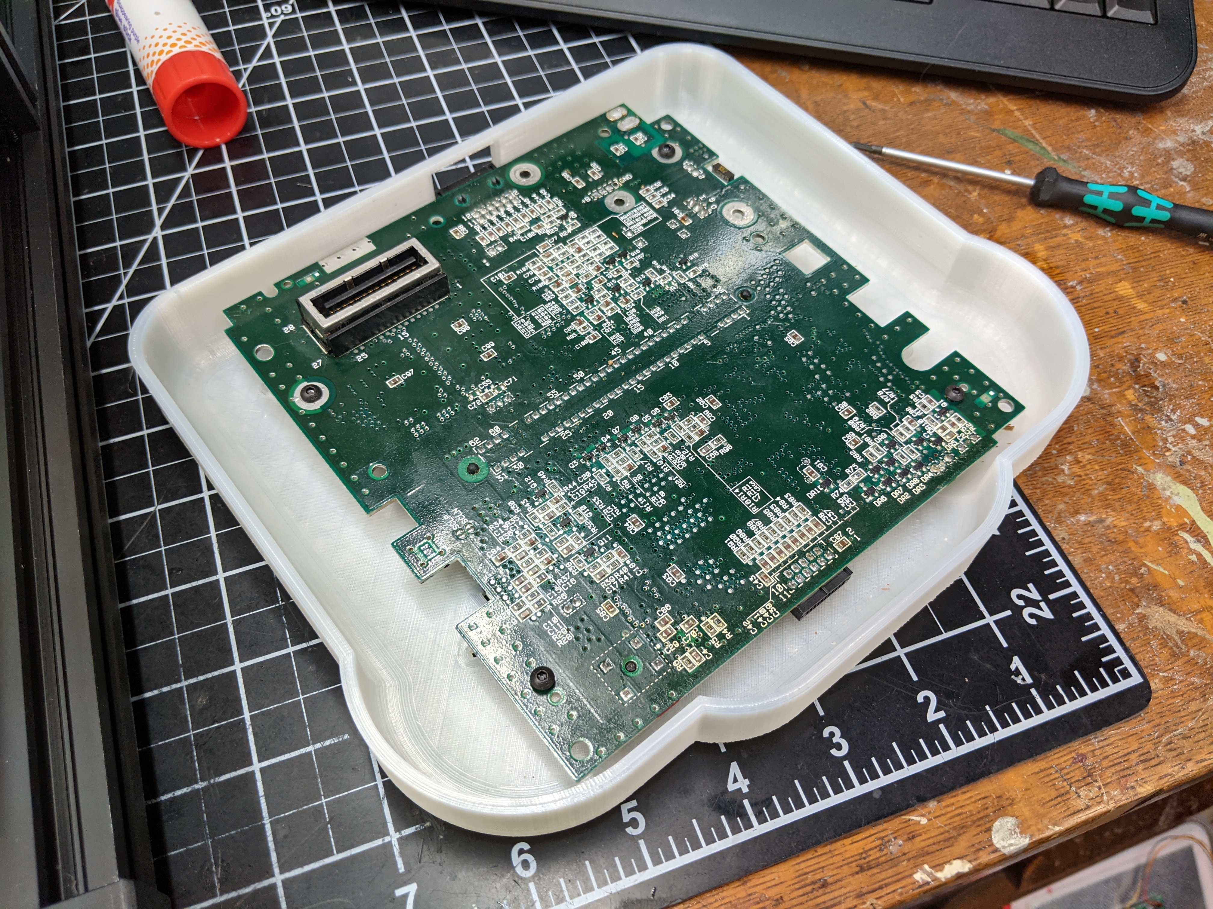

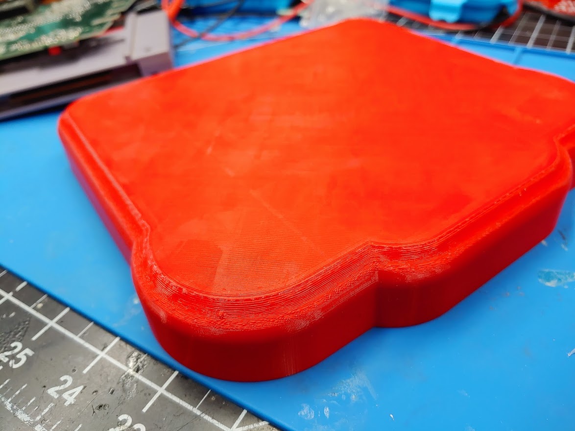

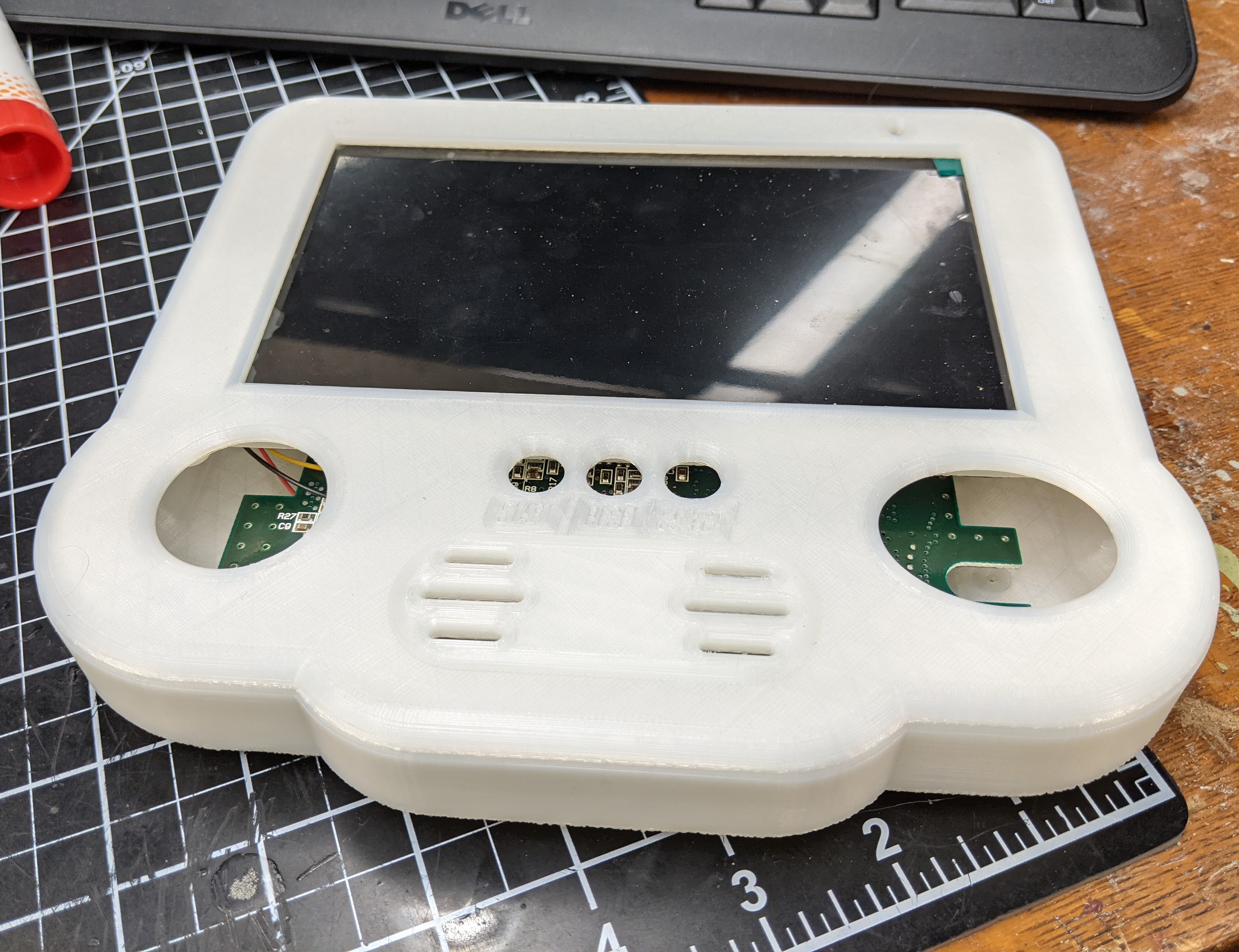

Top and bottom shells printed for initial fitment.
Need to redo dpad now that I got a SFC controller in the mail to harvest parts.
Need to add standoffs for the SNES board to attach to the rear shell.
Need to add standoffs for the front to attach to the rear.
Thinking of making outer holes where controls are and having another part slot in with buttons and soft tacs attached.
Need to measure and make access for AV out.

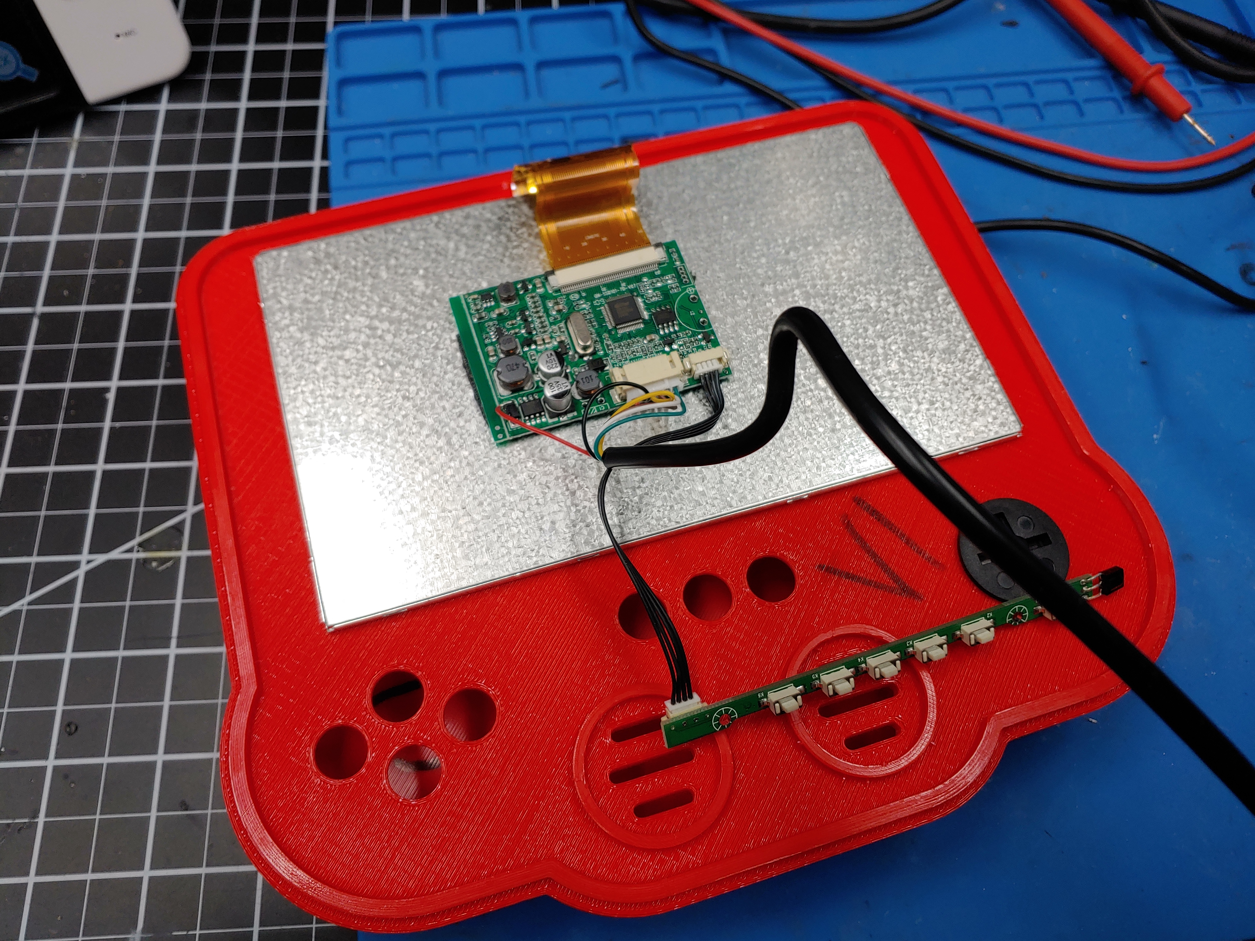

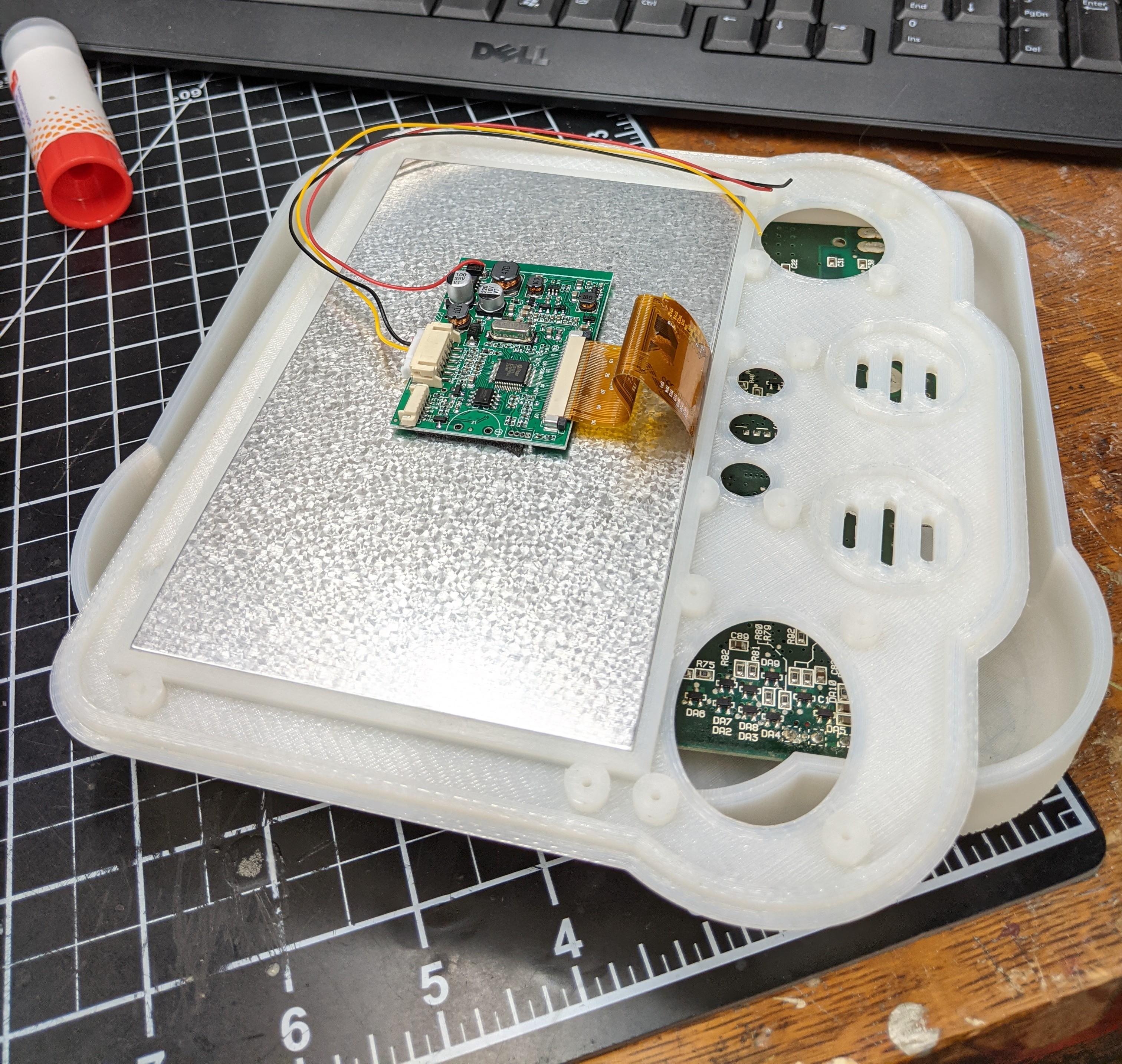

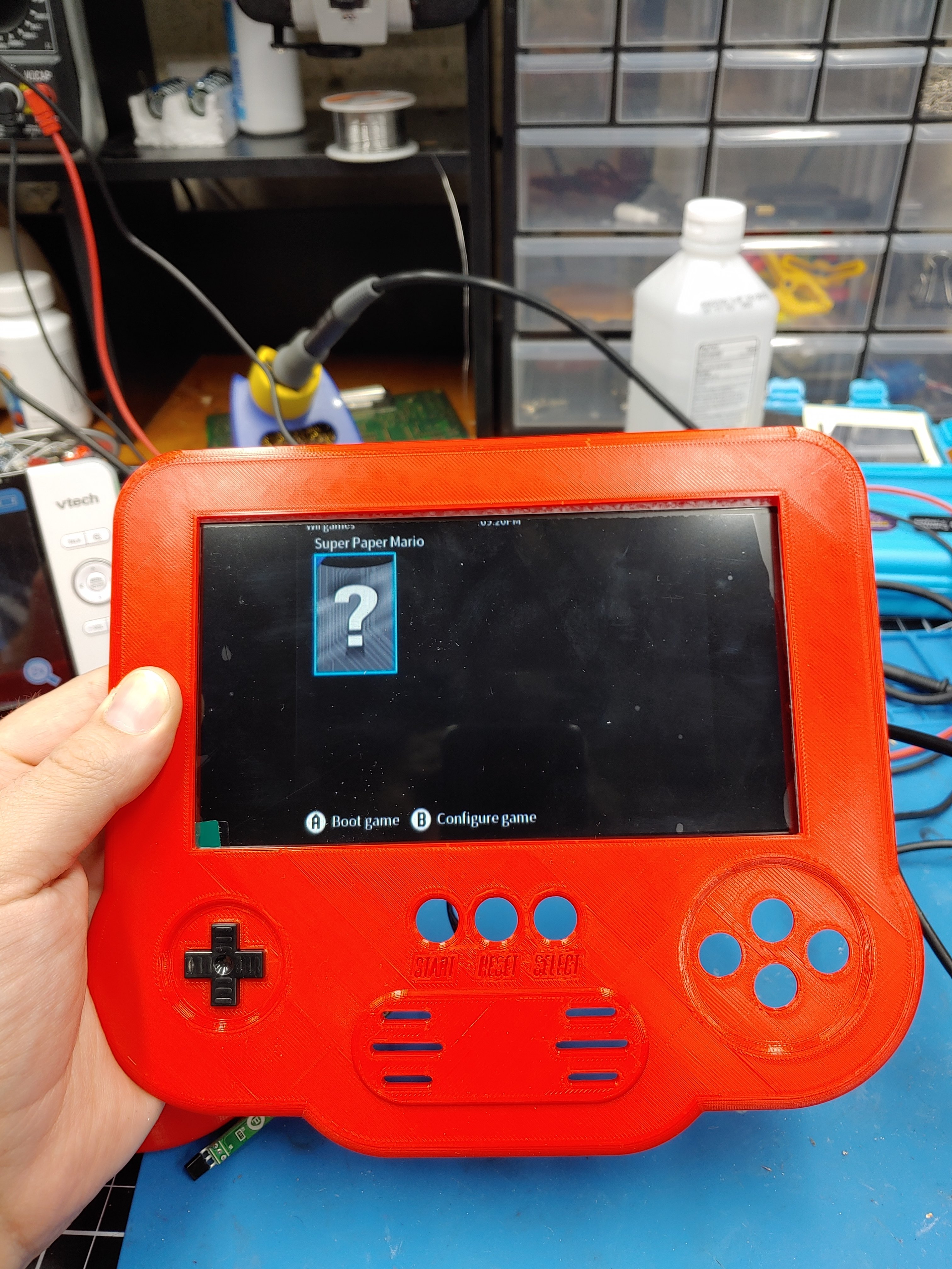

Got the 7" LCD in from Amazon ($35 special). It can do 4:3 or 16:9 which was a deciding factor as I couldn't find a larger 4:3 specific LCD for a good price.

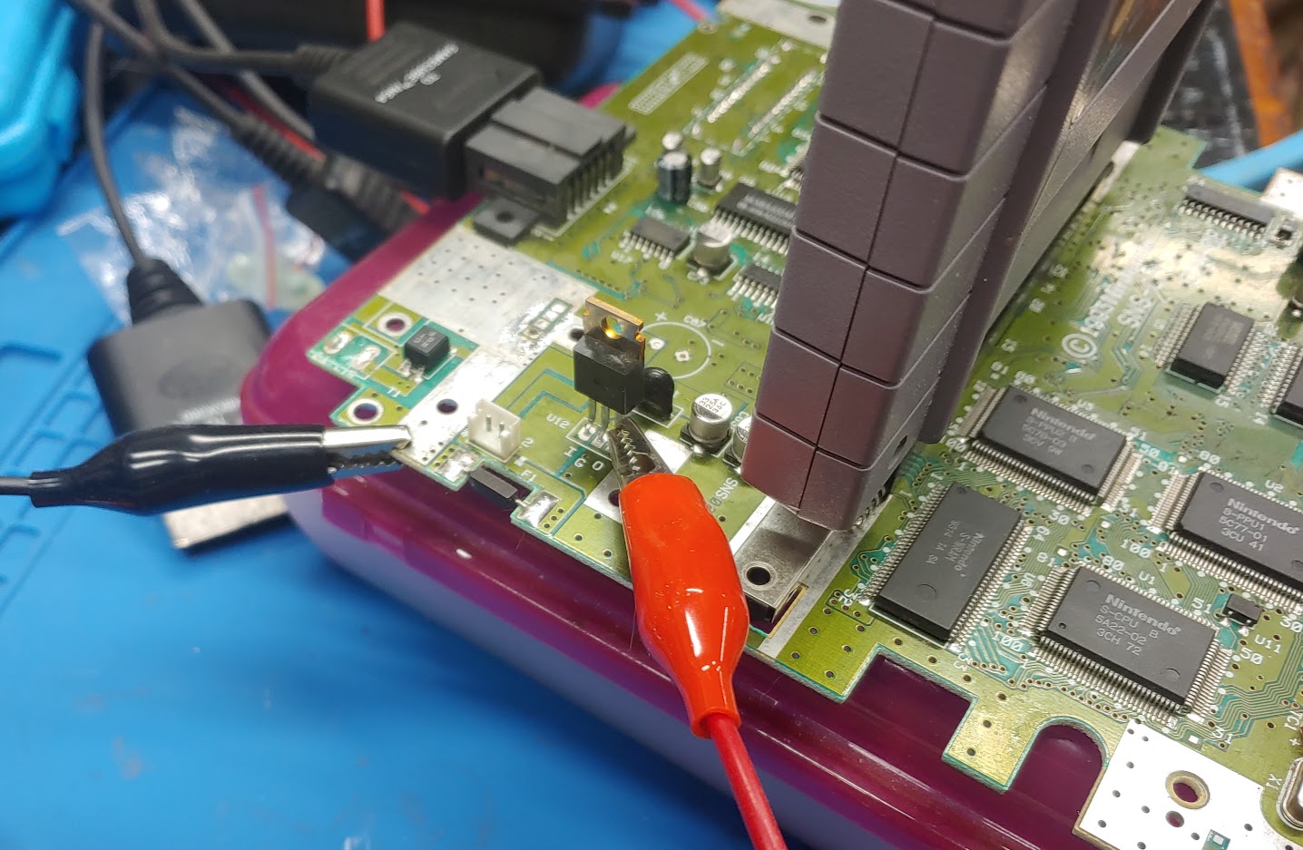

Ran it on 12V, found the 5V point and now it works on 5V.
Need to tweak the viewable area just a tiny bit, measure and model the area for the screen surround and make a bracket to hold the screen in place.
For the bottom shell I've decided to make it like the top, just a face plate. I'll print a middle spacer separately and I'll be able to save time and material when printing multiple iterations.

The real question is, will it take a 240p signal?
Absolutely (not).
RGBDRV might be compatible though, so yes, maybe.
I'm fine with composite for SNES SFC, but RGB would have been really cool. Maybe down the line?
Absolutely (not).
It doesn't matter if it's composite or RGB, the Snes only outputs a 15khz signal and if that LCD doesn't support 15khz how are you planning to get image?, a line doubler?
[EDIT]
Further looking at the pictures it does support 15khz over composite.

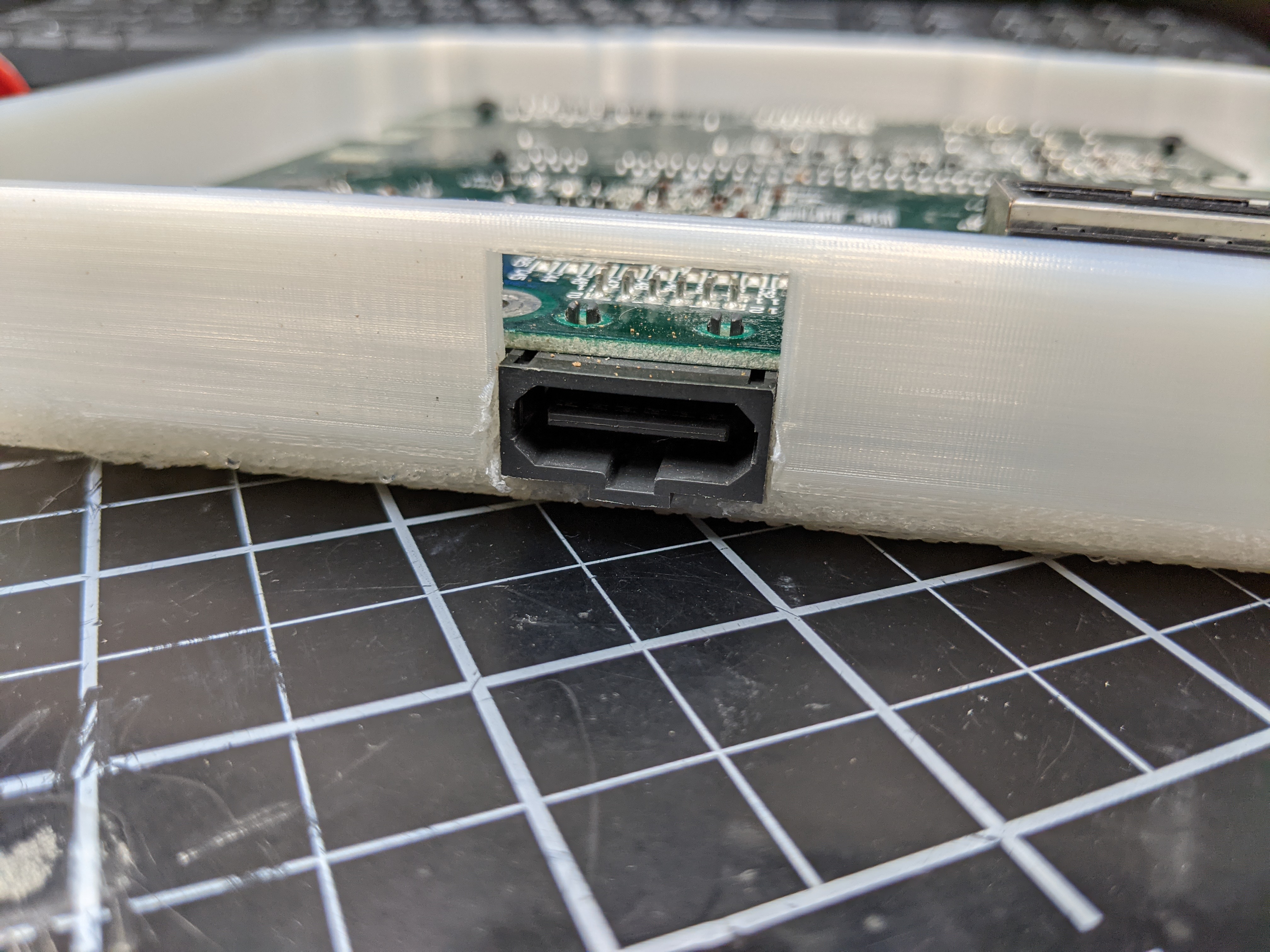

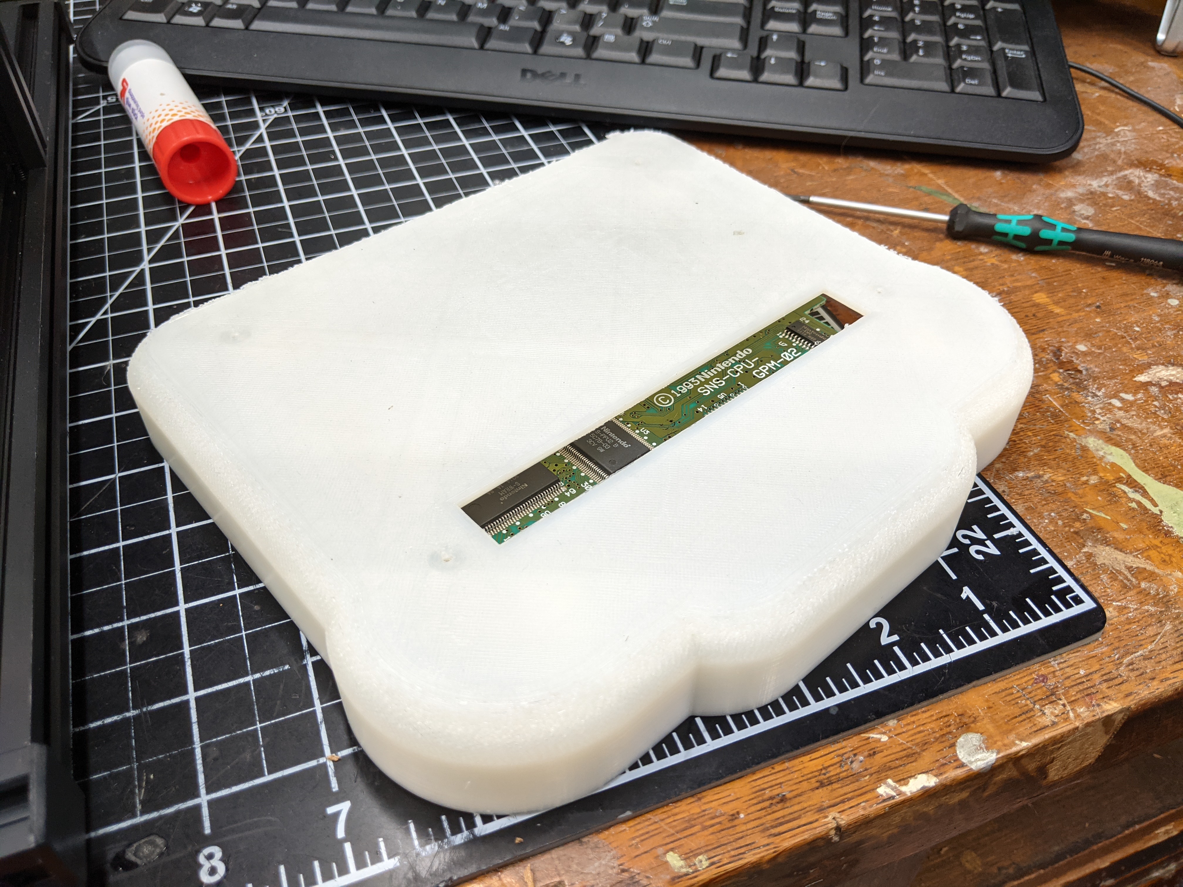

SNES Portable Update:

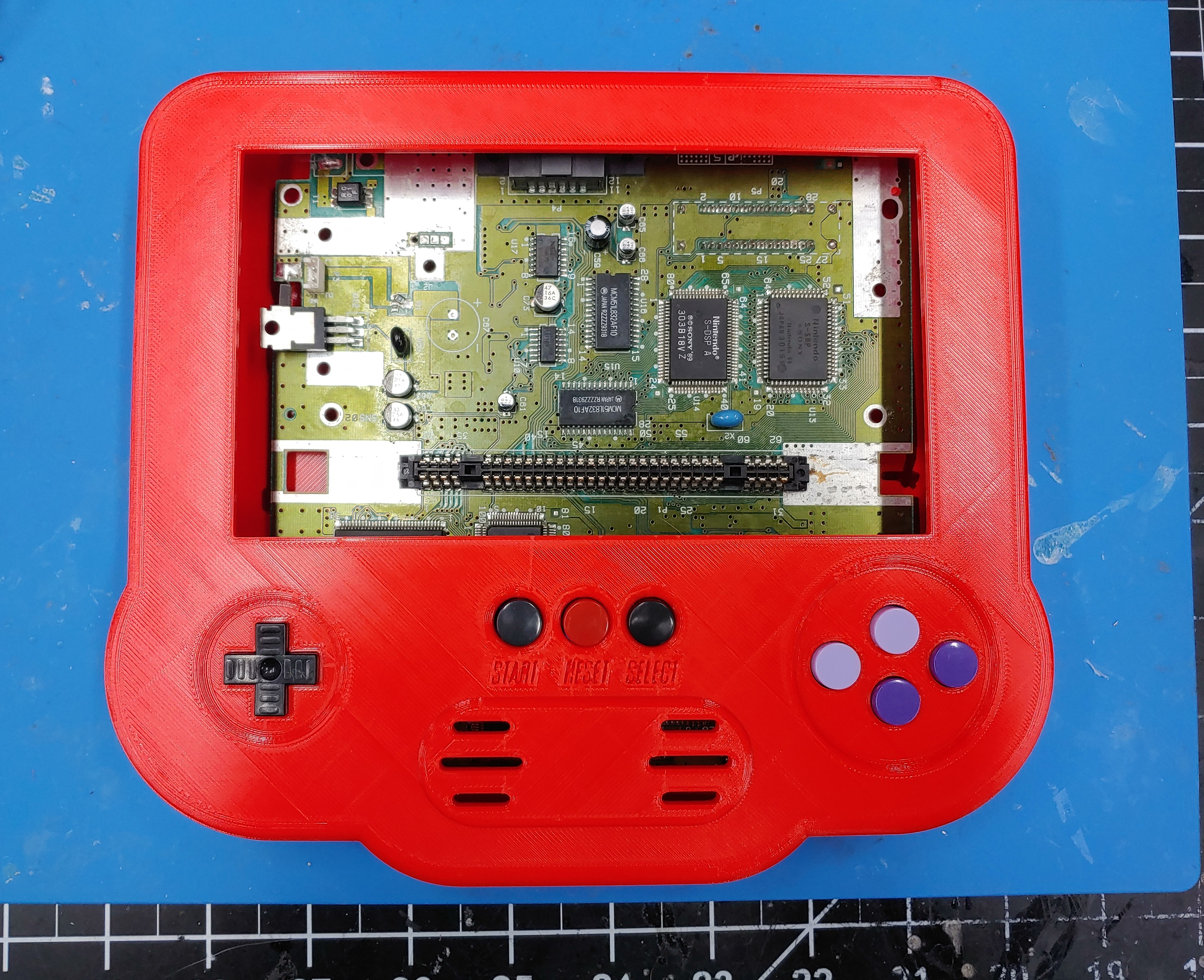

-Improved front panel, inspiration for drop in button sections from @xipher_design
-LCD screen surround added, screw holes for a screen holder bracket
-Speaker holes enlarged to 29mm

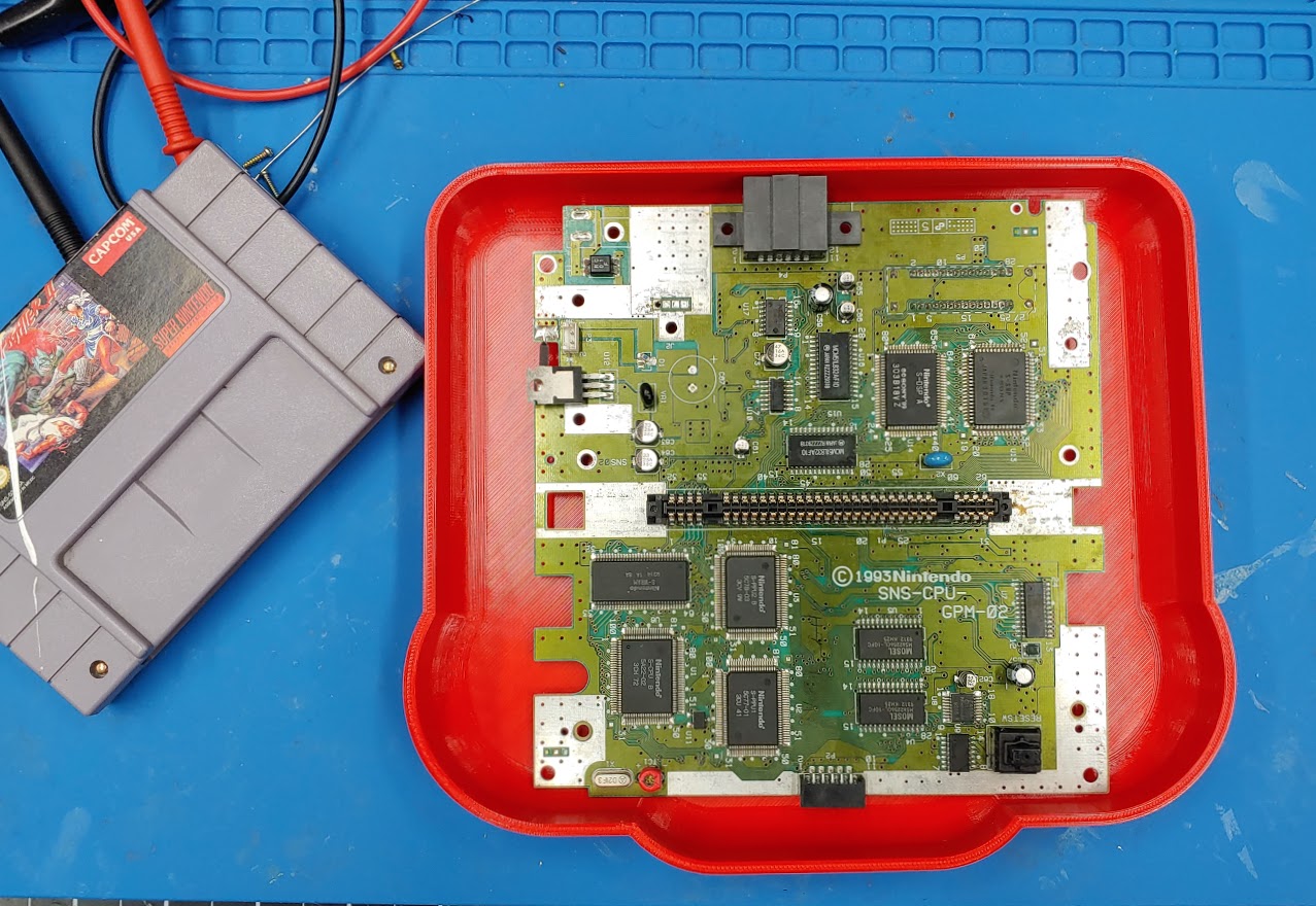

-SNES motherboard fits in rear shell, AV out should have been 12mm the OTHER way, oooooops.

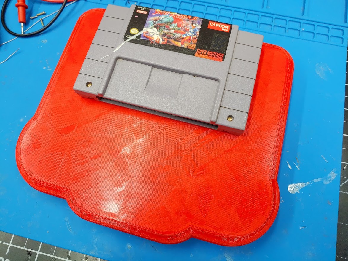

-Cart cutout placed, screw holes added
-Cart holder needs to be printed and tested, cart slot needs attachment points, controller needs to be hacked apart, controller sections need to be created and added for install into front.
PXL_20210728_003417412.jpgPXL_20210728_003436037.jpgPXL_20210728_003423600.jpgPXL_20210728_003236770.jpgPXL_20210728_003158498.jpg
