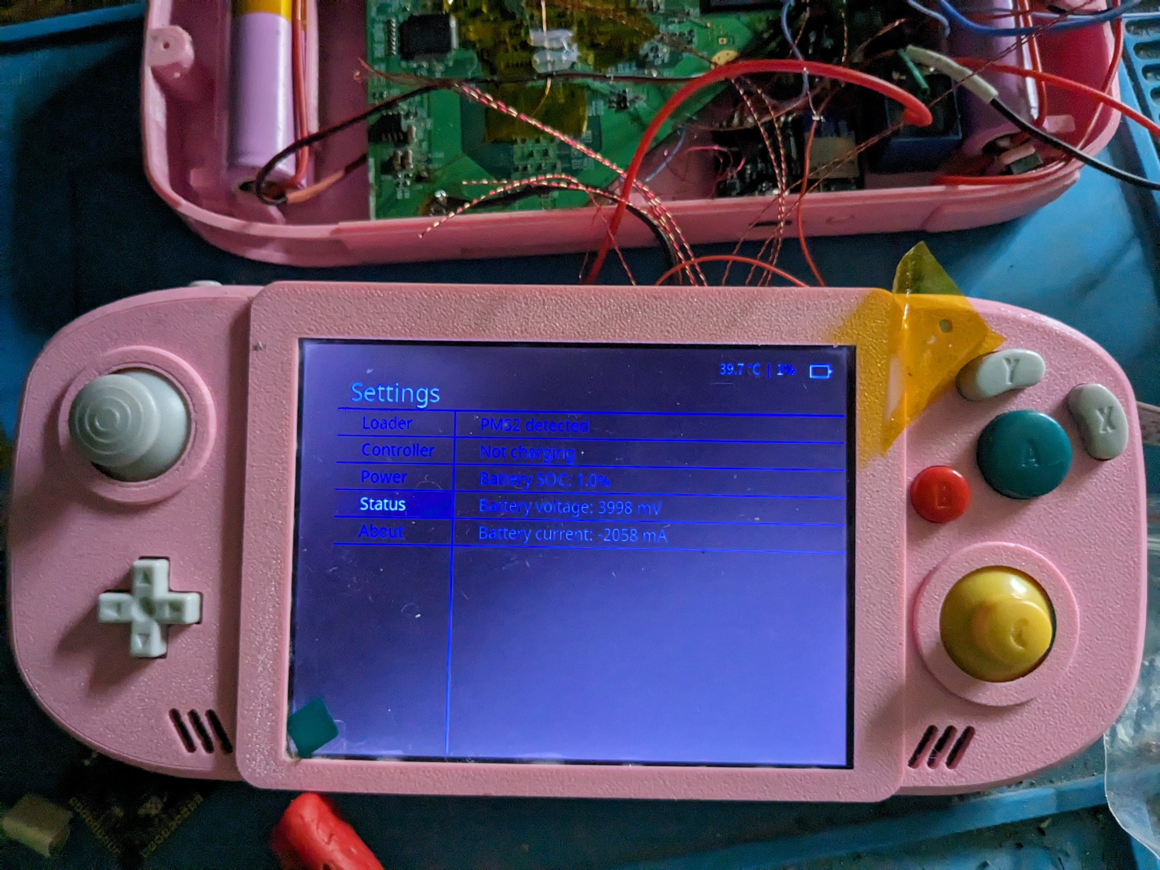

So I've been working on building a G-Wii for a while now. I just got bluetooth working, but I haven't wired up any of the gamecube controls yet. Anyways, I need help understanding why RVLoader Always thinks the battery's at 1%. It also says that the current reads to be around "-2060mA", which doesn't make sense to me either. Does anyone know what may be going on? Thanks in advance
UPDATE- I finally found the specs of my battery (I bought them about a year ago and couldn't find an email receipt or anything). I updated the PMS settings for the capacity to 3500mAh and now it days 86%, which seems much more reasonable.
I still haven't figured this out. I will add though that when plugged in & charging, it's reads around "-450mA." I really don't understand why it's giving these numbers. The battery is nearly fully charged, yet the PMS seems certain that it's at 1%.
