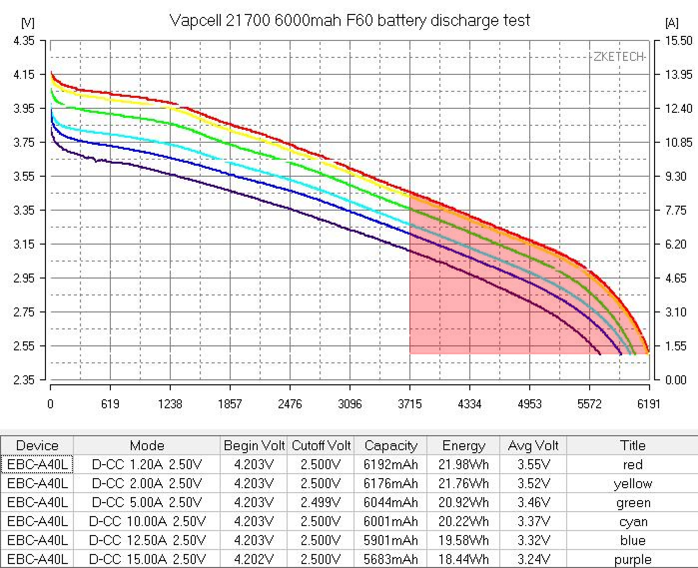

This is the Vapcell F60 discharge curve. At low discharge currents, with modern cells like this, the curve is relatively flat. A Wii portable draws around 10W, which works out to less than 1.5A per cell with a 1S2P pack like the Ashida's. So the relevant traces in the plot are the red (1.2A) and yellow (2A) ones.
By cutting off at 3.45V, you are sacrificing 40% of the cells' advertised capacity (the red area under the curve). The effective capacity per F60 cell when cutting off at 3.45V is only 3715mAh, not 6000mAh!
That's 13.4Wh per cell. Assuming your portable draws 10W, a 1S2P 26.8Wh pack will run it for 2.68 hours. This matches the behavior you're seeing. A fully exercised cell (nearly 6200mAh at these low C-rates!) provides 22.3Wh. As you said, that would work out to 4.5hrs.

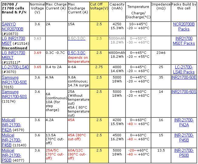

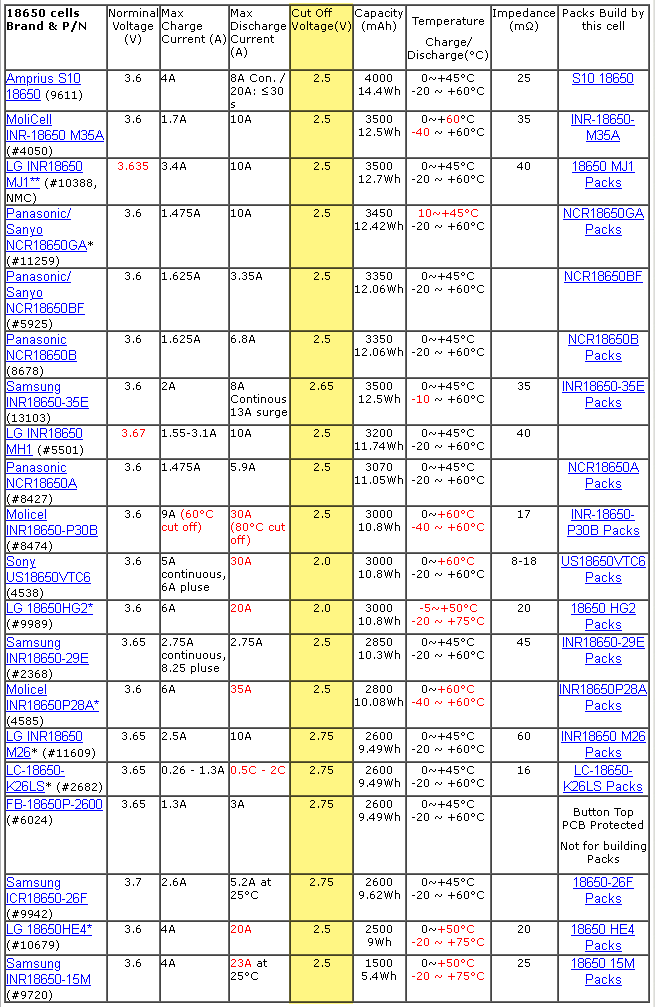

2.5V really is the industry standard cutoff voltage for cylindrical cells. A few cells have cutoff voltages of 2.7V or so, but they are outliers.

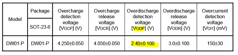

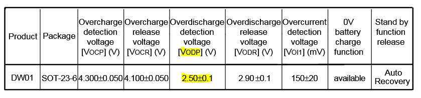

The most common DW01 protection IC, used in virtually all eBay/AliExpress PCMs, has an overdischarge threshold of 2.4V - 2.5V.
A threshold of 2.9V would only sacrifice ~10% capacity instead of 40%, while providing very wide safety margin for all cells on the market.

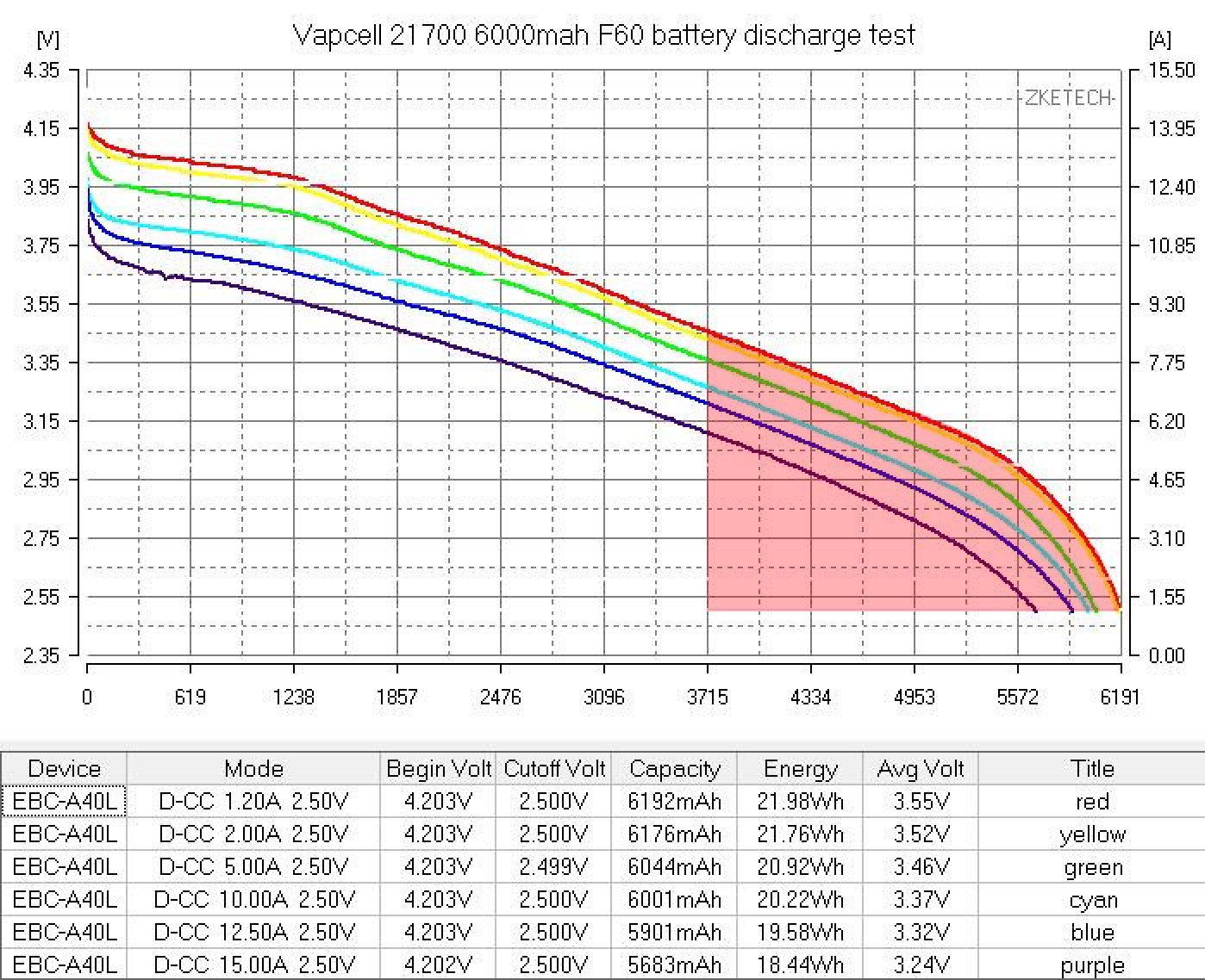

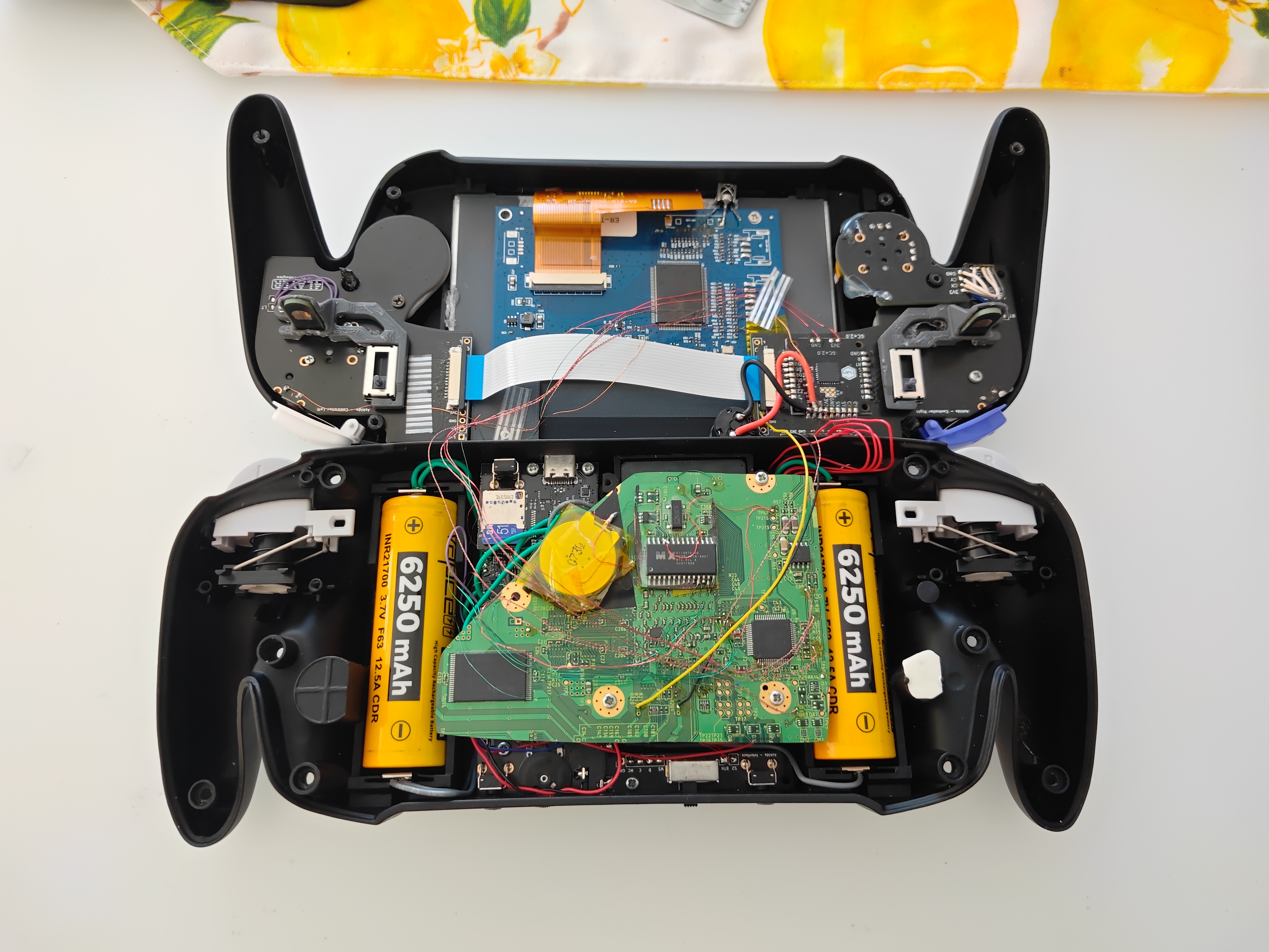

Wow thanks, never thought about that, I ordered the new 6250mAh to get maybe another 15-20 minutes
Man my figures are hella outdated...................
got the new batteries and try the battery time now
