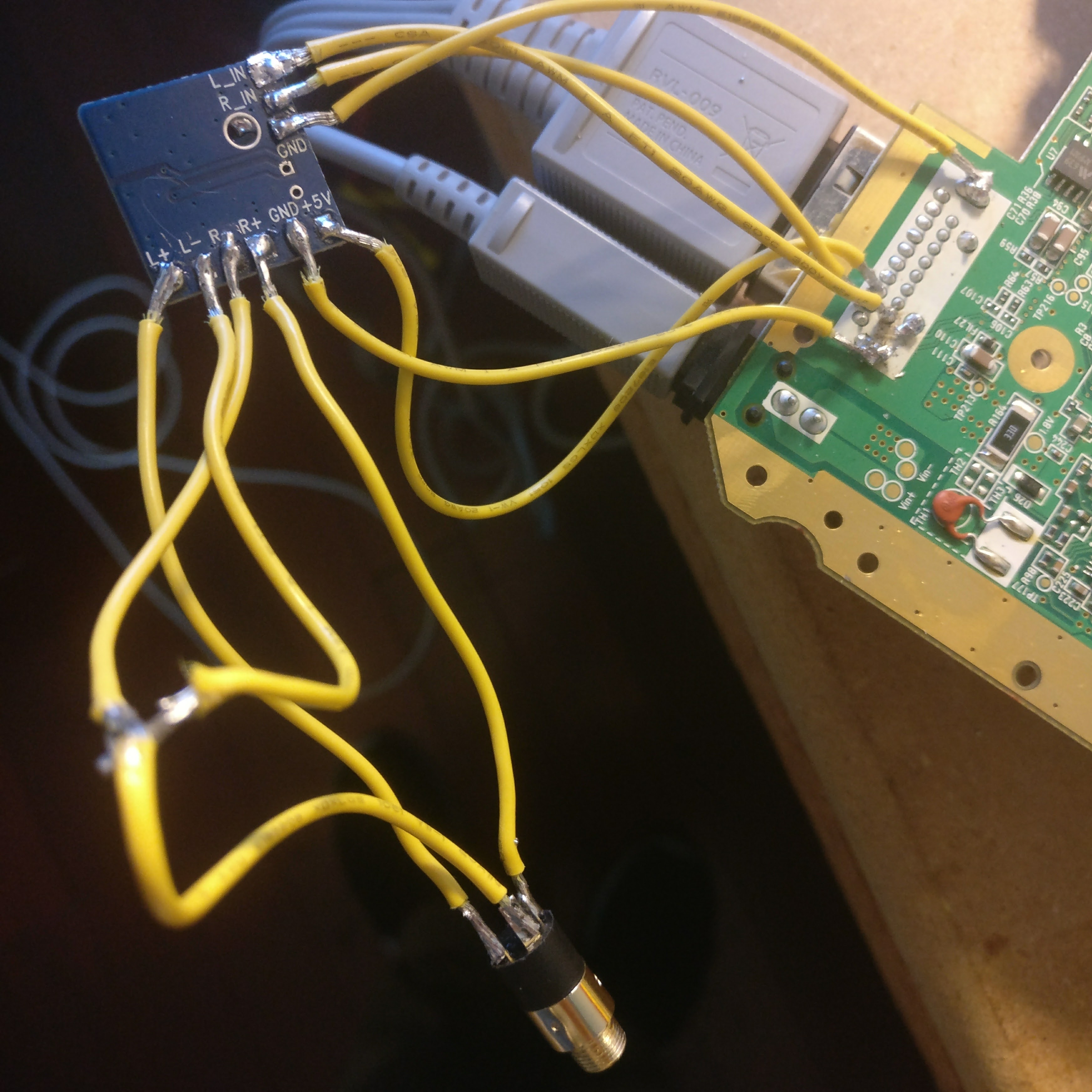

Yep, I realized that after I remembered that that's how it is for the jack. So I'm not quite sure what's going on. I'll post a picture when I get home, maybe that'll help

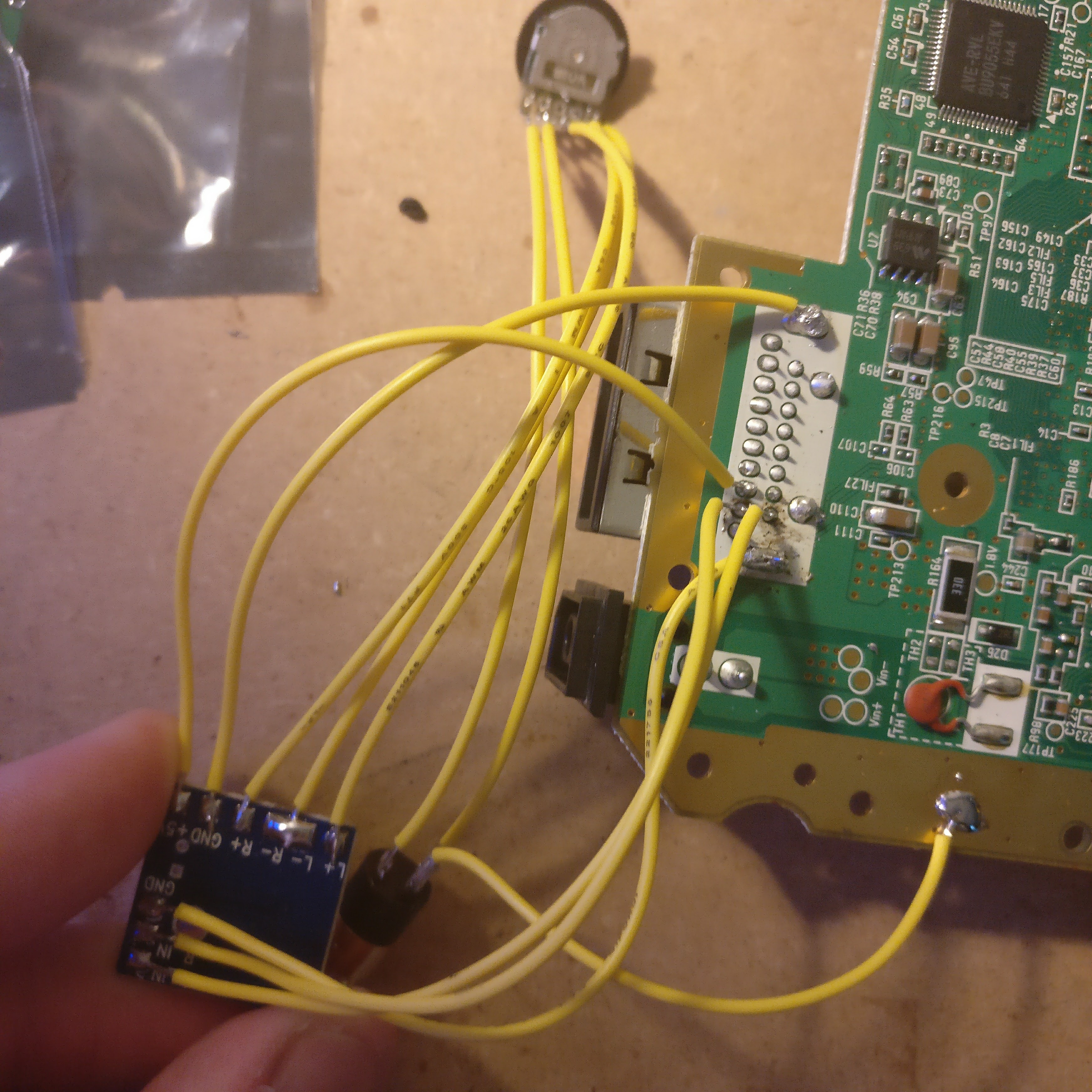

I definitely have to be wiring something up wrong. I'm getting crackling no matter what I do with the amp, but I know the amp works. As soon as I solder the jack straight to the board without the amp there's no crackling.
I've gotta be overlooking something, right?
When you said you hooked it up directly, how did you have it wired?
Just without the amp. Left and right audio from the board straight to the jack and then just grounded it. It works with the pot too, but as soon as I add the amp it goes to poop
Well, try wiring just the amp and no pot? The amp may be bad
Huh, weird. I had used the amp with some speakers yesterday and it was working just fine, but I guess it might be bad now? Skipped the potentiometer and still got the crackle. I'll order another amp and see if it works.

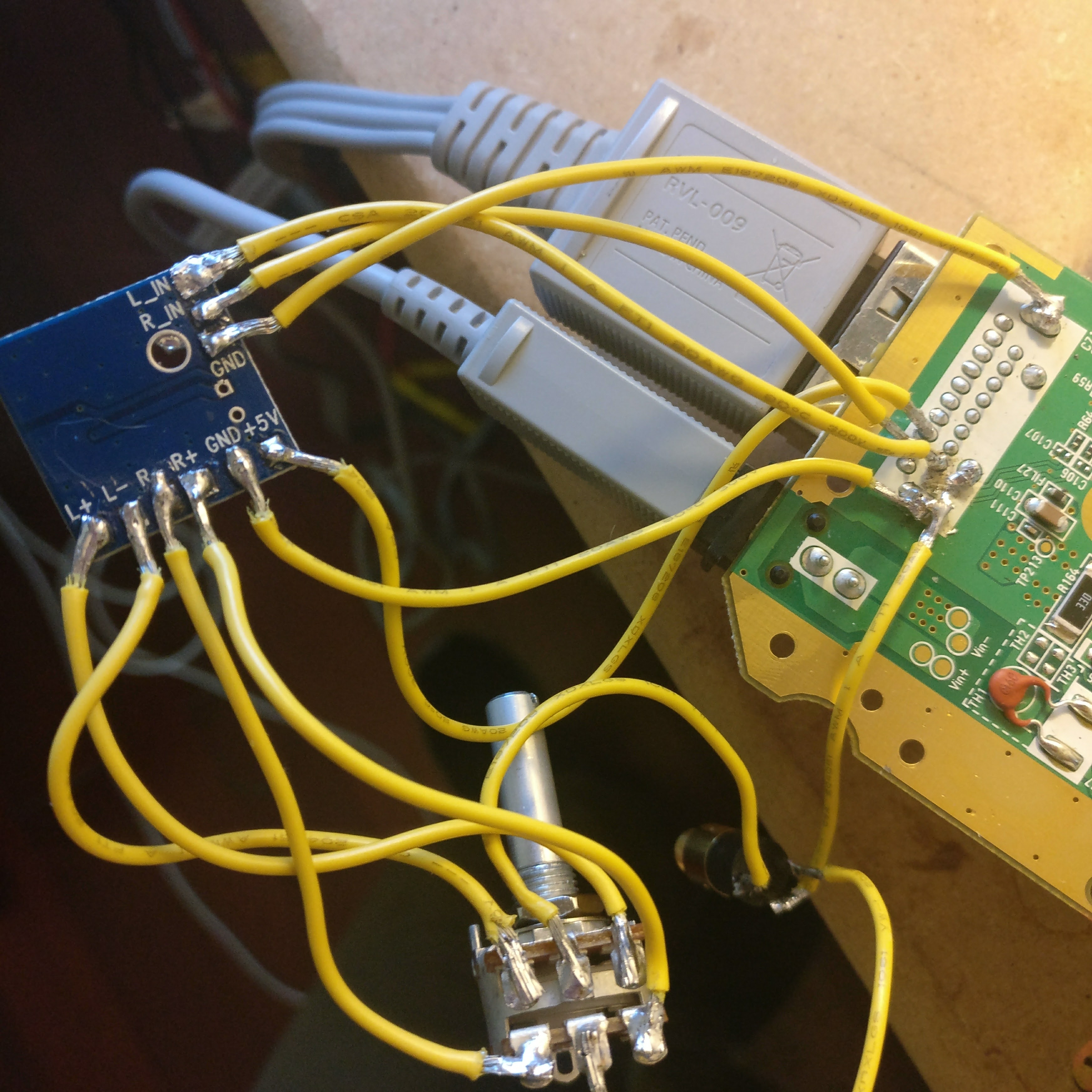

So I got a new amp, which works. I wired everything up, and it kinda works? Its definitely way louder, and no longer makes the speakers in the tv super quiet when you plug a pair of headphones into the jack. The sound comes in loud and clear in one ear, but crackles in the other. And if I turn the pot down to low volume it sounds like the crackling goes away? And then sometimes when I turn it all the way down and back up again the crackling will switch to the other ear? Not really sure what's going on here
