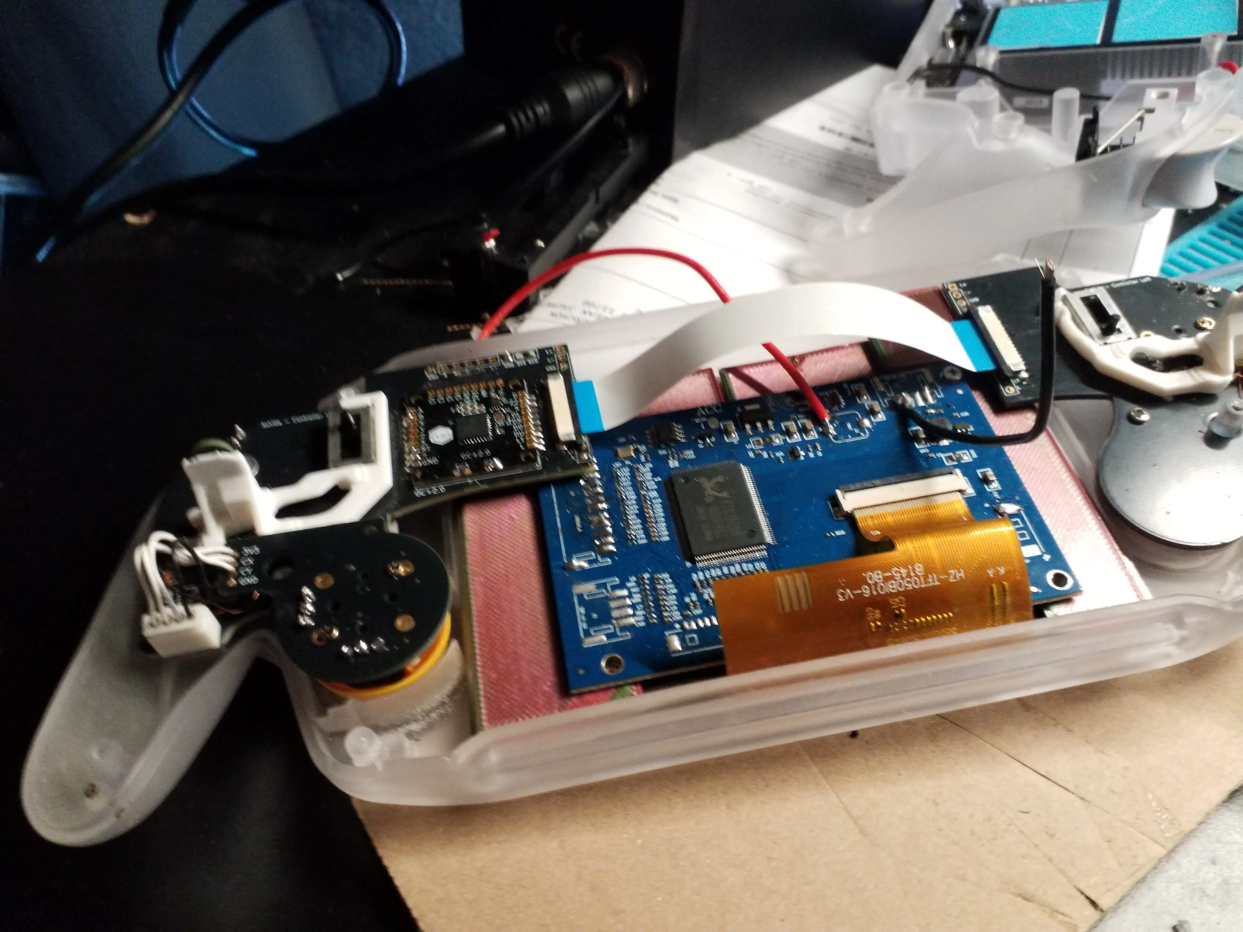

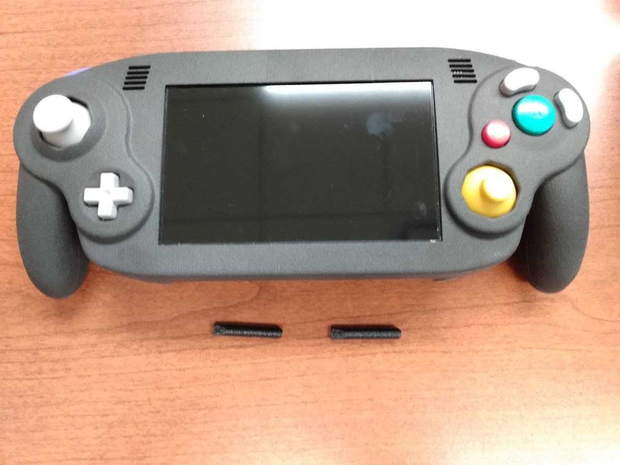

Hey guys, I had some files i wanted to share when putting together my Ashida. I hope it helps out others!

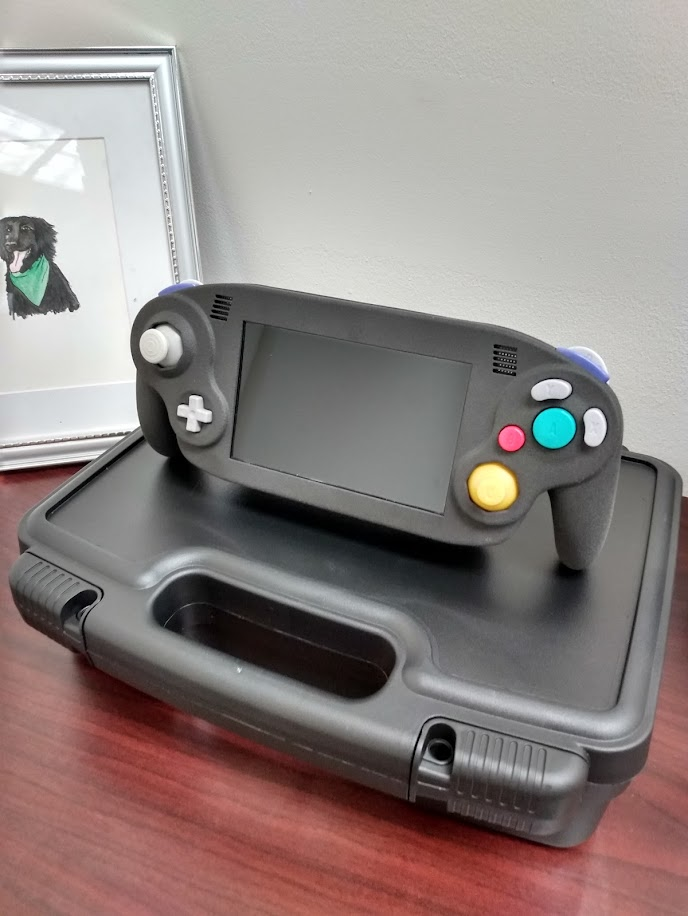

First are some portable stands, so I can prop up the Ashida on the go for wiimote games

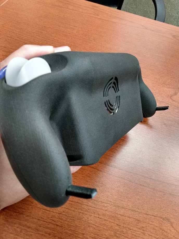

Second are some spacers for the noctua back version that plug it up so air is channeled the right way

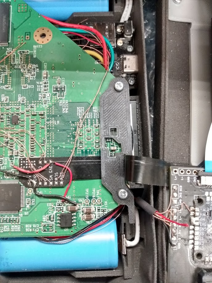

Next is a DD flex relief since I almost tore mine working inside it. it also has a little circle for wire management between halves

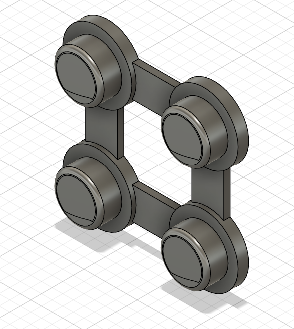

I had a hard time printing the Start and Sync buttons at JLC due to the size, so here are some that meet the minimum specs. I used a black resin

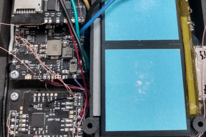

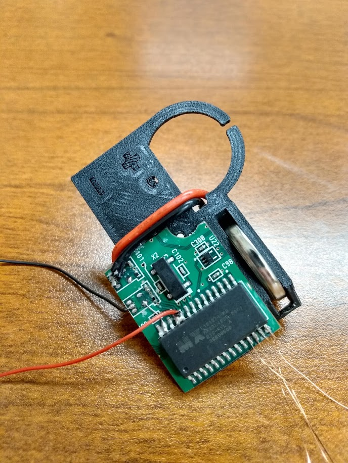

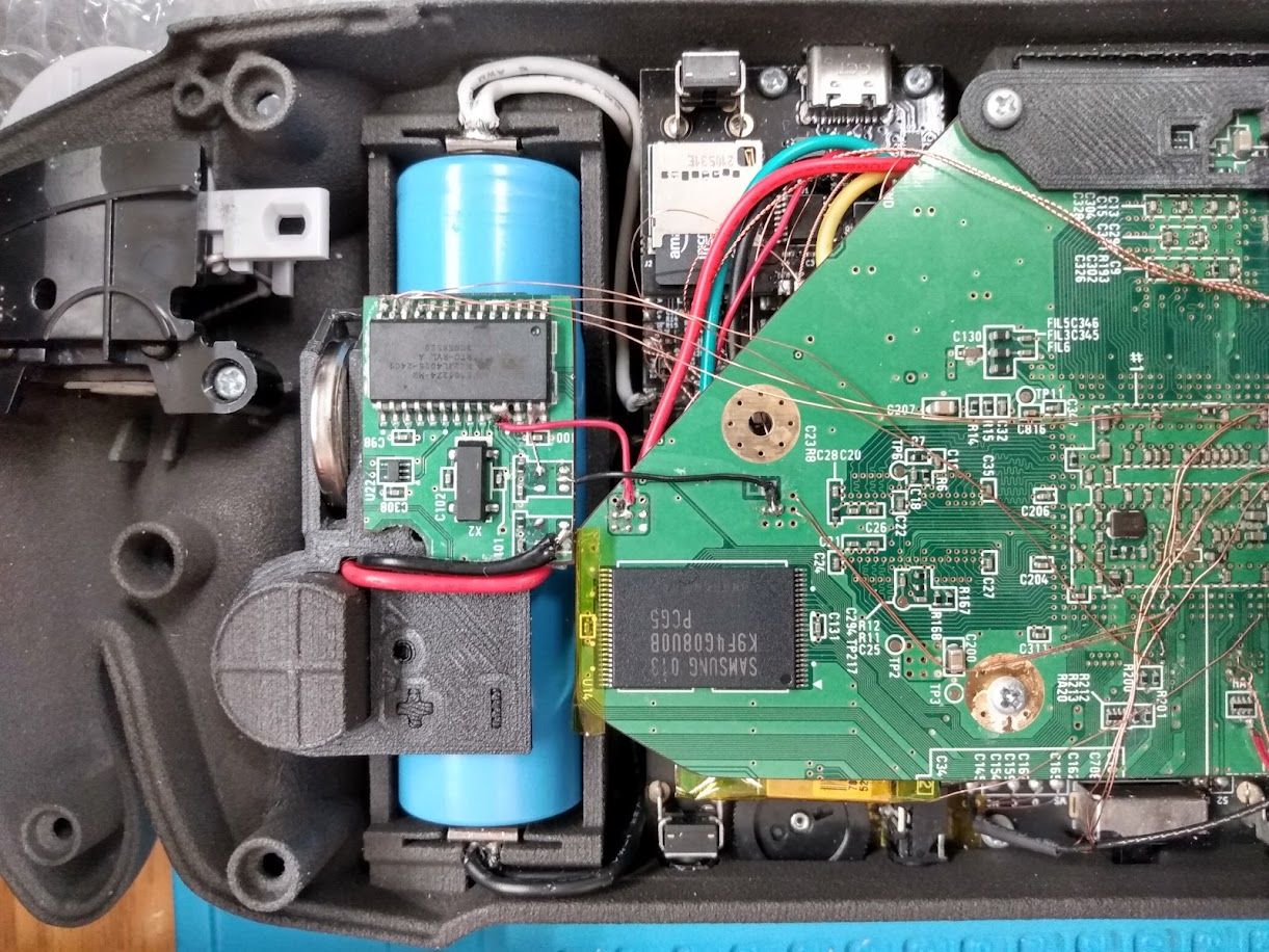

Here is a bracket that holds the MX board and has a spot to hold the CR2032 battery. you just run some 22 awg twisted wire through the holes, and use an iron to melt the ends into the side of it. It makes it easy to remove for the future but still secure. There is also a hole so you can use one of the screws with a really big head from the disc drive of the wii and hold it down.

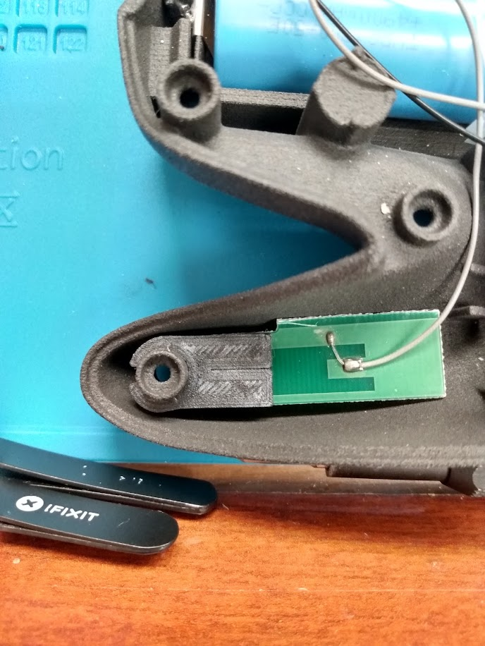

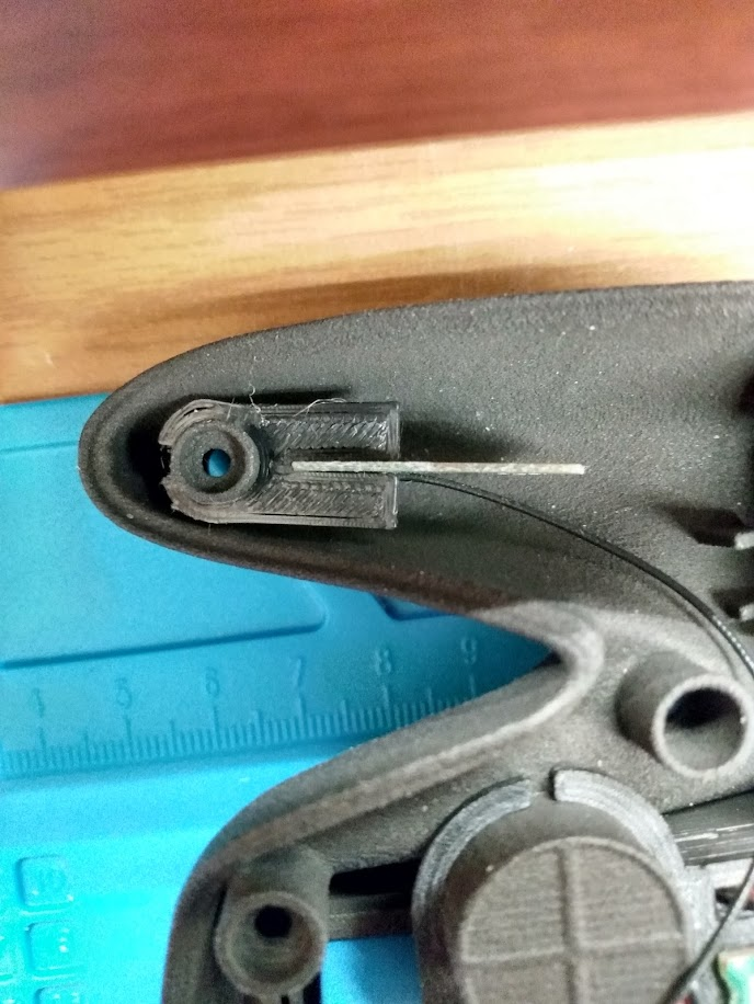

Last but not least was a simple Wifi antenna bracket, that holds them perpendicular to each other in the handles. you have to glue the one that lays flat
