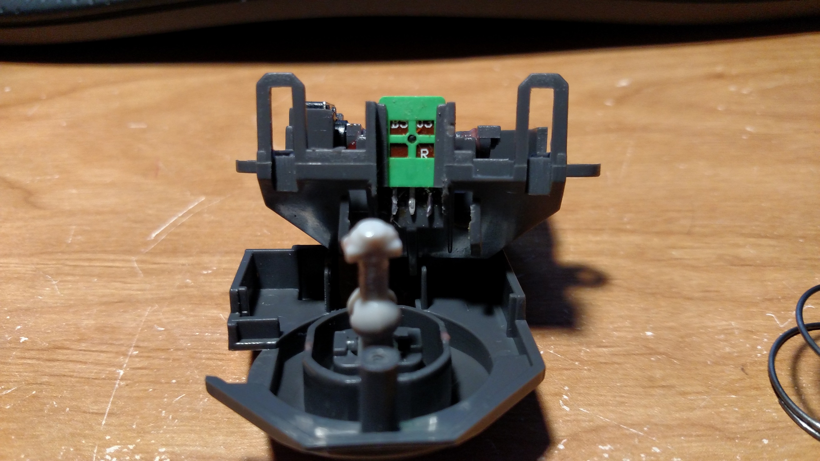

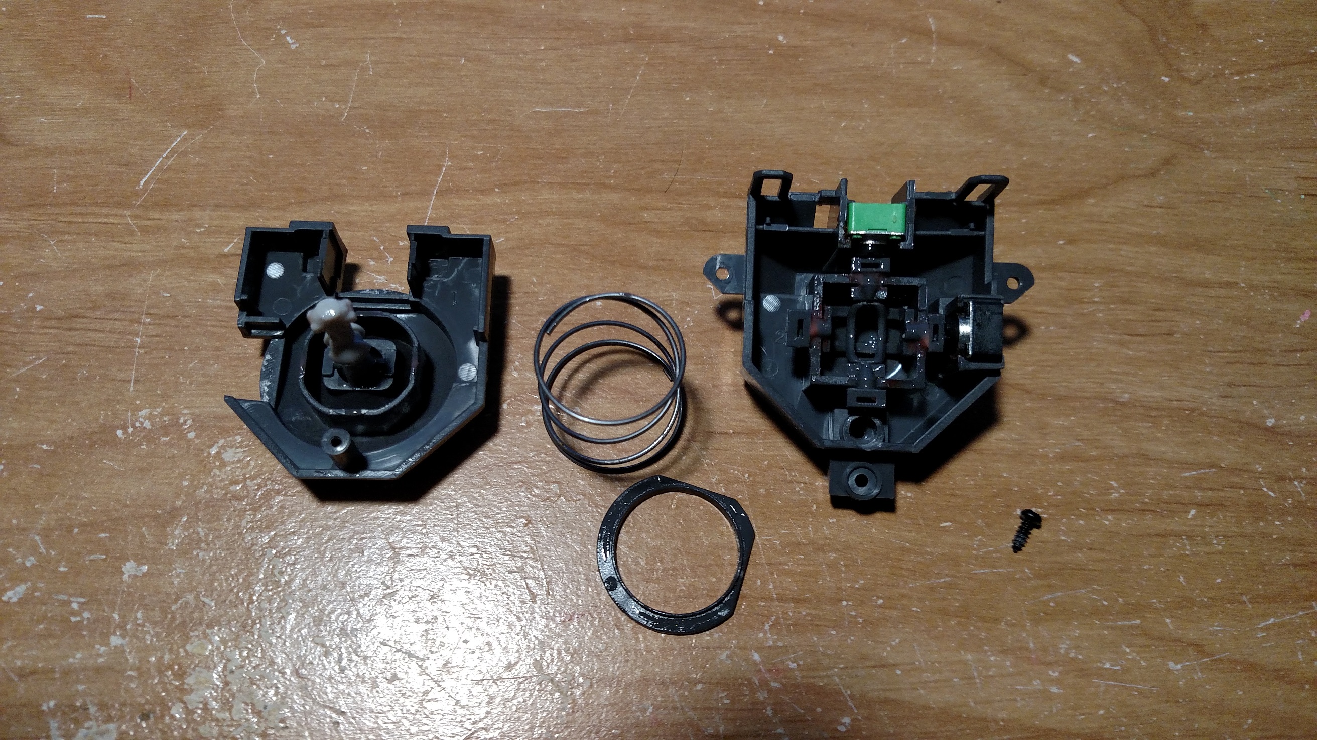

Can you open the 3rd party's joystick box and show me what the board looks like?
Yeah I can open it up and take some pics. :) From what I can see there isn't any kind of board inside though. It looks just like a regular, newer style analog stick inside oddly enough. The two bars that swing the actual stick just attach directly into what looks like an X axis potentiometer and a Y axis potentiometer.
Once our little man gets to bed here in a few minutes I will open it up... The controller is already in pieces anyway so it won't take long. :)

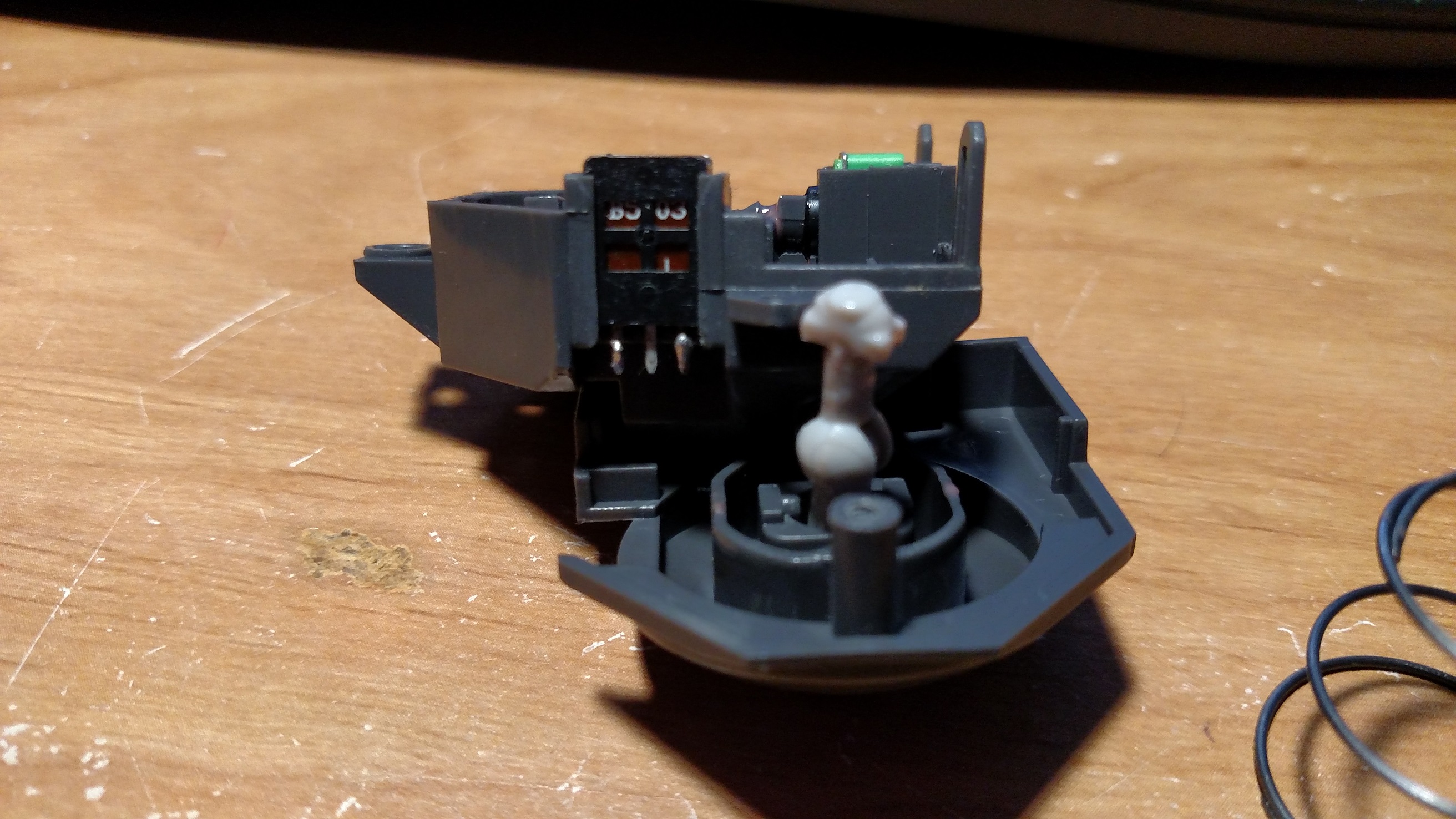

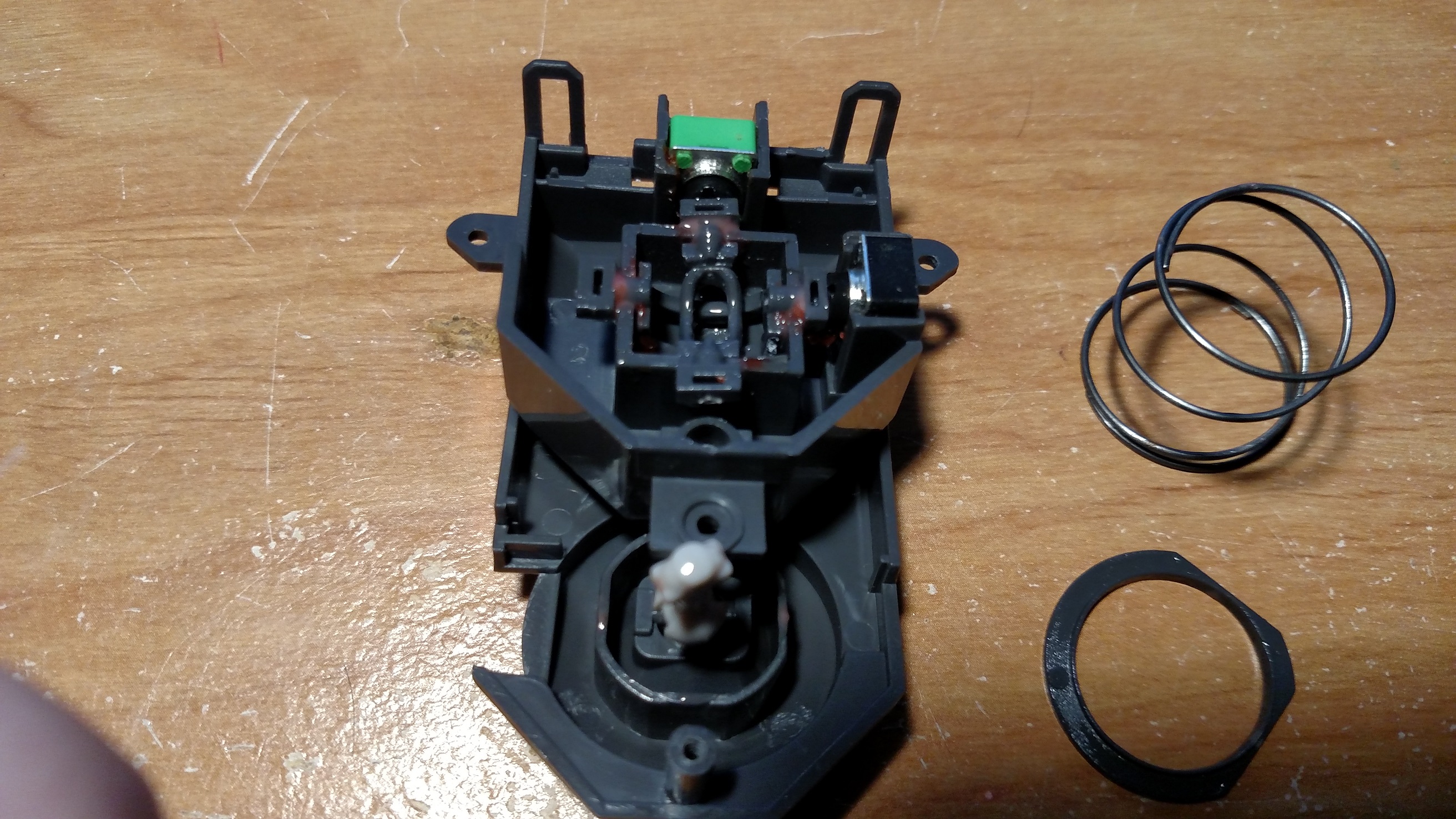

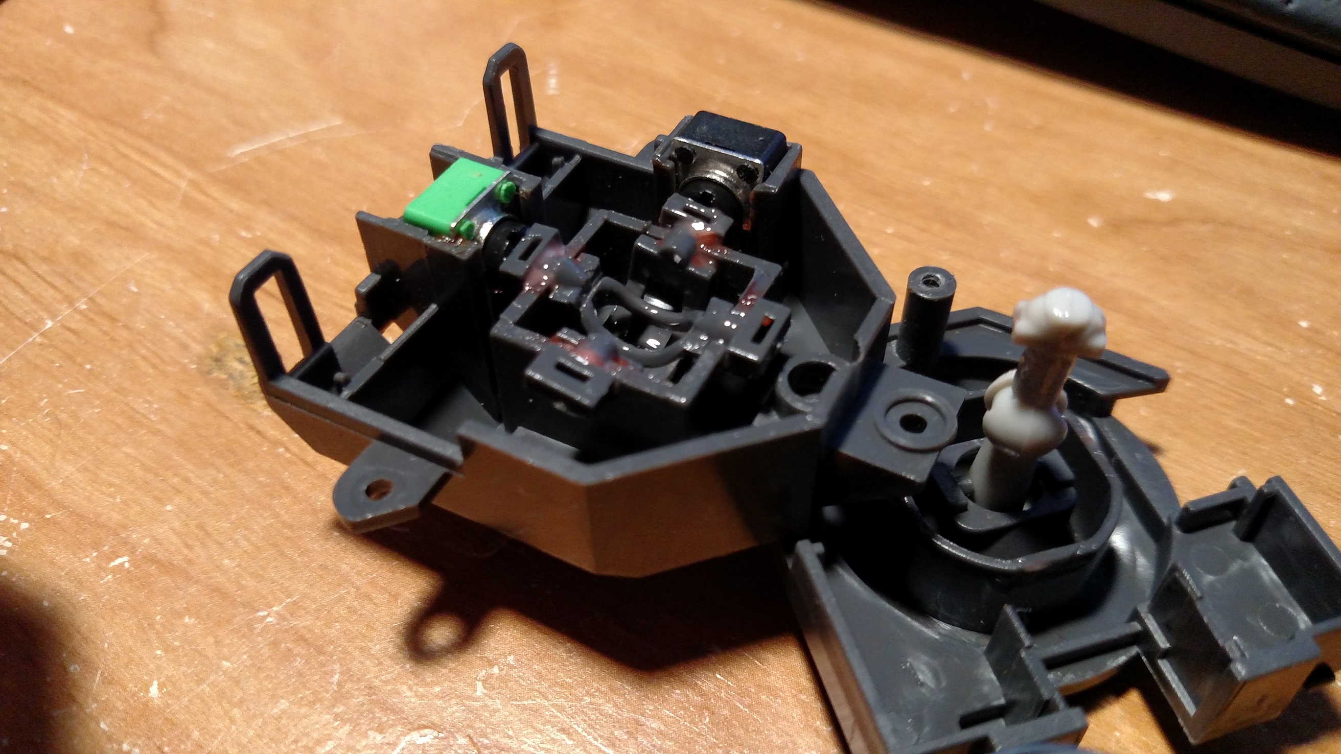

@ShockSlayer , Here are some pics of the inside of the analog stick. Let me know if you need any other pics of certain parts, I tried to get them all in there. I'm going to leave it apart for now just in case... putting it back together is a PITA, lol!!
And sorry about all the grease, I used some dielectric grease I had laying around to try and smooth it out. It did help quite a bit but for some reason the stick still seems to physically move further to the left than to the right so it's still hard to control. :\

Oh ok, I thought from the first picture than there was a circuit board inside it, but I guess it's just two potentiometers. Give me a second to figure this out, I used to deal with this a lot.

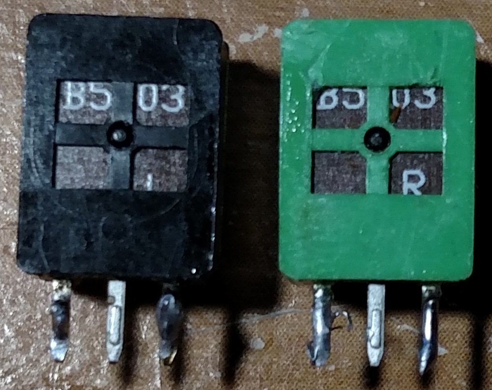

If you could get us some good pics of the text on the sides of the potentiometers, we could probably find a normal replacement joystick online somewhere. It looks like it says B303 or B505, or some combination thereof.
I tried wiring them that way, and even the opposite just to test but on both other analog sticks I got no movement so it has to be resistance values like Luke said, only think I can figure too, (thanks btw @Luke !!). Oh, and both analog sticks have been removed from their boards already so I'm connecting to them directly.
Here are the best pics I can get of the pots... there have plastic covering some of the numbers but as far as I can see they both say B5 03 on the top, the only difference is the color of the plastic and that the Red one has a letter "L" on it and the green on has a "R" on it. I can always try and cut away some of the plastic if needed to get a better look though... I tried on the green one but the numbers are so close I'm afraid I will end up scratching the number off if I'm not careful.
From doing a quick Google search it looks like they are 50K OHM Potentiometers... now to just find a 50K OHM analog stick... lol!!

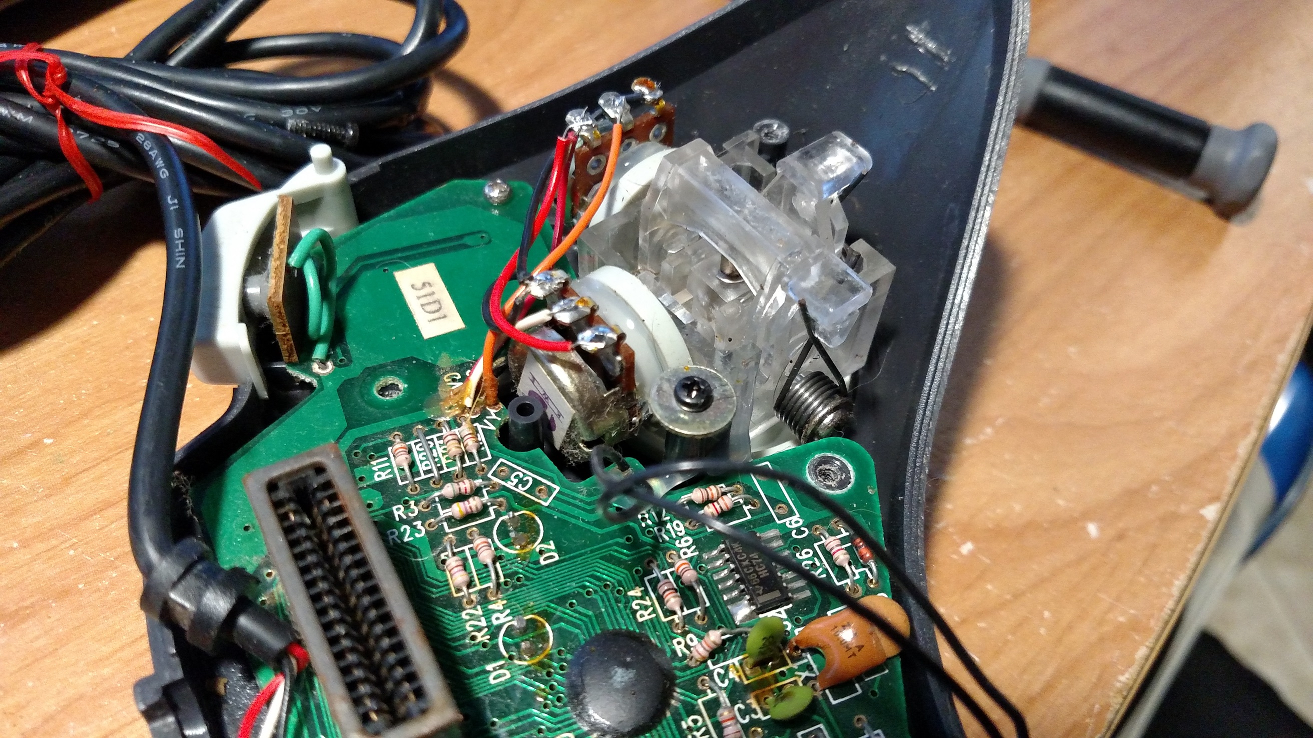

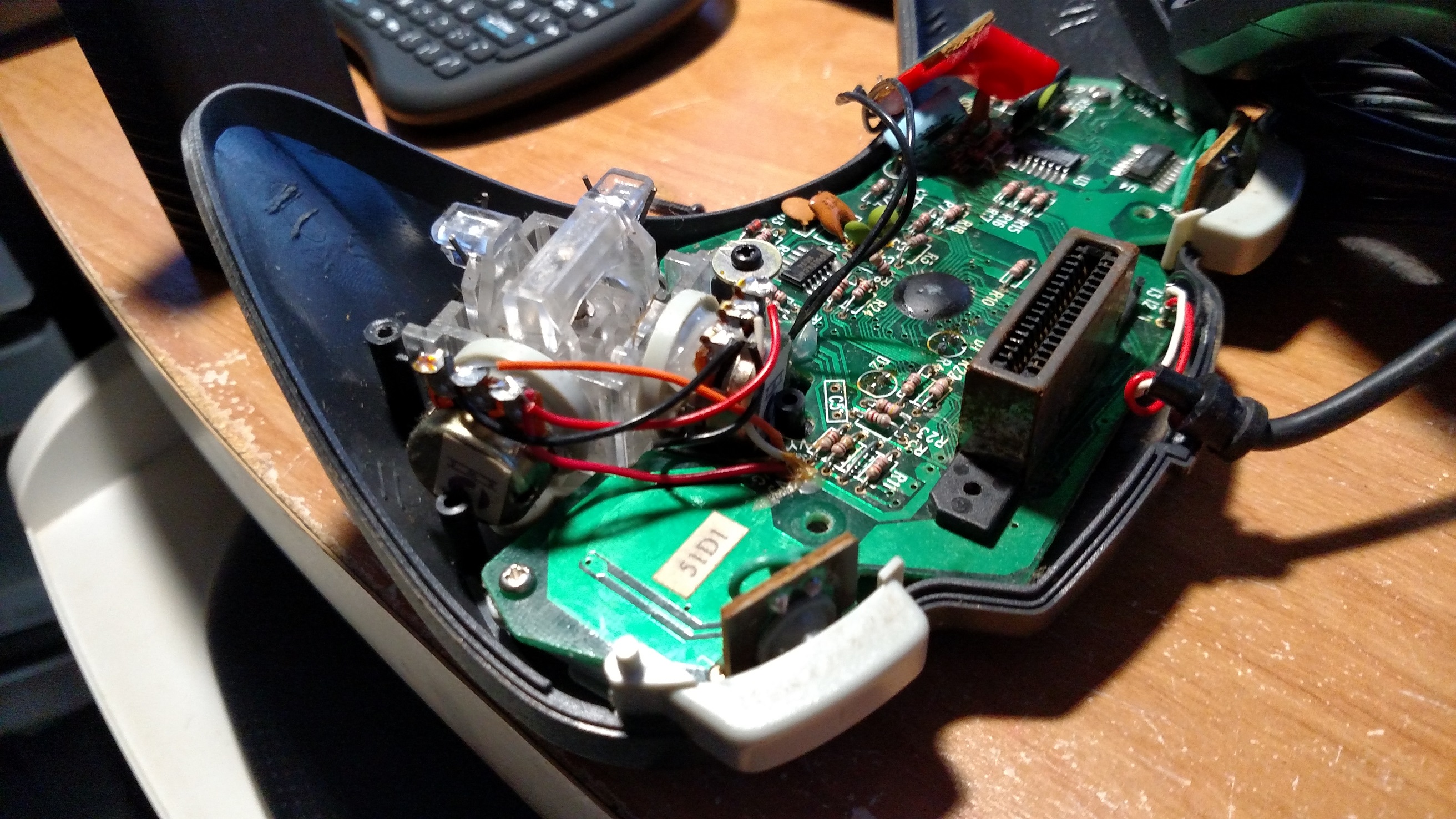

Just got the SuperPad 64 Plus a few minutes ago and I got to say... "Holy overly complicated analog sticks Batman!!!"
Looks promising for a MUCH smaller GC style analog style transplant... the funny thing is this stick actually feels and responds really well, it's just HUGE with the full size pots in it. I can say that all the buttons suck though, not a big deal since they're all going to be replaced anyway but they just all take a really hard press for them to actually work, lol!! :D
