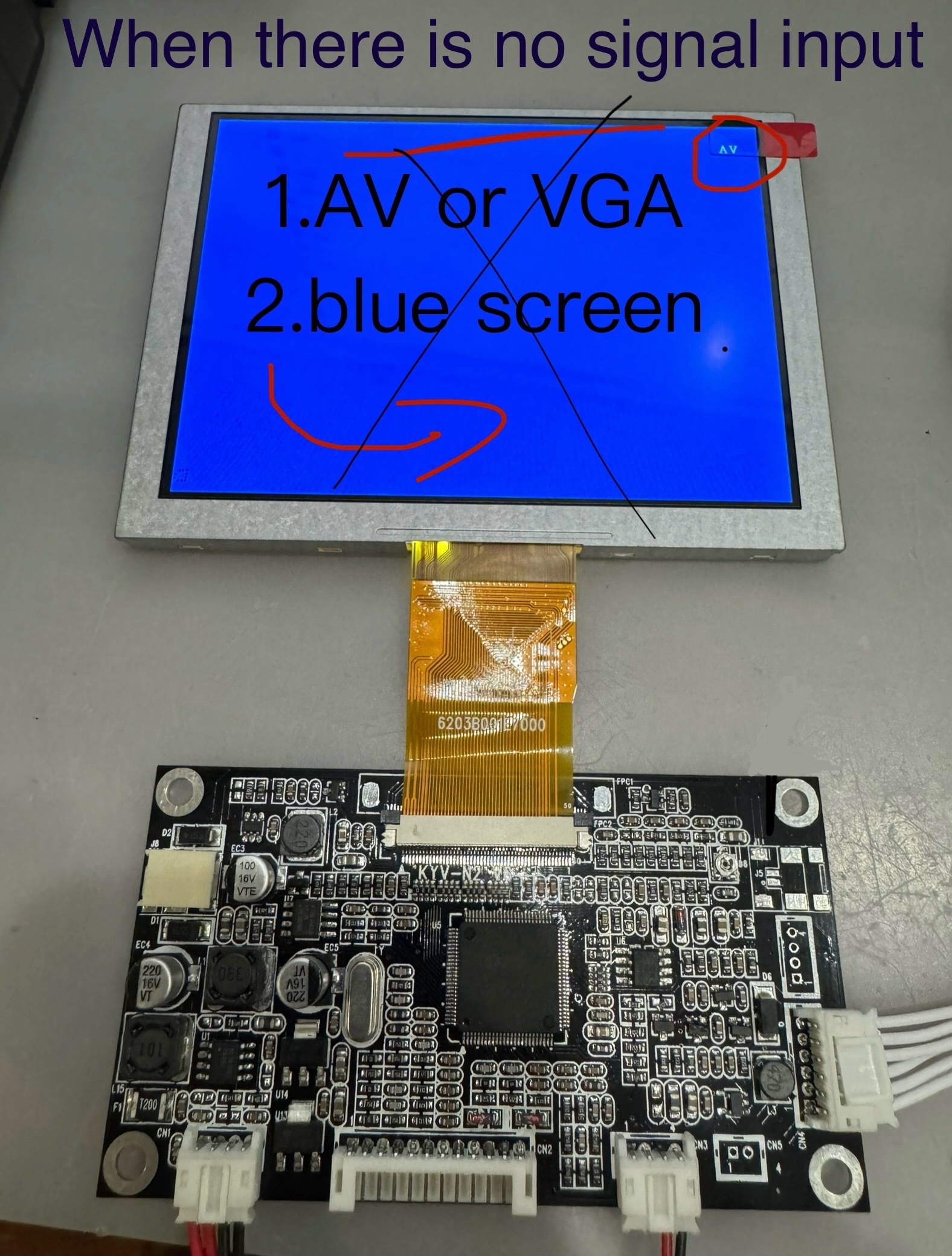

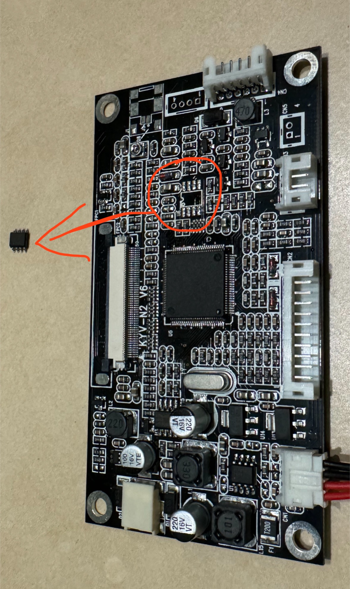

tzmwx . Joined May 29, 2019 Messages 71 Likes 378 Location China Portables SEGASATURN Portable PLAYSTATION Portable Nov 21, 2023 #1 KYV-N2 V6 PCB ZJ050NA-08C 5”LCD CH341 programmer When there is no signal, cancel the Blue Screen and display channel code (AV and VGA)function Attachments 5lcdNObluescreen.rar 5lcdNObluescreen.rar 45 KB · Views: 219

LCandell . Joined Jan 27, 2023 Messages 95 Likes 55 Location MX Portables 3 Trims, 2 Portables, 2 Tabletop Feb 9, 2024 #3 When there is no signal, cancel the Blue Screen and display channel code I think is for keep the screen totally black
Stitches 2 and a Half Dollarydoos Staff member . . . Joined Feb 5, 2017 Messages 4,646 Likes 3,592 Location Banana Bender Land, Australia Portables 6 Feb 9, 2024 #4 So that you don't get flashbanged by the blue when the system is first turned on
