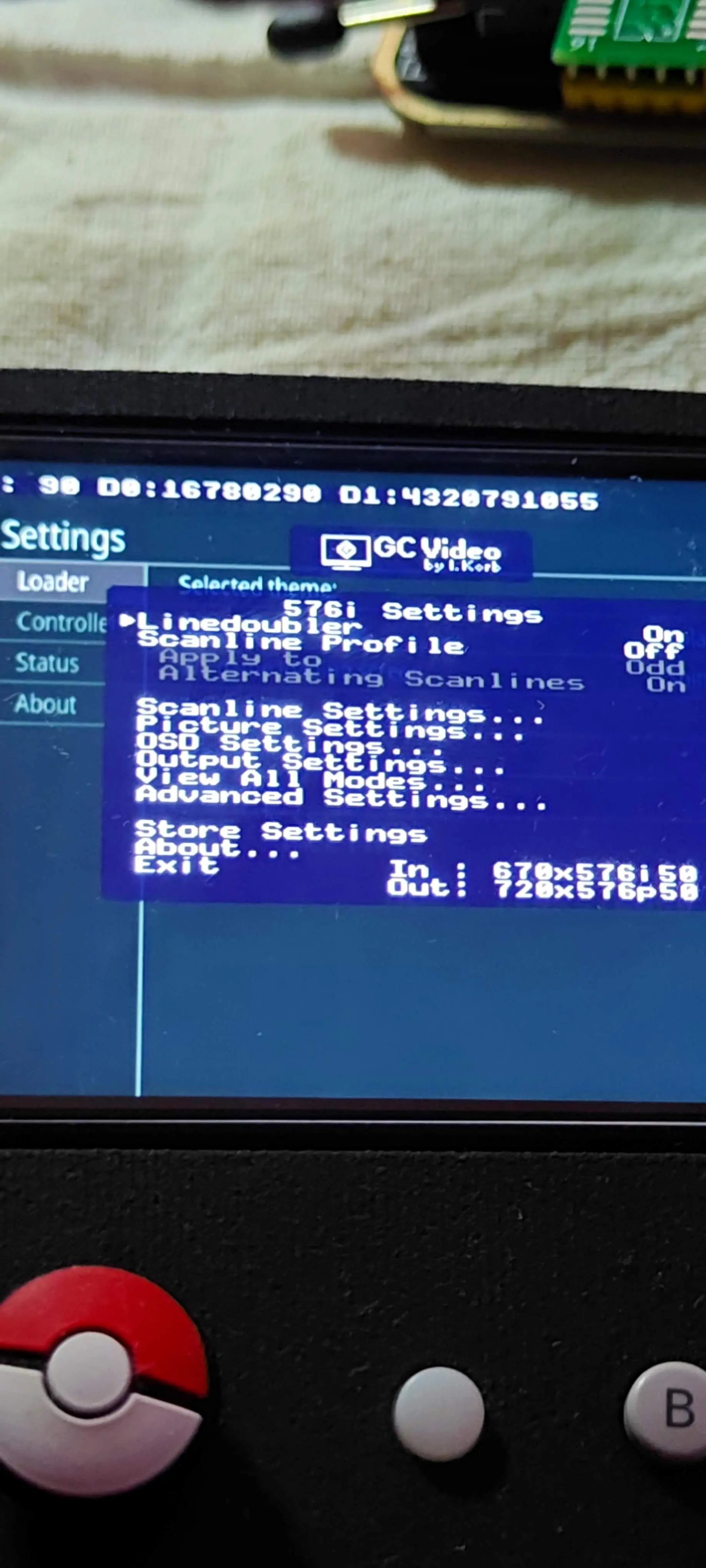

Hi guys, I was tinkering with my portable again when I wondered if, after all these years, I could finally break down the compatibility barrier between GC+ and GCVideo. I started by modifying the GC+ and actually had some success—I managed to open the OSD menu (using the L2 button injection combo), but couldn't do anything else. So, I decided to tackle the second major challenge: setting up the virtual environment and compiler for the GCVideo FPGA. The initial tests went much worse than the GC+ side of things... I went back and forth between the two without much luck, until I decided to search online for something conceptually relevant to the work I was doing. I studied how the GameCube controller communicates, the timing, and so on. I returned to the GC+ and finally managed to navigate the menu; it’s not perfect—you have to press the button multiple times or hold it down—but it works. It’s a bit clunky, but it’s better to be able to use it with a few quirks than to have it completely dead or non-functional.
I’m attaching some test results I had saved; it seemed worth sharing them for anyone interested in the details—specifically, what modifications are needed in GC+—as well as for those who just want the latest compiled firmware (@Aurelio , let me know if this is an issue and I’ll delete it).
Since these are GC+ side modifications, there could potentially be issues with the games themselves, but for now, everything seems to be working correctly, just as before. Naturally, use it with care—it still needs thorough testing.
Getting the GCVideo OSD working with a GC+2.0 (Fujiflex) — Technical Report
## Summary
On a portable based on [Fujiflex] - (GCVideo) featuring controller emulation via [GCPlus-2.0], the L+R+X+Y button combination used to open the GCVideo OSD menu failed to work. This is a known issue that has been documented for years without a public solution.
**Identified cause:** The bit period generated by the GC+2.0 during transmission (`T2PR` in `si.c`, which drives the CLC/SPI clock used for output) is not optimal for sampling by the GCVideo `PadReader.vhd` module, even though it is "correct" according to GameCube protocol documentation (4µs/bit, as confirmed by [Jeff Longo] using a logic analyzer). Slightly compressing the period compensates for a sampling bias specific to this HDL synthesis.
**Fix:** In `si.c`, change `T2PR` from `0x1F` to `0x1B` within `SIConfigureCLC()`, **combined with** a reorganization of the main loop to minimize and stabilize the command-to-response latency (see the dedicated section below). Both modifications are required together; changing `T2PR` alone, while using the stock main loop, is insufficient.
Original symptoms:
- Holding L+R+X+Y on the GC+2.0 never triggered the GCVideo OSD—neither with a quick press nor a long hold (even 3+ seconds).
- The exact same input, when read by RVLoader/homebrew (using the Wii's standard SI stack rather than GCVideo's dedicated sniffer), always registered correctly.
- An original GameCube controller, used with the same GCVideo unit, opened the OSD normally on the first attempt.

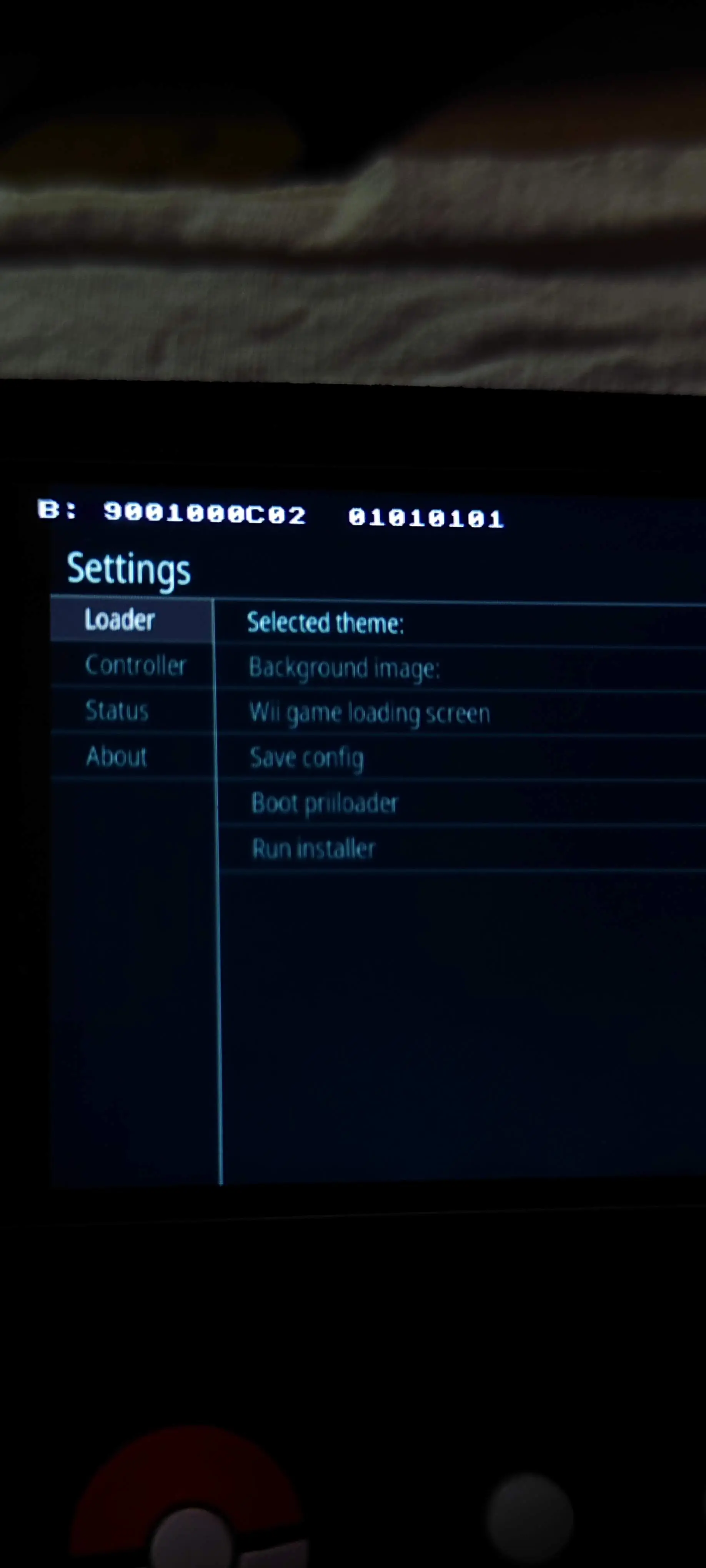

By measuring `PADREADER->bits` using instrumented GCVideo firmware, it was observed that **at idle, the packet is consistently truncated at 9–17 bits** (well before the full command, which requires 25 bits)—too early to be a timeout issue, and too consistent to be random noise (confirmed by (6); the Deglitcher made no difference)
**Experimentally verified margins:**
Note: the original value (`0x1F`) corresponds exactly to the 4µs/bit documented as the protocol standard by Jeff Longo—it was not a design flaw in the GC+2.0. The fix most likely compensates for a sampling bias specific to the HDL synthesis of `PadReader.vhd` on this particular GCVideo firmware/board, rather than an error in the protocol itself.

## Hypotheses tested and discarded
During the investigation, the following leads were systematically verified and **all ruled out** via direct testing (measuring `PADREADER->bits`/`paddata[]` using on-screen debugging on a custom-compiled GCVideo build):
1. **Packet content** — direct injection of L+R+X+Y/D-pad bits, bypassing GC+ debouncing: the button combo worked (with sustained repetition), but the D-pad never did.
2. **"Clean" vs. abrupt release** — progressive release ramps on analog axes: no effect.
3. **GC+-side debouncing** — verified not to be the cause (the D-pad works perfectly everywhere except in the OSD).
4. **GCVideo cross-debounce filter** (`prev_data`) — removed: no improvement.
5. **"One packet per video frame" gate** — removed: no improvement.
6. **Deglitcher.vhd** (noise-filtering front-end, `CompareBits`) — increased from 2 to 6: no change in measured values, ruling out ambient electrical noise as the cause.
7. **Bit-banging the transmission** inspired by [ProCon-GCC-PIC18]: introduced new instabilities (corrupted ADC readings) without solving the underlying issue; abandoned.
8. **`T6PR`** (receive command-end timeout, 5µs) — any reduction, however slight (e.g., 4.5µs), completely breaks command reception; **must not be altered**, as the 5µs margin is already at the structural minimum.
## The root cause and the fix
C
void SIConfigureCLC(void) {
T2PR = 0x1B; // was 0x1F — slightly reduces the generated bit period
- - `0x1B` (27 counts, ~1.75µs base unit): **stable**; OSD opening and navigation work.
- - `0x1A`: borderline; behavior unreliable.
- - Below `0x1A`: complete communication failure.
- - Above `0x1F` (original value, theoretically "correct" according to the protocol): the OSD never recognizes the packet.
## Reordering the main loop (necessary, not optional)
Experimentally verified: **reverting to a completely stock `main.c` (original loop, with `T2PR=0x1B` still present in `si.c`) causes the OSD to stop opening**—even when using the physical L+R+X+Y combo. `T2PR` alone is not enough.
Explanation: `T2PR` corrects the *duration* of each transmitted bit but does not eliminate variability regarding *when* transmission begins relative to the received command. In the stock loop, before responding, the firmware proceeds from port reading → `buttonsUpdate()` (debounce) → rumble handling; each step introduces a variable delay that translates into phase jitter when restarting Timer2 (which generates the transmission clock). `T2PR=0x1B` compensates for GCVideo's sampling bias only when this startup phase is reasonably consistent.
The necessary reordering within the main `while(1)` loop:
1. `SIGetCommand()` checked first, prior to port reads/`buttonsUpdate()`.
2. For `SI_CMD_POLL`: `SISendMessage()` called **before** handling rumble (`rumbleSpin`/`rumbleBrake`/`rumbleStop`), not after.
## Final Result
With **both** these changes (`T2PR = 0x1B` in `si.c` + main loop reordering; the rest of the firmware remains stock GC+2.0):
- The OSD opens reliably using either the physical L+R+X+Y combo or via emulation.
- D-pad/X/Y navigation works ("semi-smooth" quality: a second press is occasionally required, likely due to a residual timing margin not yet isolated).
No changes on the GCVideo side (HDL or firmware) proved necessary for the definitive fix—all modifications explored there were ultimately reverted.
