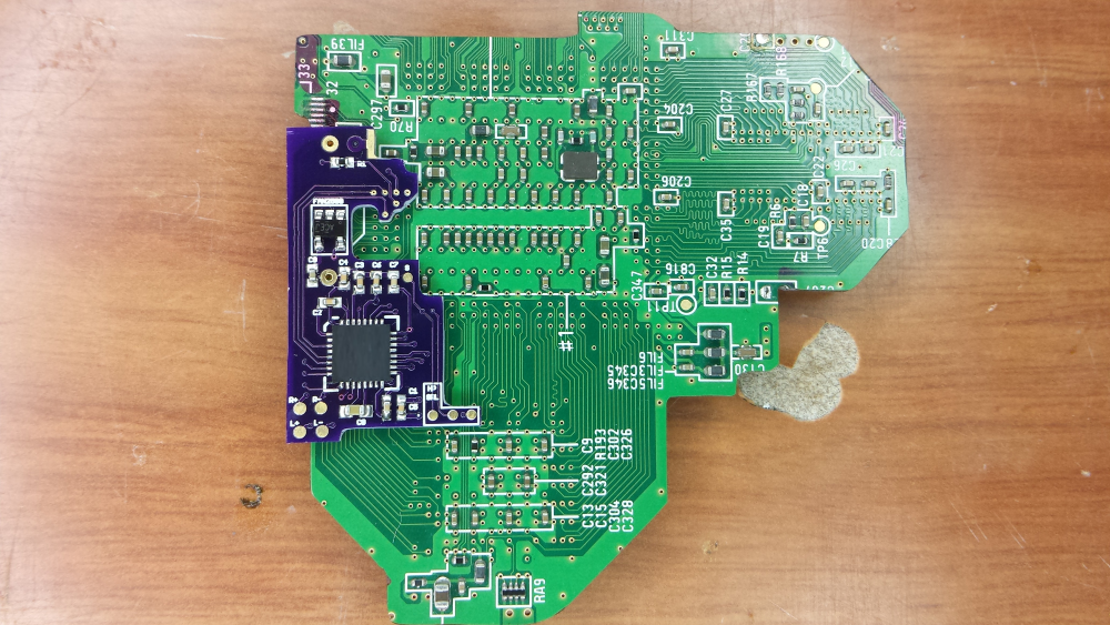

After having @ShockSlayer testing 50 (thanks <3) or so IOS builds I finally got few things working. This is a little demo video showing the overlay and the gamecube controller hook working in a Wii game (yes, that's the Wii version of Zelda Twilight Princess):
The audio amp specifically designed to work with WiiHUD is ready and it's working. We've been doing a lot of tests in the past few days. This amp works straight from Wii i2s digital audio for better quality (also removing the needs of the AVE if used along with GCVideo), it has an internal Class G amplifier for headphones (with automatic switching when plugged in) and it is completely driven by WiiHUD, allowing the user to change the volume just by using buttons combinations on a GameCube controller.
ShockSlayer is going to do a stream in the next few hours showing the board and how it works.

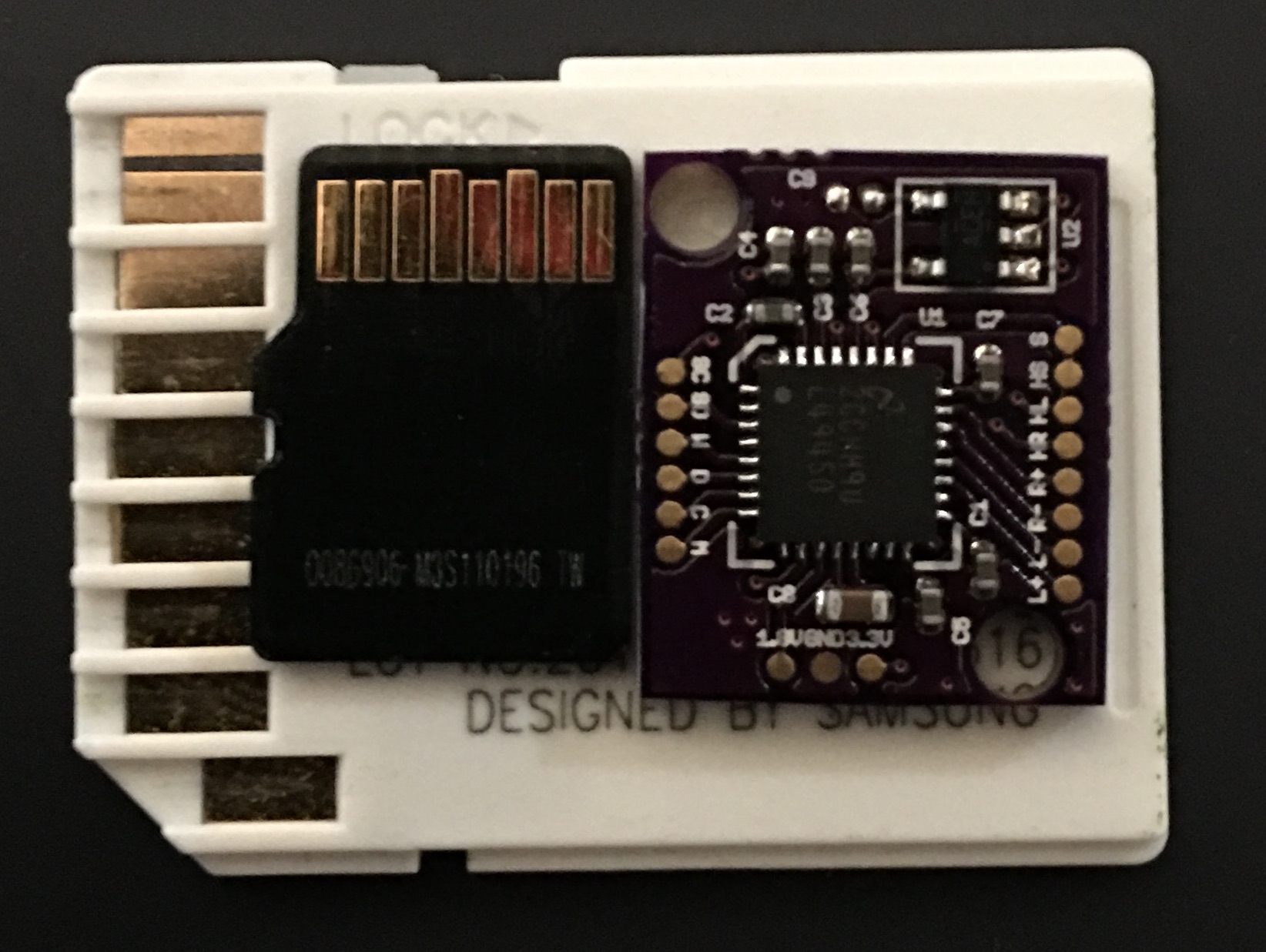

PS: Maybe the picture is not clear enough, but this thing is really tiny, it's just 17.04 mm x 28.22 mm

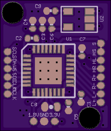

This is probably the final design of the audio amp. This board is probably the smaller board I've ever designed. It is 13.36mm x 15.75mm, you can fit this wherever you want :D
