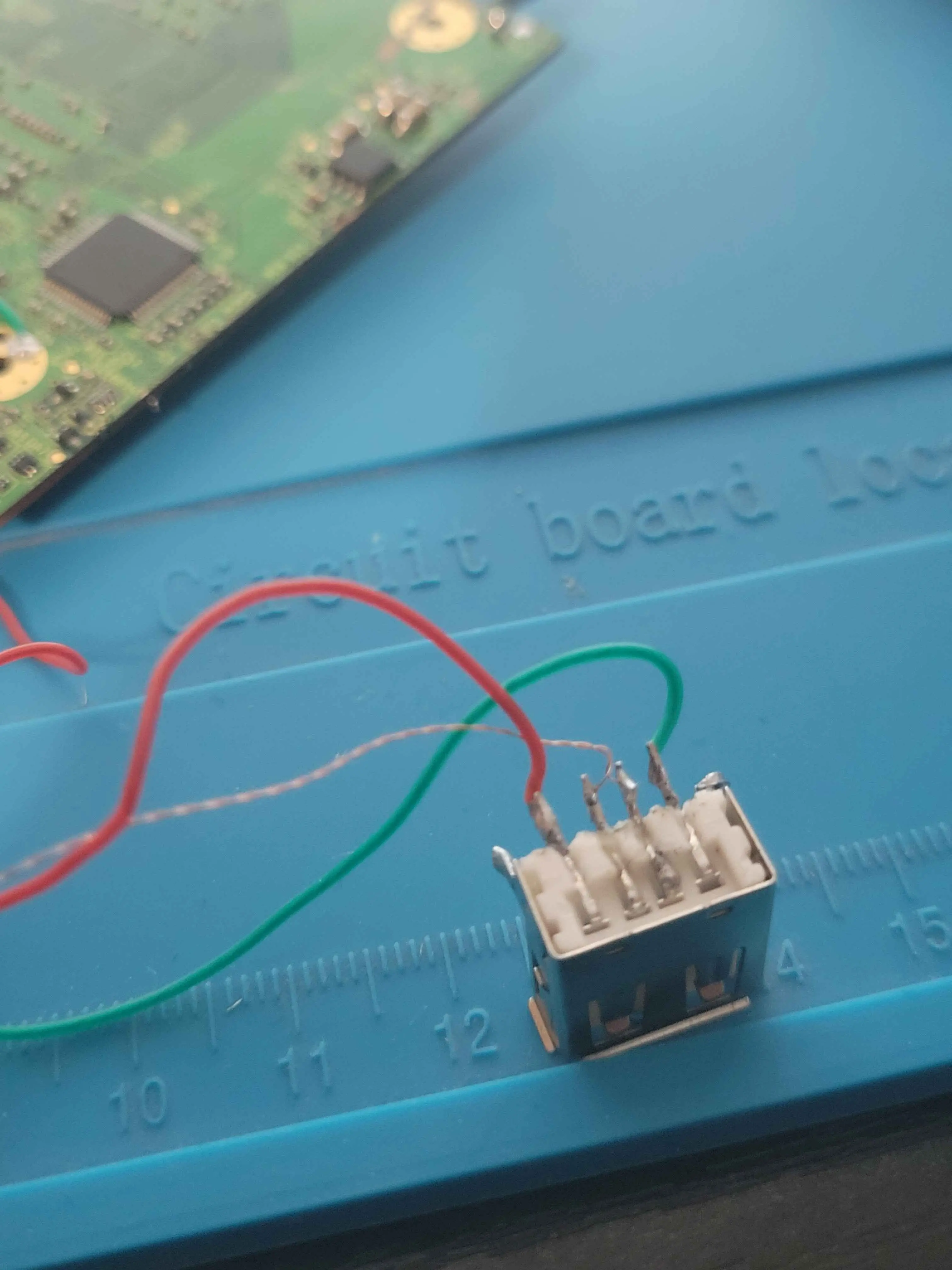

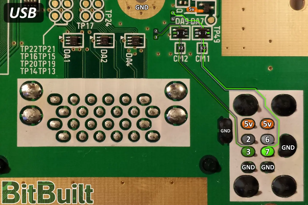

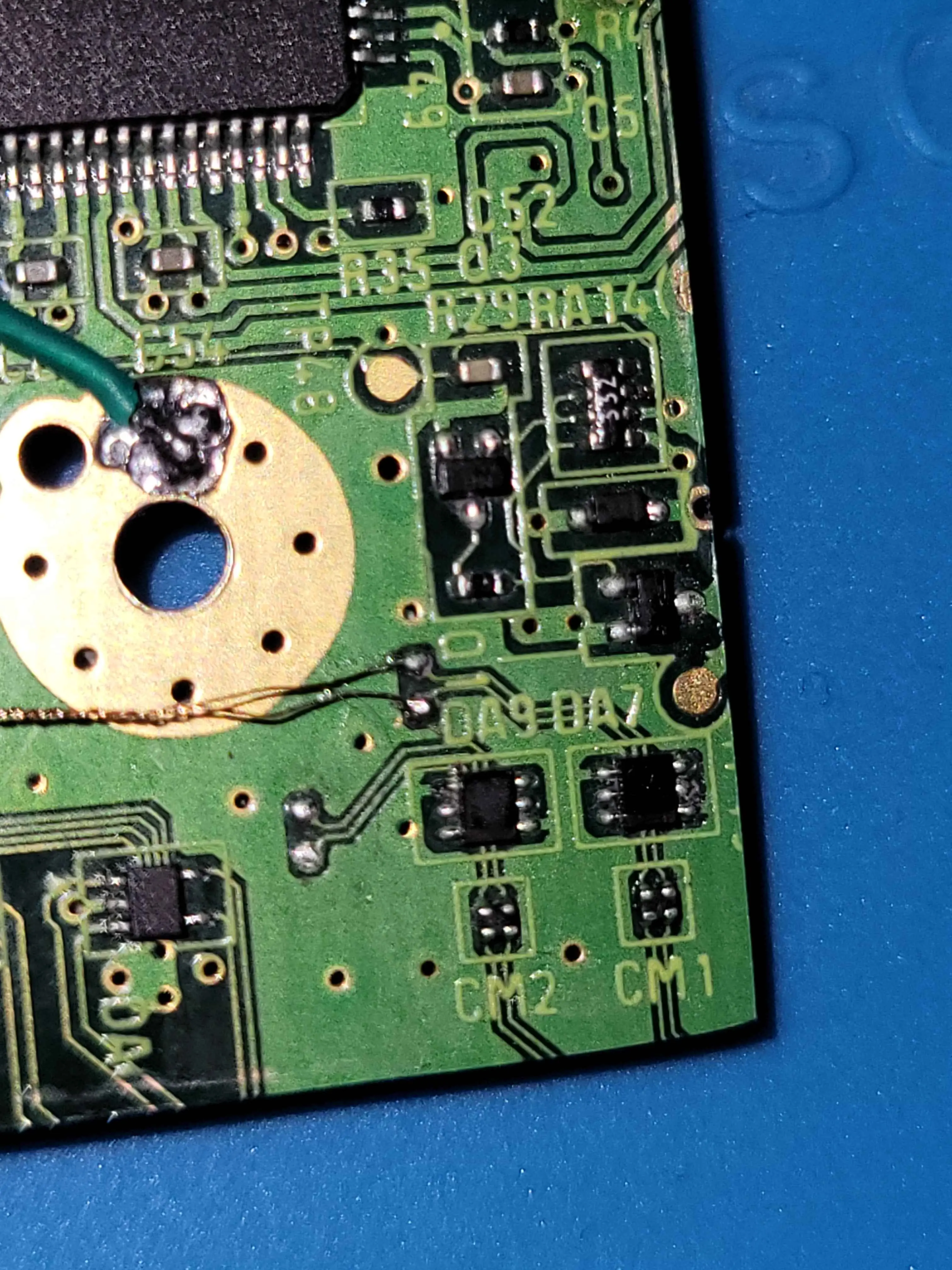

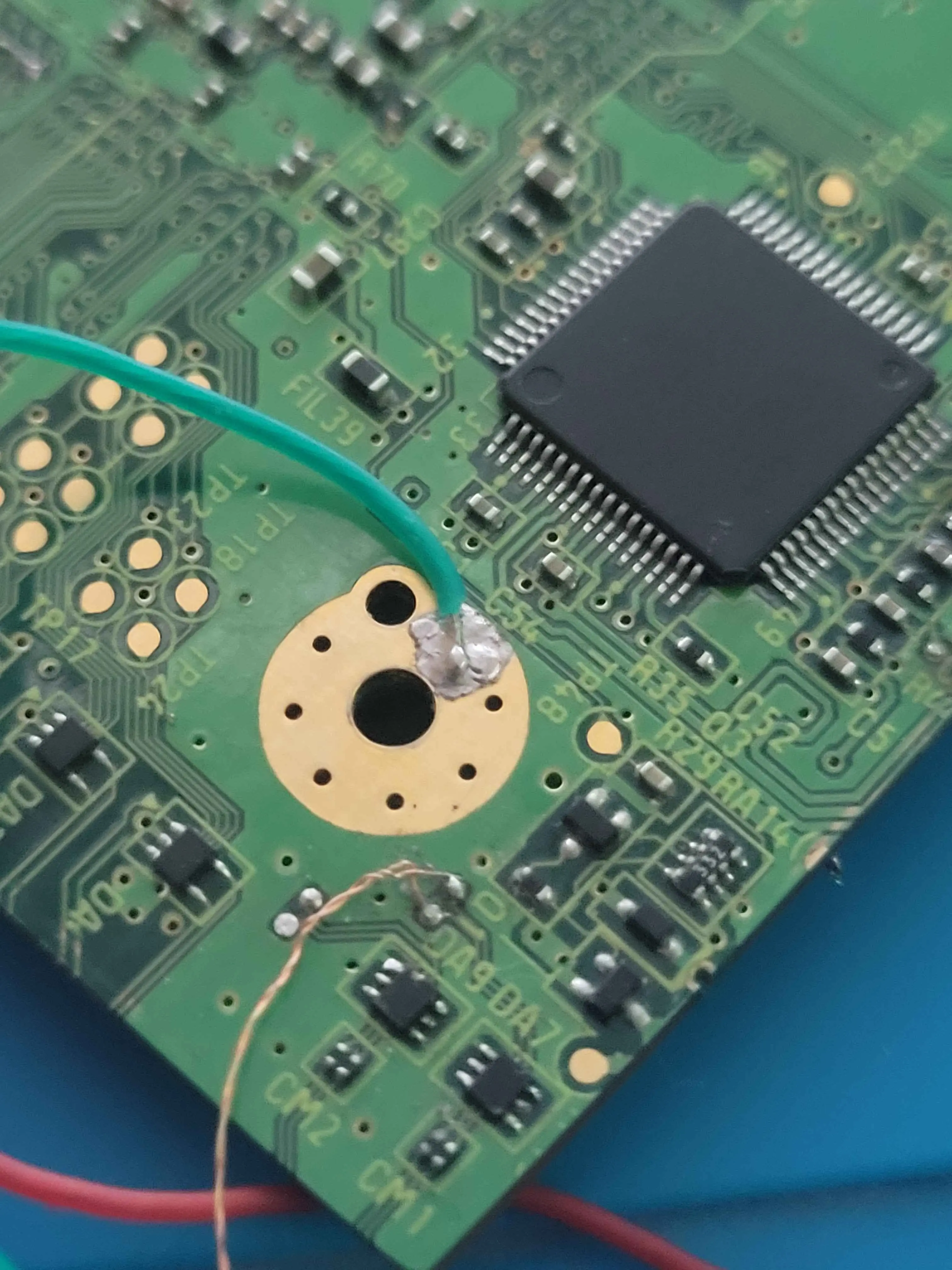

I've shortened, twisted, and resoldered these usb wires for a long time and my USB still isn't working on my Wii trim. I'm using 32 awg magnet wire, twisting it extremely tight with a drill, soldered it to the 2 different sets of vias multiple times, and I even desoldered a spare USB 2 port and soldered directly to that but no matter what my USB just refuses to work. I don't really know what to do anymore and I think i might just use SD if thats possible. The only things connected to that trim right now is the RVL-PSU and my Bluetooth relocation. Any help would be extremely appreciated as it would suck to have to get another Wii or something and try again. I can't take new pictures right now so here's an example of what my wires look like right now from earlier, when I was trying to troubleshoot in the BB discord.
