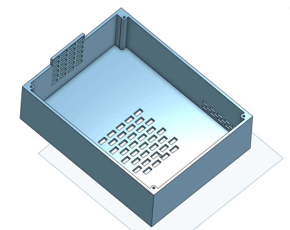

I am terrible at 3D CAD, so it took about 2ish days to get here. Getting a little better at least. Everything done so far has been done with OnShape. I don't think I'll ever have the brain power for a full on portable though.
The main goal is to have a use for the LOLWUN. I don't want to have documented everything about them go to waste..
It'll still work for LOLWUT's.....but why would you waste one on this?

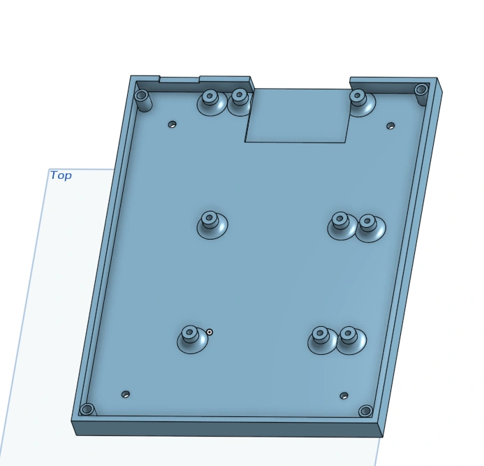

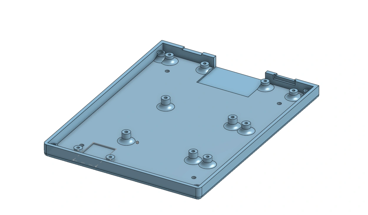

I think atp I'm done with the bottom half of the shell:

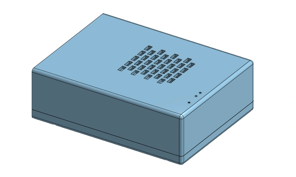

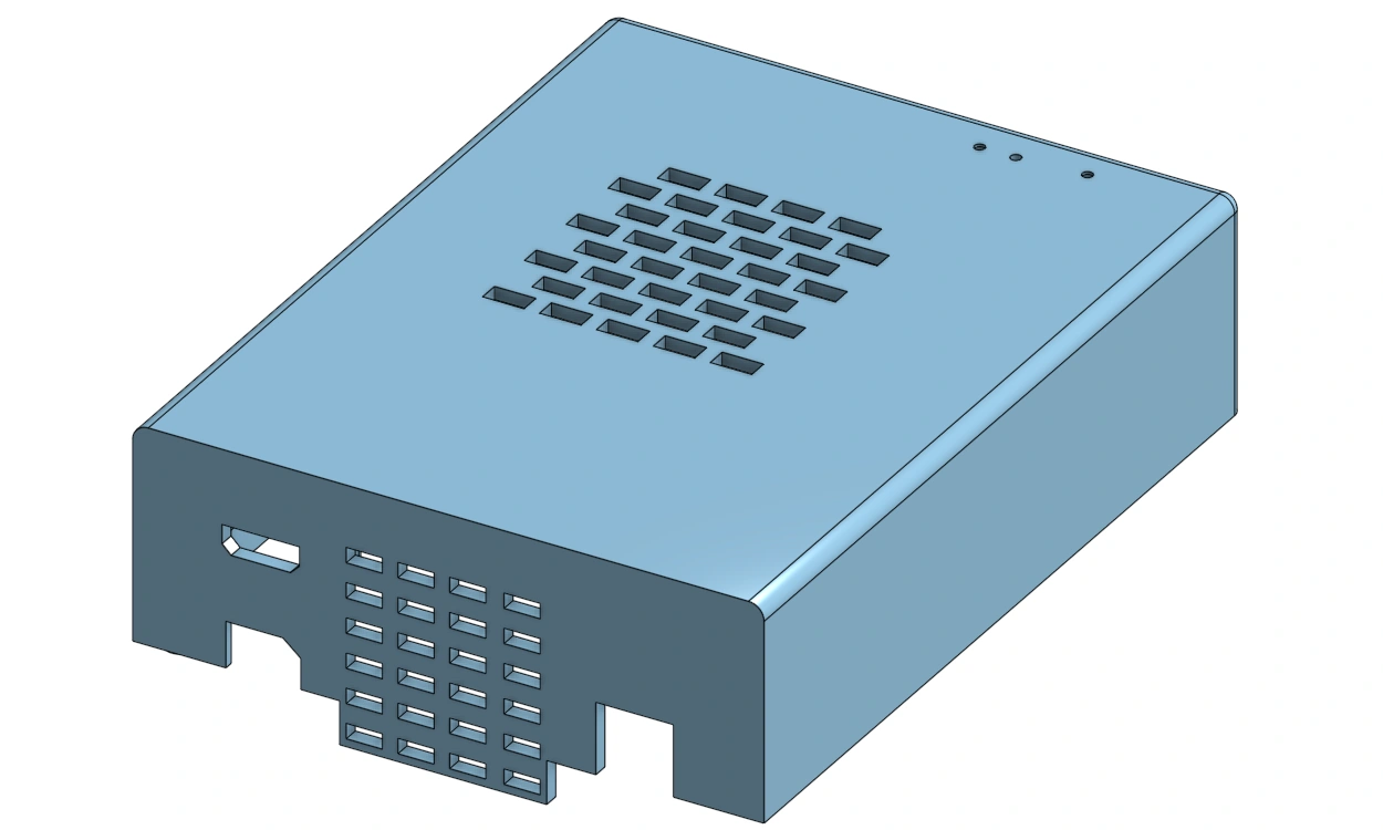

And working on the top half:
Right now it's just cooling holes (and that's not even done). I do want to have the power/eject buttons and all of the LEDs up there just so I have have my status indicators.
HDMI and power input will probably be mounted up there too.

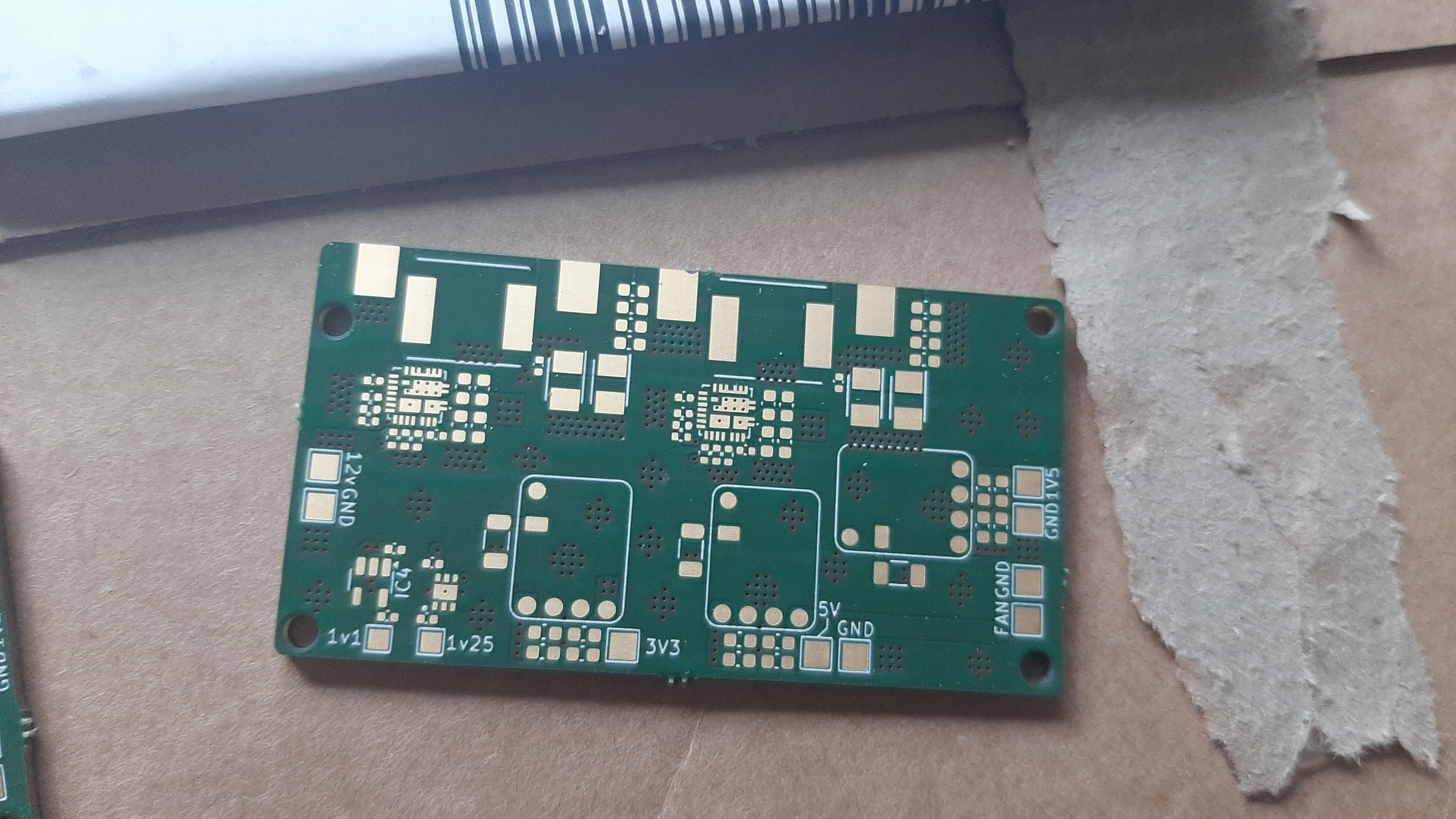

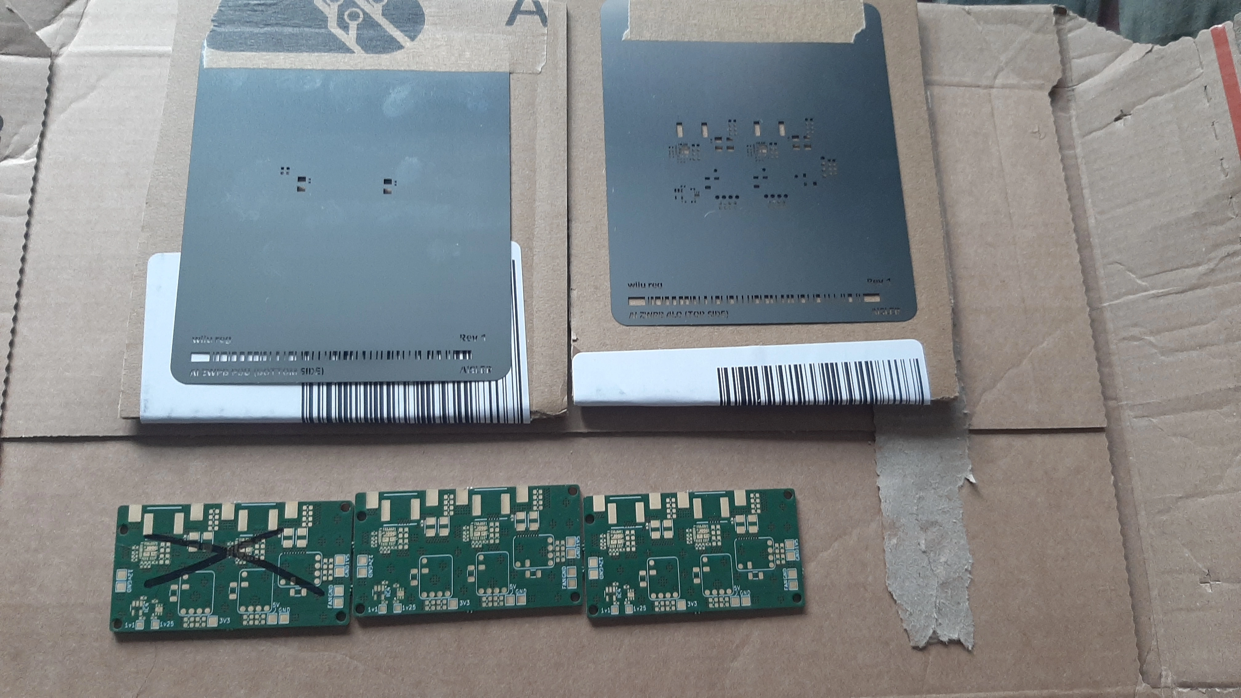

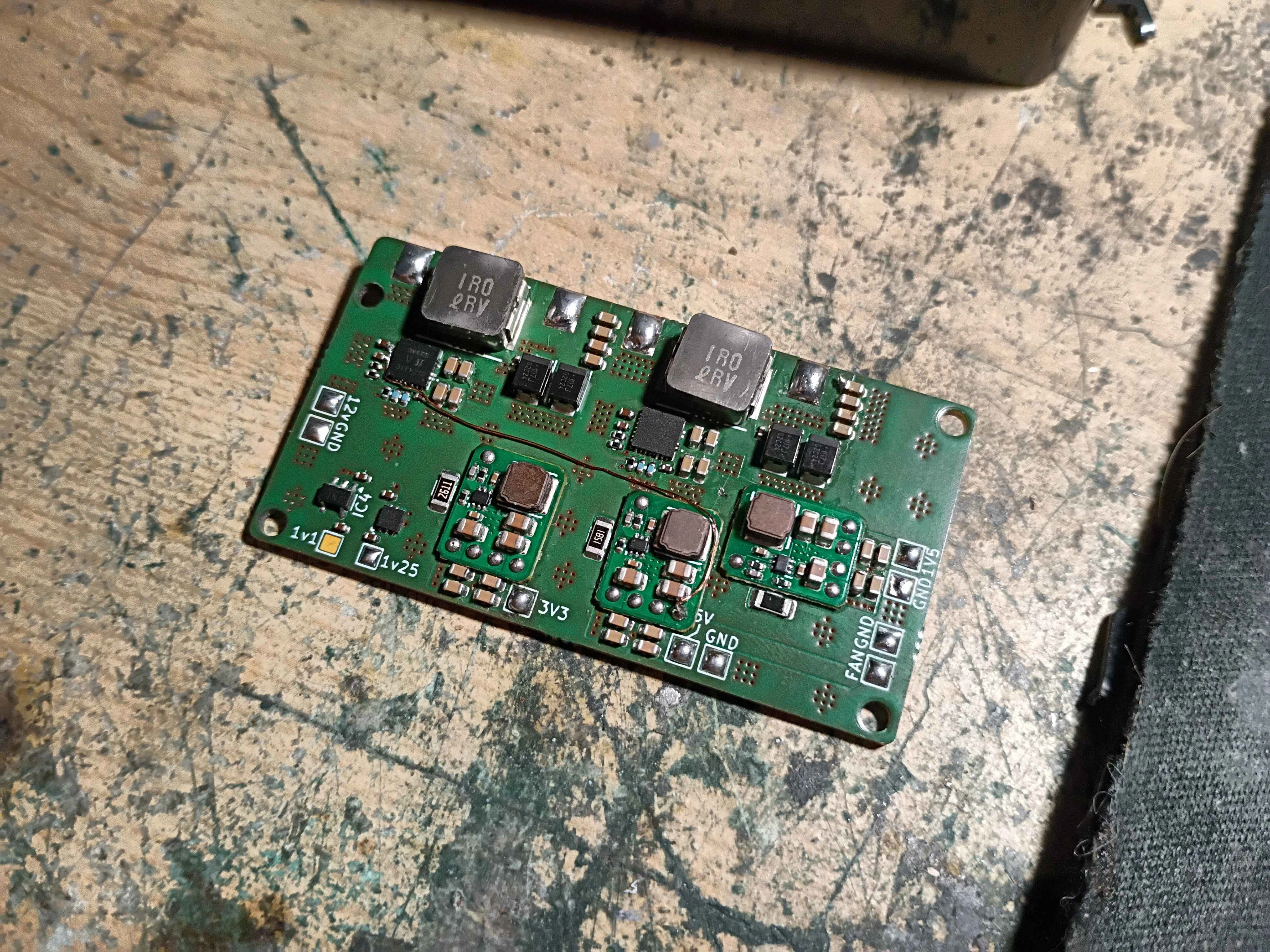

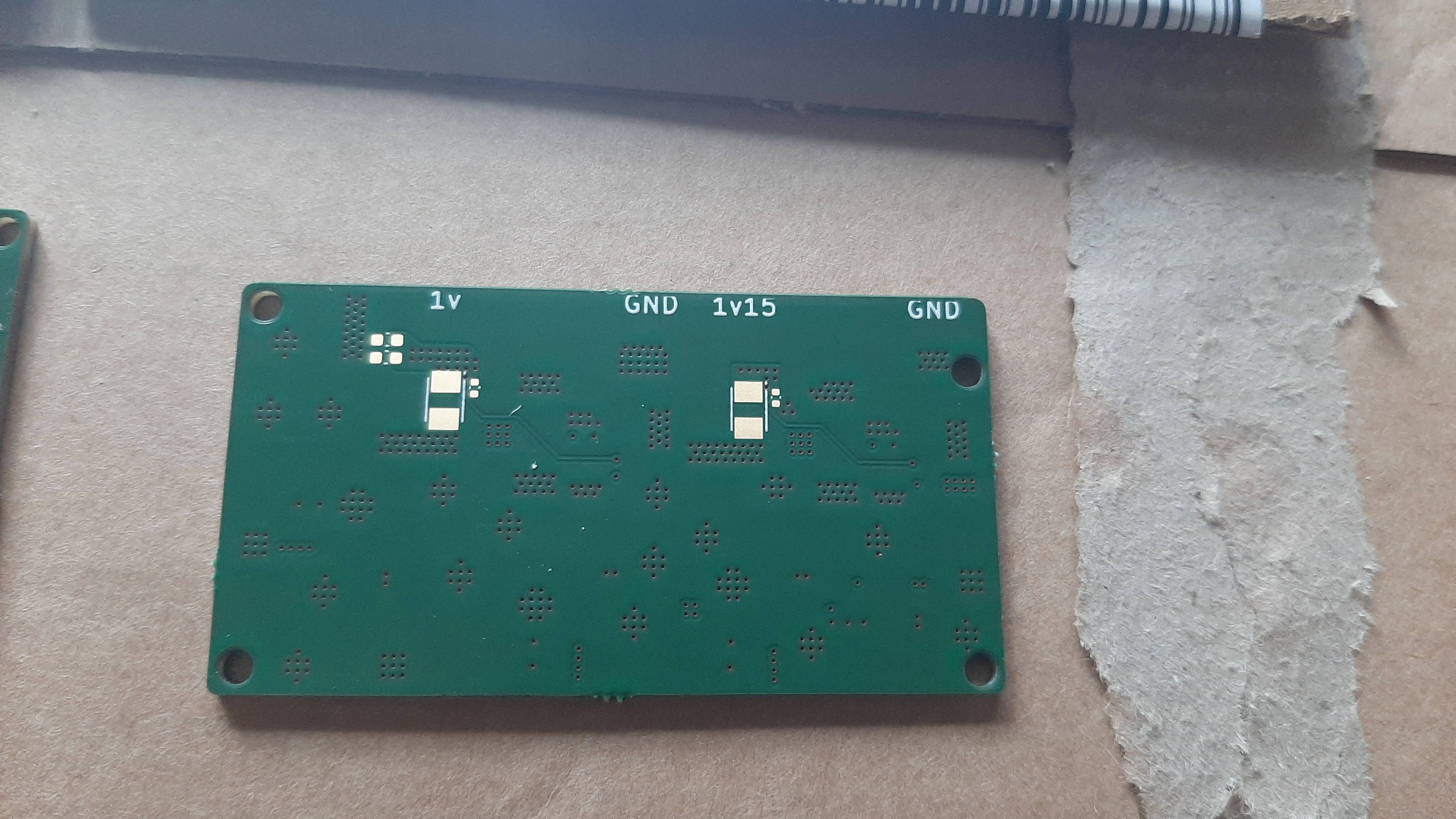

Last year I designed a power regulator board (4L) for this project and tried out AISLER's PCB service when tariff stuff was still constantly changing. They're OK if we look past the board copper going right to the very edge (JLC's and PCBWay's engineers usually scale it back about half a millimeter or something so the copper isn't exposed at the edge) and one of the 3 boards was X'd out and I wasn't notified. I remember the price being pretty alright though, so it's hard to complain.
It's name? PiiSU. That will be the first and only time I will use that on this post for everyone's sanity.
The board is intended to take in 12v, but up to 17v at the very maximum should be fine.
Half the work was done for me, as I surface-mounted Yveltals reggies right to the PCB for 3v3, 5v, and 1v5. All of these are 1a or below, more than enough. Probably made the BOM a little cheaper too (don't quote me on this).
1v and 1v15 are using the SiC431's that are found on bistro and the failure that was minireg.
1v25 and 1v1 are using LDO's, powered from 3v3. It's not battery powered, it's fine.
Here's what an assembled one looks like:
(The bodge wire is not needed if you're using SiC431AED/SiC431BED. The C and D variants need an external 5v supply, which is what I had on hand after I fried one of them)

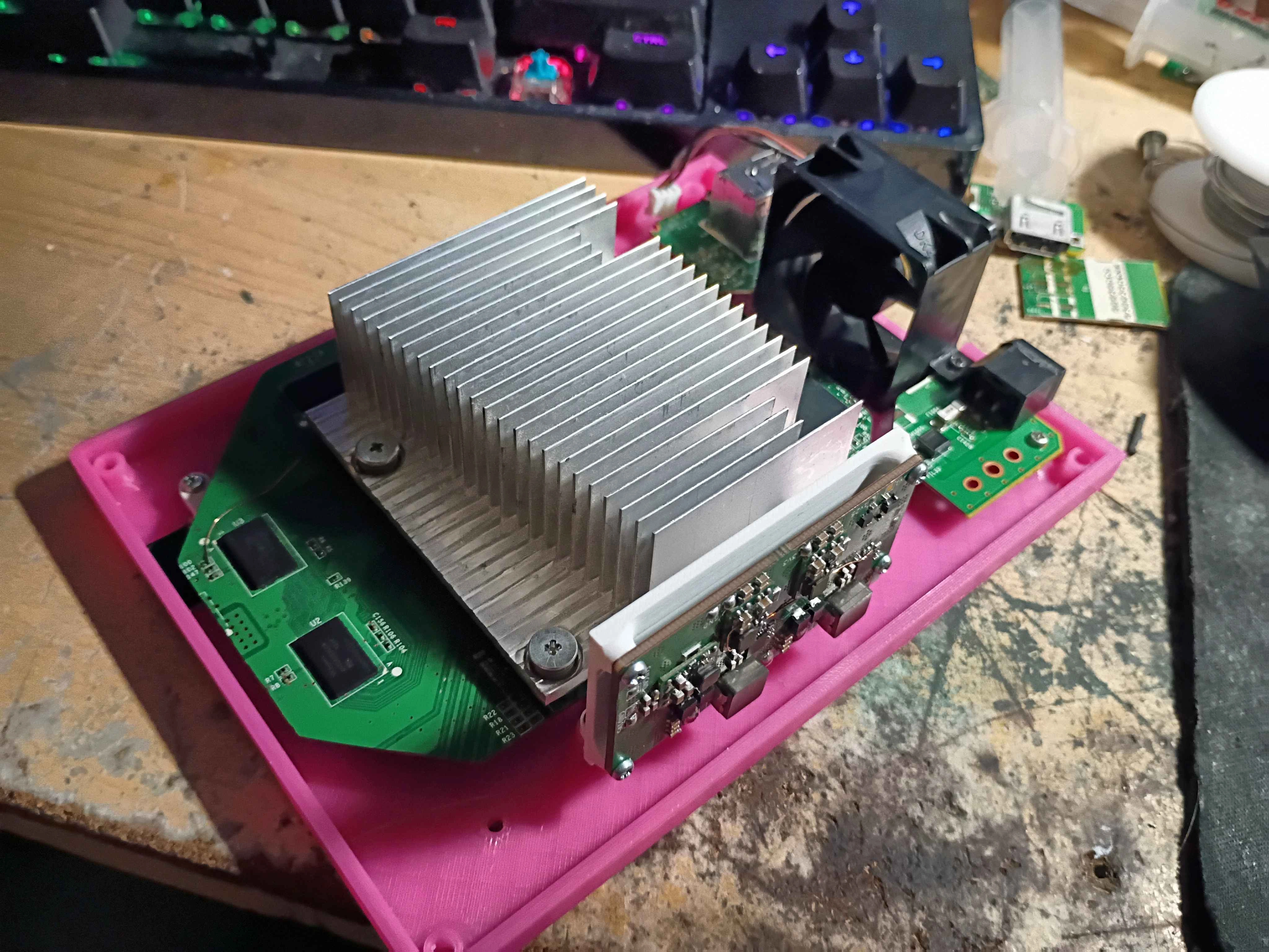

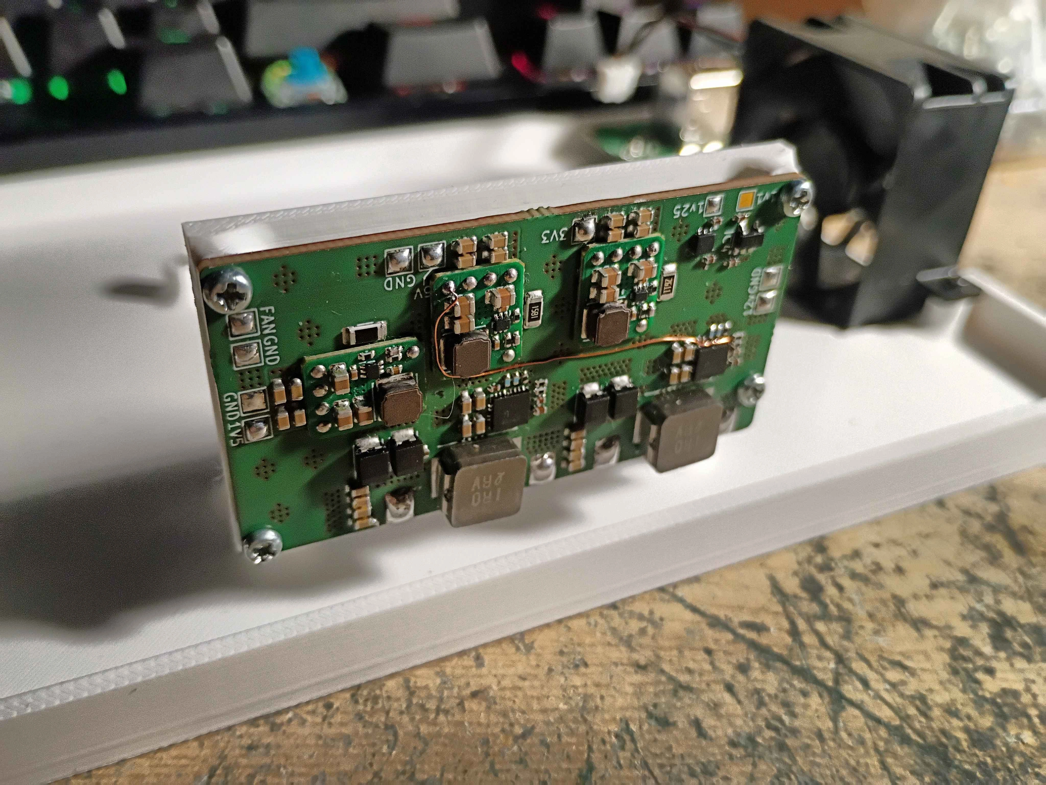

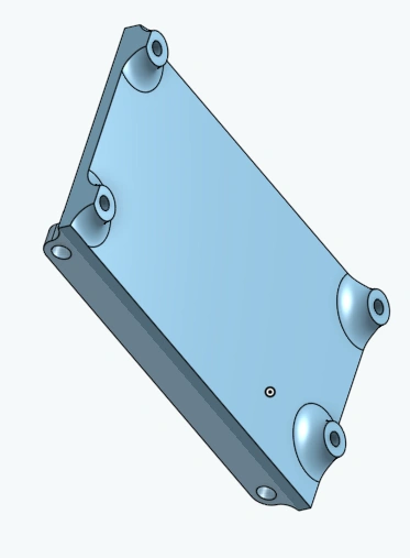

To mount the reg board on the inside, I designed this little mount:
Secured to the mount/shell with those screws every Wii/Wii U has like 20 of.

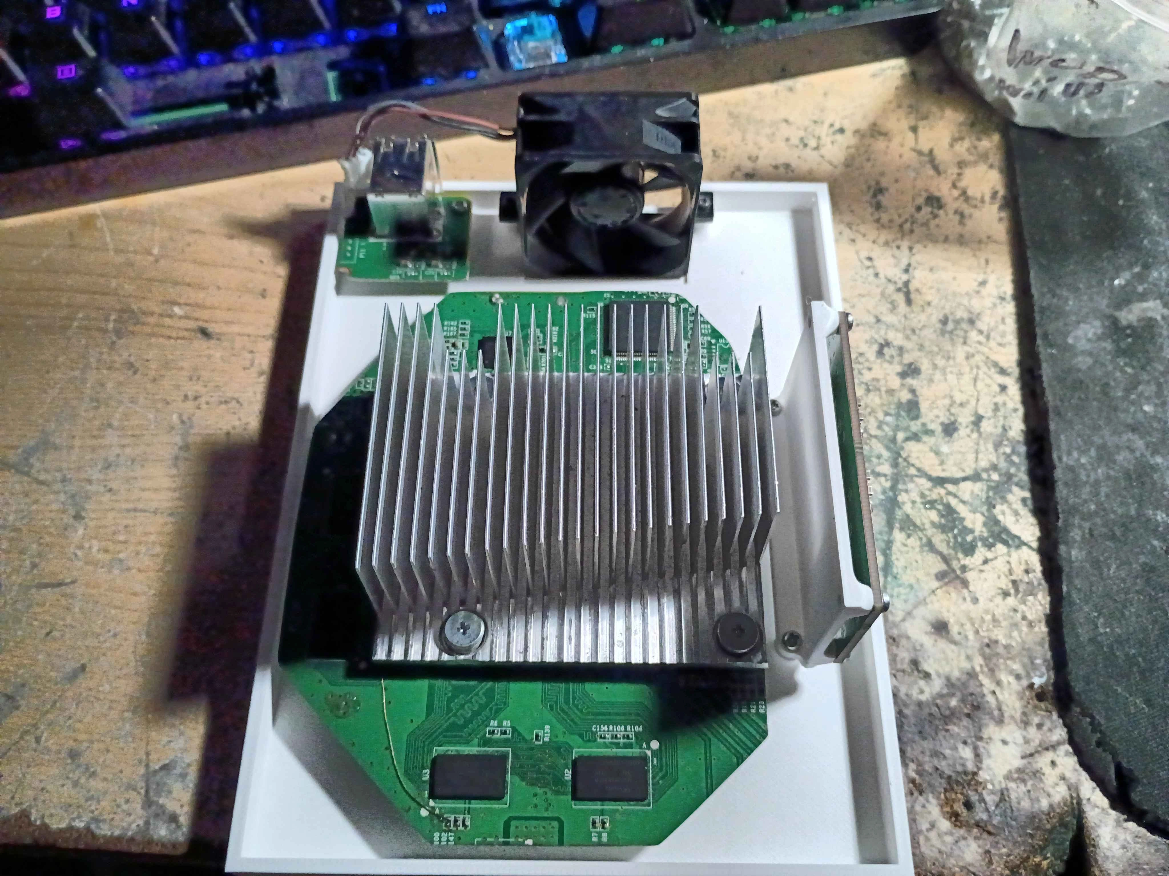

The heatsink I'll be using is the stock one. Unfortunately a 45x45x10 heatsink paired with the 50mm blower fan as shown in the R&D thread is just barely enough to cool an A5X before it shuts off from overheating. If it's like that for awhile, who knows what damage it could cause over time. I'm not really able to get a beefier heatsink, so this is the only option. The stock fan is used due to this. It's also why the power board is vertically mounted.
The USB ports at the back are also stock.

Things I did today:

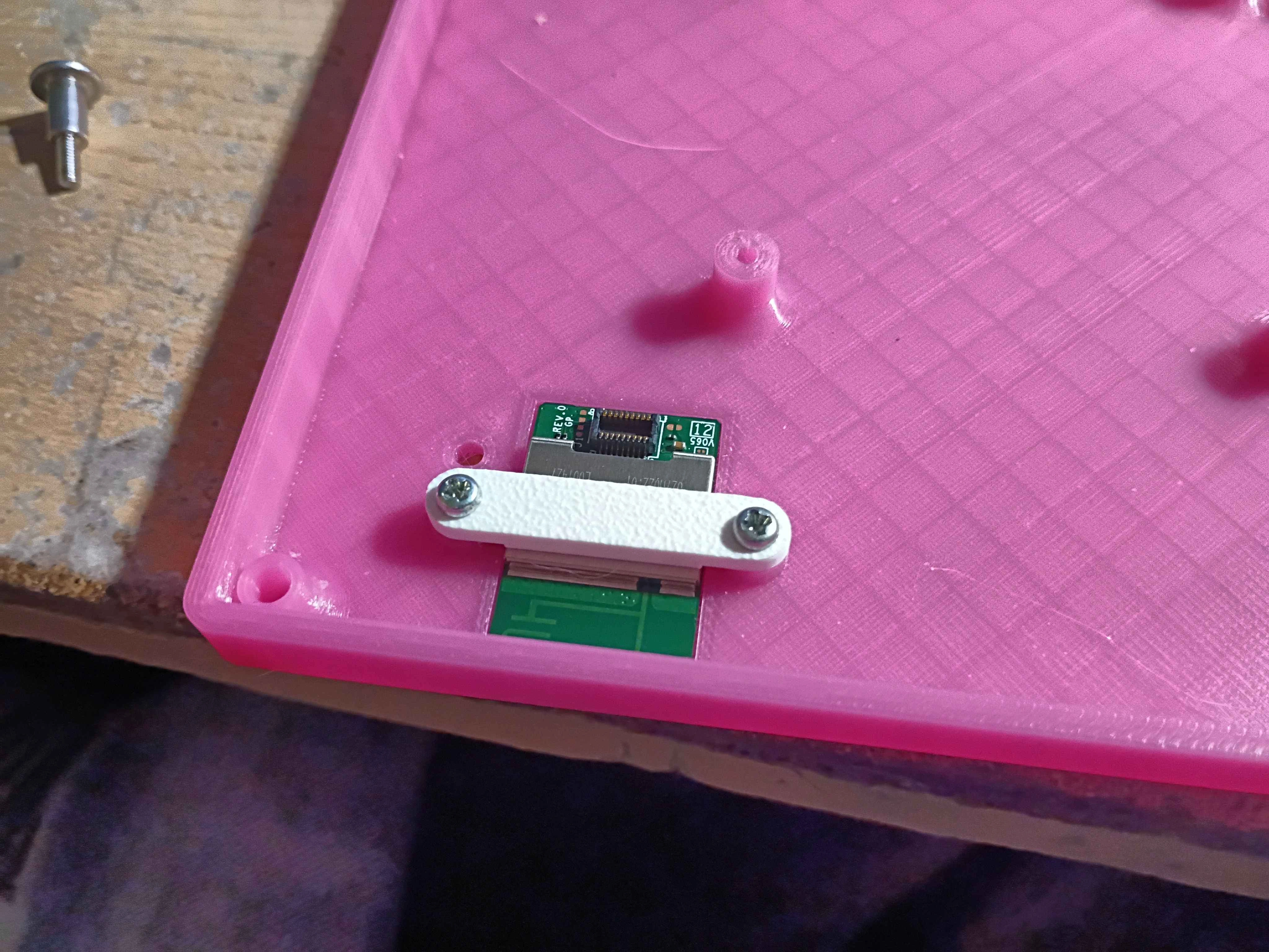

- Print the bottom shell in PETG. I really dig the pink! Worlds first Pink Wii U! My only worry about PETG is it coming off the build plate mid-print.
- Add a recess for the Bluetooth module to sit nicely. I had to extend the cutout by half a mm though, because on a PETG print the module wouldn't go in without some force unlike the PLA prints. I guess PETG shrinks a little more than PLA? oh well. I also put a little bracket (or the "electric chair") over it to keep it from ever falling out.

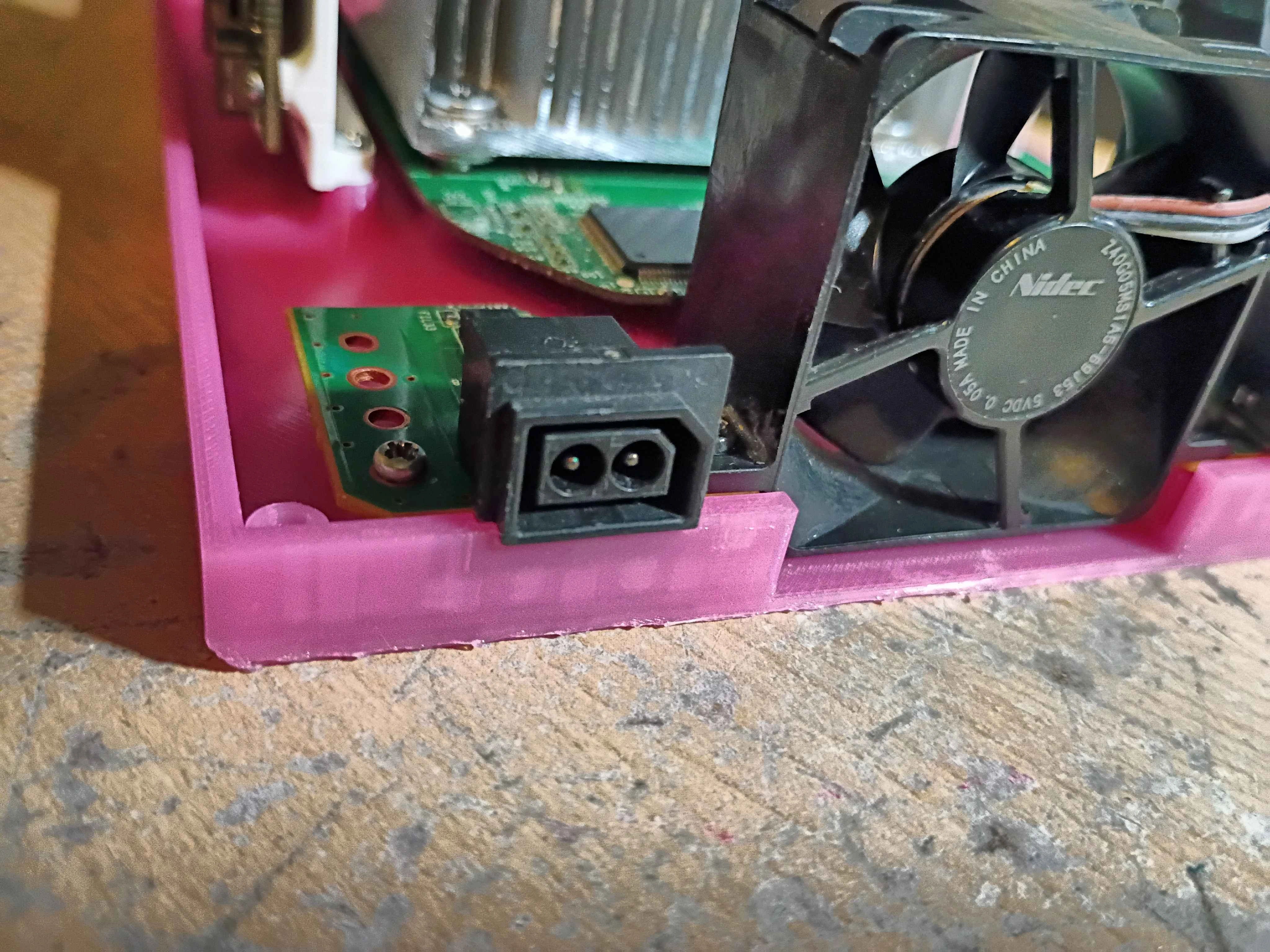

- Put in a power plug. I'll be using the stock plug because why not use more parts from the stock board

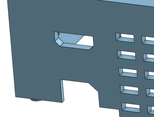

- Put in the HDMI port on the top shell. It's going to sit above the power port. This will also be the stock port.
- Buttons/LED's. They look out of place (maybe I shouldn't have put them at the front..) but if I really don't like them or the whole thing just doesn't work, I'll just remove them. I tried to copy the faceplate but eventually vibed (no not AI) the positioning of everything. If I do remove them I think I'll have the front panel connector next to the SMC just so I know what the system is doing.

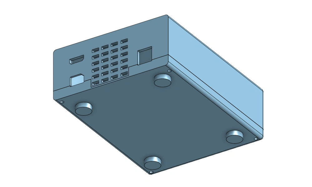

And here's what the whole thing looks like currently:
I know I need to print the bottom part at least one more time. Top shell is kind of a gamble.
IDK if the cooling system is adequate, but with some holes for air to flow, the beefy stock heatsink, and the stock fan, I think it'll be fine.
If someone we're to want the AV port for some reason, there might be just enough space over the USB ports if the sensor bar port is lobbed off. I'm not going to do that though.

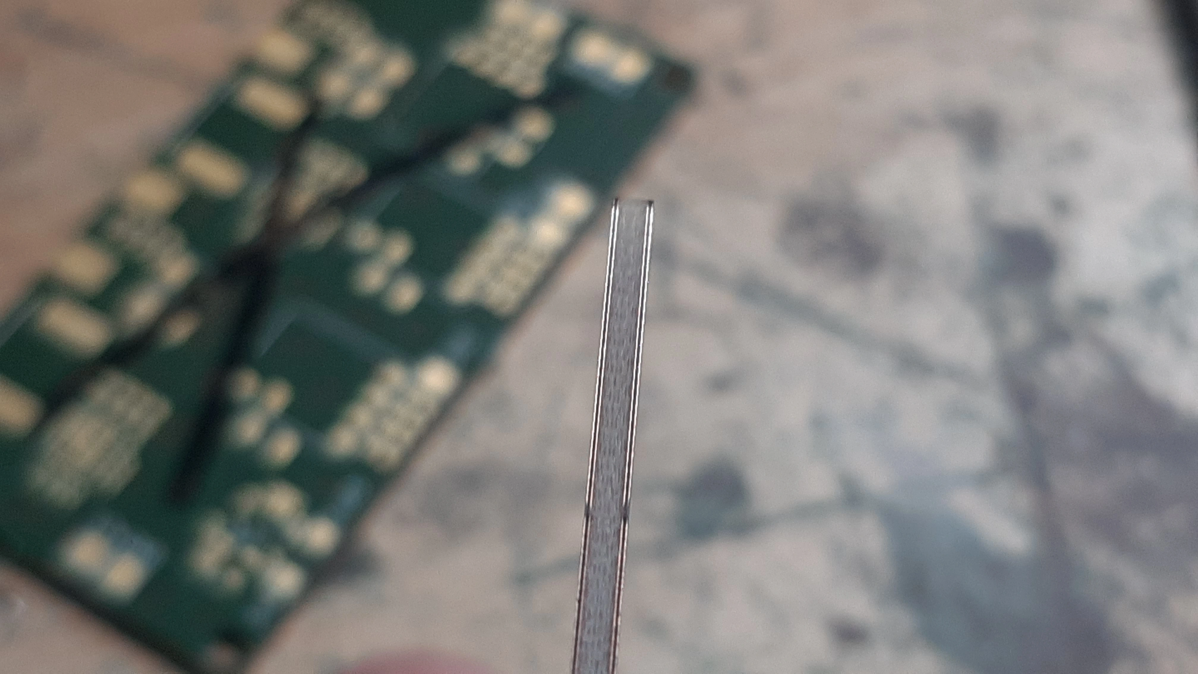

Because I only have 38awg (and some other wire that is too big for this) I doubled up some 38awg for power/ground to the module. IDK how much power the module really uses but it definitely gets quite warm.

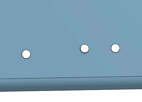

I swear this is important for the shell!
Because the microSD slot blocks one of the screwholes, I had to remove one of the posts for the heatsink:
I think 3/4 will be adequate, so I'm not really that worried.
One of the screws for the BT module holder thing that I designed completely conflicts with the NAND/eMMC daughterboard. I forgot to consider that the daughterboard will be in that area. Whoops! With the flex this isn't a huge problem as there's not a lot of thickness added, so I am just going leave that as-is, glue the module in place, and call it good.
