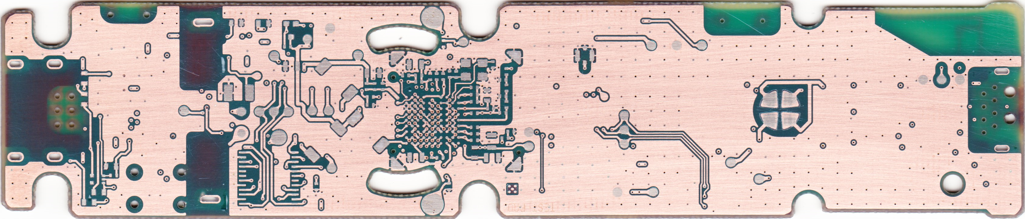

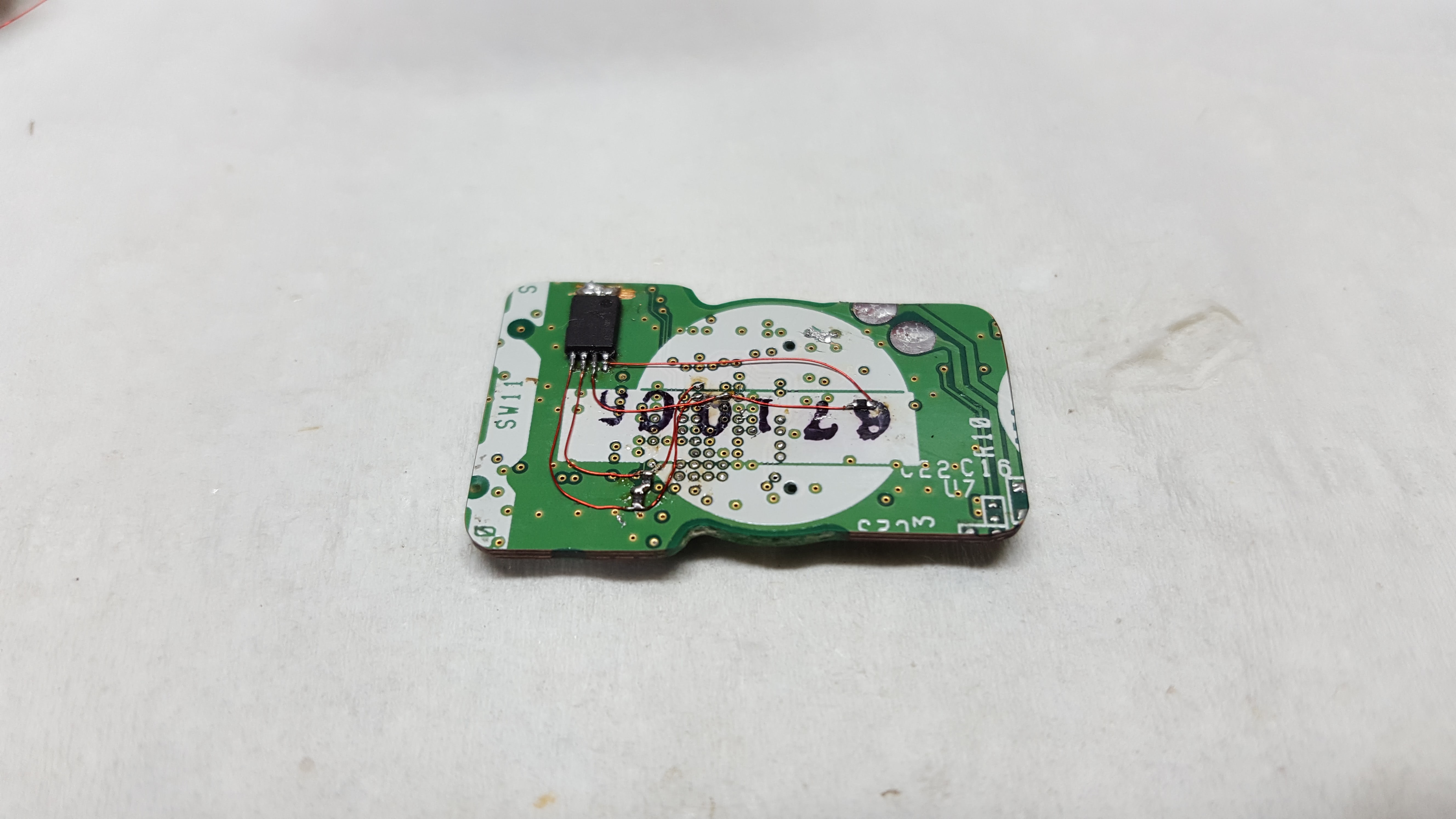

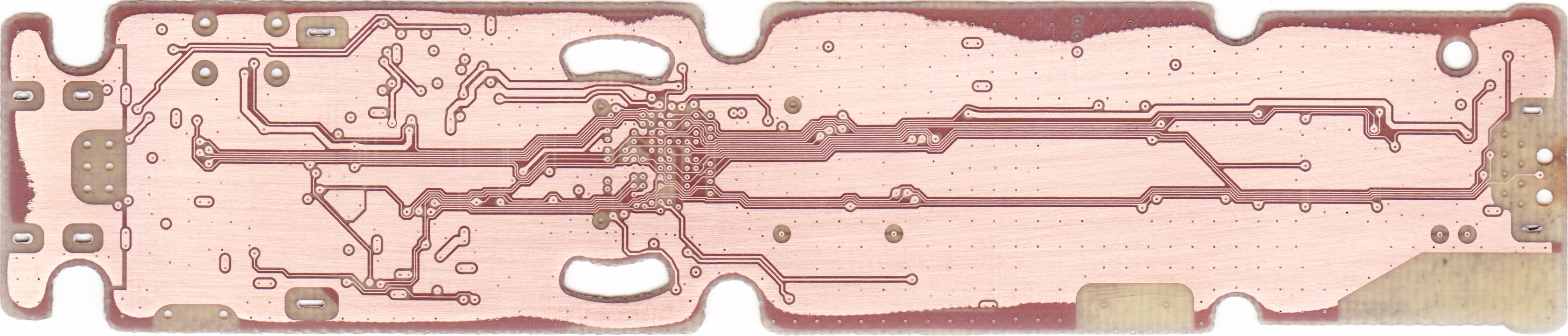

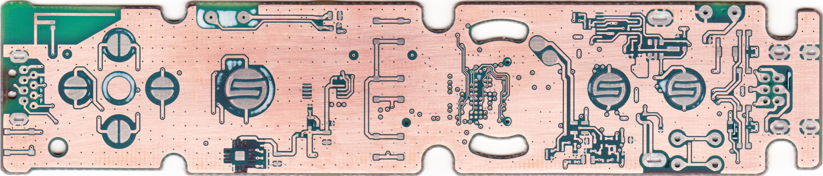

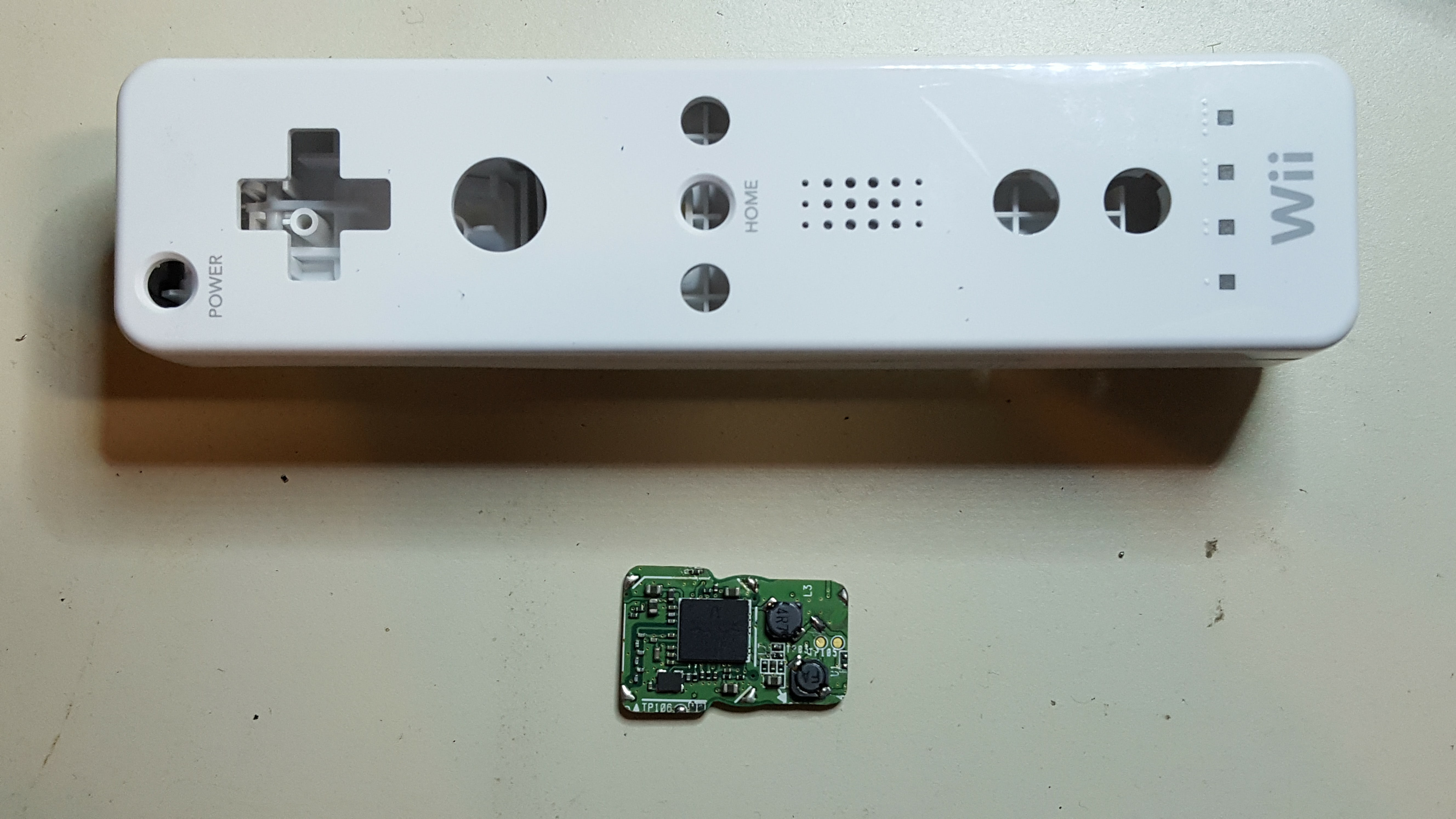

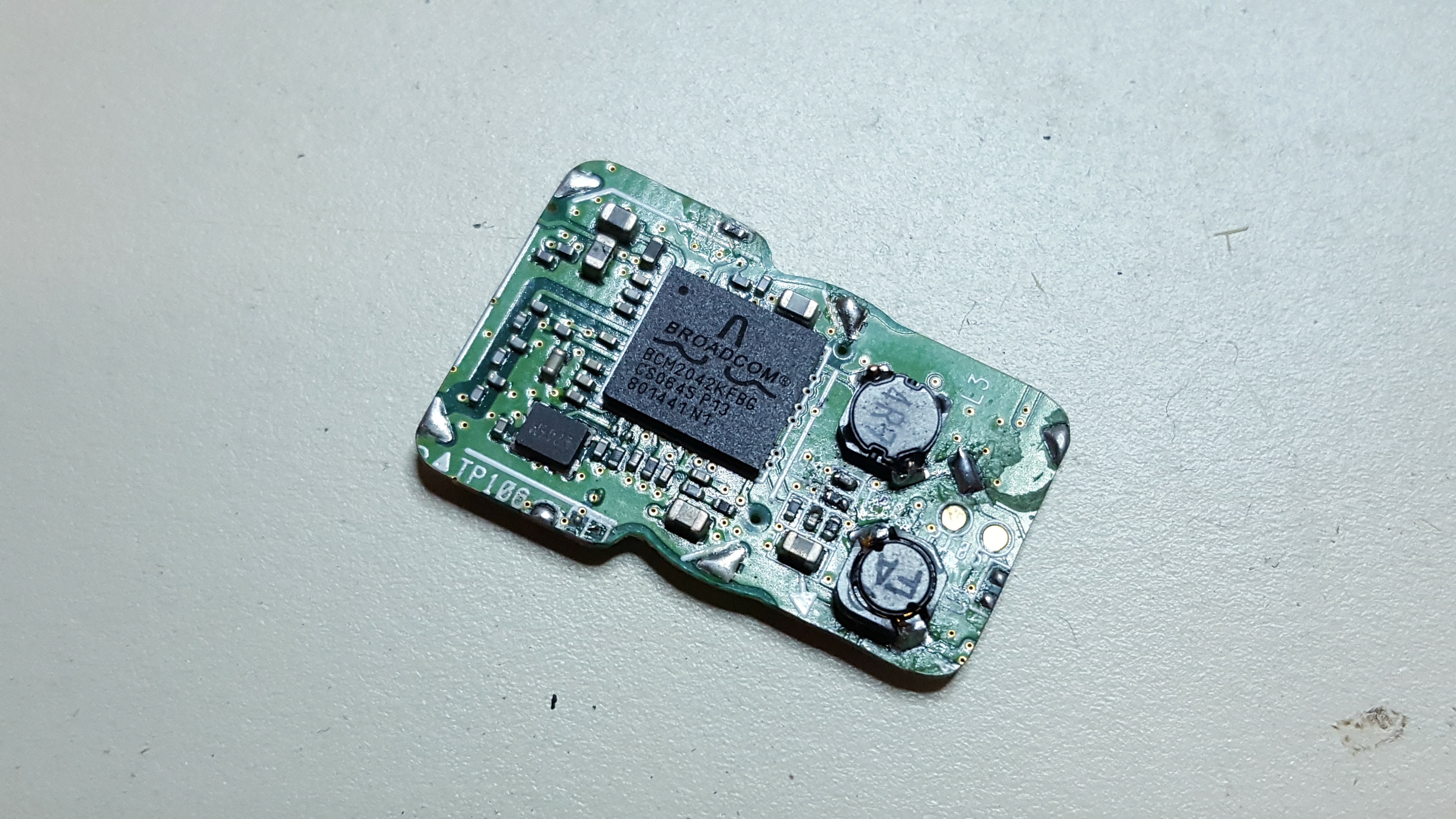

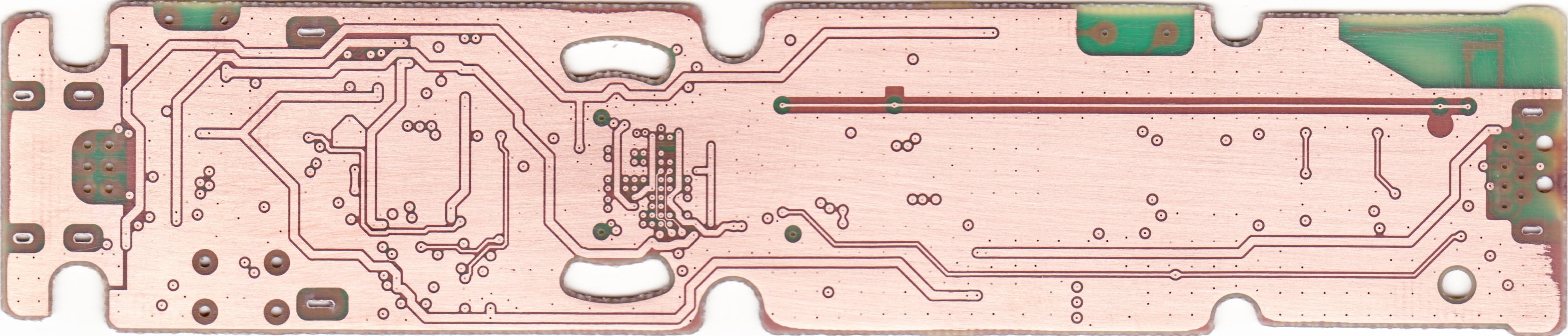

I tried to trim the Wii remote in my last portable, but it still ended up being pretty big. I wanted to figure out how to make it as small as possible this time, so I took sandpaper to one of my 4-layer boards and made scans of all the layers.
Top Outer Layer.png Top Inner Layer.png Bottom Inner Layer.png Bottom Outer Layer.png
With those scans I found out how to bypass the voltage regulator that takes the battery input and converts it to 3.3V. I was able to cut it down to not much more than the main IC. This required that I relocate the I2C EEPROM and the accelerometer (but it doesn't need the accelerometer to function).
View attachment 2916 View attachment 2917 View attachment 2918 View attachment 2919
Would you consider making a guide on Wiimote trimming? It would be really cool to have a list of what's important and what's not, as well as how to perform the necessary relocations.
I'd love to contribute to some kind of guide, but I don't know how helpful it would be. Part of the trouble with making a Wii remote trimming guide is that there are countless revisions of the Wii remote and I only know how to trim this one specific board.
