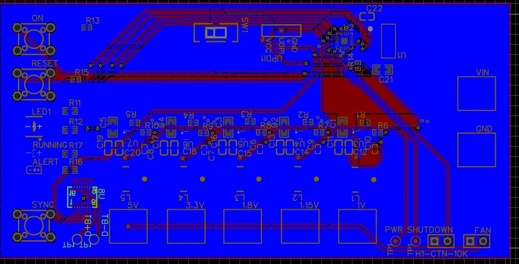

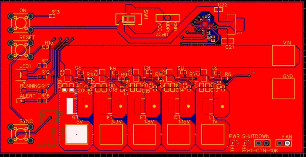

I designed custom PCB to power on a ElectronAVE modded wii but , before ordering it, I want know if my pcb will be secure to powering a wii and if I can command it securely and if it can just work
(Detail : It is based on the PSU Plus circuit and uses the same regulator, the AP62301Z6-7 )There is on it a ATTiny1616 who make security fonction and enable/disable the regs and soft power on/shutdown bluetooth function and the SW1 switch are used for programming of the ATTiny
I will order it on JLCPCB with 1oz copper weight and I used easyEDA to design it and his size is 100mm by 50mm
There is some photos and Altium Designer and EasyEDA files
Thanks !
