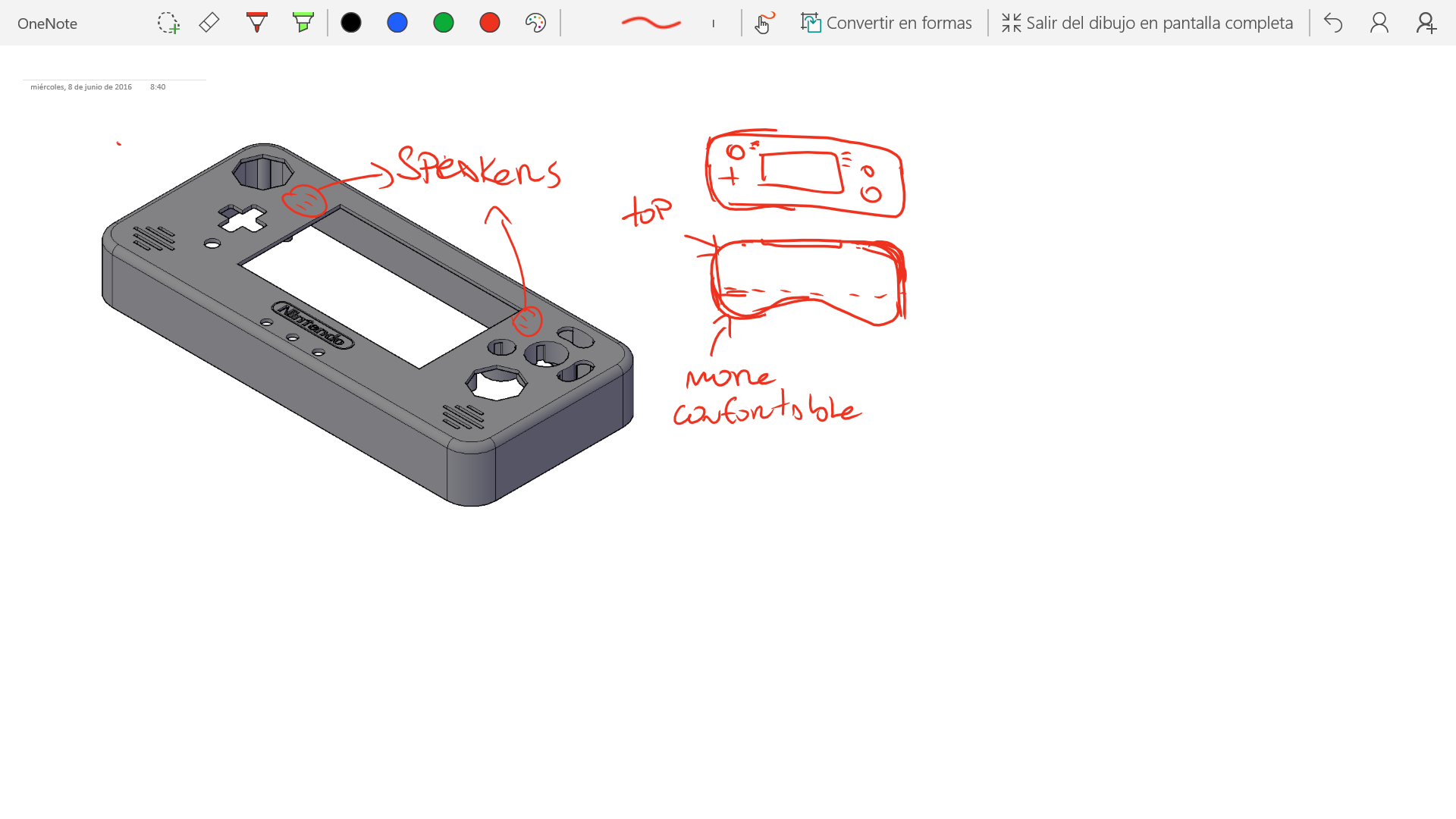

You should really match the centerpoint of your A button and your joystick hole, and the center of the Dpad and your cstick hole.
And moving the speaker holes inward will help with this
Regardless, I'm really liking the case overall, it's definitely gonna turn out great
