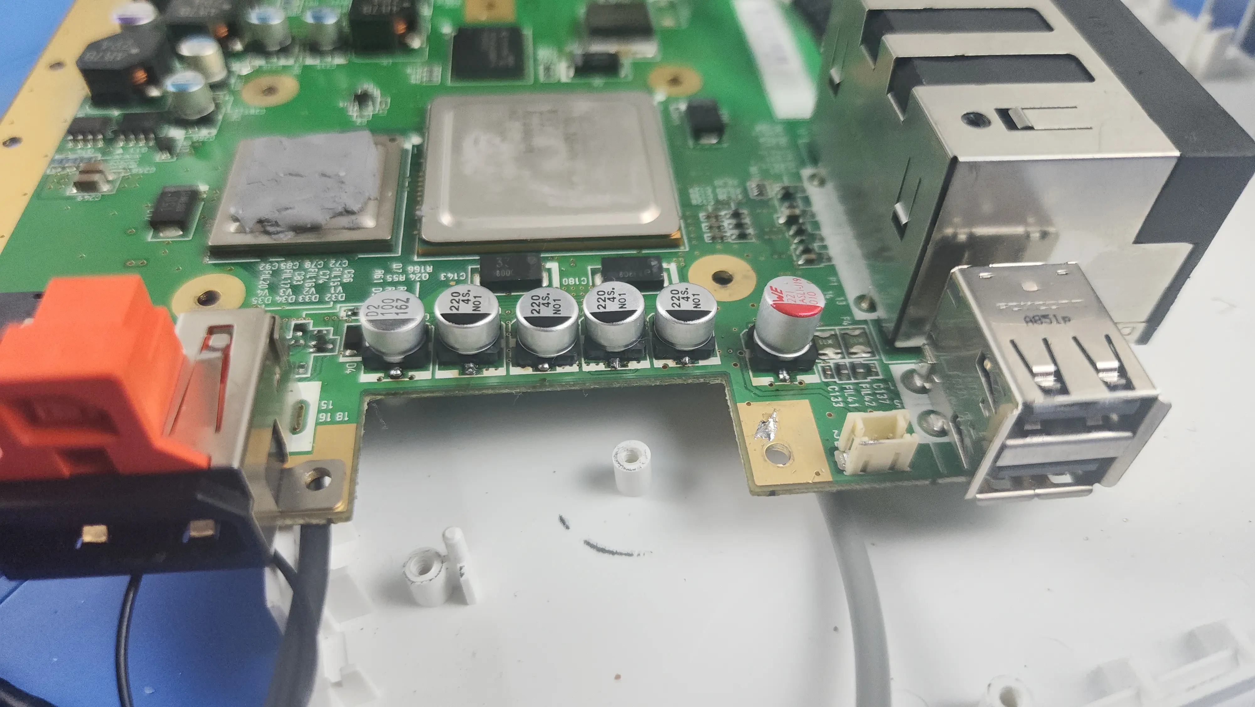

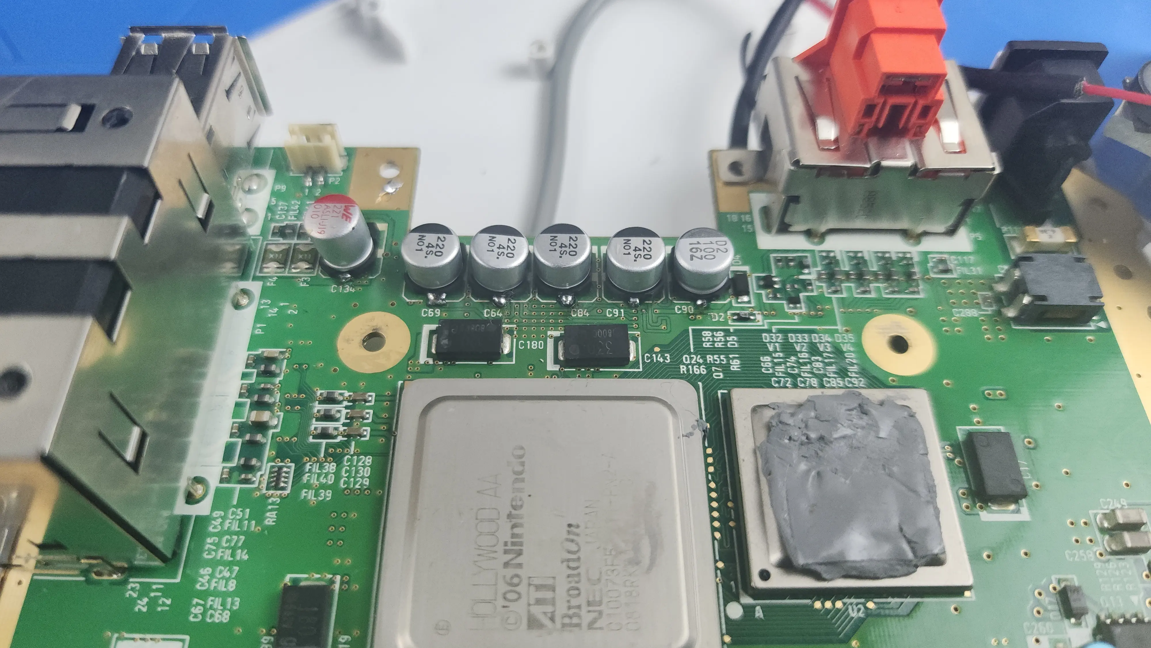

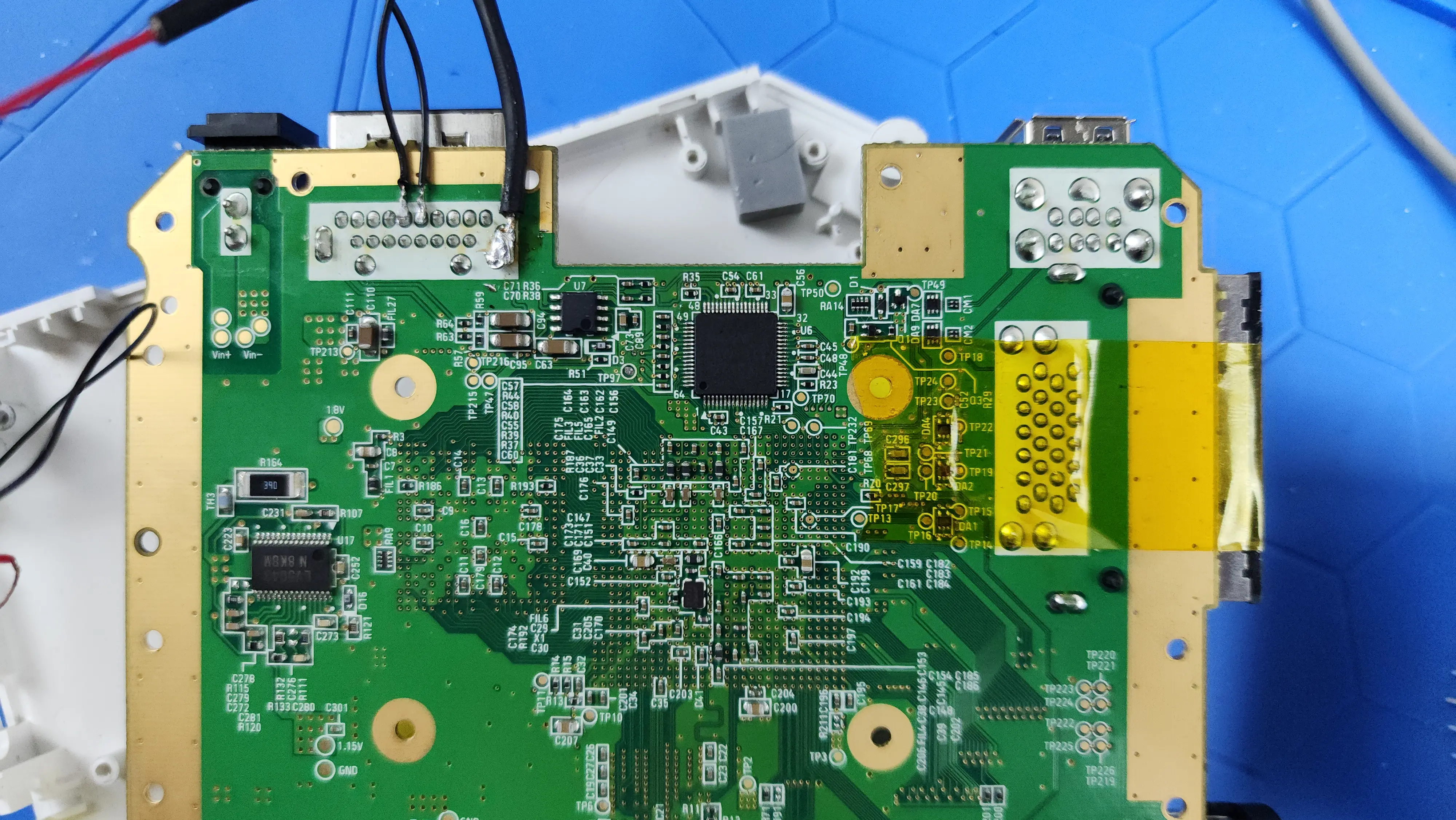

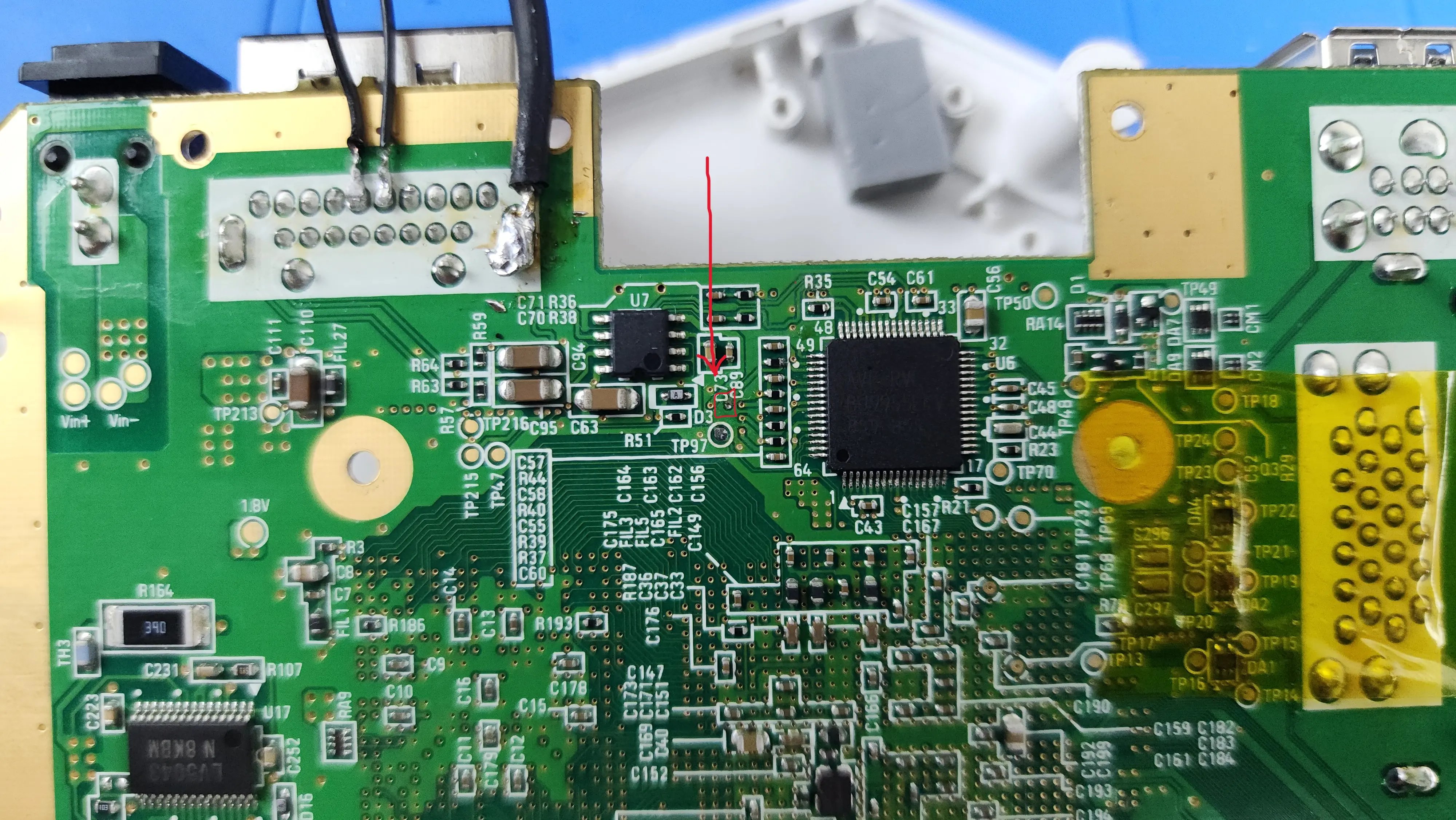

I have include photos of the board and my crappy soldering job on the capacitors, in the second photo I have marked the via I was using to test the video output in addition to testing the capacitor closer to the chip, the third and forth photos show the 6 capacitors I replaced.

Probed the AVE-RVL chip to see if I could detect any video signal, but I’m not getting anything regardless of where I place the probe.
Checked continuity on all output pins and grounds for the AVE-RVL and everything appears to be connected correctly
Measured the video output pin, and it sits at 3.3V

Replaced the six capacitors associated with the AVE-RVL video circuit, but still no video output
