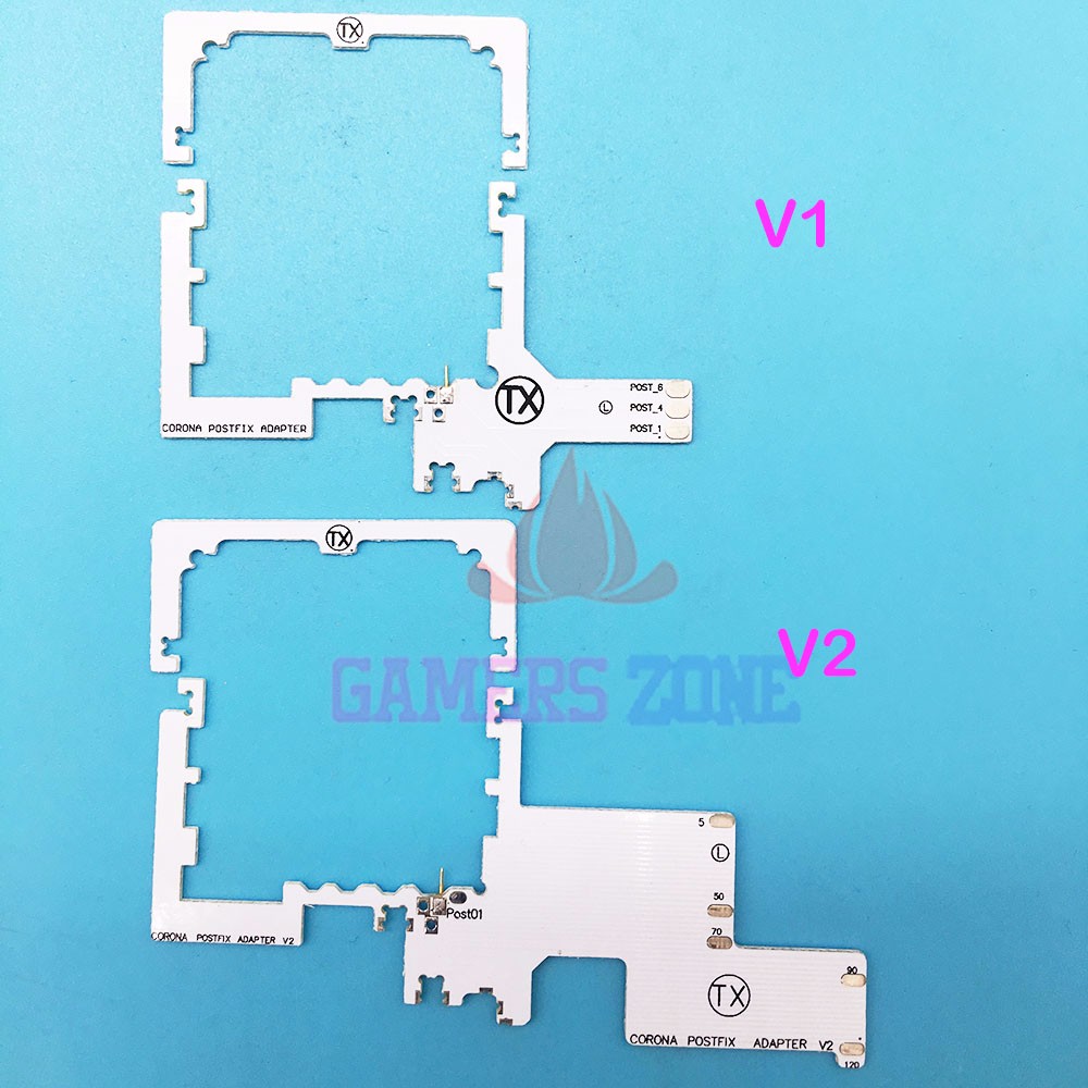

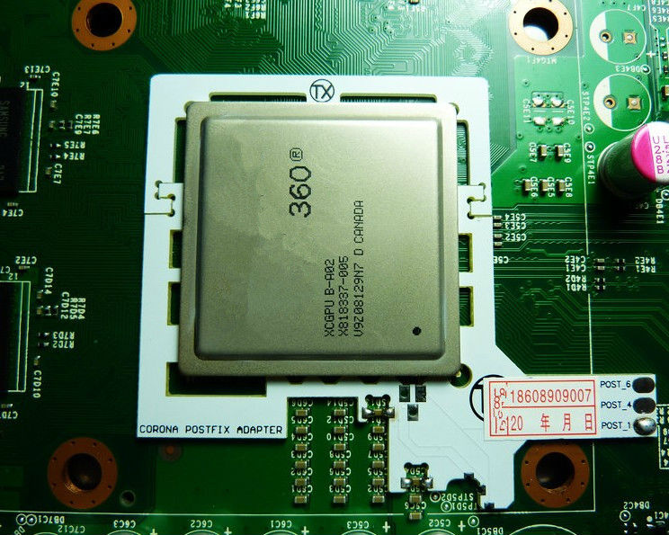

So I thought about some of the things that were made for the 360, and one thing that came to mind was the Post Fix Adapter. So for xbox 360 slims (specifically the Corona versions), some revisions removed the post trace to the XCGPU to try to stop people from modding the consoles, however they were very lazy and still left the post pin under the XCGPU as it probably would have been a decent design change for something as simple as that. The adapter just consists of a little QSB with anchor points/ hook points, and a pin that goes directly under the XCGPU to make contact with said Post pin.

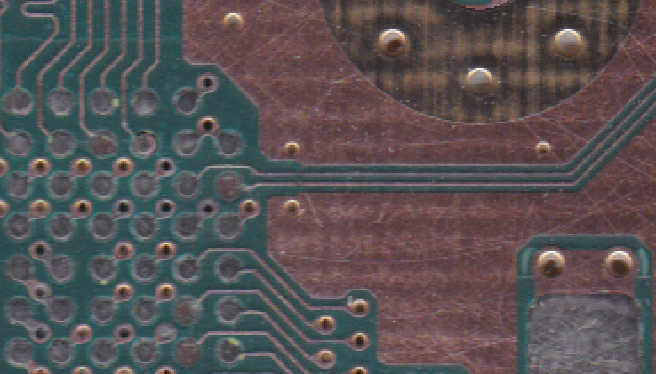

So my thought is developing something similar with 2 pins to try to make contact with the 2 BT module data lines. After looking at the Compendium, I noticed that it would be a little more complicated due to the pins being Horizontally beside each other rather than vertically, but I think I could make a work around.

So after looking a bit further into this, I figured out that I could definitely make something like the Postfix Adapter that at least connects to the outside pad, but I doubt I could get a pin small enough thats isolated about 85% as to not short the other pads.
I did however find that I could slightly bend the end of a 34awg magnet wire and then sort of lodge it in there to make contact with the inside pad. I didnt have the wire tinned so I couldnt verify continuity with said pad, or the ones around it for shorts. Regardless, im not sure how safe that would be anyway to just shove a wire in there.
