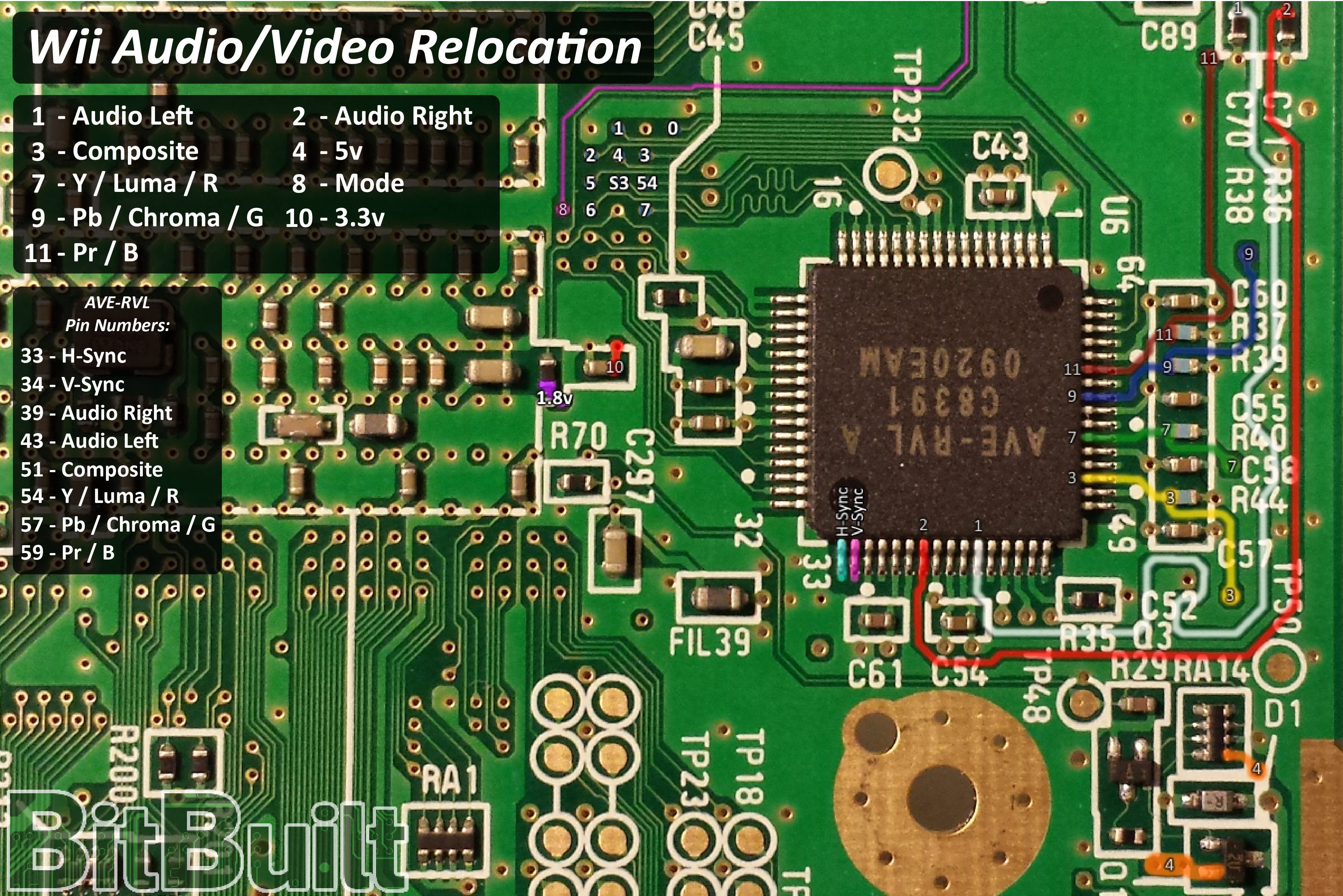

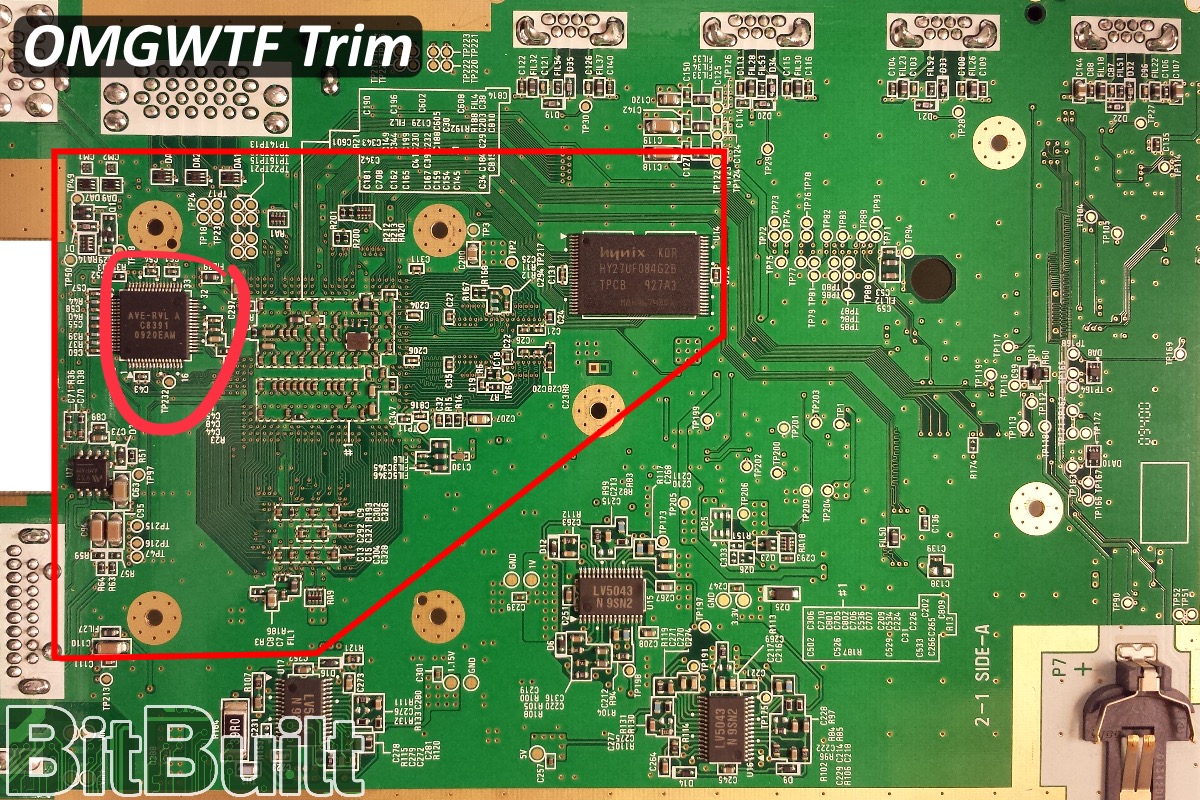

Here you can see the ave (circled):
This is on the underside of the board and the a/v output connection points are here:
The ave does not get cut off. I believe you may be referring to a different a/v spot which does get cut off. However, this one doesn’t. As for BT, you are taking the BT module, and soldering it to the trace lines that connect to the GPU. After scratching off the solder mask of course.
You would be wiring the wires from the ave to your screen and Bluetooth is just getting moved closer to the GPU.
Hope this helps!
Rule 1 when you are new: there are no dumb questions. (As Long as you put some effort into learning)
This is on the underside of the board and the a/v output connection points are here:View attachment 10185
You would be wiring the wires from the ave to your screen (and batteries) and Bluetooth is just getting moved closer to the GPU.
Hope this helps!

When things you need get cut off, use the trimming guide to follow the trace backwards until it reaches something that isn't severed. For example, you may be referring to how the AV port is cut off during the trim. Because it is cut off, follow the composite video trace backwards. You can see from the image above that the composite video signal originates at the AVE. Anywhere between the AVE and the point at which it is cut is a viable point to solder to. Generally, we pick the easiest point to solder to. Which is the large capacitors on the top of the board. You can apply this logic to anything you are reconnecting to the Wii.
Thanks for the advice! I had a theory that that might be what I needed to do, but confirmation that it is a viable strategy is what I needed. I don't want to screw anything up and make as little dumb mistakes as possible (like cutting the board and then not knowing how to hook it up to anything. Thank god I didn't do that). I will make sure to study my Wii motherboard very closely and plan out all the connection points, and I'll pray for the best when cutting the board.
