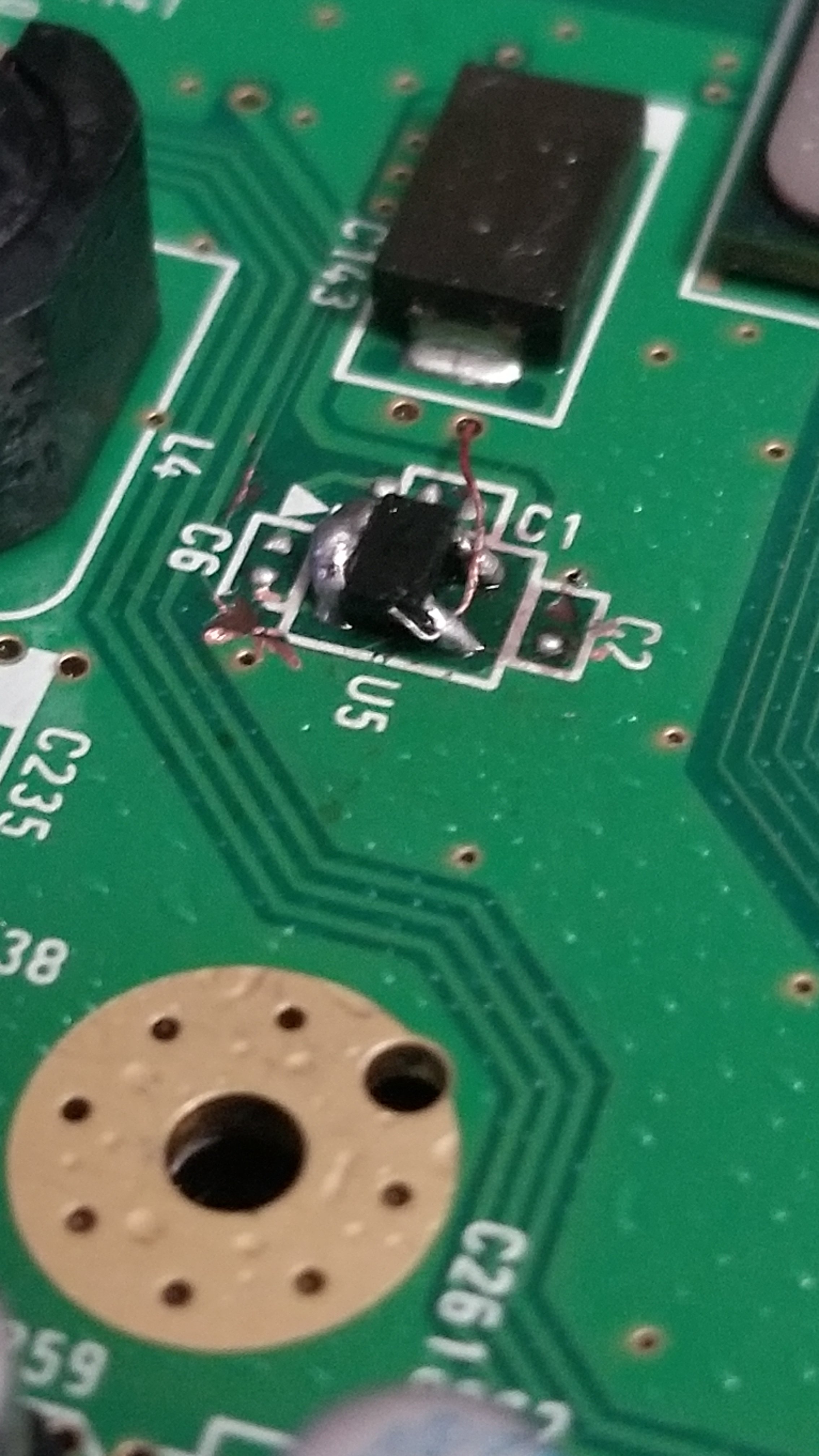

This is my first portable and I am trying my best at it following the threads and all to help me out with my problems, but I am just having a tough time.
When I tried to remove the U10 transistor without a hot air station and kinda broke off the leg, but I still had U9, so I packed up the Wii and head on over a friend who had one. We got it off fine. We successfully replaced it, or so I thought. I was finishing up the relocation 2 days after moving the U9 to U5 since I just got my shipment of wires in. Wired everything up and went to test, no boot. Thought the trace was not fully cut, so I dig in some more. Nothing. I saw online from and found a troubleshooting guide of U10/U9 relocation from Shank, and went to bridge the U9 pin 4 and 5 location. Test again and nothing... Went through the troubleshoot some more and saw that the output was not producing the 3.3V but around 0.5V, so I knew that was my issue. But no there was more to come. Remove the wire from the transistor and decided to plug it in knowing nothing will happen, but to my behold.... The LED on the motherboard is now super dim. Now I am here just pulling hairs thinking did the board break!!! Did the AC adapter reset till not working.

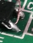

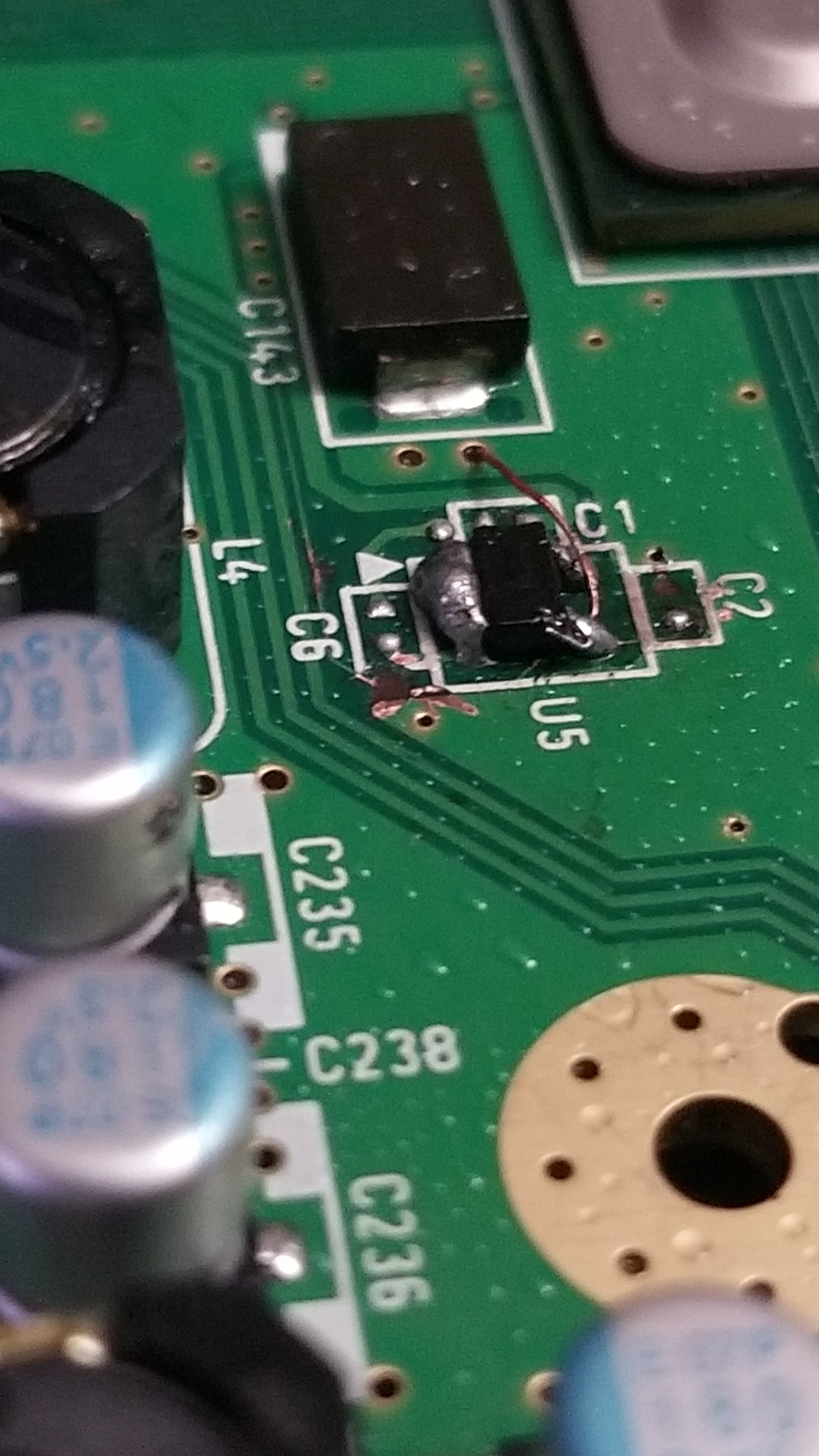

From the picture you attached, several immediate thoughts. First of all, it's hard to tell what's going on at all with all of that flux residue. Grab some IPA and a toothbrush and clean that off. I can also see a solder ball just sitting on the board. That's a recipe for a short when it falls off and touches something it shouldn't. Secondly, the wire is it's possible the output is shorting with the input. The enamel looks slightly burned off near the input pin. Lastly, I can see some ripped off pads where the capacitors were, so it's not impossible that you ripped off some pads on the U10 spot. Check continuity with the input and 3.3v, and the ground blob and ground.

Voltage are fine. I said it before and I'll say it again, this looks very questionable. Could definitely be shorting. I suggest you bend it in such a way that it isn't touching the input pin.
Cool. Moved the wire, plugged it in to power and check the pin and power is being outputted. So in the end the IC has been fried. I ordered a replacement. Thanks for the help again. Sad that it happened and still pondering but not caring as much for LED since it will be gone when trimmed, but it was a good learning experience.
