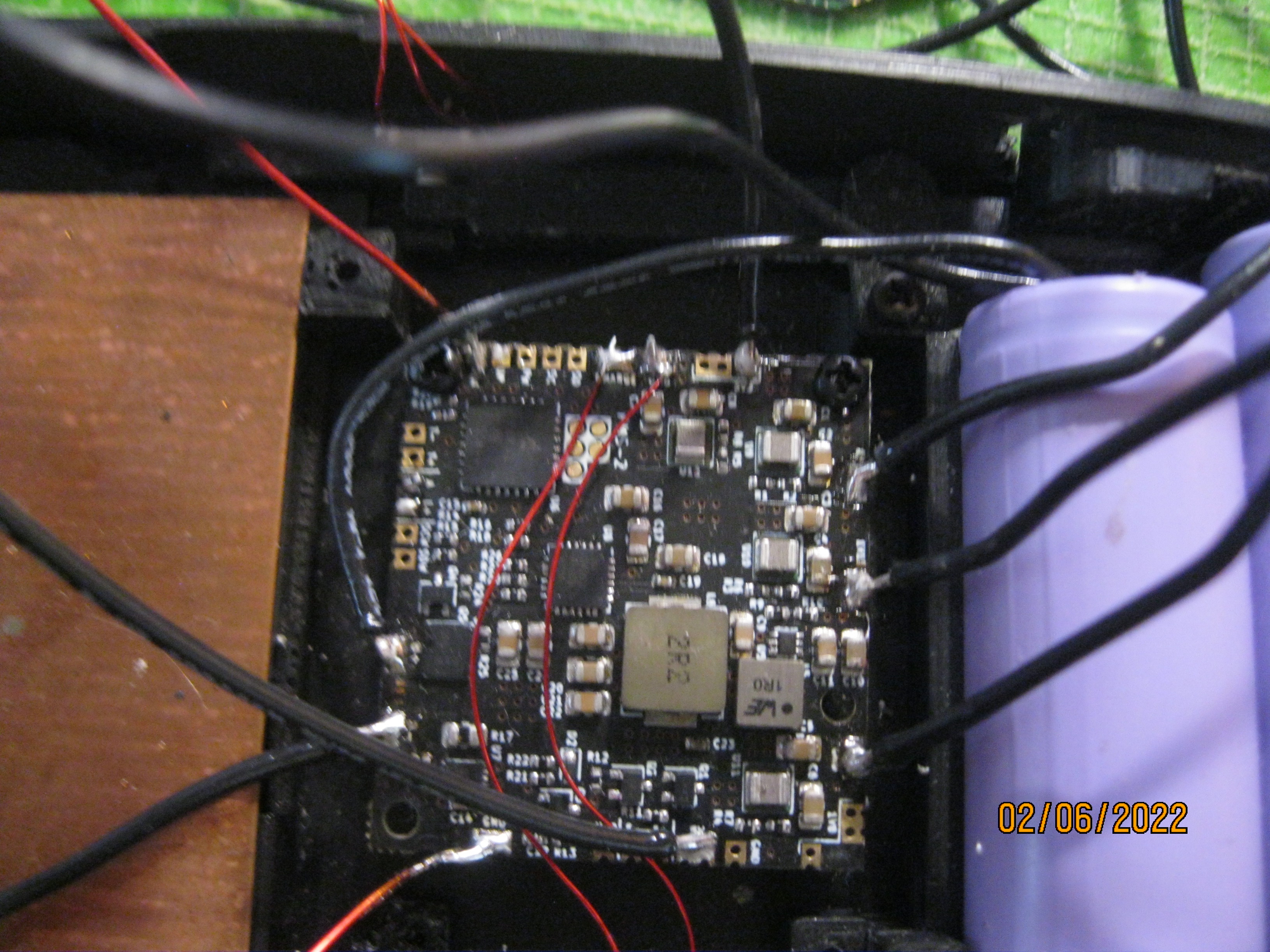

Here is some wiring.
However, I dont think it's the issue, as the screen and wii work fine untilI load something.

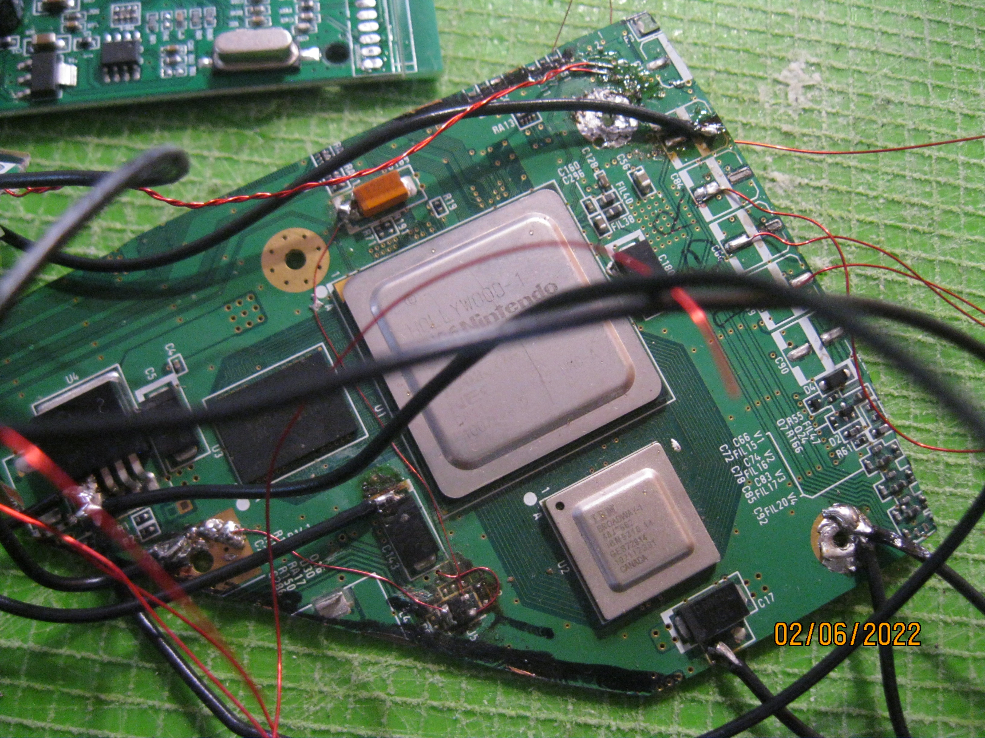

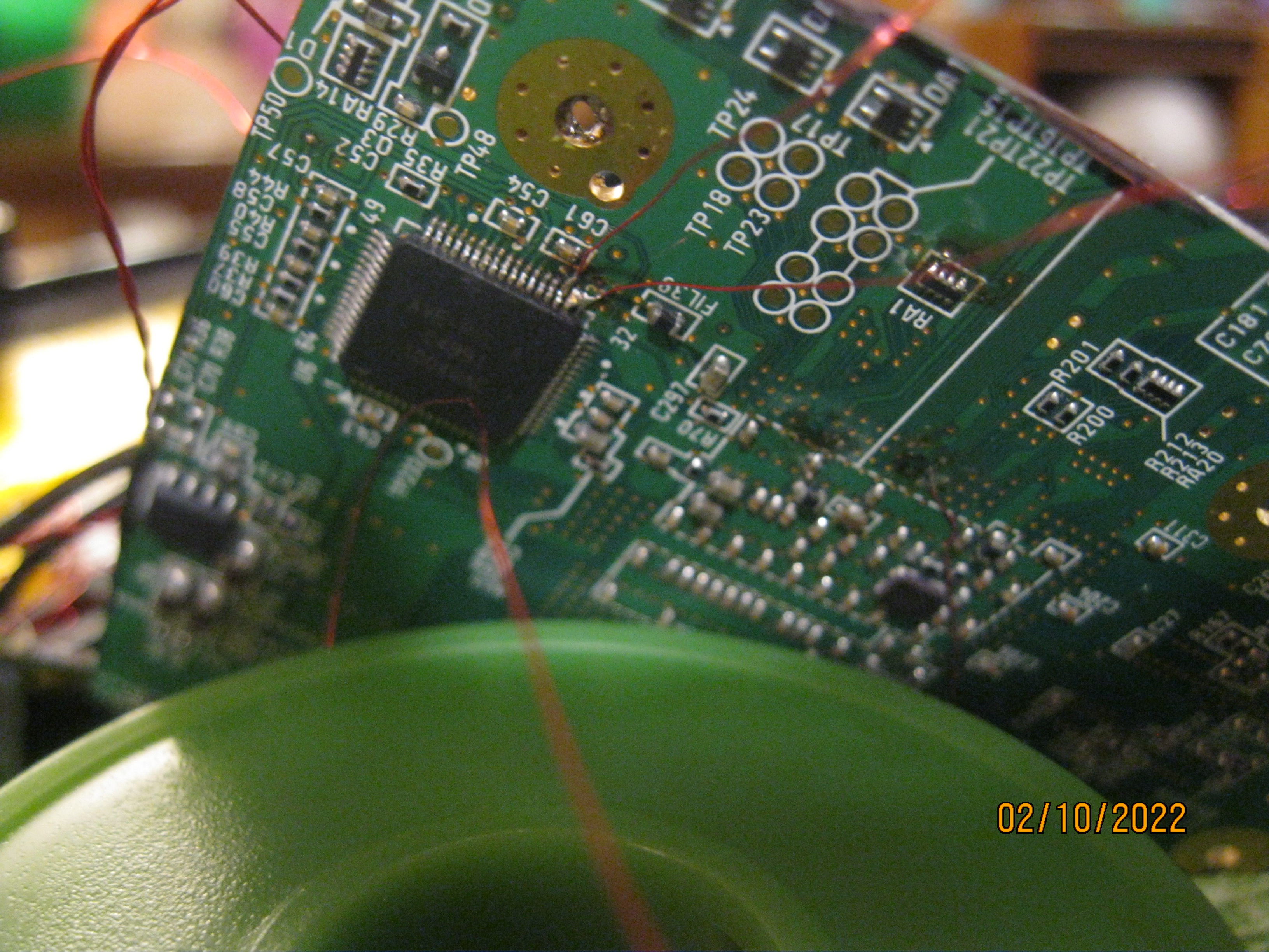

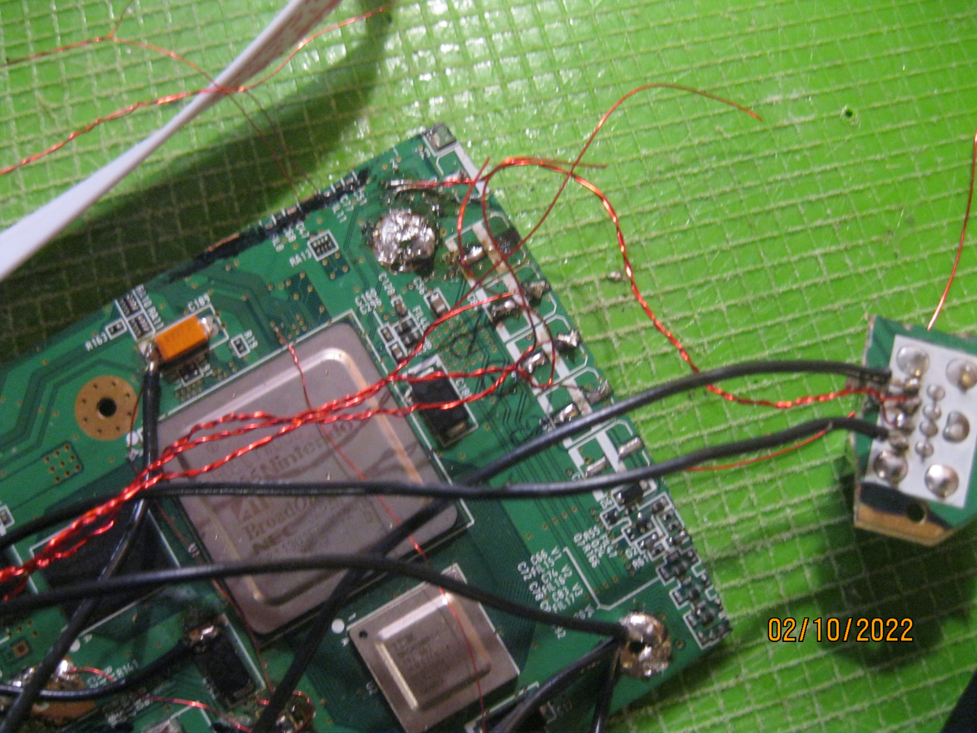

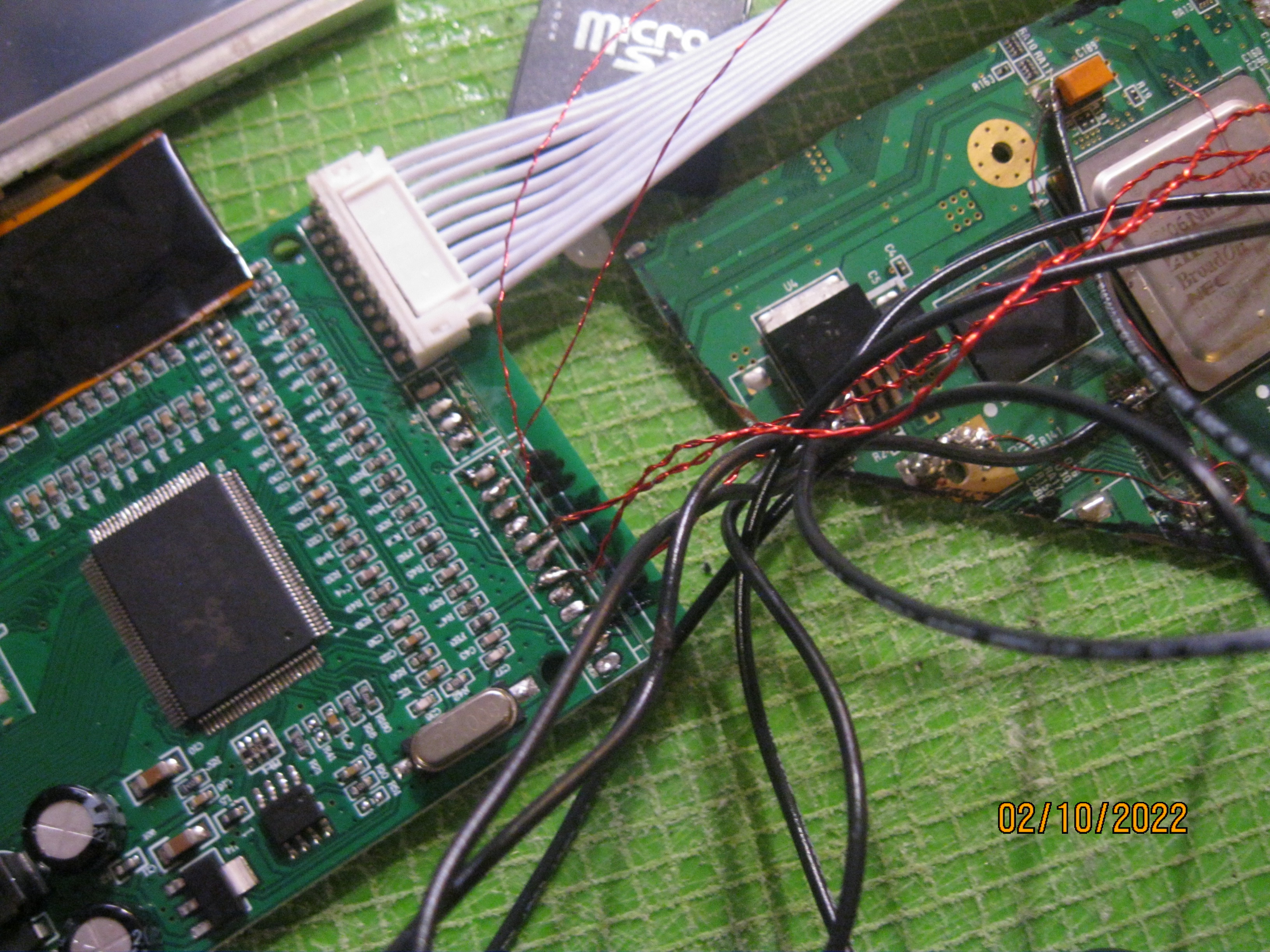

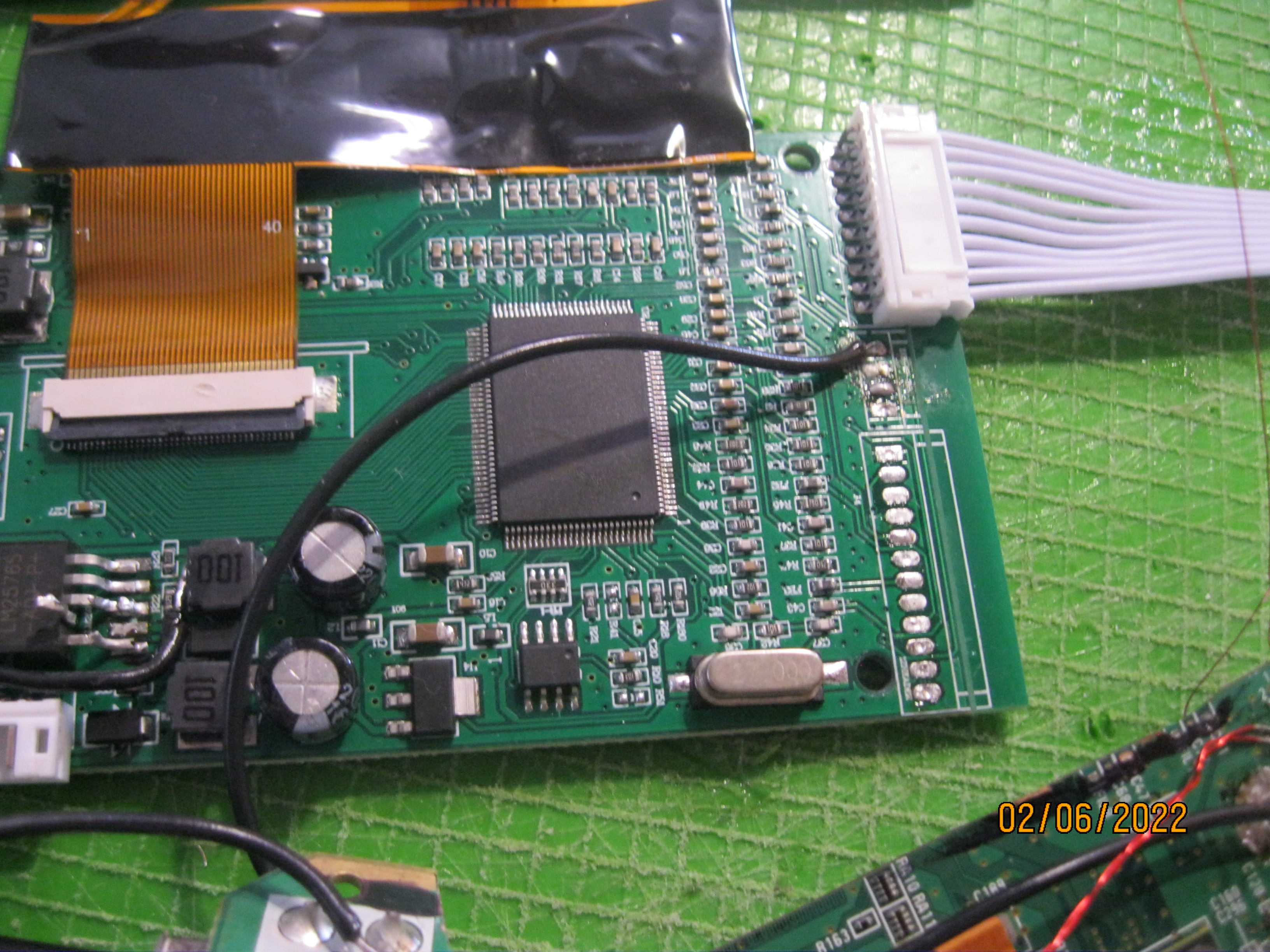

Got some photos!
I patched out VGA, like I said, and to make extra sure it was a hardware issue, I tried forcing VGA(R-L-Z-B) However, there is still no signal.
I twisted all my wires with GND, and I don't think the AVE is fried, so the only thing I'm guessing is a H/V sync short, if that would put VGA out of action.
No transient shorts, as far as I can tell.
Yes, I know the wiring's dirty, but it worked with composite before.
H and V synch don't visibly look shorted, but they don't particularly look great. Use a multimeter in continuity or resistance mode to check for a short between two lines. I would recommend checking resistance, as sometimes a resistance that is normal will still be below the threshold of what the DMM considers a short (not in the case of H/V sync, but still good practice). If you have 0 ohms between two lines, that's a dead short right there. Aside from that, all of those solder joints still look really cold, you really need to be using flux and a good, temperature controlled iron (I typically keep mine set to 650F/350C, 750F/400C for big planes). Having the ability to know that your solder joints are all solid is key in being able to track this issue down.

Just making sure, you have connected Mode to 3.3v to enable VGA out, yes?
The picture of the underside of your Wii is a bit funky, but I don't see a wire going to the Mode pad
OH!!!! You need to connect mode to 3.3v?
I didnt know that! I'll do that!
It's in the Definitive Trimming Guide, might not be written in the manual entry
Yeah, I must've missed that in the trimming guide. I found it now!
