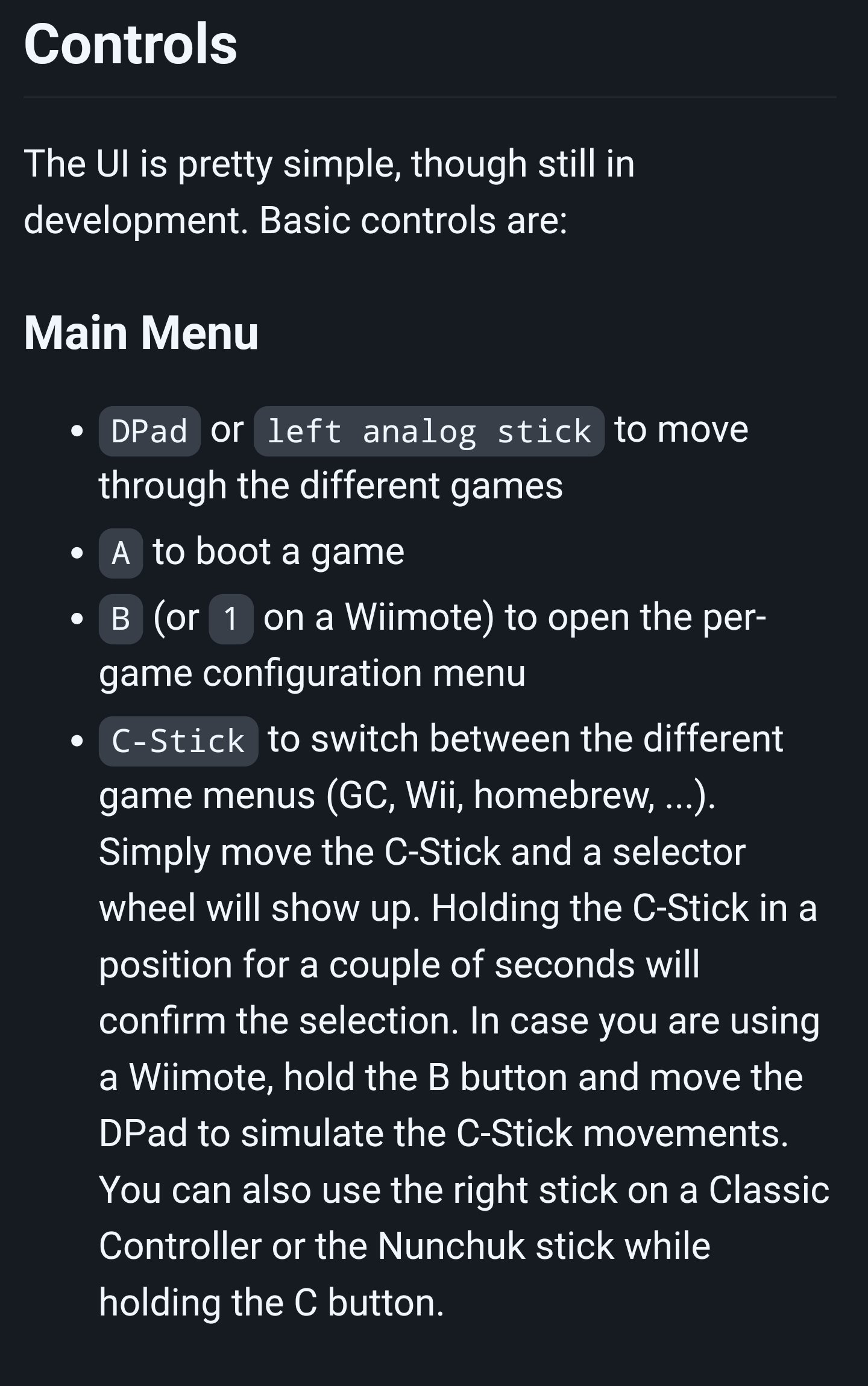

Just to point out pressing and holding B on the Wiimote then pressing the dpad will allow you to use the radial menu without a nunchuk or classic controller
I have learned a thing!
thanks i did it ,it works as you said without a nunchuck
