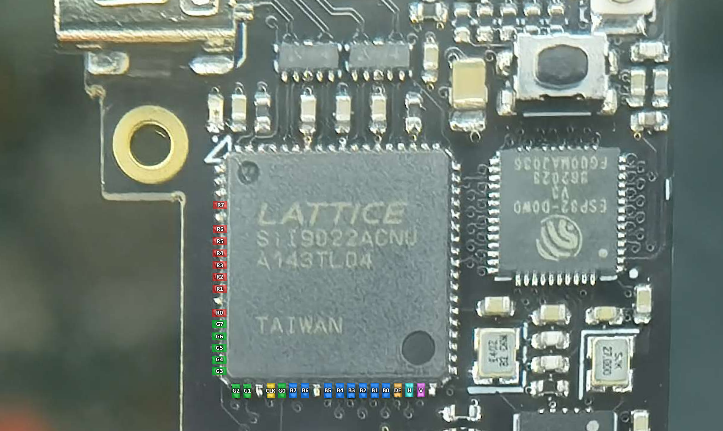

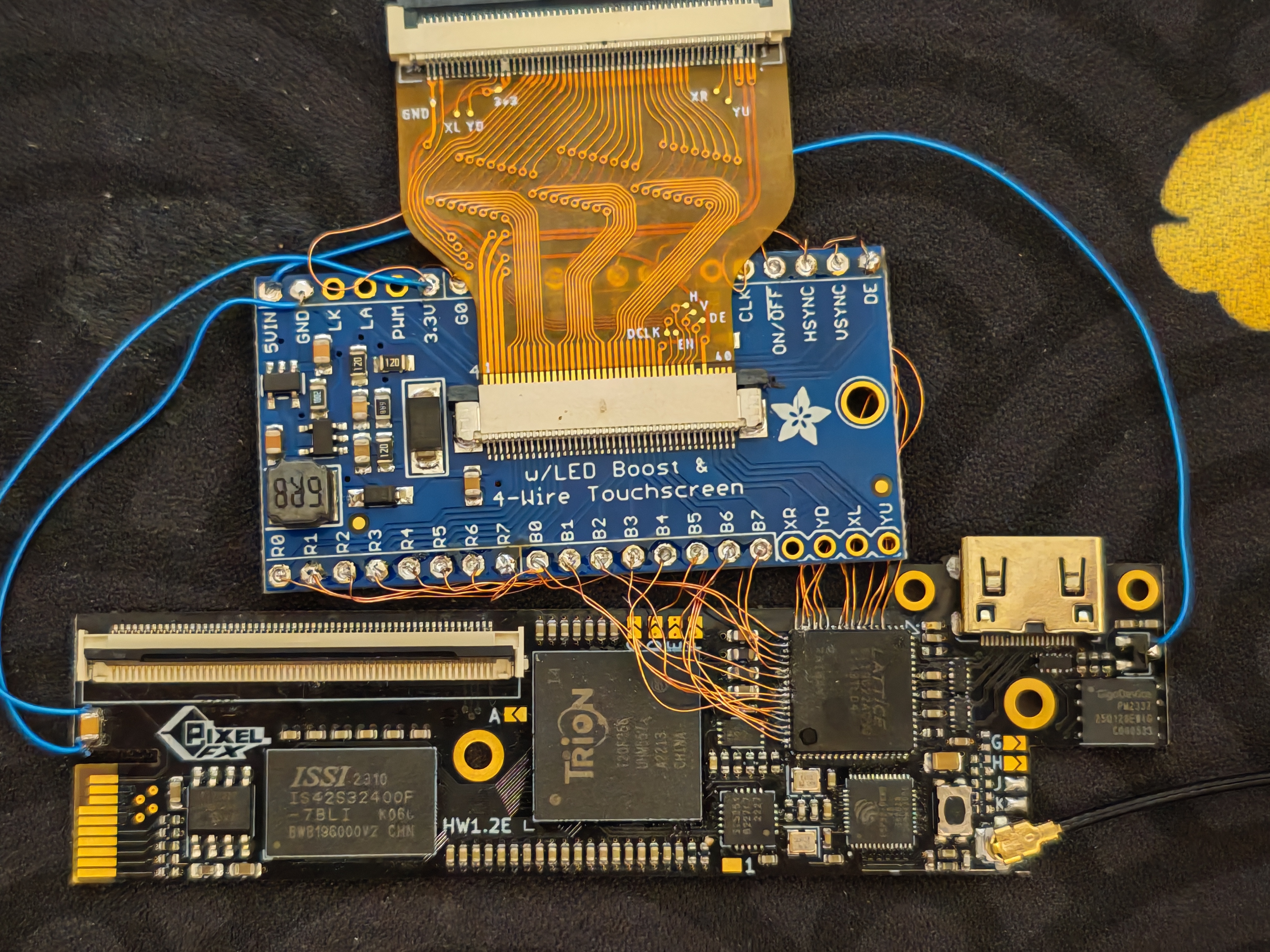

The HDMI transmitter is outlined in red. You can keep it, or remove it. If you keep it, it will draw extra power despite being unused. However, removing it can make it harder to debug issues since you can't connect to an external monitor anymore. Up to you.
The above diagram shows the locations of the 24-bit RGB signals, CLK, DE, and HSYNC/VSYNC. 3.3V, 5V, and GND are also called out on the board pic.

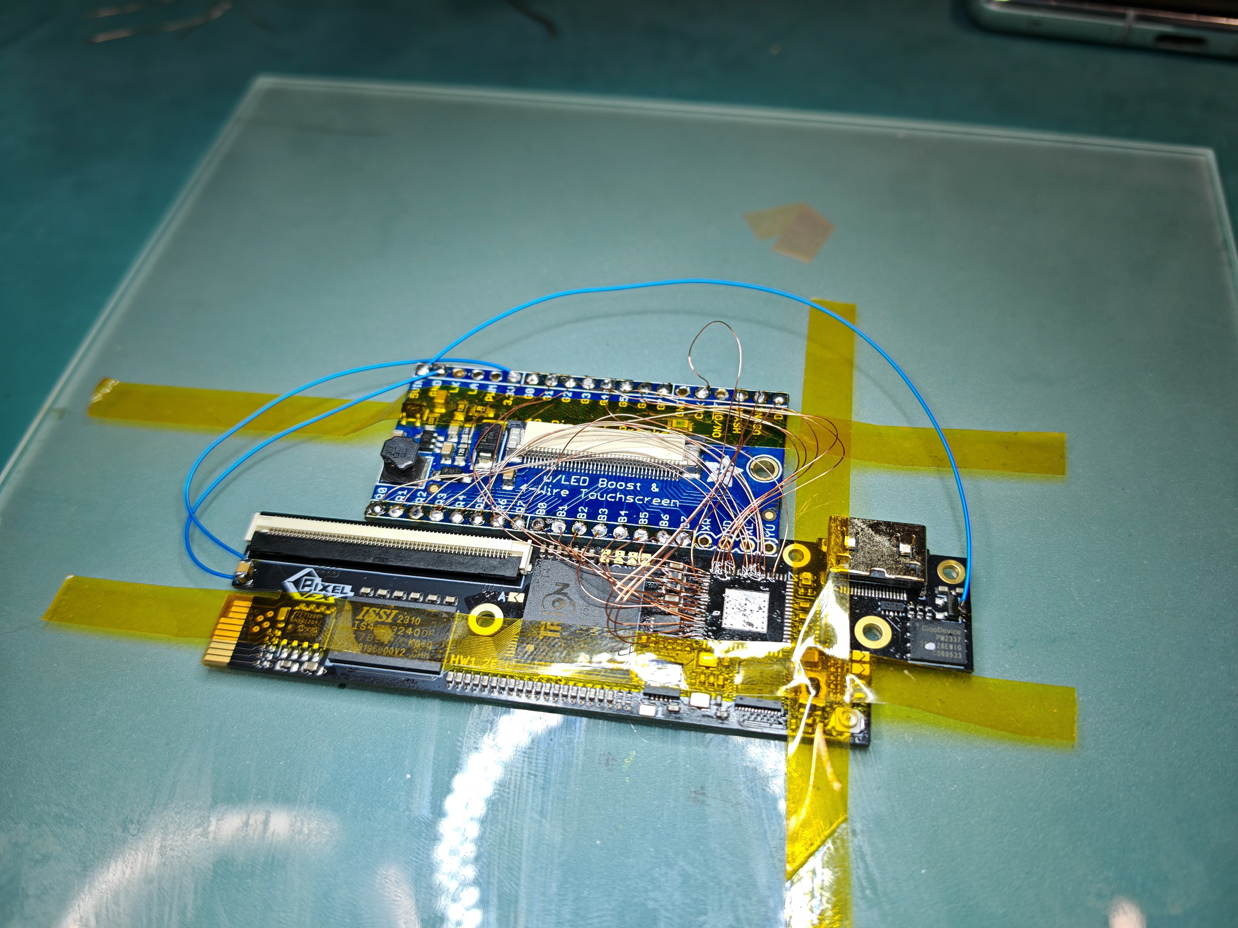

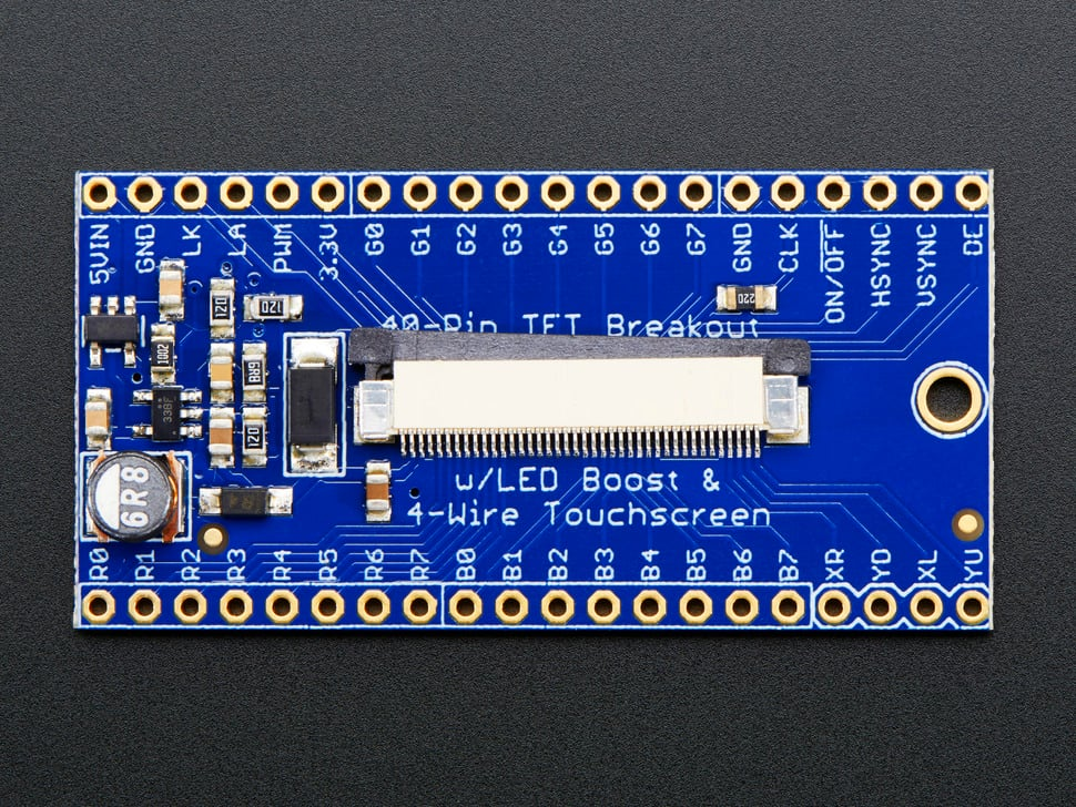

I suggest using an Adafruit TFT Friend for wiring up your LCD. It has a gross slide ZIF, but it's easy to use and nicely labeled. Note that 800x480 LCDs need the ON/OFF pin tied to 3.3V!!!

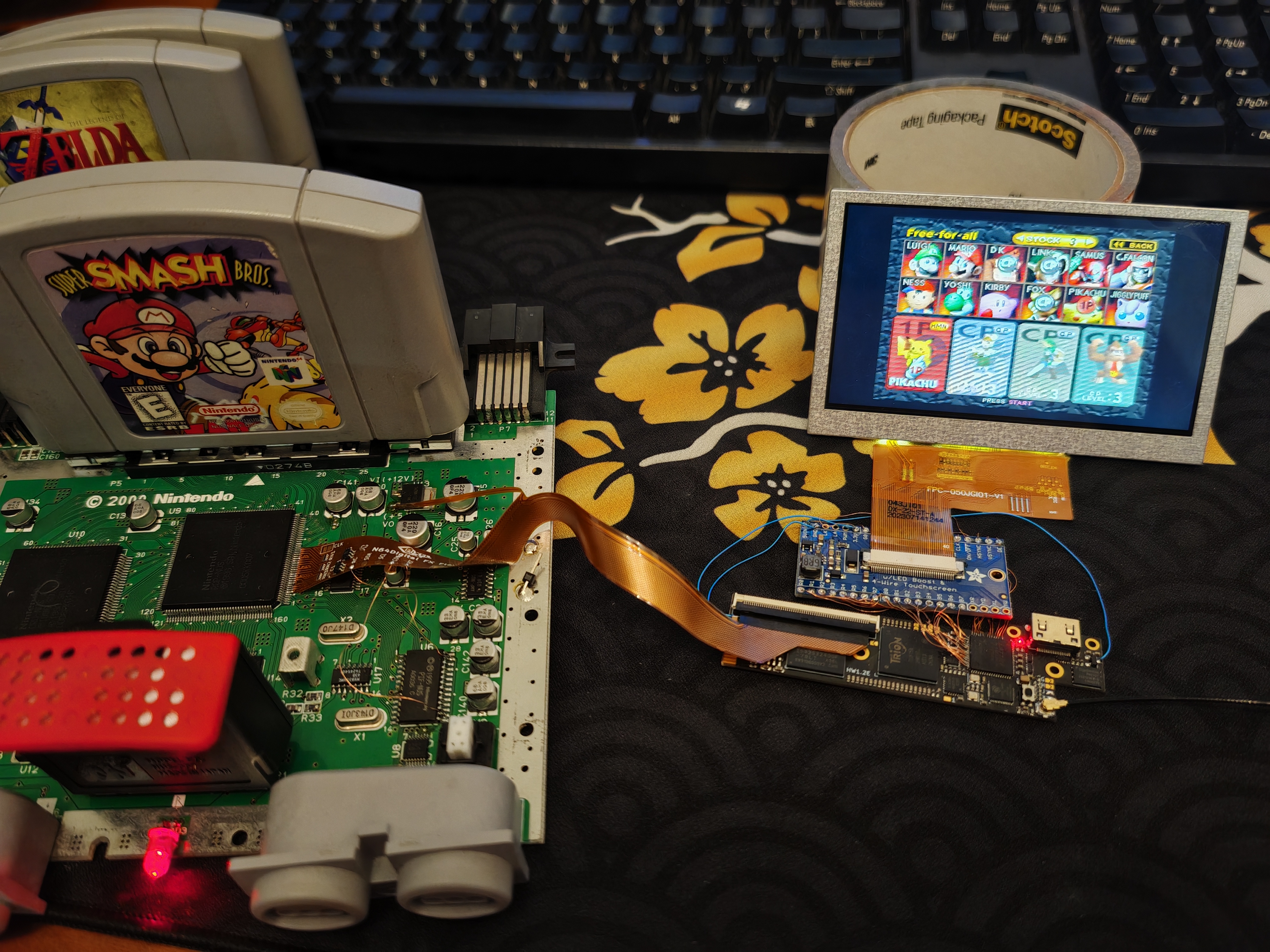

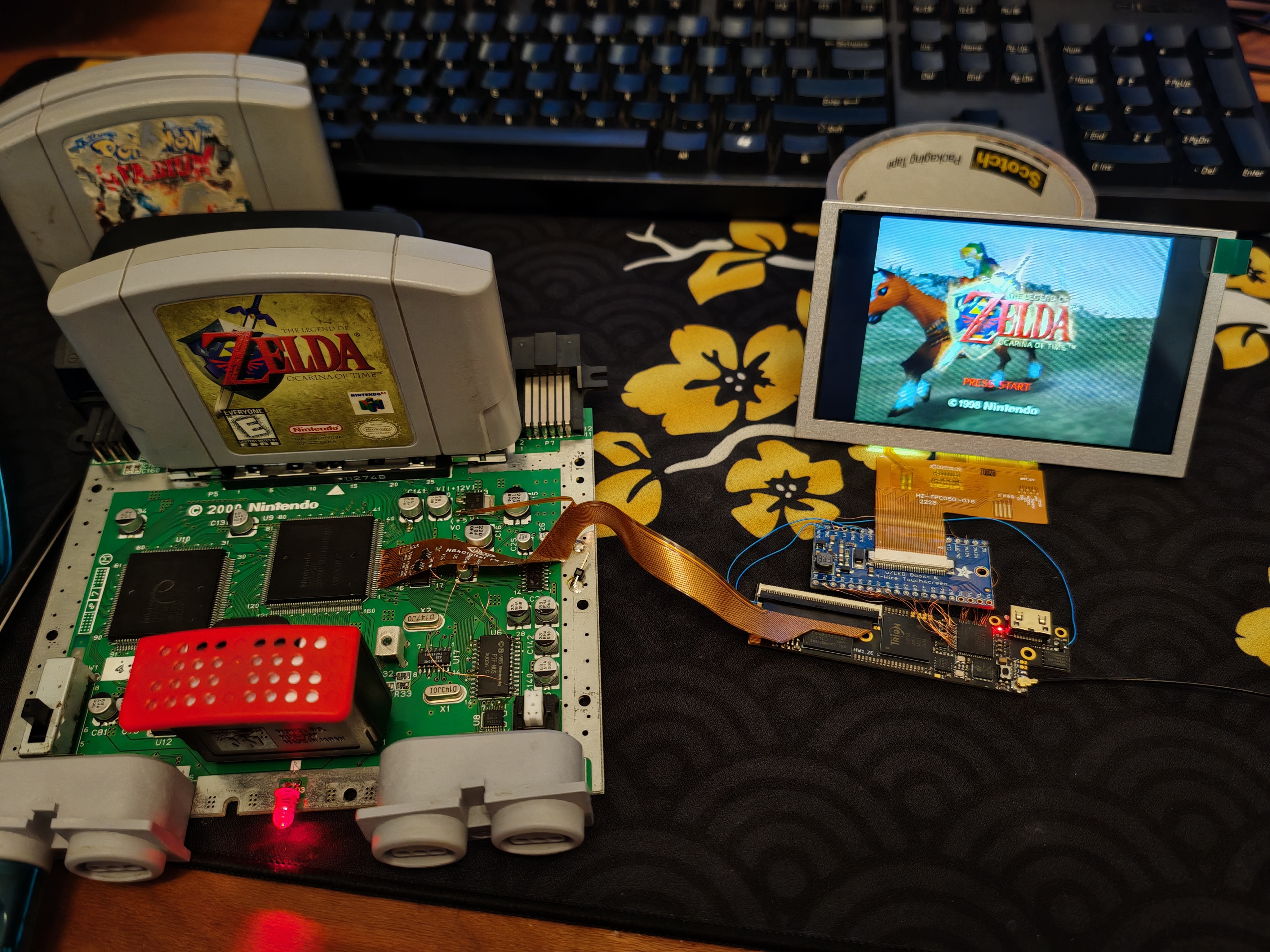

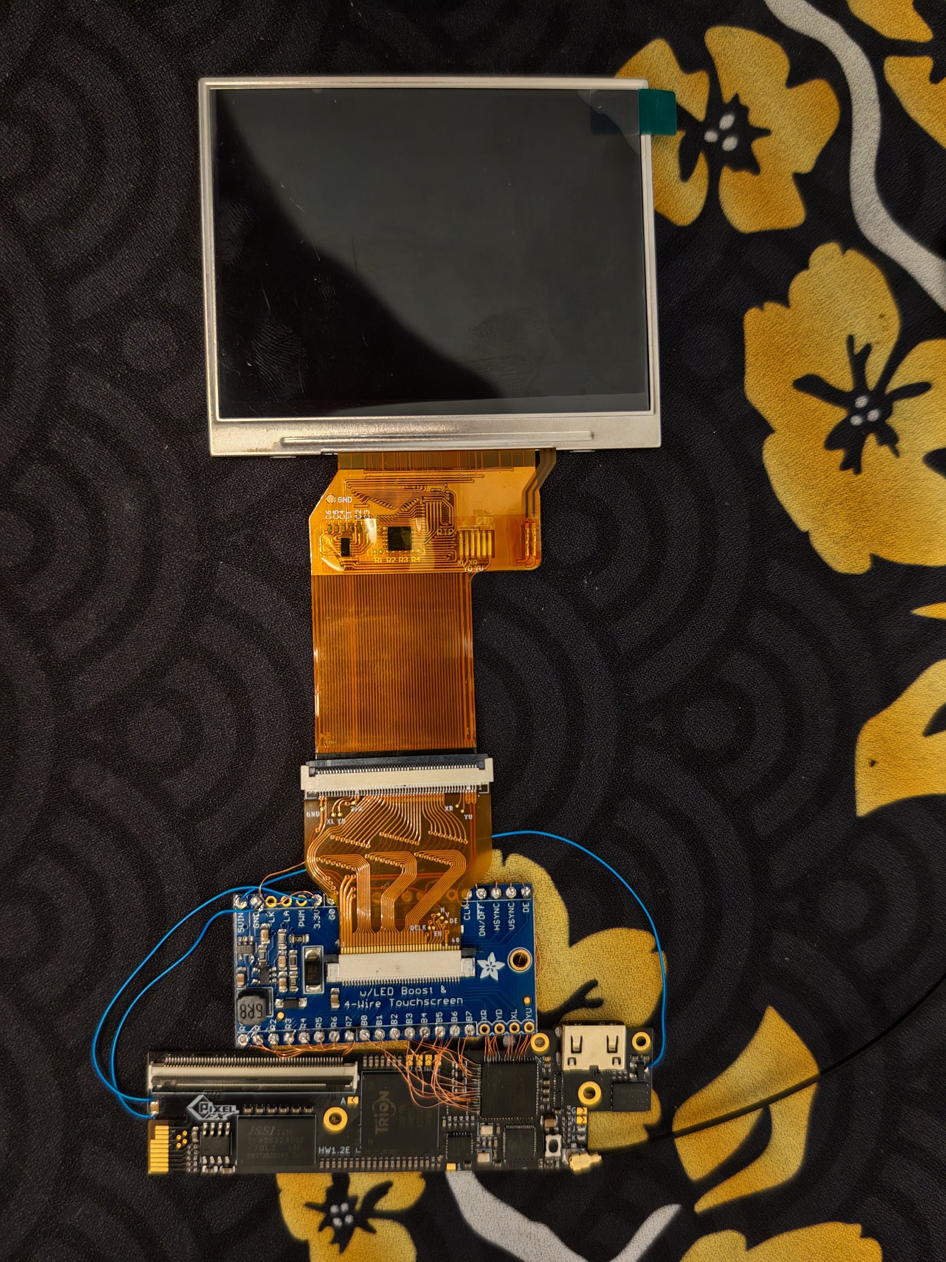

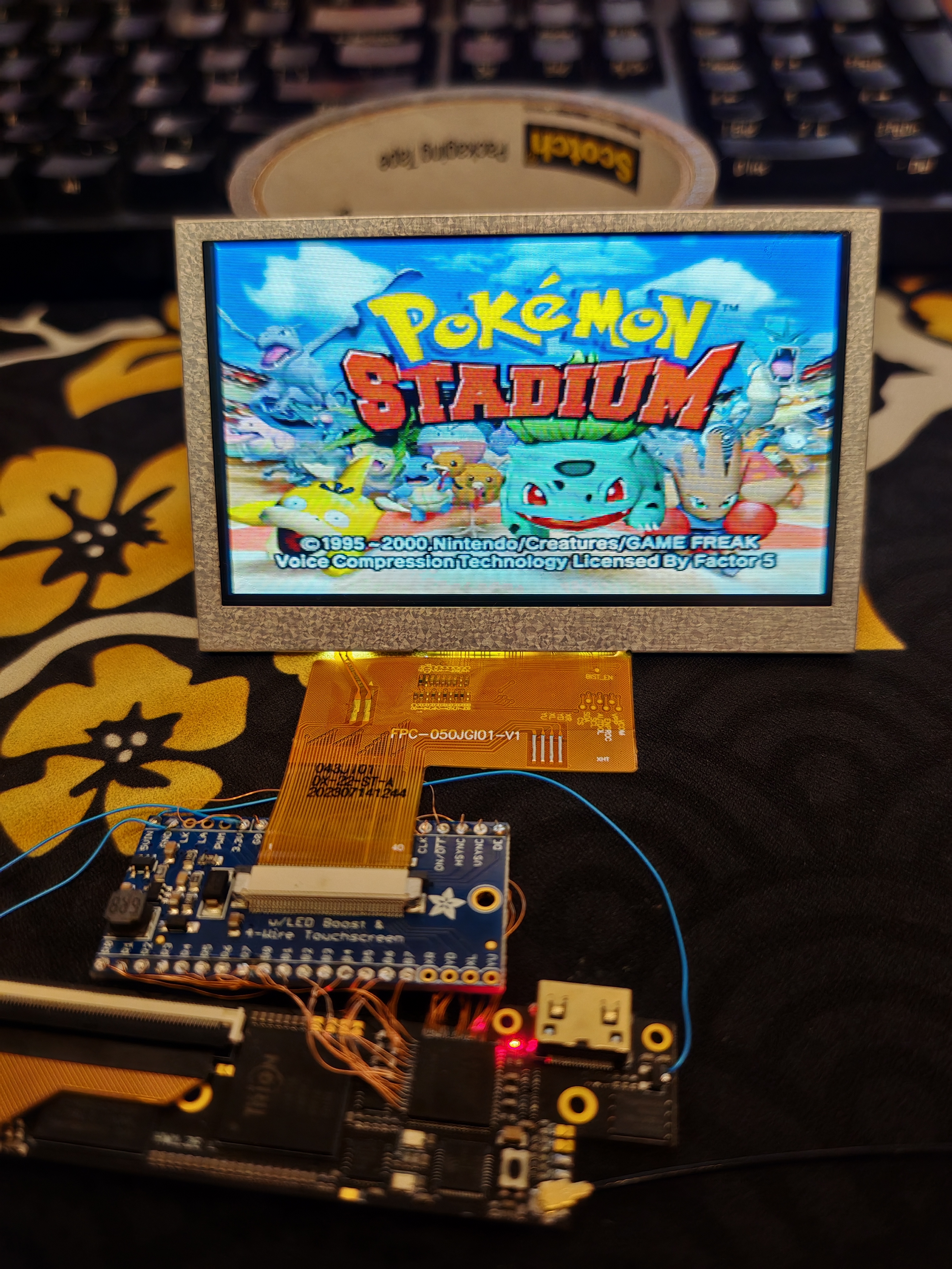

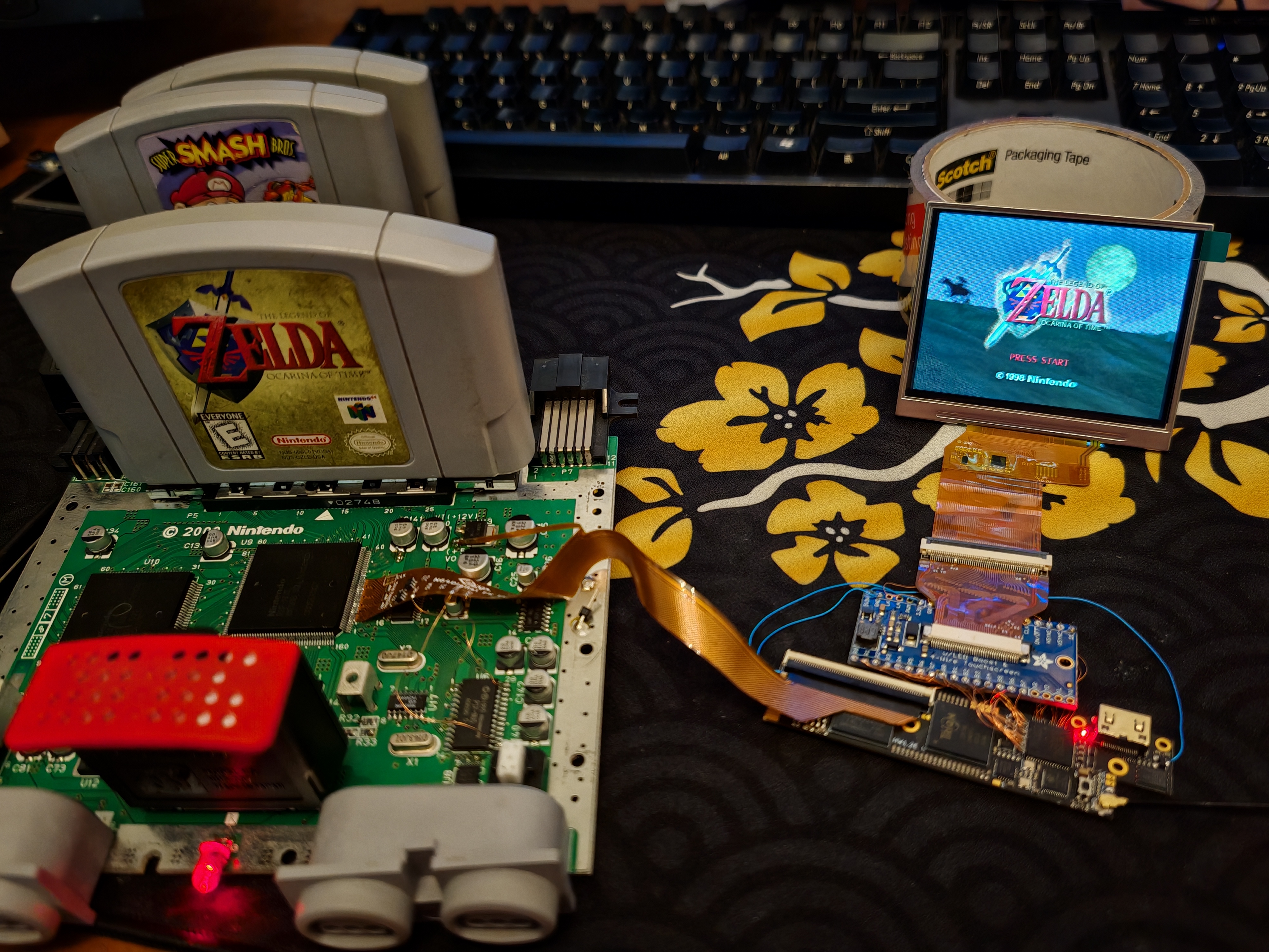

Some pics of how the GEM and TFT Friend might look after wiring:

  • 5" 800x480: BuyDisplay IPS panel with ST7265 driver works

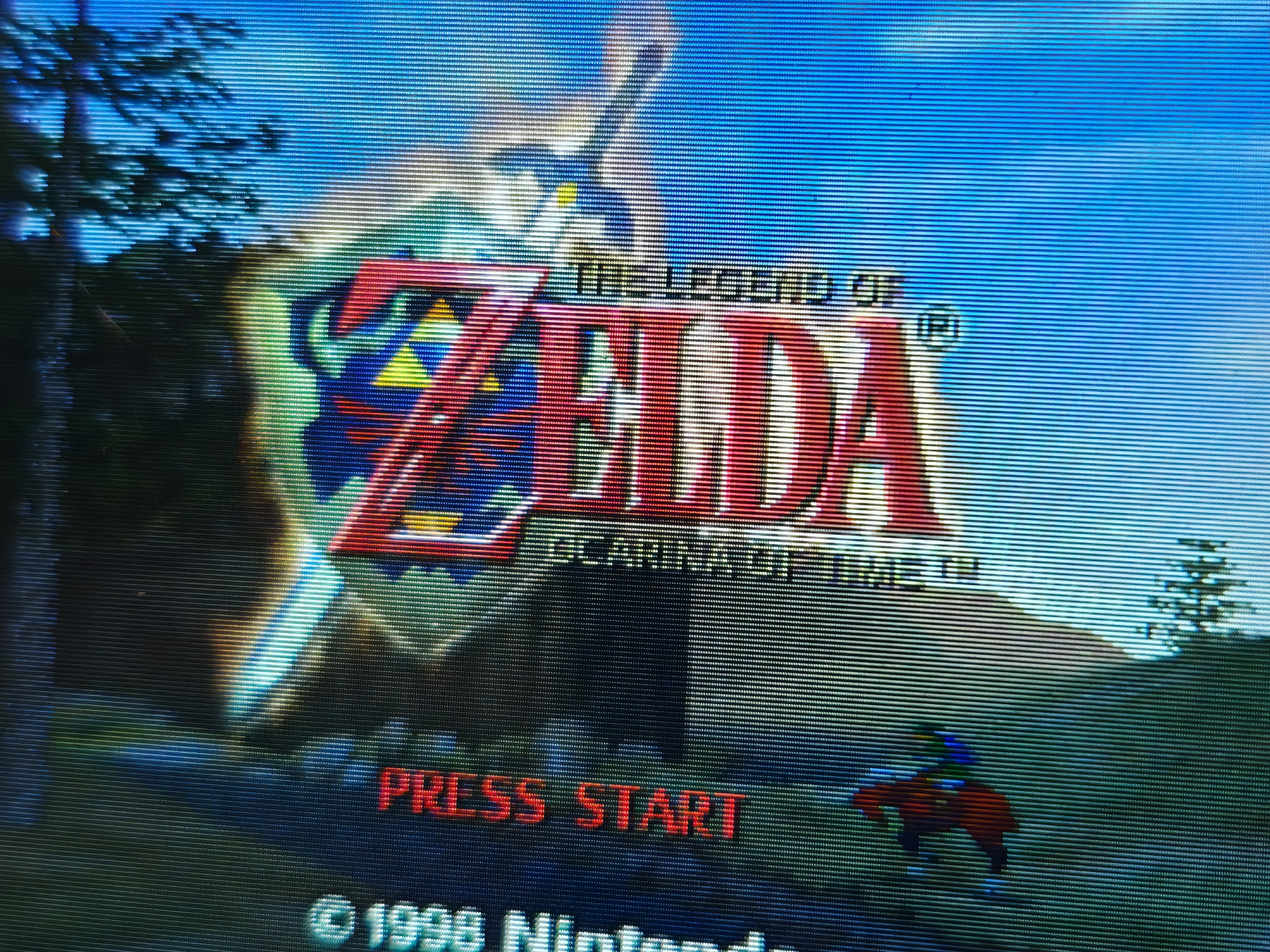

When configured this way, the GEM produces an impeccably crisp, pixel perfect image! Enabling full-strength scanlines in the Retro FX menu cleans up the image a lot.

4.3" 800x480 LCD:

3.5" 640x480 LCD:

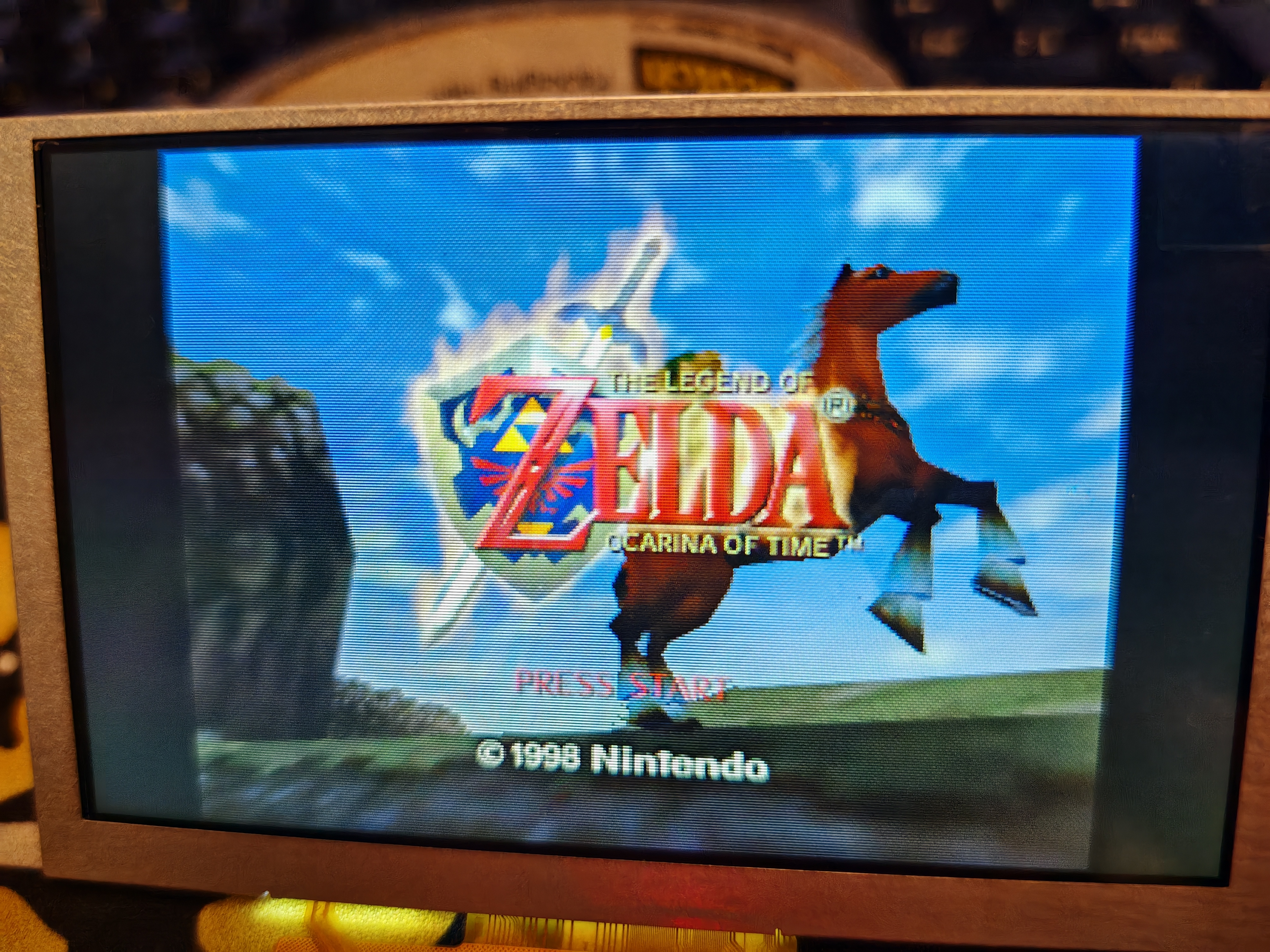

By tuning the horizontal porches on the modelines, I was able to get the fancy deinterlacers working. So 480i content on PS2, PS1, and N64 should look decent if you select a deinterlacer other than bob. The bob deinterlacer on firmware 2.6.x works with just about any horizontal porches, so it's an OK fallback. But it exhibits the characteristic 30Hz flicker of all bobbing and looks pretty bad.

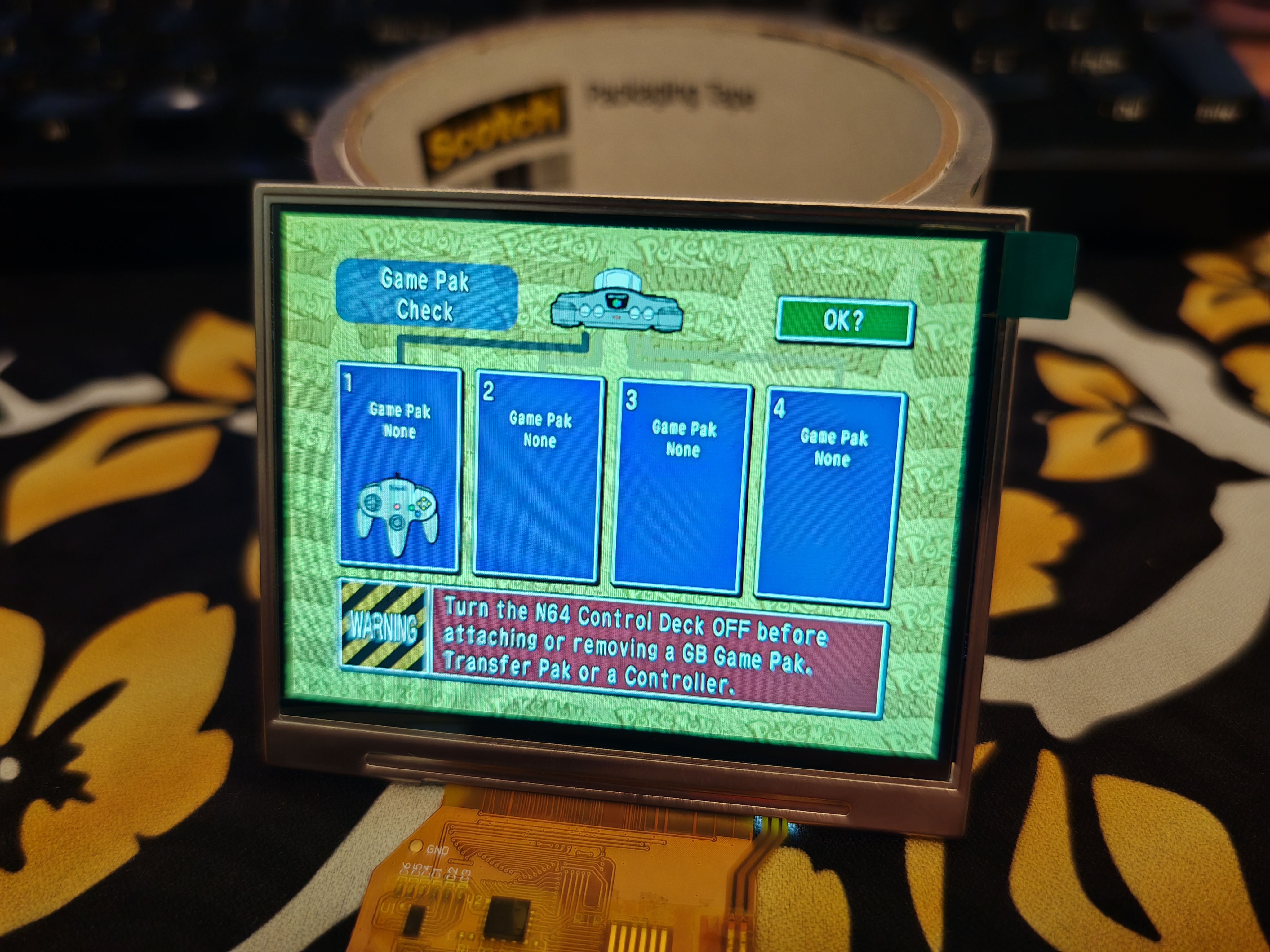

Weave looks amazing for static 480i content like UIs and menus (seen below). PS2 probably needs motion adaptive to look decent.

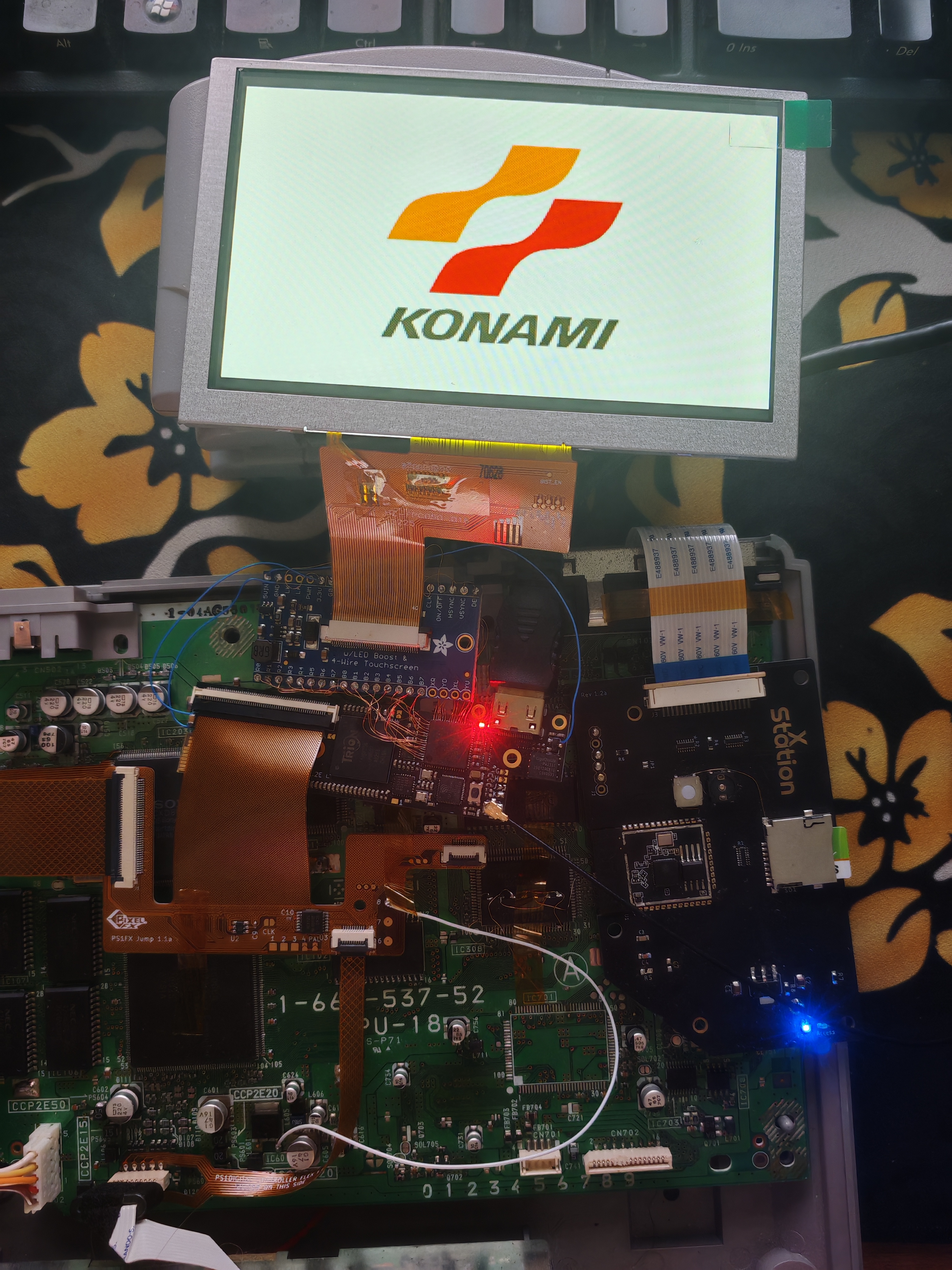

You the man for discovering this! Glad to have been able to test this, it is truly the best video quality available. I tested the Hispeedido HDMI, GBS Control via RGBS, and direct RGBS from the N64 itself and this RetroGem was the best. I'll post pics of other consoles using this direct drive solution sometime soon.

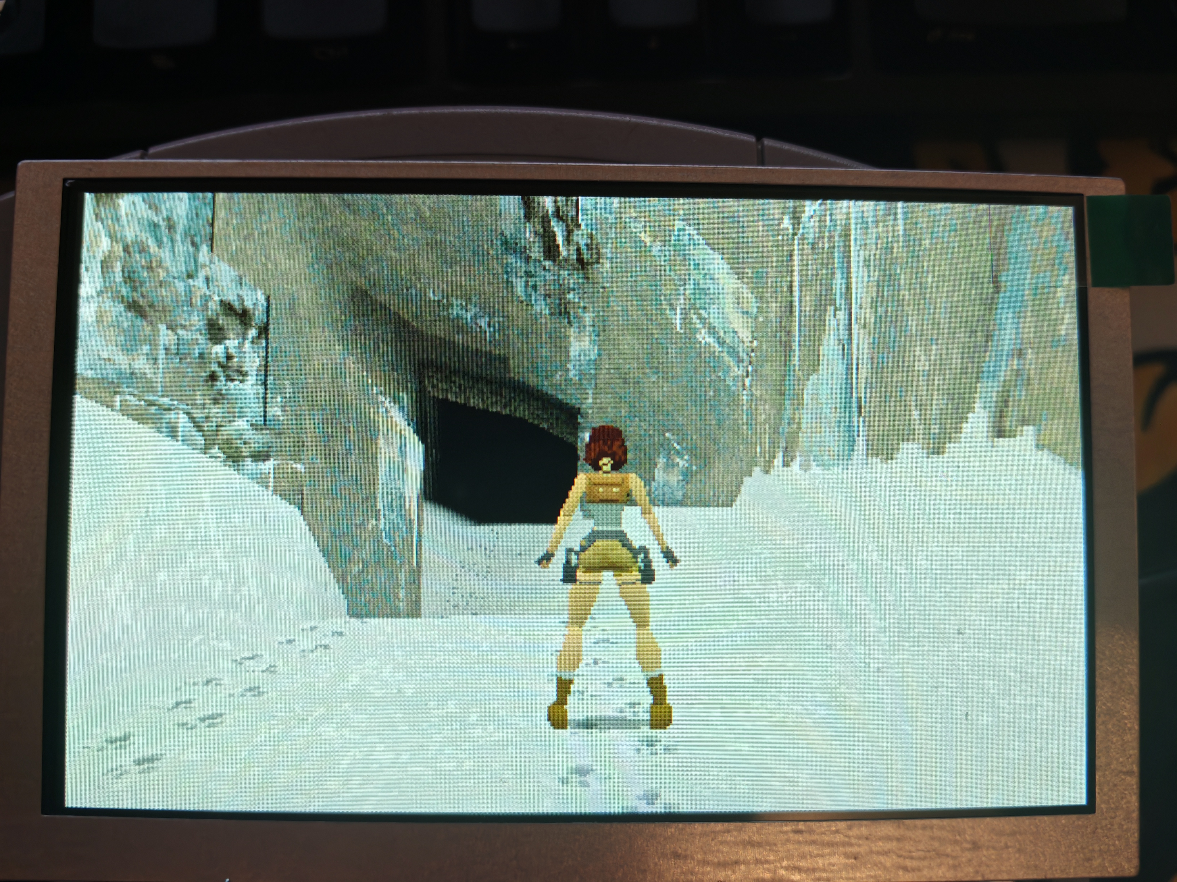

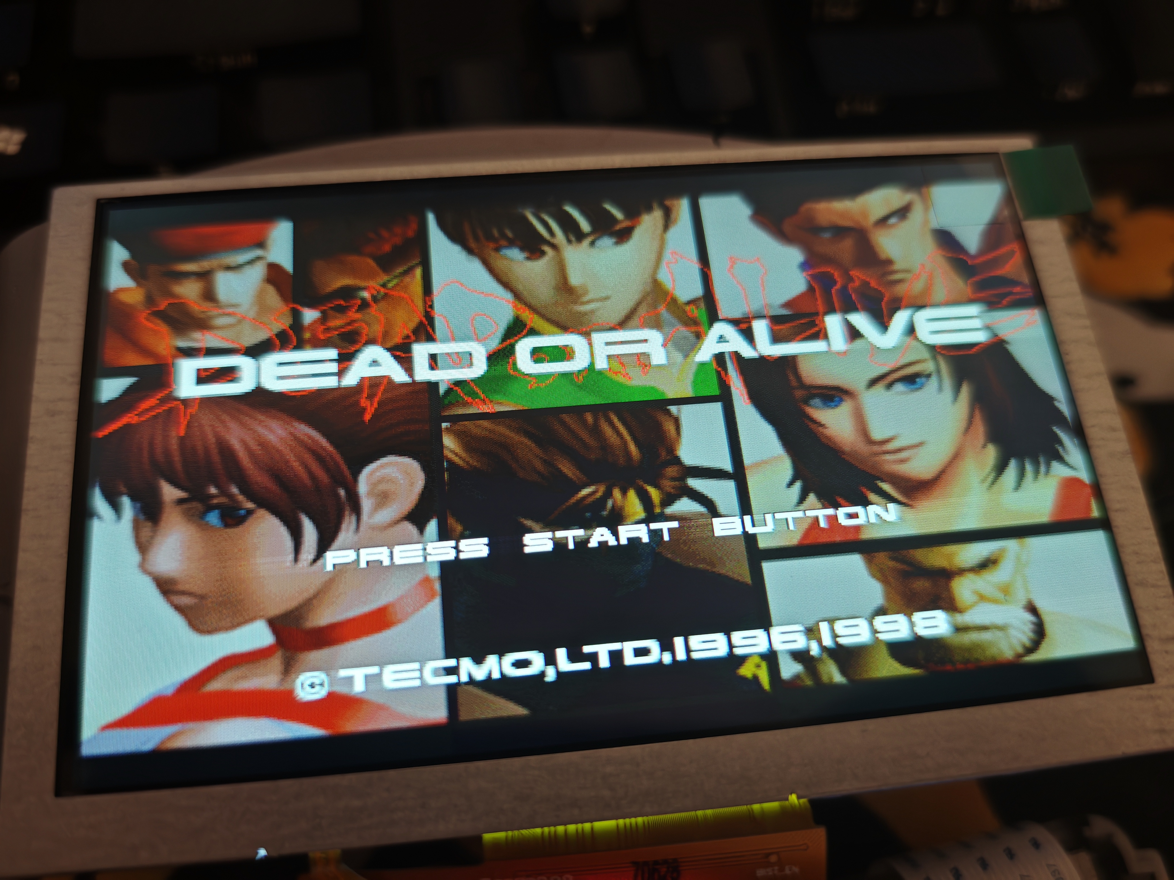

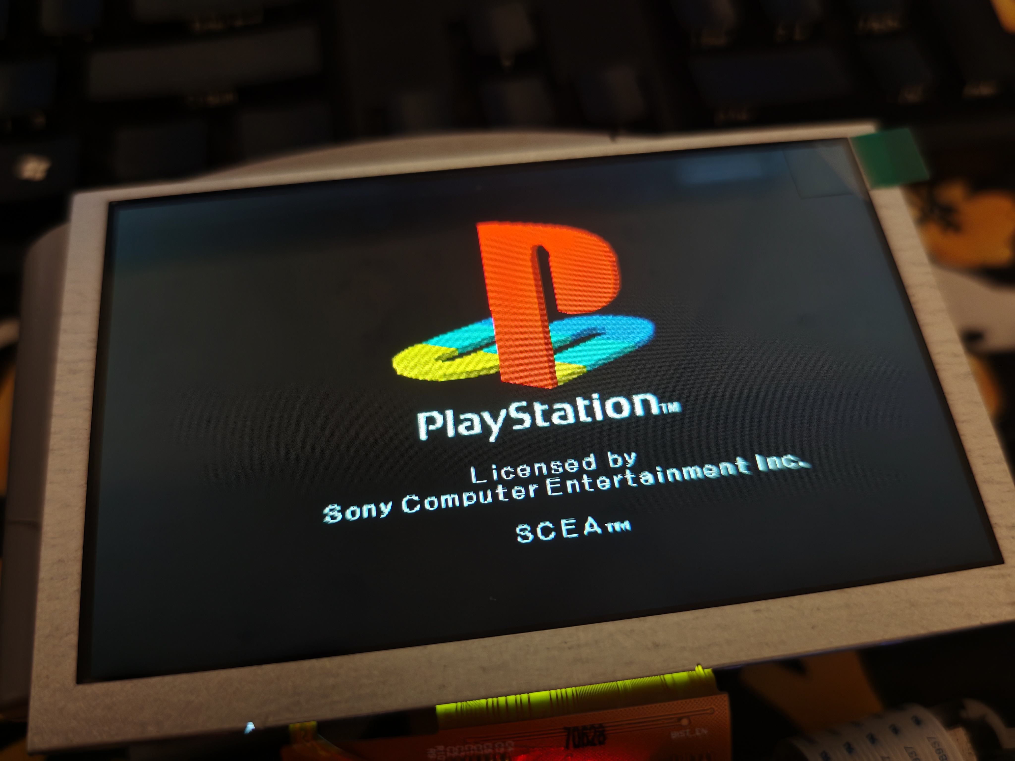

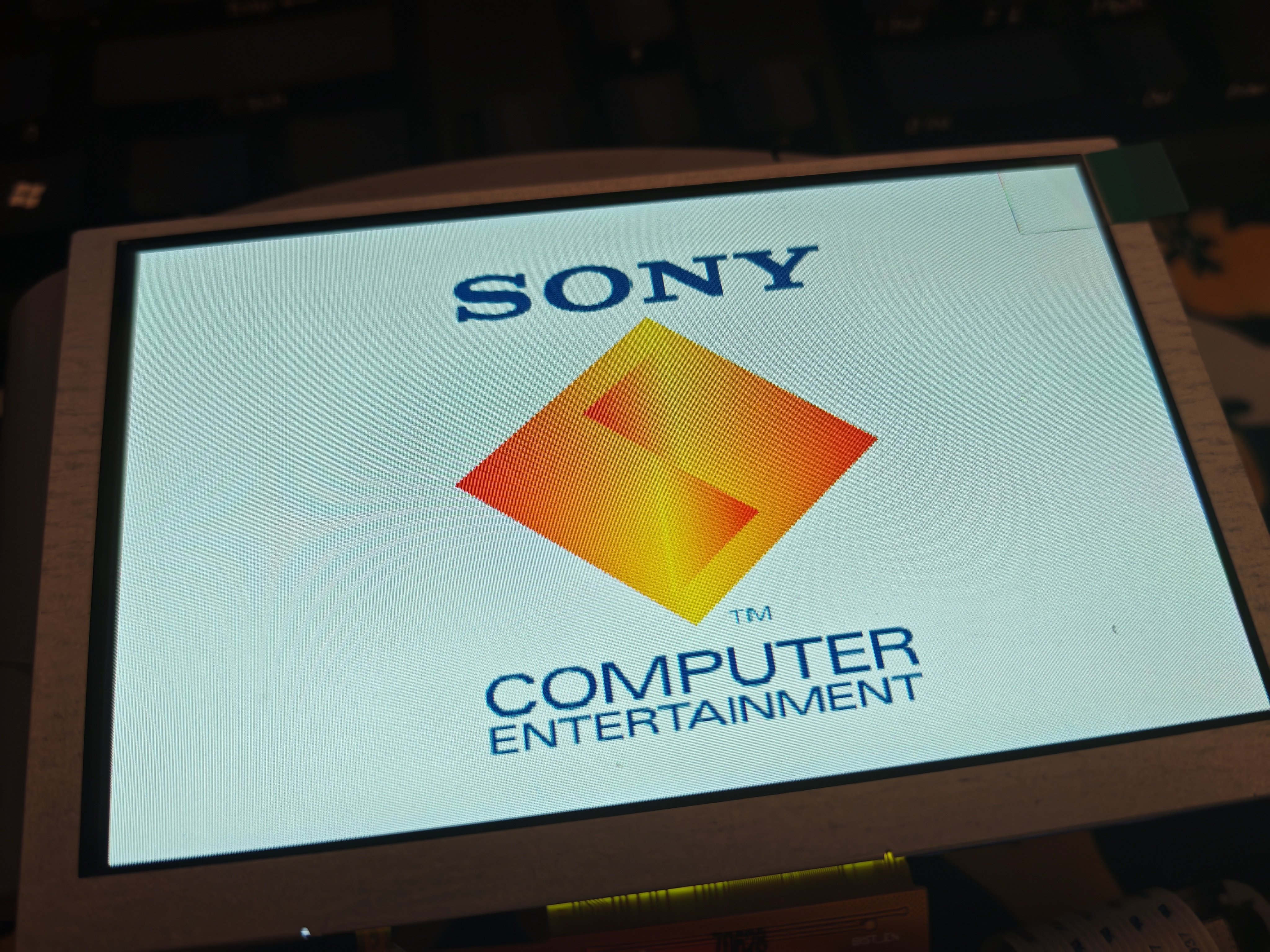

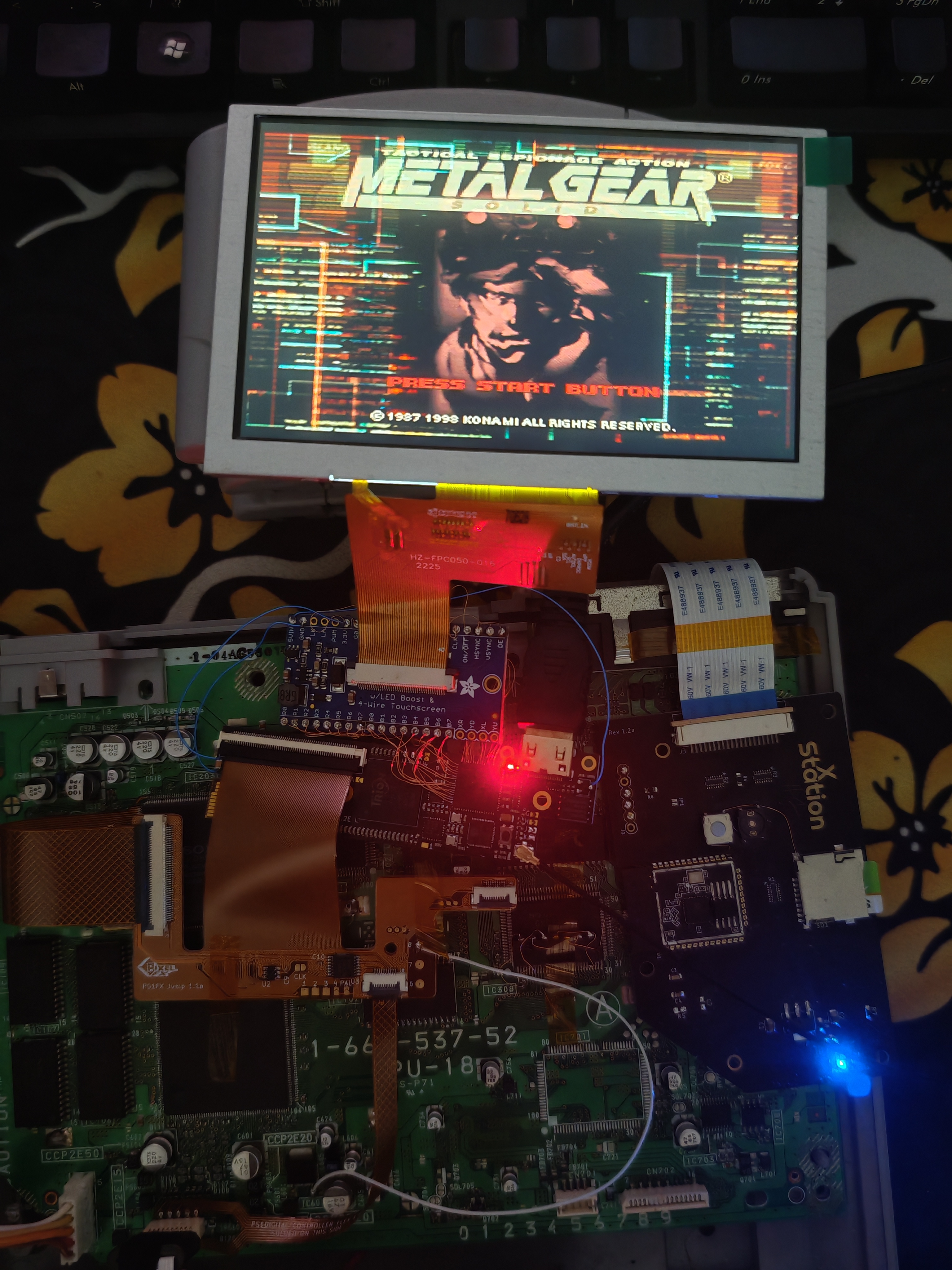

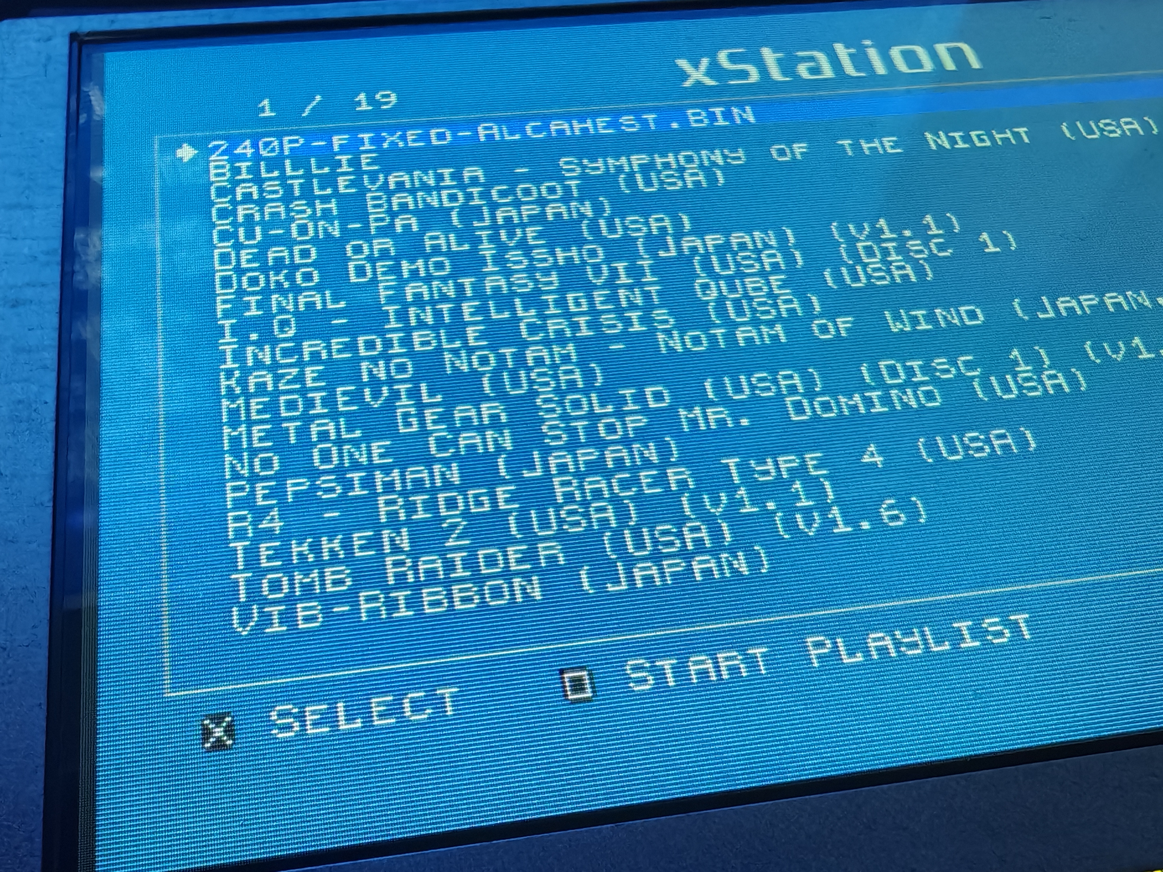

I have confirmed that both of the custom modelines work perfectly on PS1.
The 3.5" LCD is difficult to photograph. Hopefully the sharpness comes across in this 4K recording. The motion clarity and crispness are truly unbelievable.

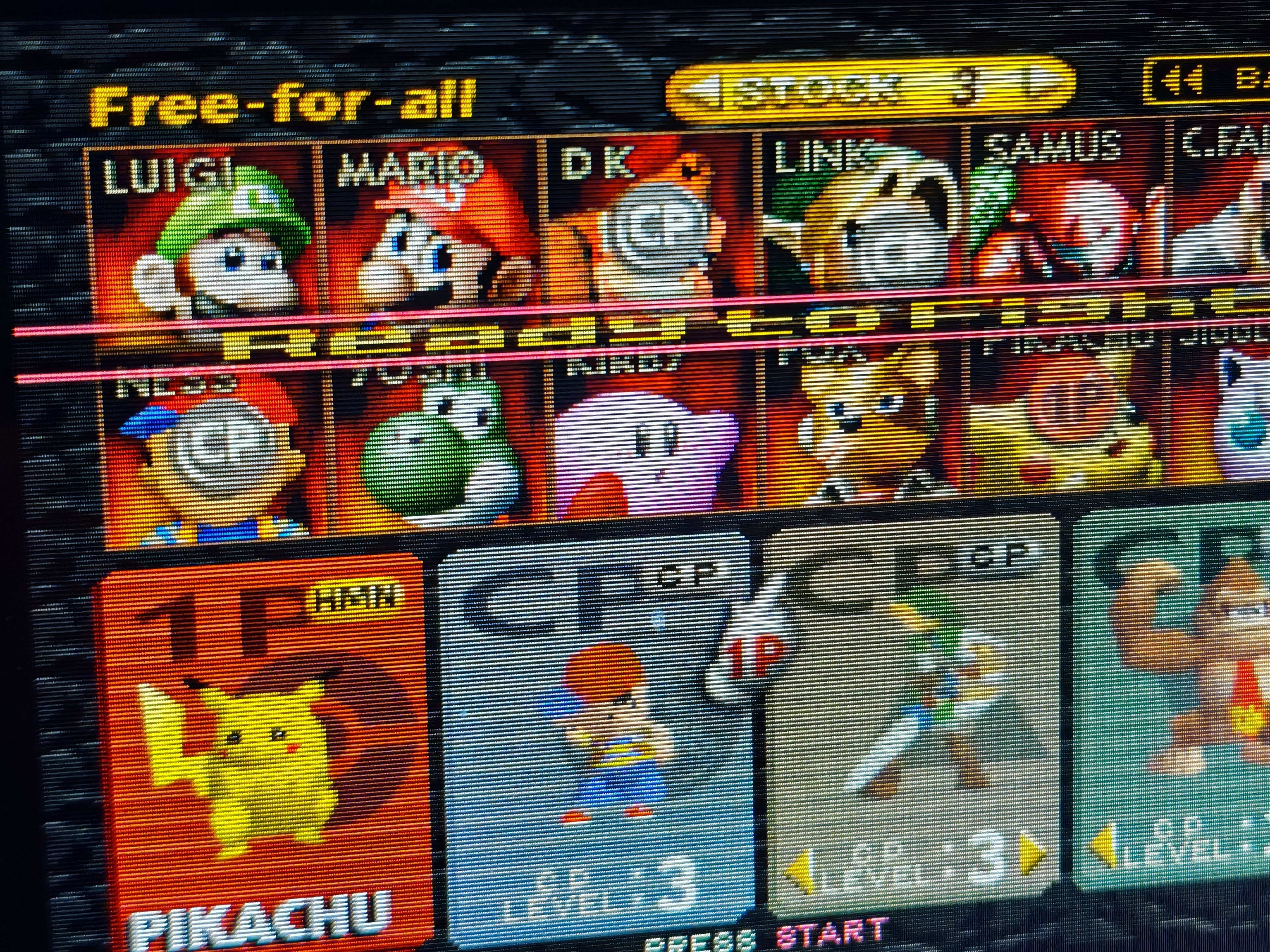

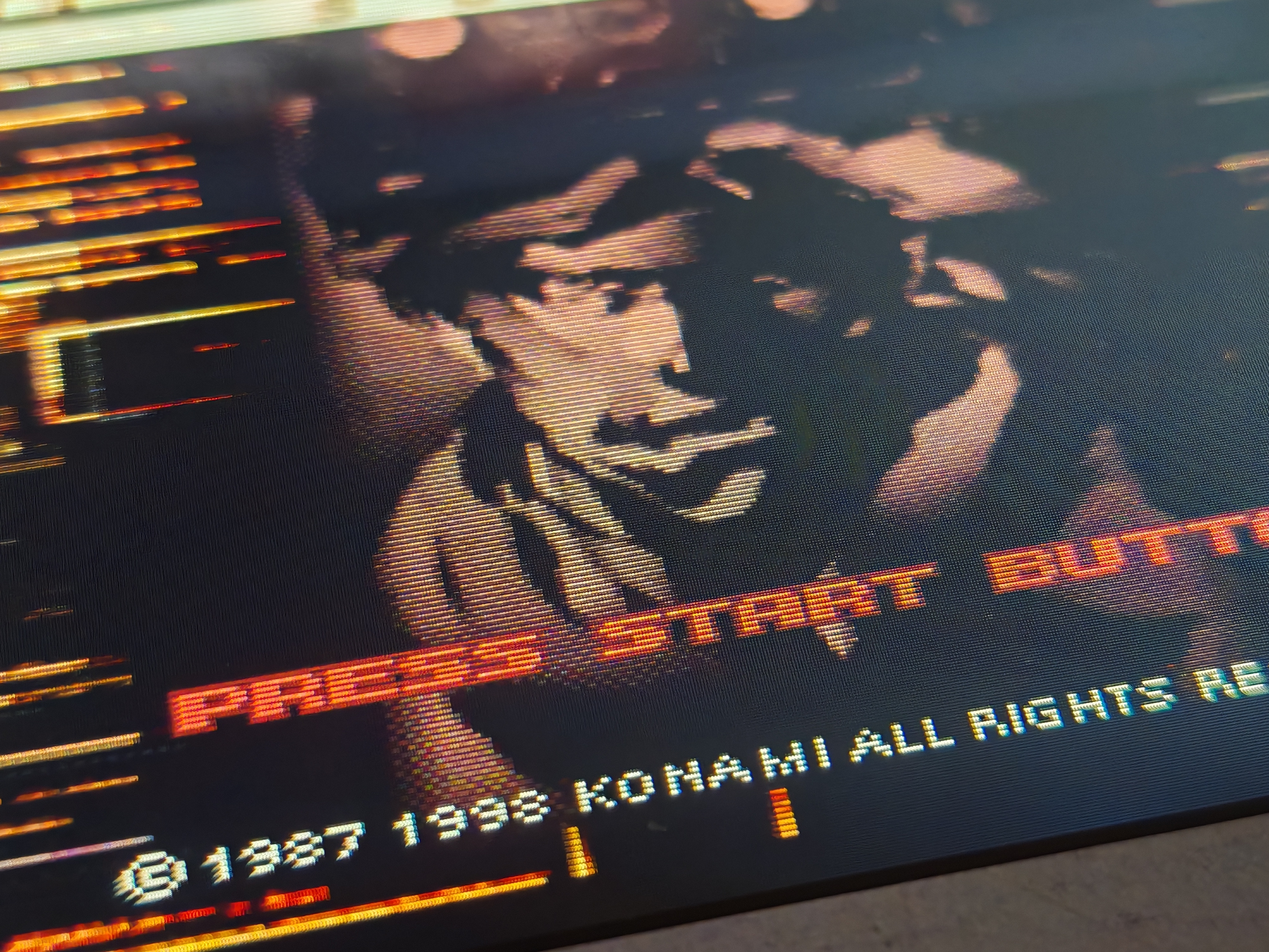

Close-up of scanlines on the 3.5" LCD:

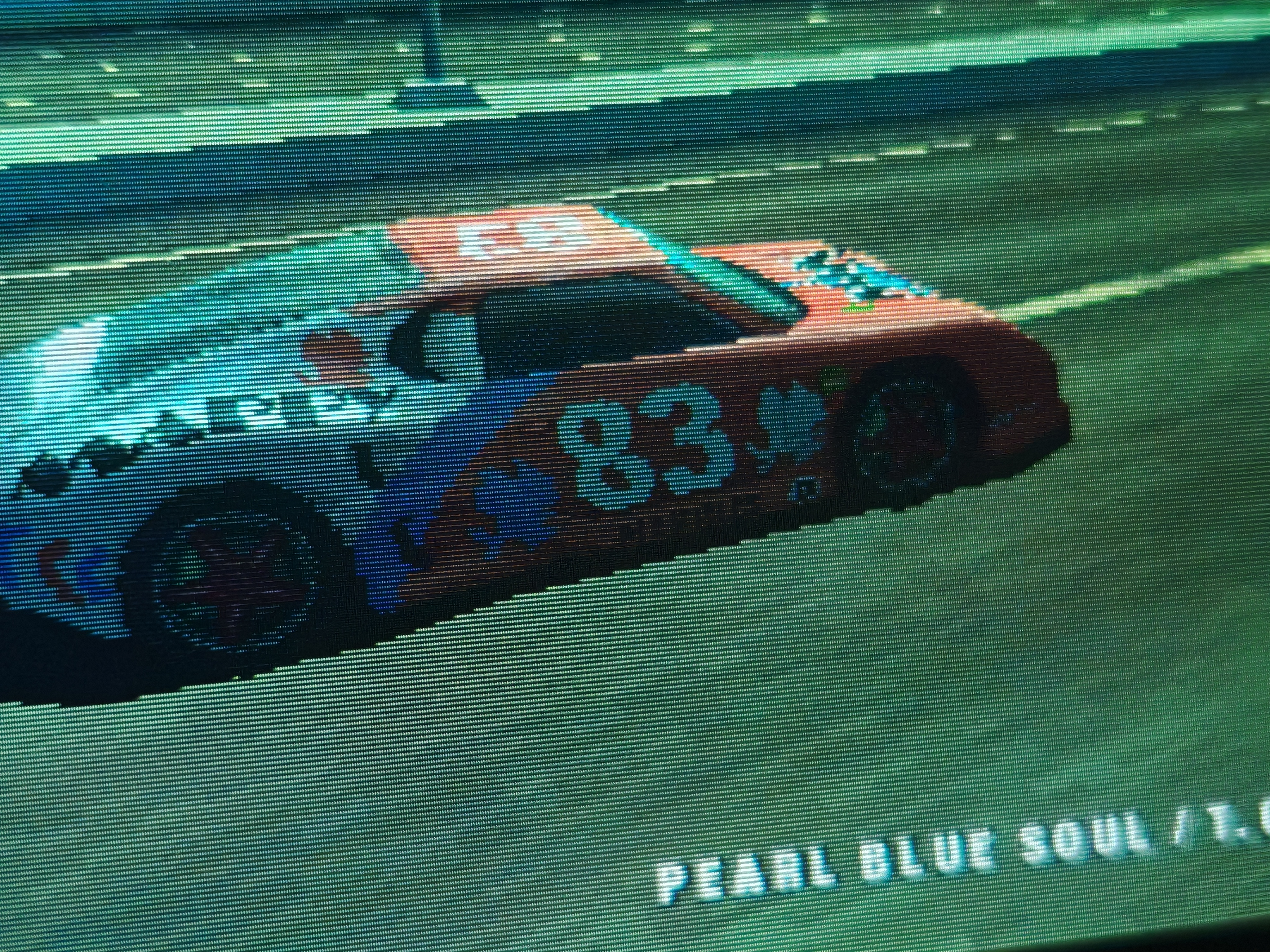

Some scanline close-ups on the 5" 800x480 LCD:

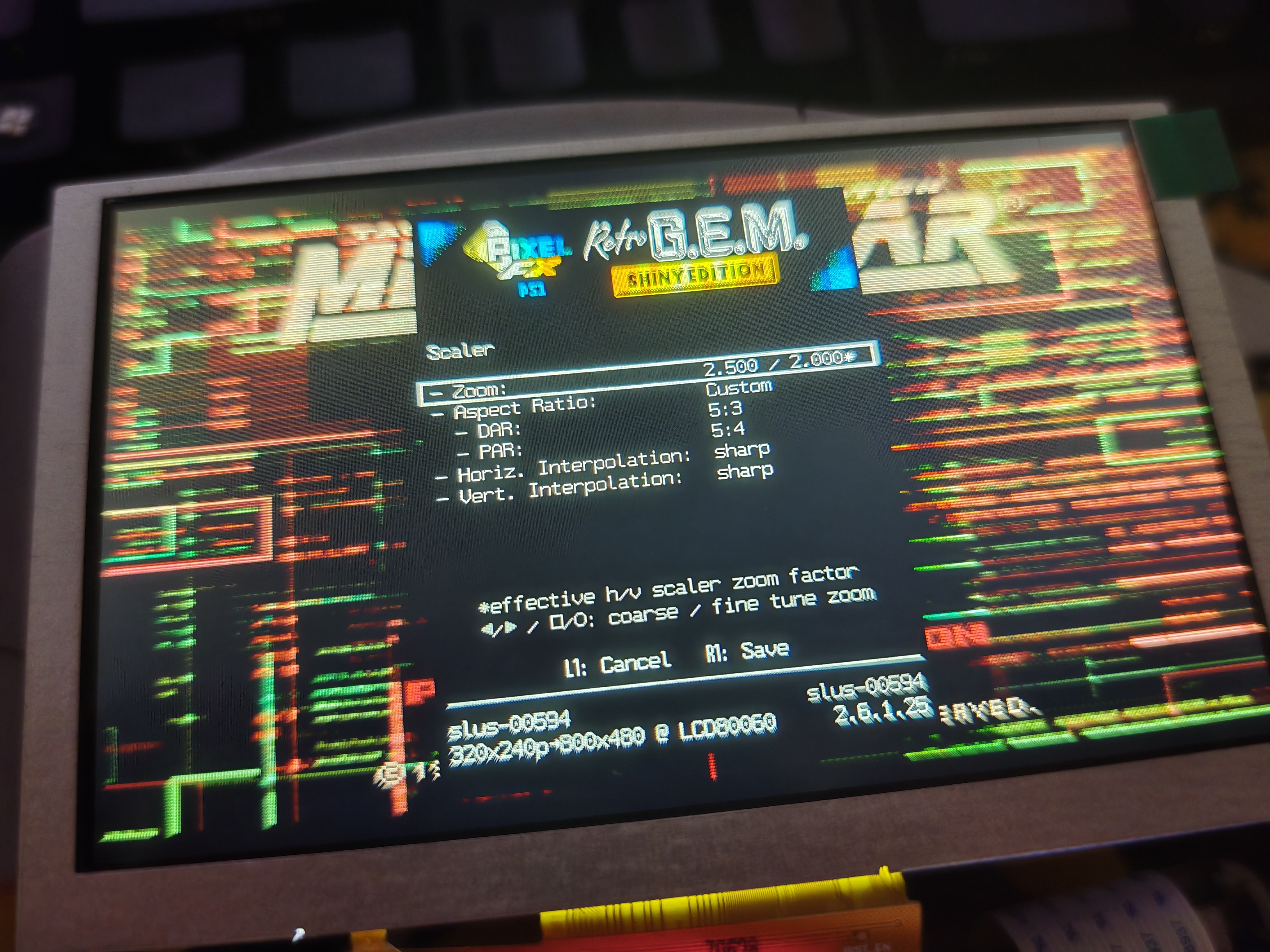

Ideal scaler settings for stretched image on the 800x480 LCD. As with N64, stick to the old 2.6.1.25 firmware.
