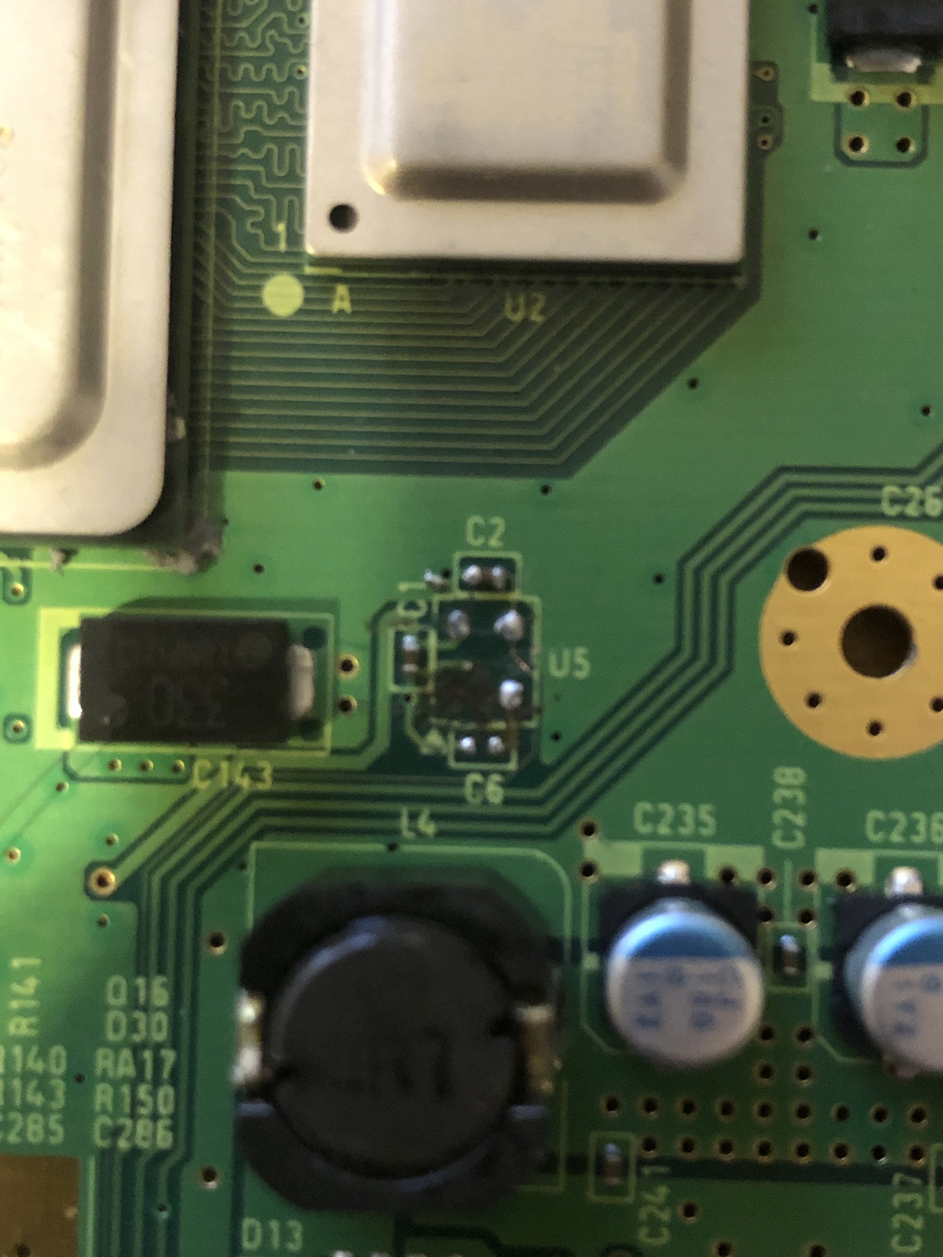

9hours . Joined Apr 4, 2020 Messages 3 Likes 0 Apr 5, 2020 #1 While trying to desolder the U5 chip, the left and middle pad fell off. Is this still okay, or is my board dead. Attachments IMG_2636.jpg 1.2 MB · Views: 345
Stitches 2 and a Half Dollarydoos Staff member . . Joined Feb 5, 2017 Messages 4,649 Likes 3,595 Location Banana Bender Land, Australia Portables 6 Apr 5, 2020 #2 It's fine, just glob the 3 rear pins together and run a wire from the glob to a ground spot on the Wii.
