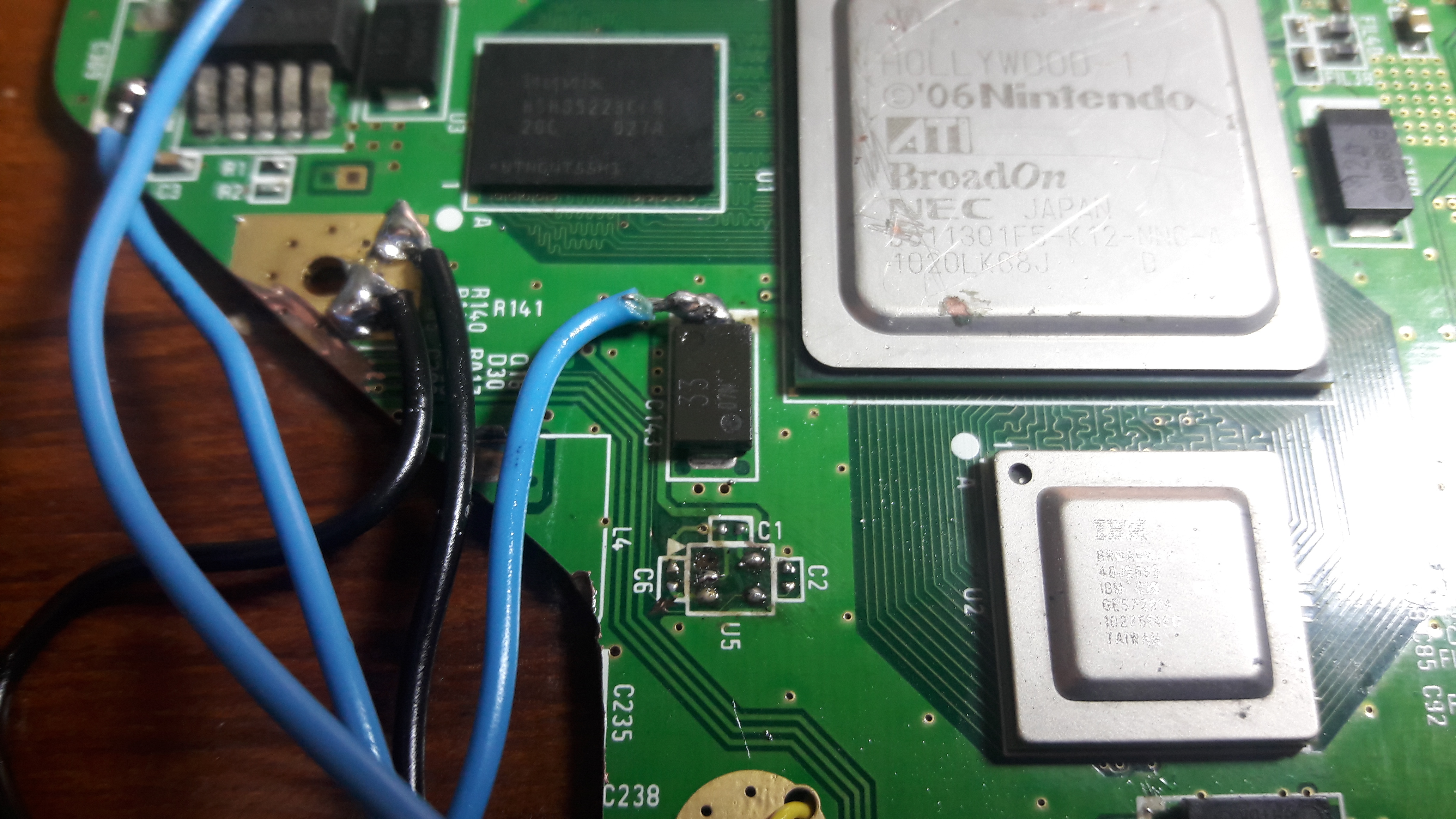

Alberto . Joined Jan 15, 2020 Messages 77 Likes 5 Mar 22, 2021 #1 Hola, al quitar el chip U5 se rompió una almohadilla en la placa, la soldé igual solo conectando las restantes que estaban bien y la wii no enciende, ¿dónde se puede solucionar o ya está muerta?
Nodel . Joined May 31, 2020 Messages 18 Likes 2 Mar 22, 2021 #2 That's just a ground pad.It;s ok if that one is burnt off
Stitches 2 and a Half Dollarydoos Staff member . . . Joined Feb 5, 2017 Messages 4,583 Likes 3,526 Location Banana Bender Land, Australia Portables 6 Mar 22, 2021 #3 If somehow it doesn't work, you can run a wire from the 3 leg side of the U10 to any ground location on the Wii.
Alberto . Joined Jan 15, 2020 Messages 77 Likes 5 Mar 22, 2021 #4 METROís Nodel said: That's just a ground pad.It;s ok if that one is burnt off Click to expand... -merge- Stitches said: If somehow it doesn't work, you can run a wire from the 3 leg side of the U10 to any ground location on the Wii. Click to expand... Thank you very much for answering, I already solved it luckily Last edited by a moderator: Mar 24, 2021
