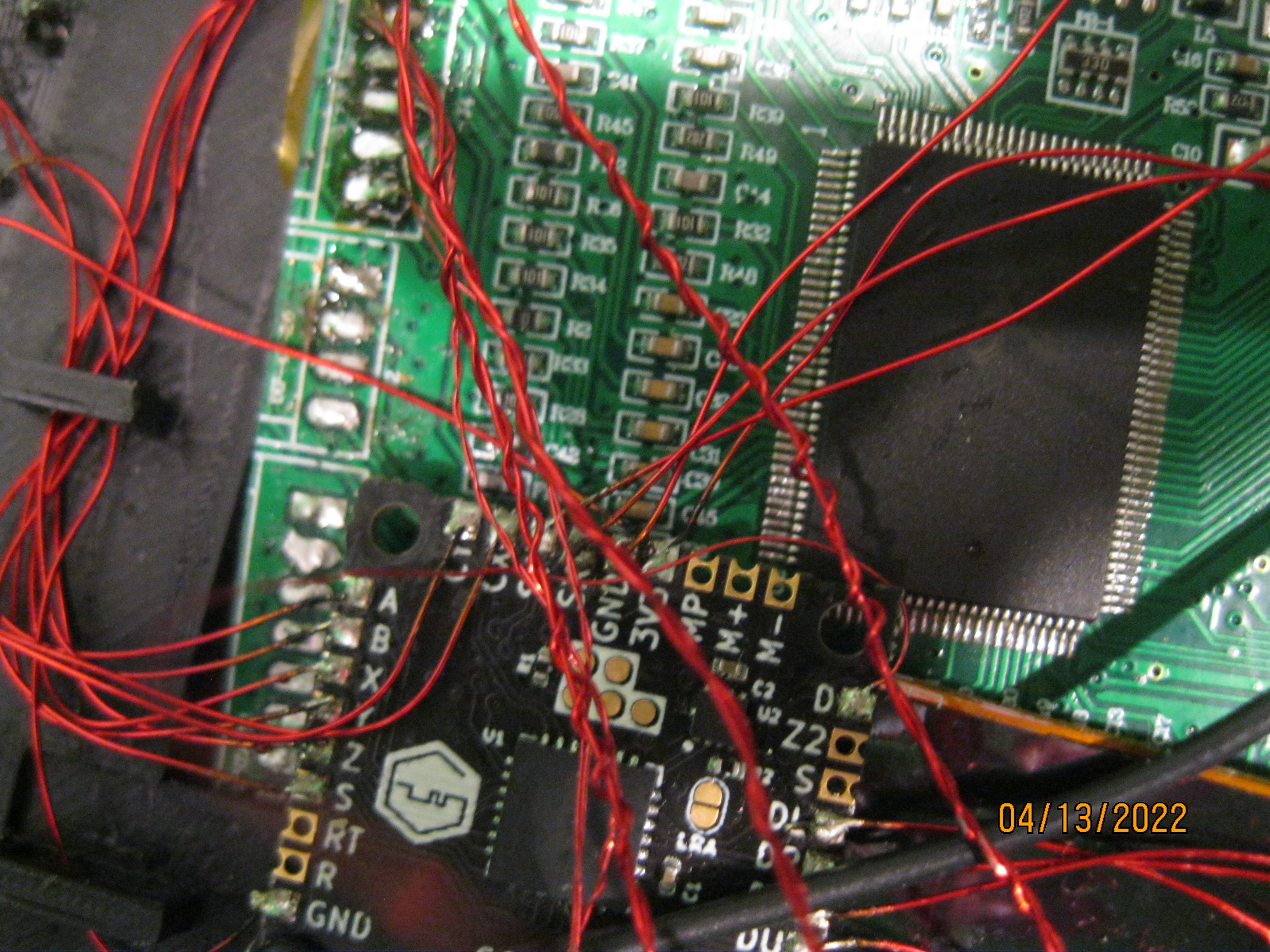

Got any photos of the wiring?
I can get some later. I don't think it's the wiring though. The buttons work fine and the joystick wires are pretty clean.
The data wire from the GC+ is a bit long, though.

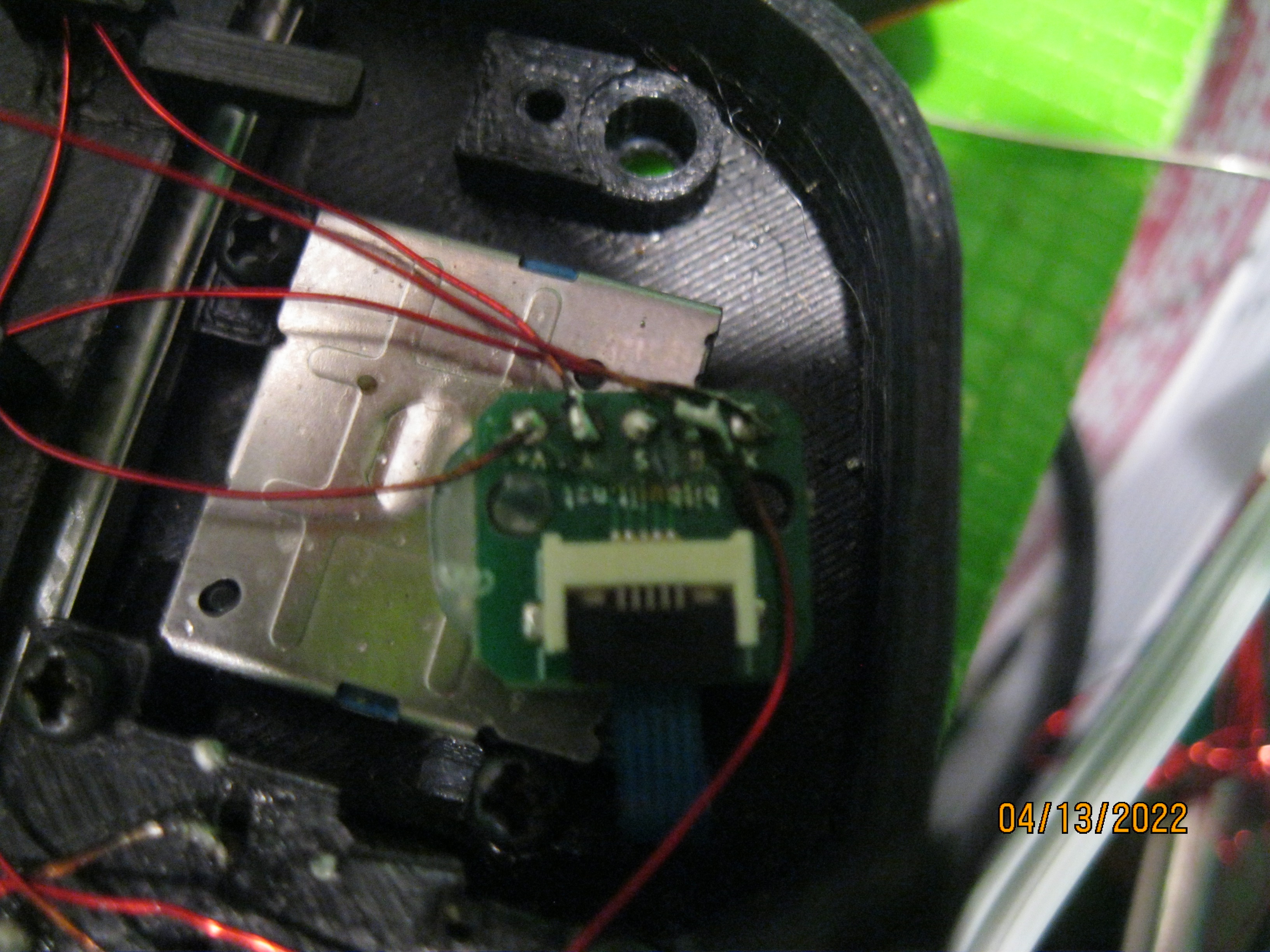

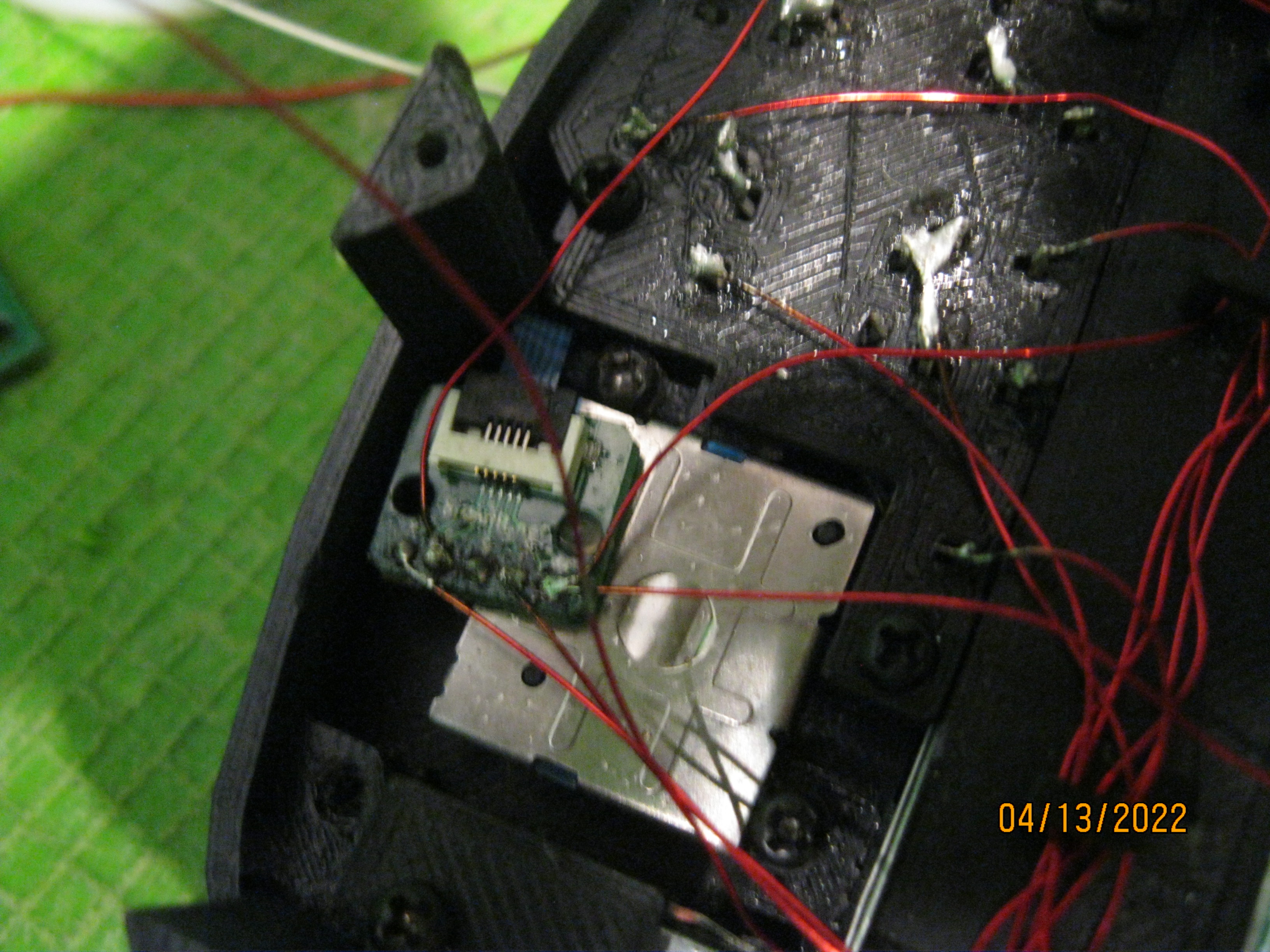

Have you tried testing the continuity of the wires? I've had issues soldering enamel wire like that in the past where the insulation didnt melt away entirely and I was getting an intermittent connection.
Another thing it might be is a short circuit, looks like the solder on the two right most wires in the first picture might get close enough to touch sometimes

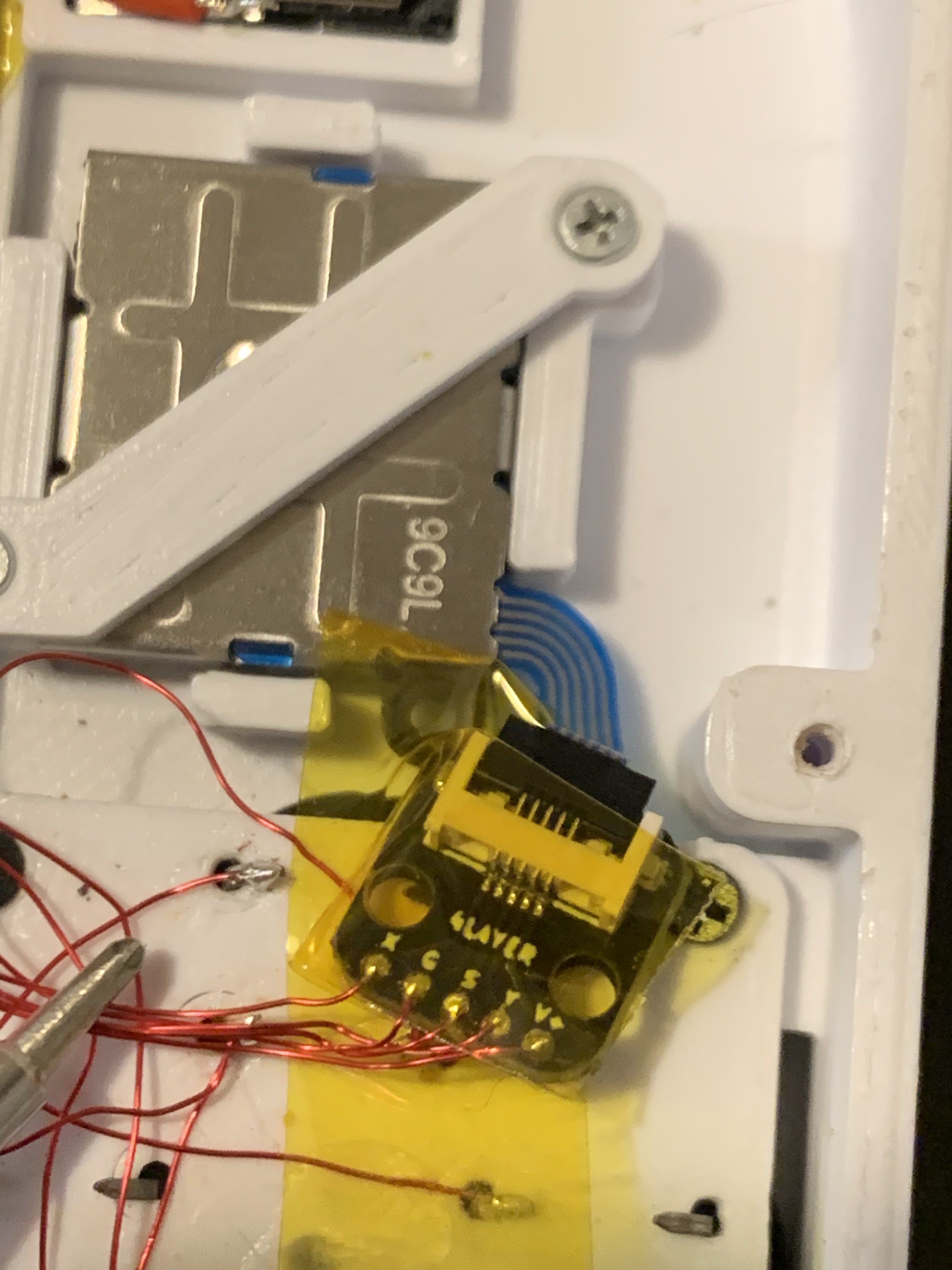

Going out on a limb, but do you have the joycon FFC cable in the correct way up?
With the all blue part on the side of the top of the pcb?

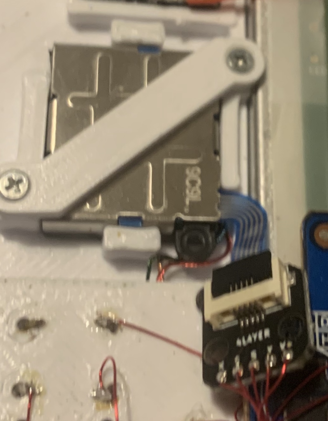

I think you might have them flipped check my picture they work like this in my ps2p.
OH! Really?
