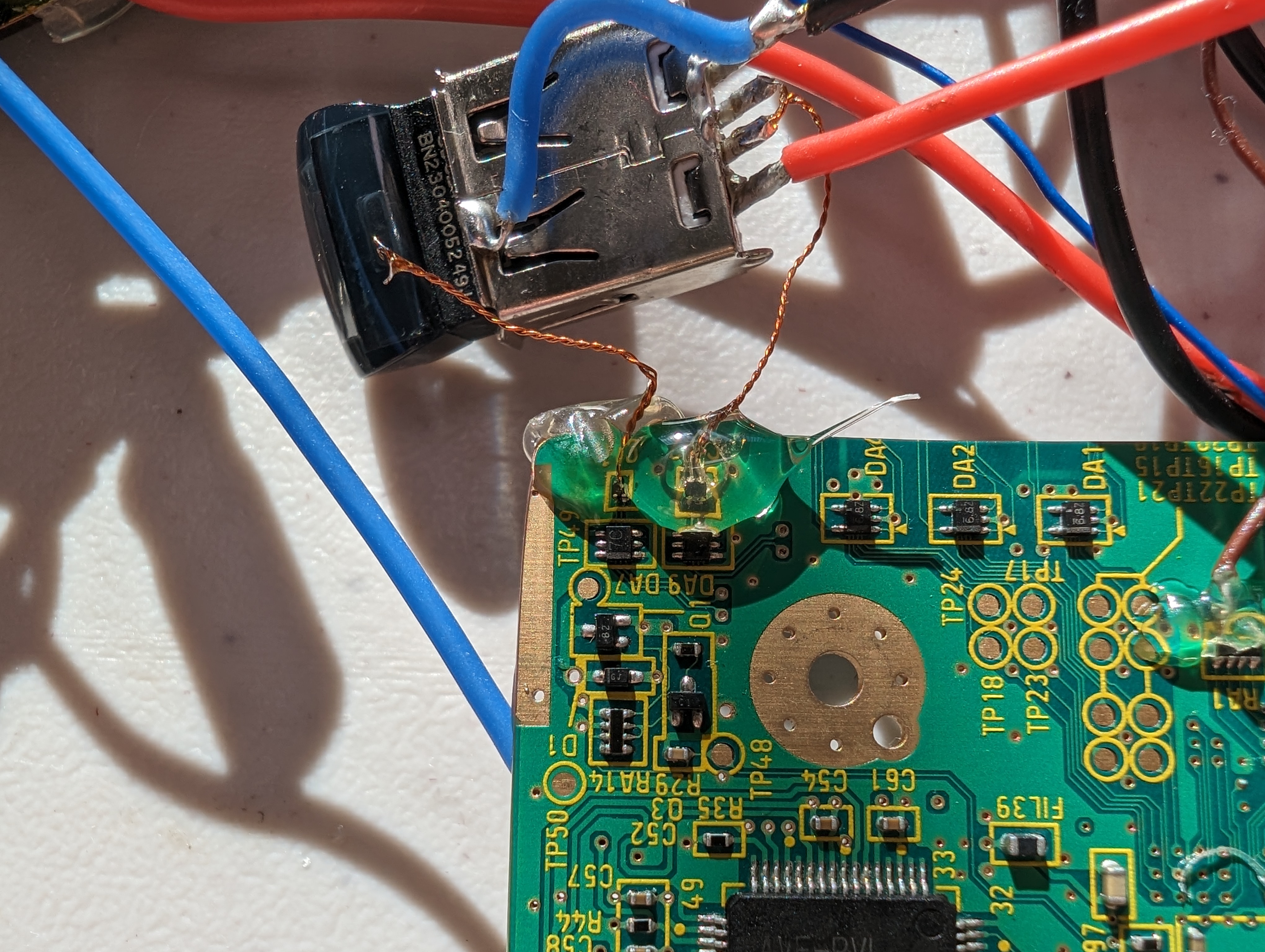

At first I was using 30awg wire of a considerable length twisted very tightly with a drill, so I switched that out for twisted 34awg magnet wire of a length of about an 1", but there was no improvement.
I'm using the current recommended drive, the SanDisk 128GB USB 3.1 UltraFit formatted to FAT32 with 32K clusters using guiformat. I've also tried with a Kingston 128GB drive and a USB2.0 to microSD adapter, all individually formatted and with their .iso files downloaded independently and from different sources in case there was a corruption problem.
I've soldered to both CM1 and CM2 and it's the same with both. I've never bypassed these CMCs. I've even tried using a tiny ferrite bead and running the 34awg through that. I've grounded the USB port. I haven't tried a clean reinstall of RVLoader, as I don't think the problem lies with RVLoader if the crashing almost always occurs in-game (sometimes I'll get a DSI exception navigating through RVLoader). I'm also hesitant to do this reinstall in case the bad USB writes some corrupt data to the NAND or whatever and bricks the whole Wii.

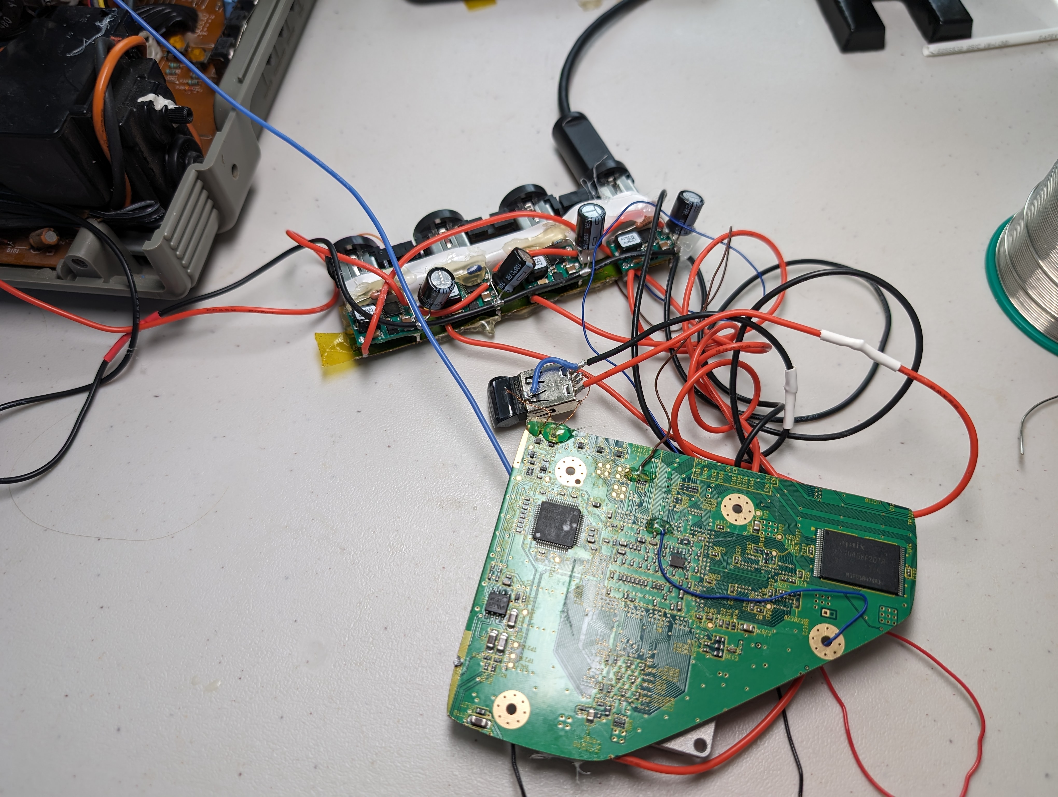

I'll attach some pictures below. Don't mind the mess of wires, i've flipped it over and tangled the wires a hundred times while trying to figure this out. Also, ik it's not good to have exposed wires, but I promise they haven't shorted. It was just temporarily like that while I tried CM2.
That is indeed a very specific issue. I can't say I remember anyone reporting this same problem before, but we can have a go at resolving it. First thing I want to ask is whether you have 2 ground wires going from the regulators to the Wii? Insufficient ground is a common cause of seemingly unrelated issues, so adding a second ground wire would be a good step 1
Holy sht I connected a 2nd ground wire between the regs and the board and the crashing is completely gone. 99 stocks 4 CPUs on temple, playing through mario sunshine, no crashing, no DSI exceptions.
Thank u so much for the reply, I can finally put this thing together! I guess it didn't cross my mind since I already had two ground wires connected to the wii, but one was just going to the gcc board and not to the regs. I wonder why the problem manifested in such a weird way. Thanks again ur the goat :))
