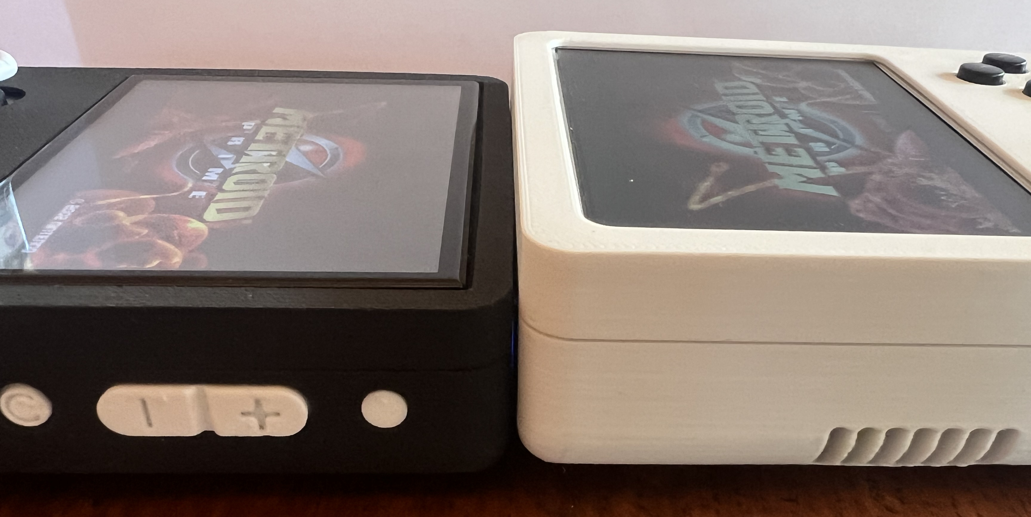

- 5mm thinner
- 145 x 86 x 26mm form factor
- 16% smaller than the Xii-Boy Original
- 25% smaller than the GBoy Rev III

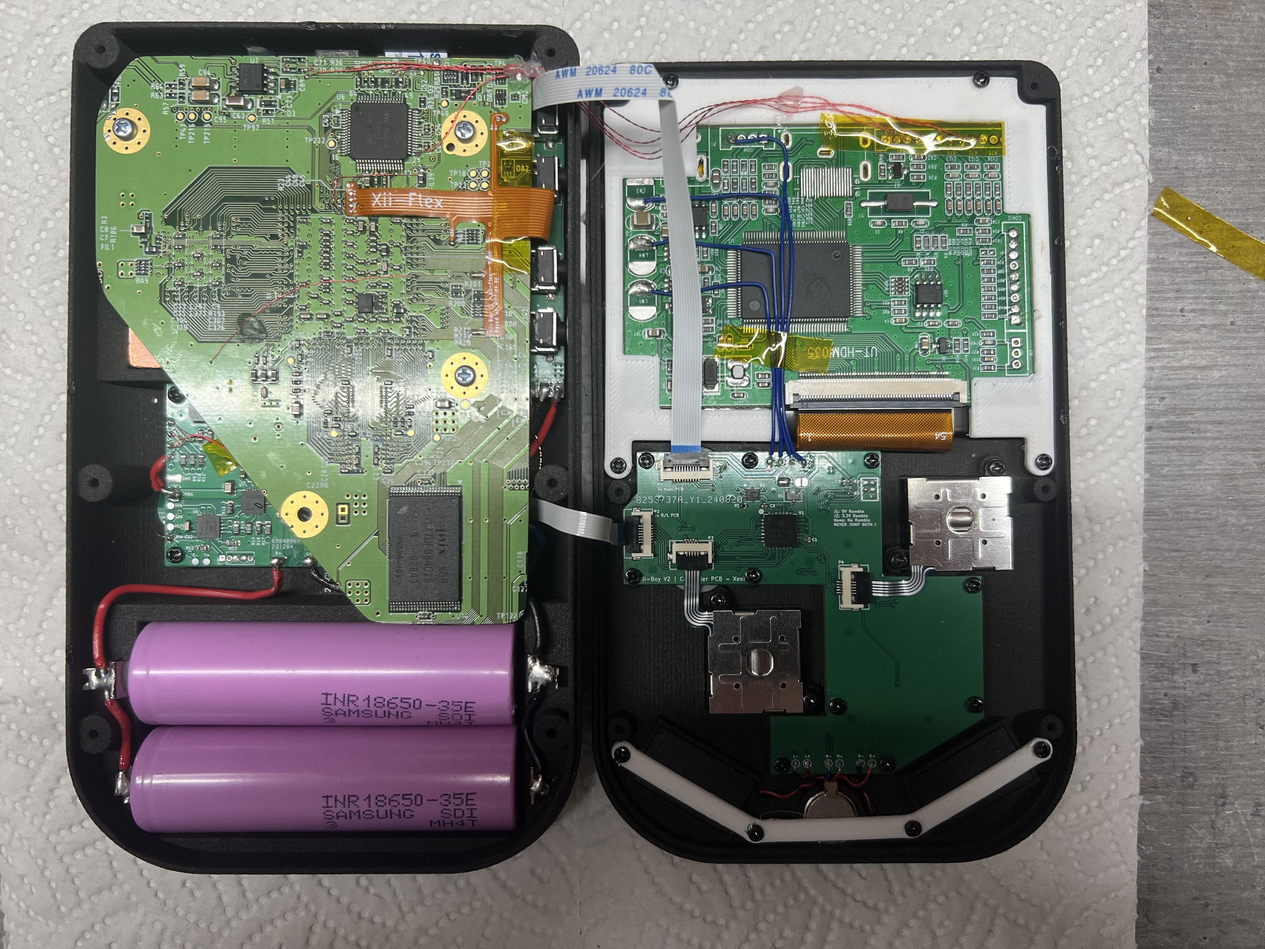

Here is a little picture of the inside

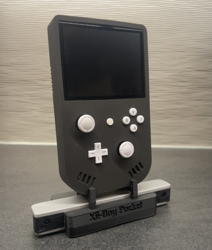

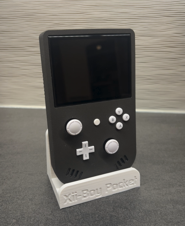

- I've added two Xii-Boy Pocket's stands. Here they are!
Right one is compatible with XiiSBar. Both are available in the STL section of the repository.
