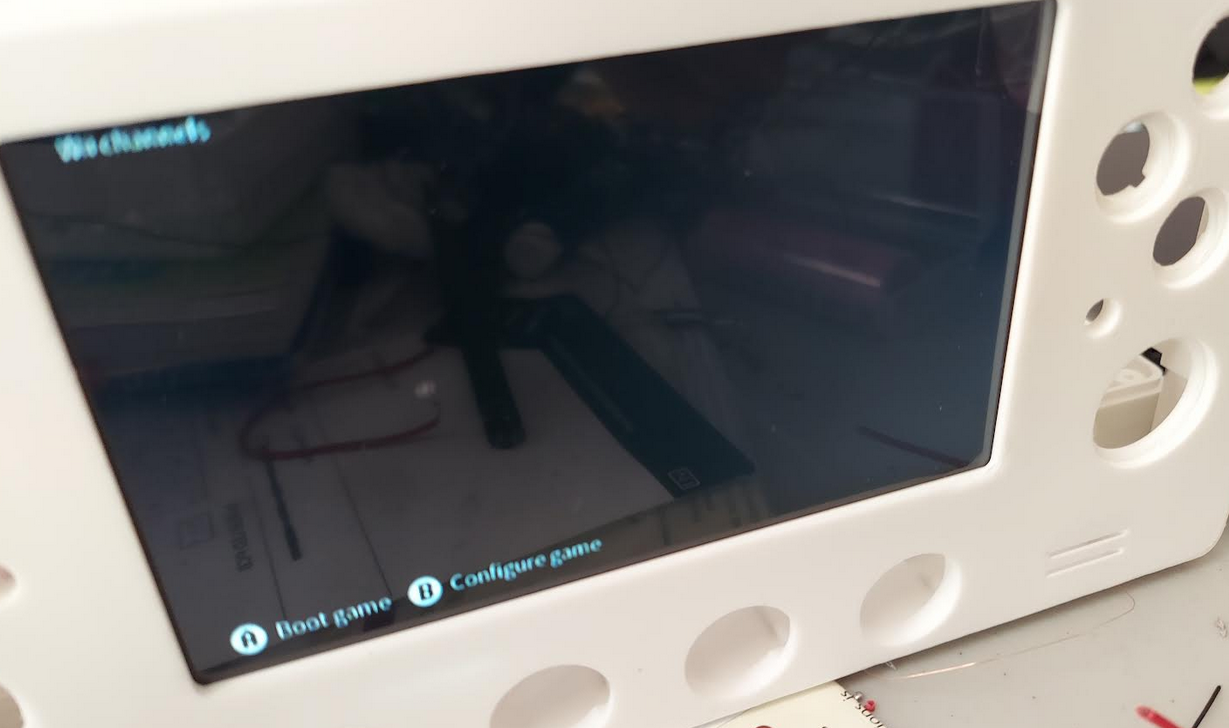

Well, I don't think I'll see my joints in hell any time soon, but they aren't the greatest. Soldering to the Wii went smoother than I expected, and overall, the process was pretty straightforward. Next was the screen:
I decided to test composite video output with my Wii first before going ahead with VGA- -a decision the majority of members seem to make. So, I plugged in the battery, turned the console on, and... nothing- -until I realized you had to change the source to composite. After that...
The Wii is booting! This project is just going one step forward after another; I feel great! Anyway, that's all that's been done so far. Just a little more to go.

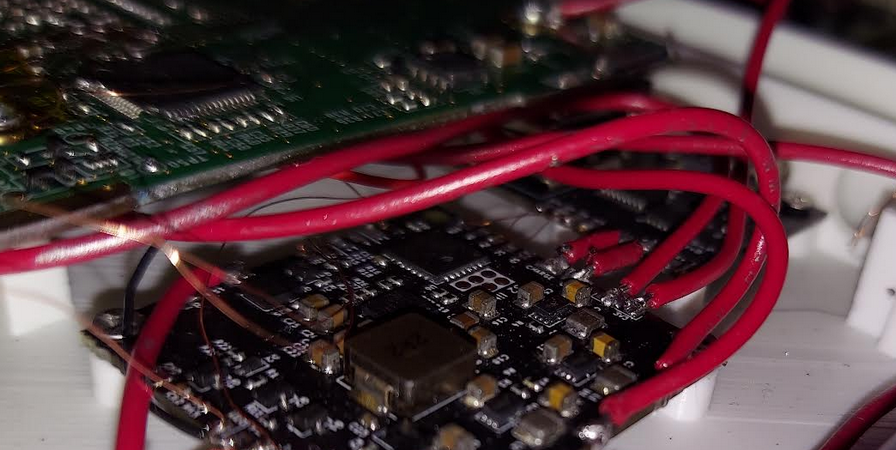

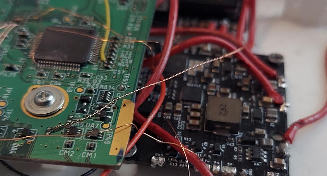

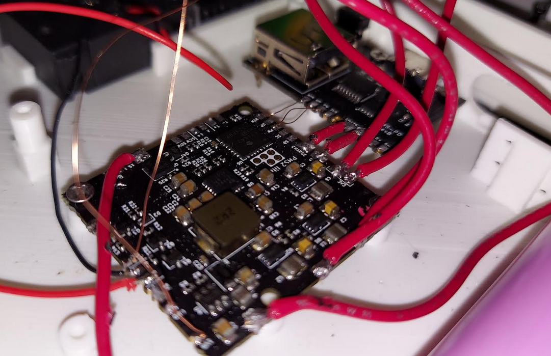

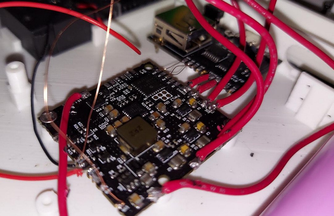

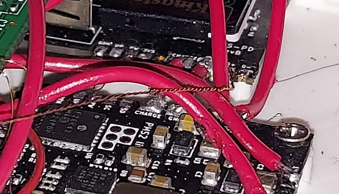

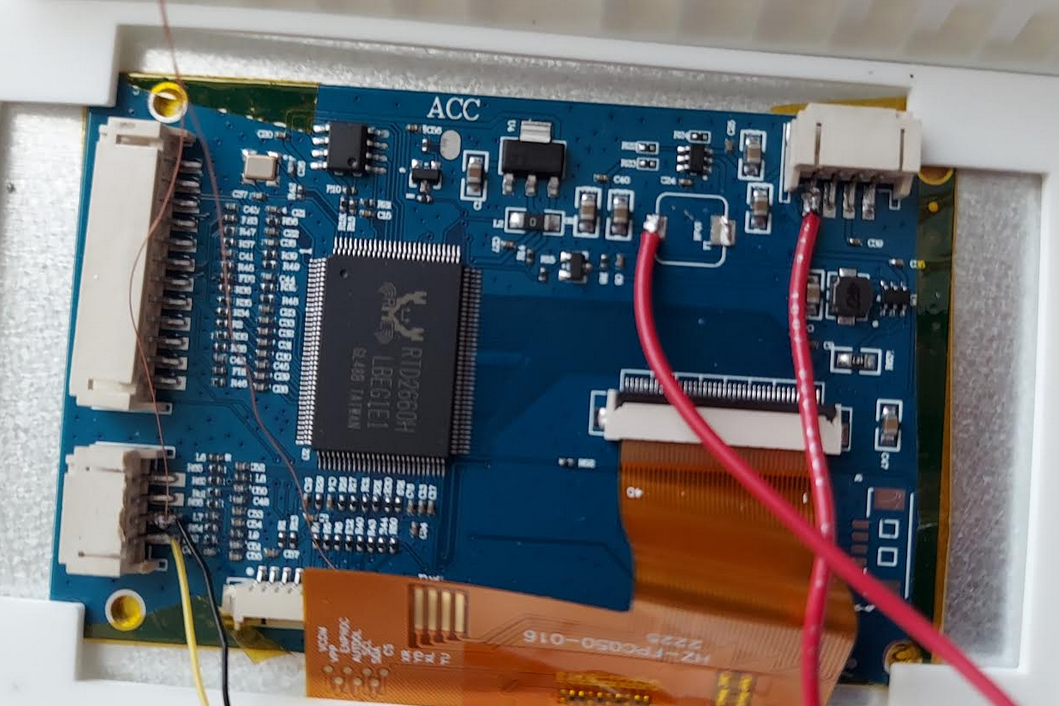

Well, looks like I've bumped into my first real problem.

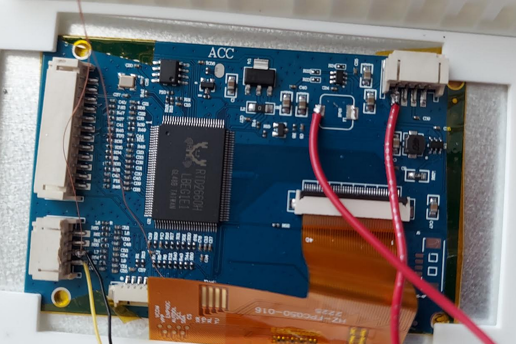

After (partially) soldering VGA into the screen, I wanted to see if the screen would show video with only one color connected. I turned on the system, and while the fan worked, the screen didn't turn on.

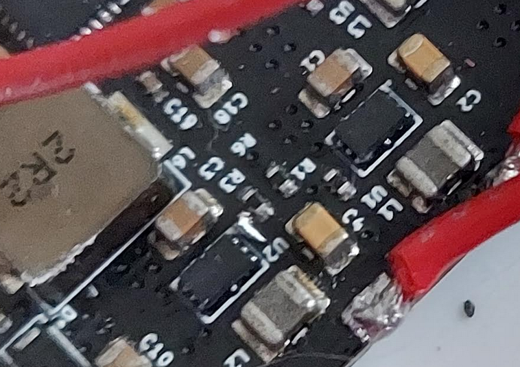

It wasn't much later that I found this little booger:
Then, after double-checking to see that the board had nothing else shorting, I turned it on and probed 3.3 volts. My multimeter showed 0.51 volts... I'm guessing that regulator's dead, but I'm not sure what my next move for this is...
I've attached more picture here in case anyone spots something, but anyway, the ultimate question is "what can I do about this now?"
And to clarify, I believe the regulator is unrecoverable; I don't think it's going to come back any time soon...

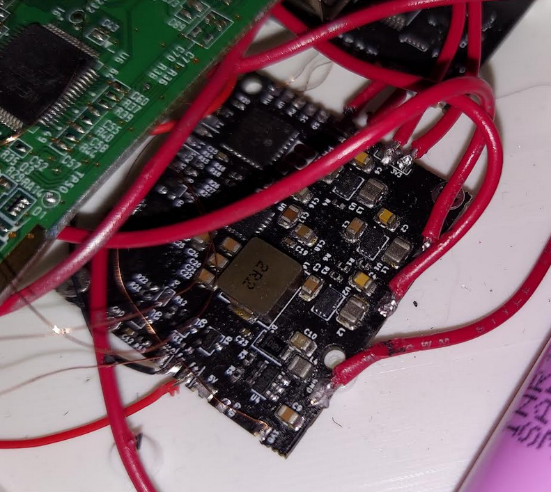

I had a very similar thing happen to me when I was building my ashida. Everything was powering on, then I added some more wires, then it stopped outputting power correctly.
My 5v rail and 3.3 volt rail were only outputting 0.60 volts and the fan wouldn't turn on when the switch was turned on.
I ended up removing my batteries, and cycling power about a dozen times to fully drain the board. Then I SCRUBBED the board front to back with 99 percent IPA and hooked batteries back up and it fired up.
Well, bad news, then.
I've been at it for about an hour and thirty and still... nothing. The 3v3 pad will fluctuate from .05 to .1 (I mean to say .051 instead of .51 in my original post), but it's not going higher than 0.128. 5v has started to have issues as well, fluctuating between 5 and 3.1 volts. It seems whenever 3v3 goes up, 5v goes down.
I think my next move is to replace the 3v3 regulator, but I don't know if that'll fix 5 volts, or if I need to get another regulator. Lots to think about...
I just wish I knew a little more about how everything was connected.
Before you go that route I'd recommend check for a short, voltage rail to voltage rail, and voltage rails to ground. Note that 3.3v to ground becomes around 4 ohms but isn't an actual short while PMS and Wii are connected. Then unsoldering every wire to the PMS and checking again. This will rule out if you developed a short on the Wii itself or another board that's causing this voltage drop.
Then solder only a battery, fan, and a button to activate the board and check voltages again.

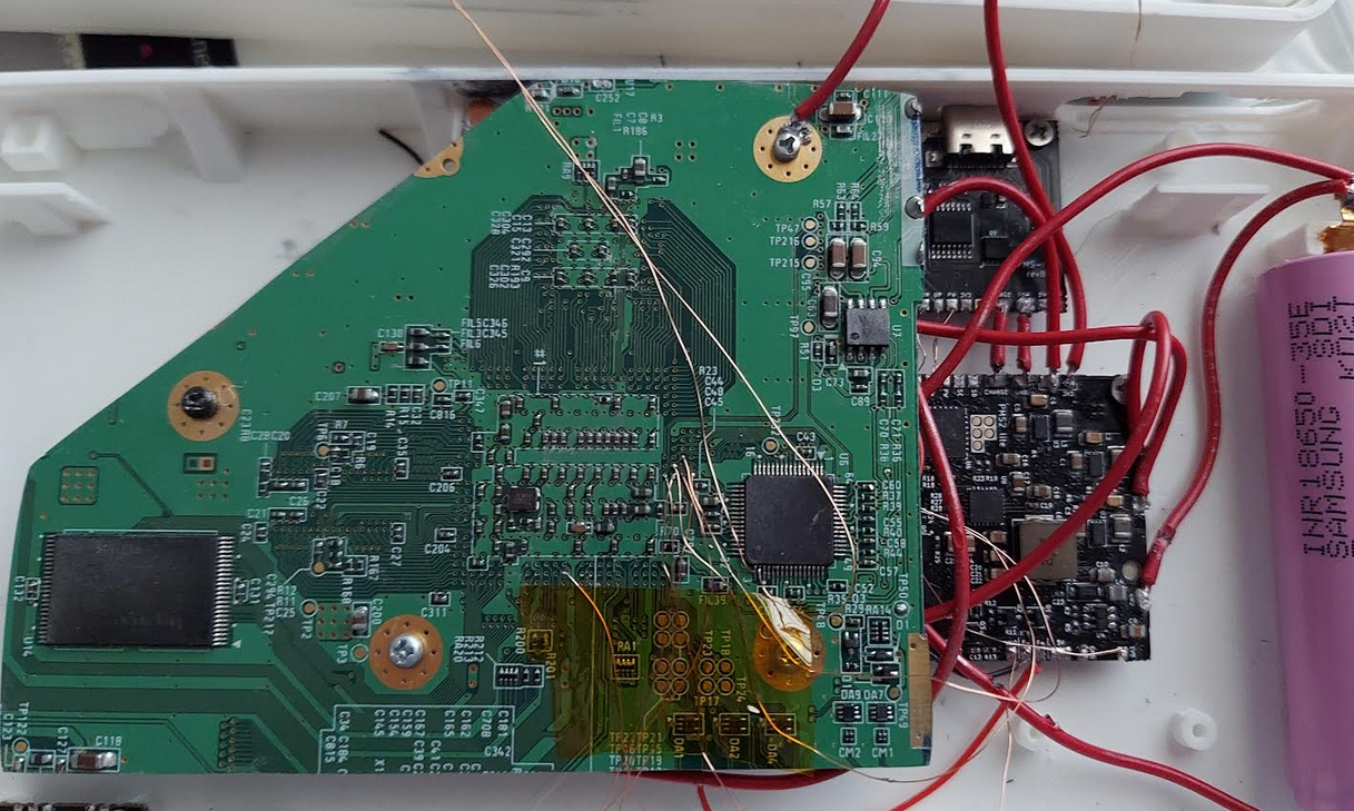

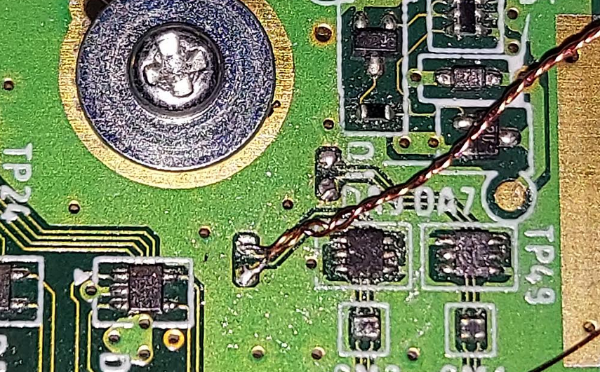

Hey, thank you so much for the advice; after I got back to my work station I isolated the Wii from the PMS and, sure enough, a flat-out 0 ohms between ground and 3.3 volts. Not to mention that the regulator has started working consistently again (when disconnected from the Wii)
Some other resistances are a little funky too, and I guess the Wii could use a good sponge bath.
Thanks a lot! I probably would've went through a lot more work otherwise :D
I'm stoked that got the PMS working again! better the issue be on your Wii rather than the spendy power management board.
I'd definitely give it a good ol' SCRUBBIN' with tooth brush and 99 percent IPA. Then check resistances again.
If that doesn't resolve the issue, and there's no clear sign of shorting on the surface (damaged SMD component, solder blob, leftover flux) then I'd go over your edges again making sure you sanded them down working from low grit and finishing with 600 grit. Then bathe it again.

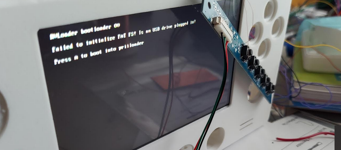

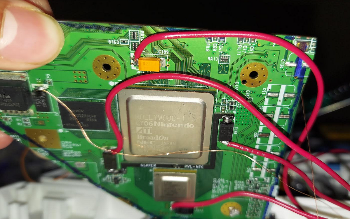

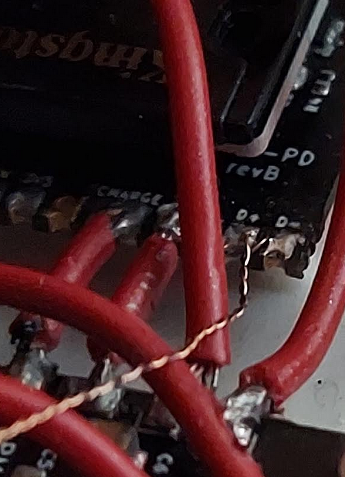

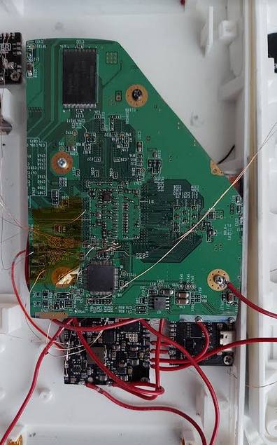

Good news!... and bad news. Let's start on a positive note: the Wii has been re-wired to the PMS and still boots!

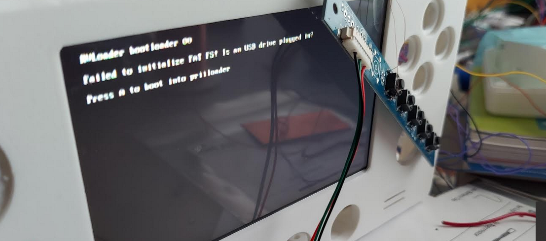

Bad news, however, is that RVLoader will not detect the microSD card. No biggie, I thought. I'll just do the troubleshooting myself. Here's how that went:
*inhale*
- Flipped around D+ and D- in case it was the wrong way around. Did not work
- Flipped it the right way around. Did not work
- Re-tightened the wire again. Did not work
- Actually flipped the microSD adapter the right way around. Did not work
- Did the first two steps again after flipping the adapter around. Did not work
- Reinstalled RVLoader on another Wii. Did not work
- Moved over to CM2. Did not work
- Flipped D+ and D- on CM2. Did not work.
- Banged my head against the wall. Did not work.
*exhale*
In case it wasn't apparent, I'm at my rope's end on what to do here. I checked the SD card, and it is FAT32. File structure hasn't been touched since I re-installed RVLoader... Anyway, I've posted some pictures of my wiring below; maybe someone will see something fishy that I can't.
So you installed RVLoader onto another Wii, took the USB adapter and SD card and put it into the new RVLoader Wii. Then could not get it to boot into RVLoader with that USB/SD card?
Sounds like regardless of the formatting, it's not compatible with RVLoader.
Getting something compatible with RVLoader can be tough. They have a rolling spreadsheet with USB drives that the community has gotten to work. Myself personally I've had a 50/50 shot that a USB drive boots and then plays games without crashing.
Check out the RVLoader FAQ page to find the list of community deemed compatible drives.
Sometimes, I only find out the answer after I've asked the question.
The next morning after I posted the above question it suddenly occurred to me (don't know how it didn't before) that I didn't wiring 3v3 logic to the board
":rothink:," I thought, "I wonder if that's the issue." I couldn't see anything else that could be. So I went through the same old song and dance of re-wiring usb...
...and it started booting
