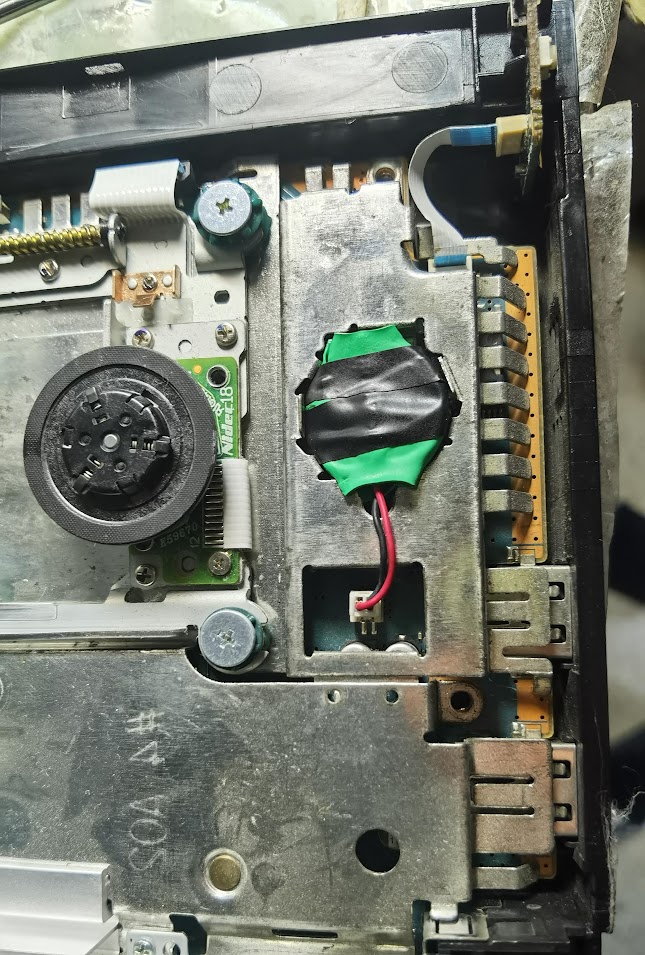

hi guys, about a month ago I purchased a small batch of PS2 slims on ebay, in particular:
first thing was to replace the dead buffer battery (cut the sheath and soldered a new one)

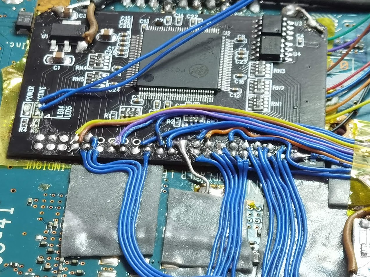

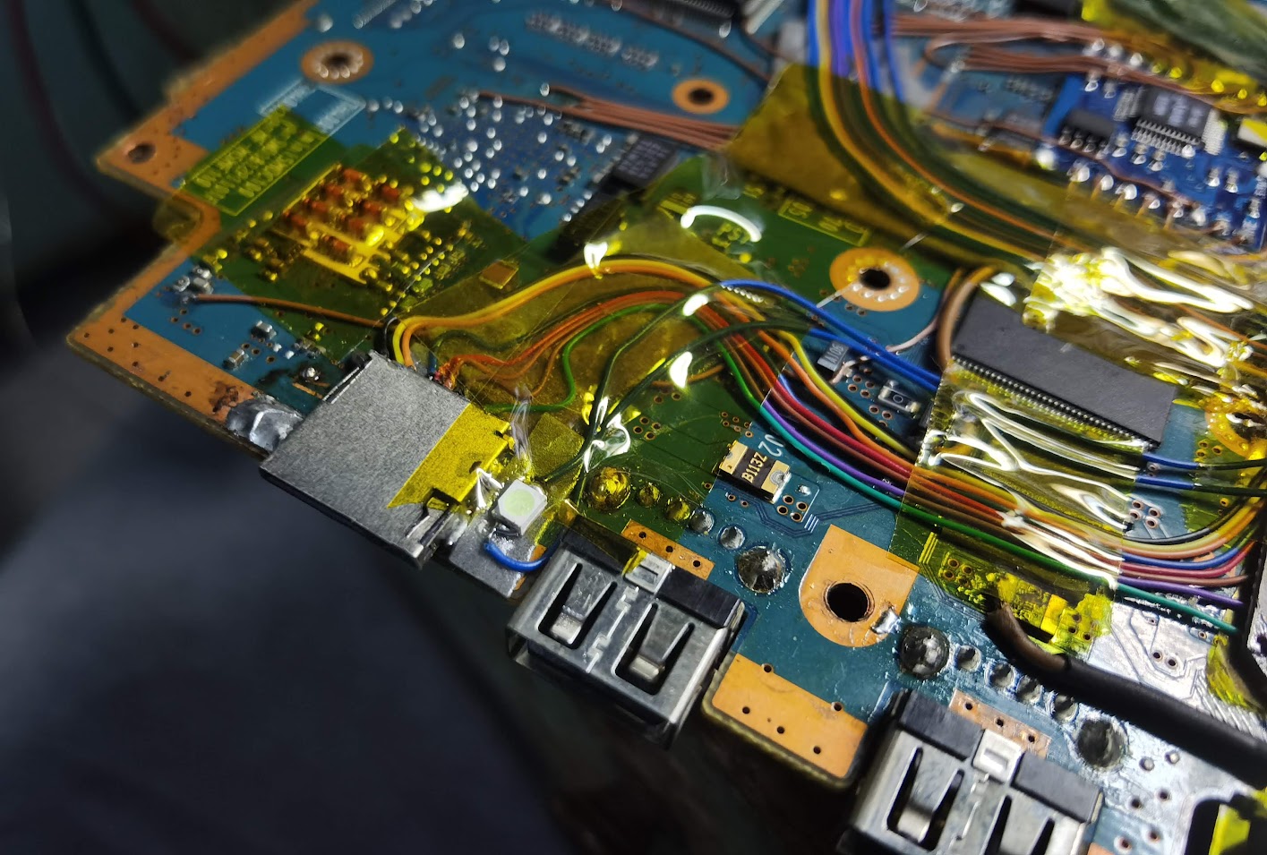

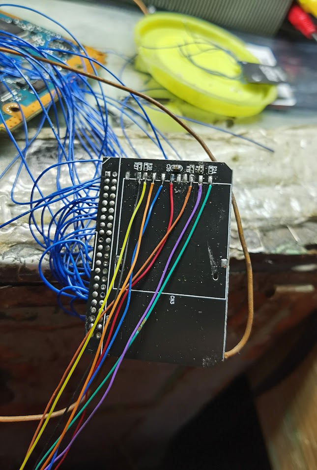

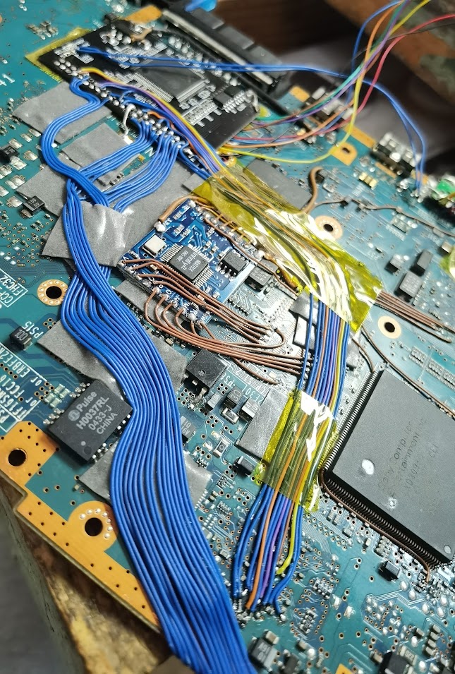

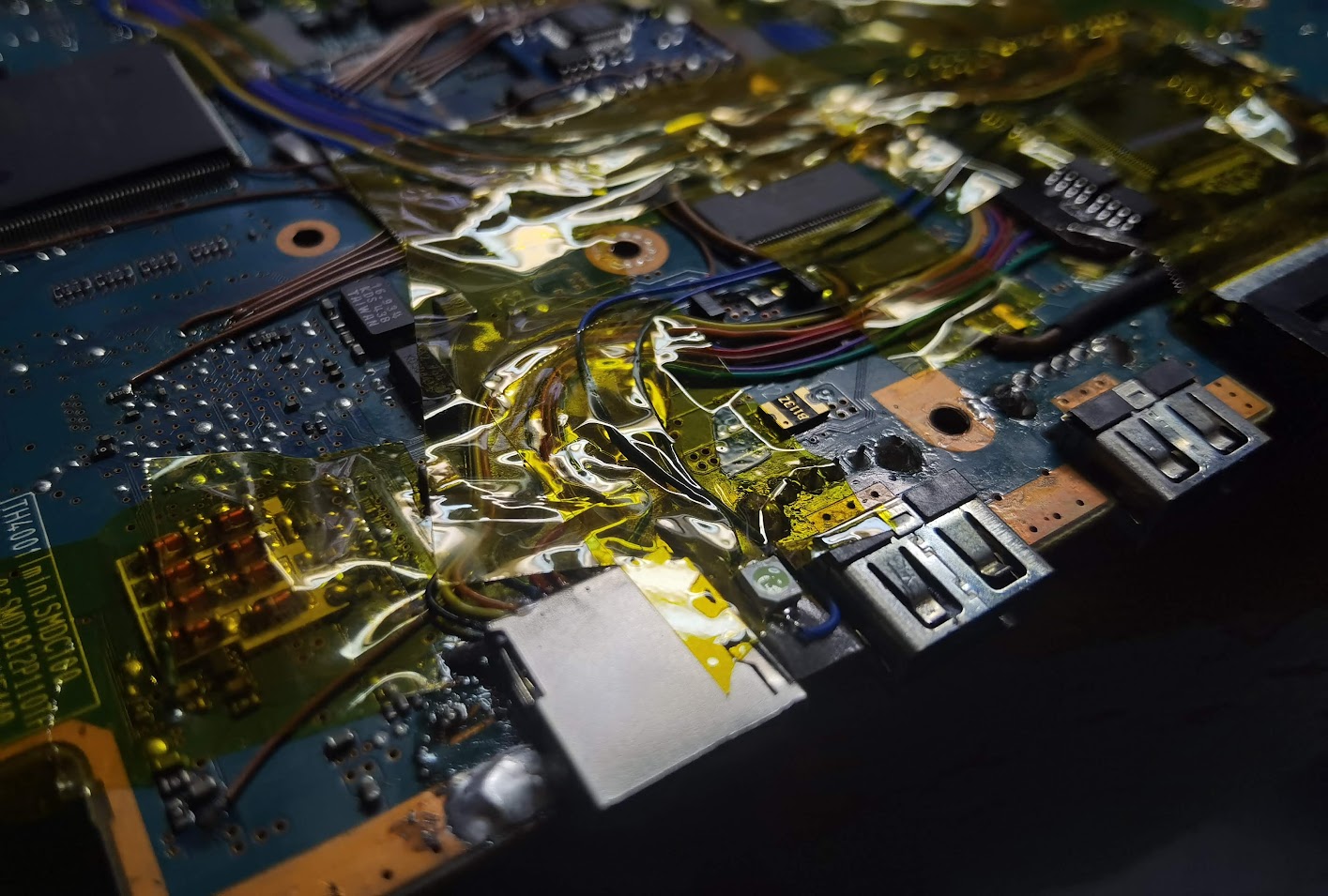

let's start the most beautiful mod... the ide; the idea of inserting a hdd or another "direct" unit without converters was good but in any case we had to affect the aesthetics and/or remove the player (which I didn't want) given that the project involved a super ps2 capable of working at 360 ° with everything...

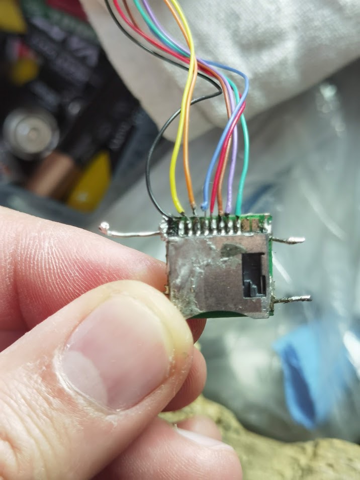

in the end I decided to opt for IDE with micro SD with the "invisible" mod found on the web, using the air grill to insert and remove the microSD at will...

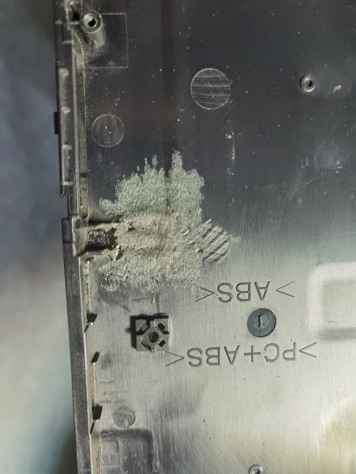

the modification seems to be minimally invasive, it was only necessary to trim the case a little in the central part, nothing more
interested pins + old sd slot for testing (without spring I didn't like it lol)

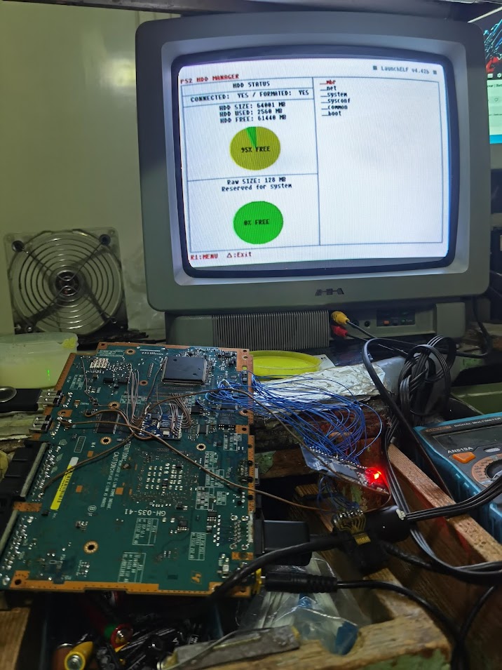

so let's do a recap:
- PS2 70004
- OK internal laser for all type of games
- OK battery cmos
- OK infinity 2.0 (modbo 4.0?) - (maybe upgrade / try to update? --> directly bot from usb without freemcboot)
- OK microsd - ide mod for backup game (no usb slow issue - comp ecc)
