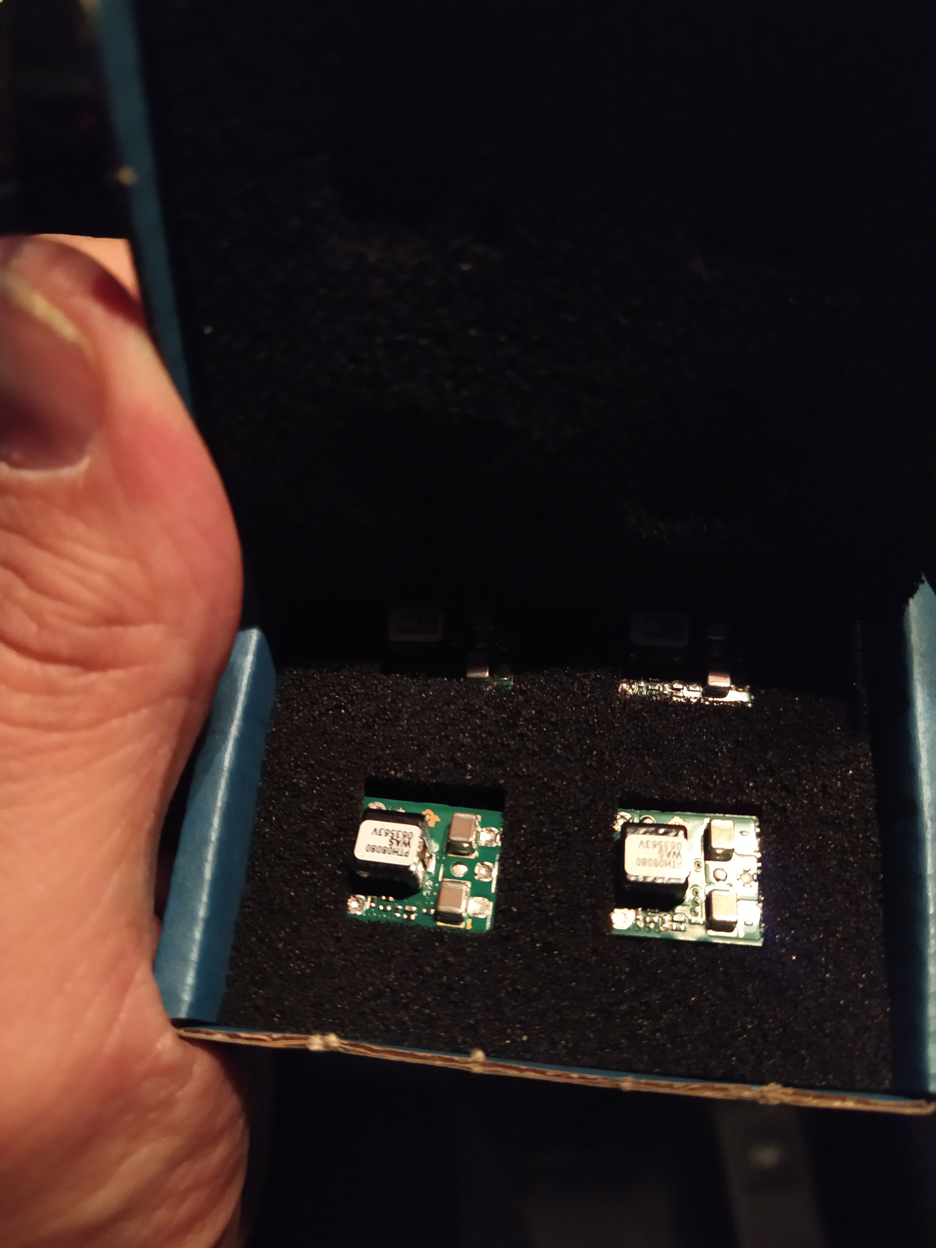

Regulators are here! I will try with the 5v output of my powerbank.

Small copper or aluminium heatsinks with at least 50% coverage superglued to the N64 chips are enough to keep it cool if you have some airflow. Some raspberry pi heatsinks should be sufficient. Thermally, it's a pretty forgiving system. As for the regs, 5v to 3.3v will work, question is for how long until the voltage drops. How much of the powerbank's life you can use depends entirely on the quality of the powerbank and the boost chip used in it. I can't speak for Xiaomi as a brand, but I do know that genuine Anker powerbanks were kinda the standard back when people used those for Wiis and such.
Thank you. Why you don't use the stock heatsinks?
