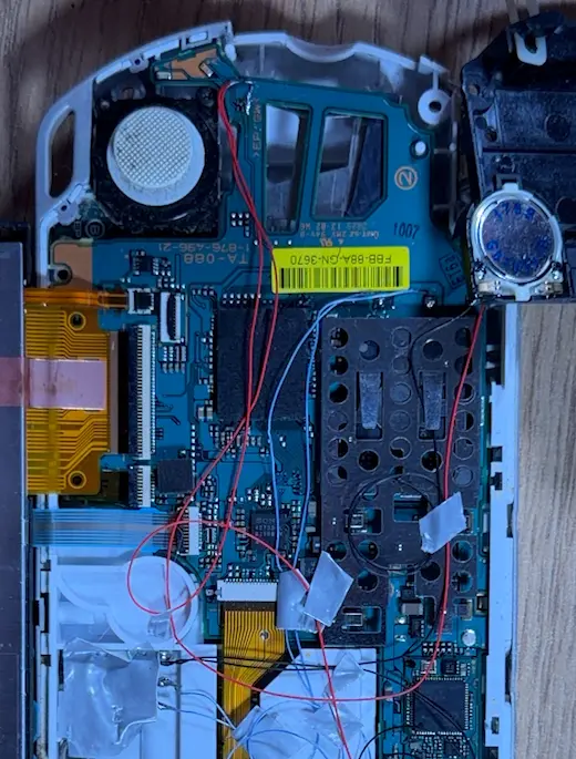

After that, I registered myself on BitBuilt to have some advice. I contacted customleds to get some help. Once every components was received I dived into the installation. To do this I used a 2n2222, 2 leds. I soldered my transistor to both speaker poles and my leds to two 5v resistors.
At the beggining, I tried to solder to only on resistor but, without doing it on a purpose, I soldered on both resistor and it works very well, I don’t know why but that’s cool xd
As you can see my wires are very long, I was afraid to cut it but next time, I will cut it to have the needed size because it’s a mess lol.
And here is the result !
I’m glad because I didn’t break my console but I have some new goals like :
