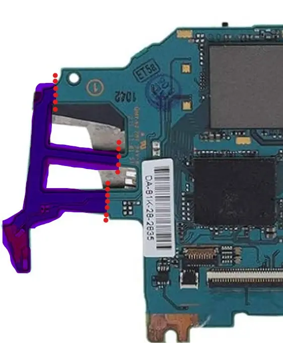

The first photo below shows what we will be trimming off (section marked in purple - the cut will be along the red dotted lines).
You'll first want to remove the memory card slot from the other side of the board. Other than that, this side of the board is mostly just home to a few components for the storage and wifi LEDs, which I suppose could also be relocated if you really want to. As with any motherboard, cut a bit outside of the line as you will need to sand those trimmed edges to be perfectly smooth before testing!!

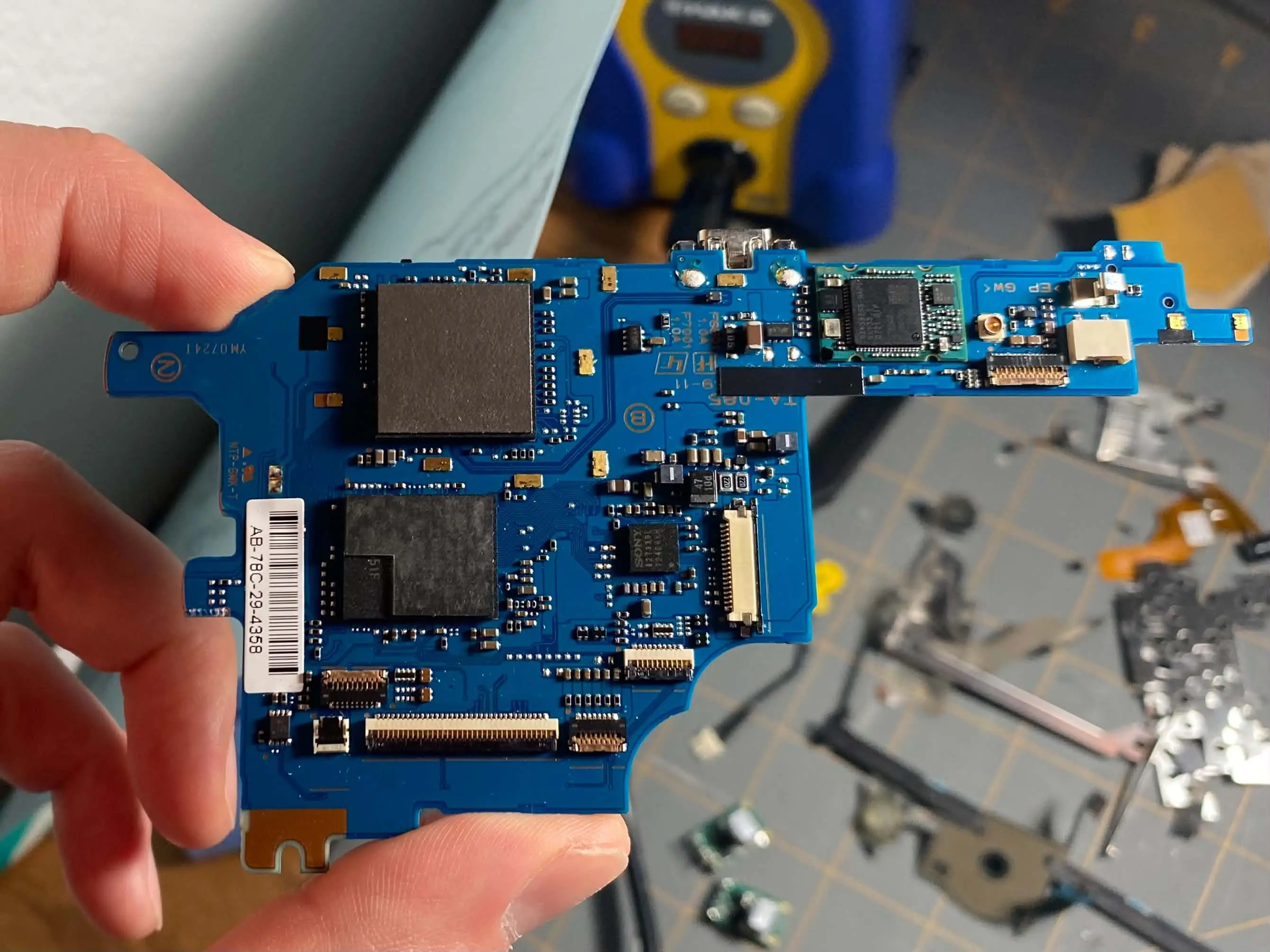

Here's what a trimmed board looks like!

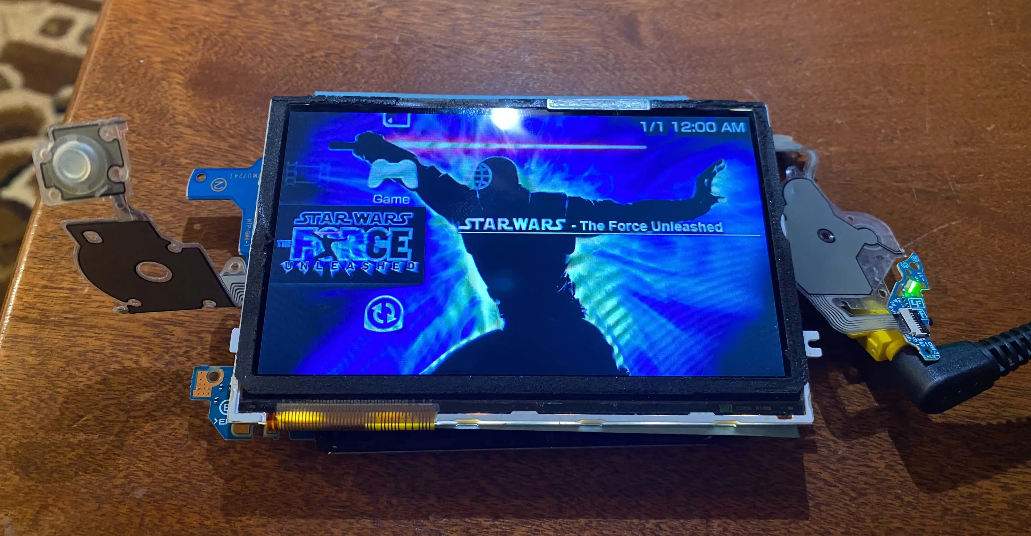

And voila, now you've got a psp motherboard chopped down to nearly the same size as the lcd panel... psp micro build anyone ??
