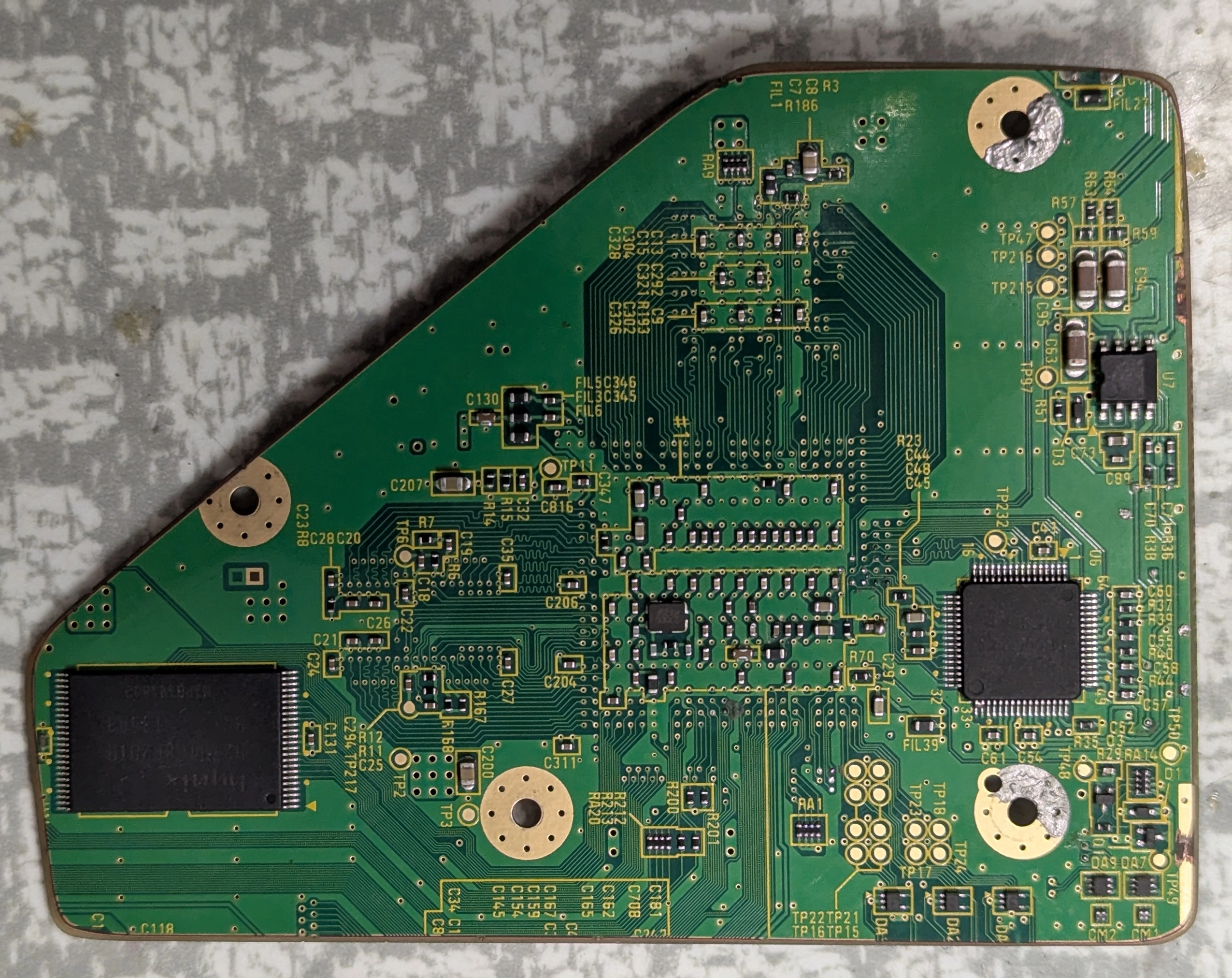

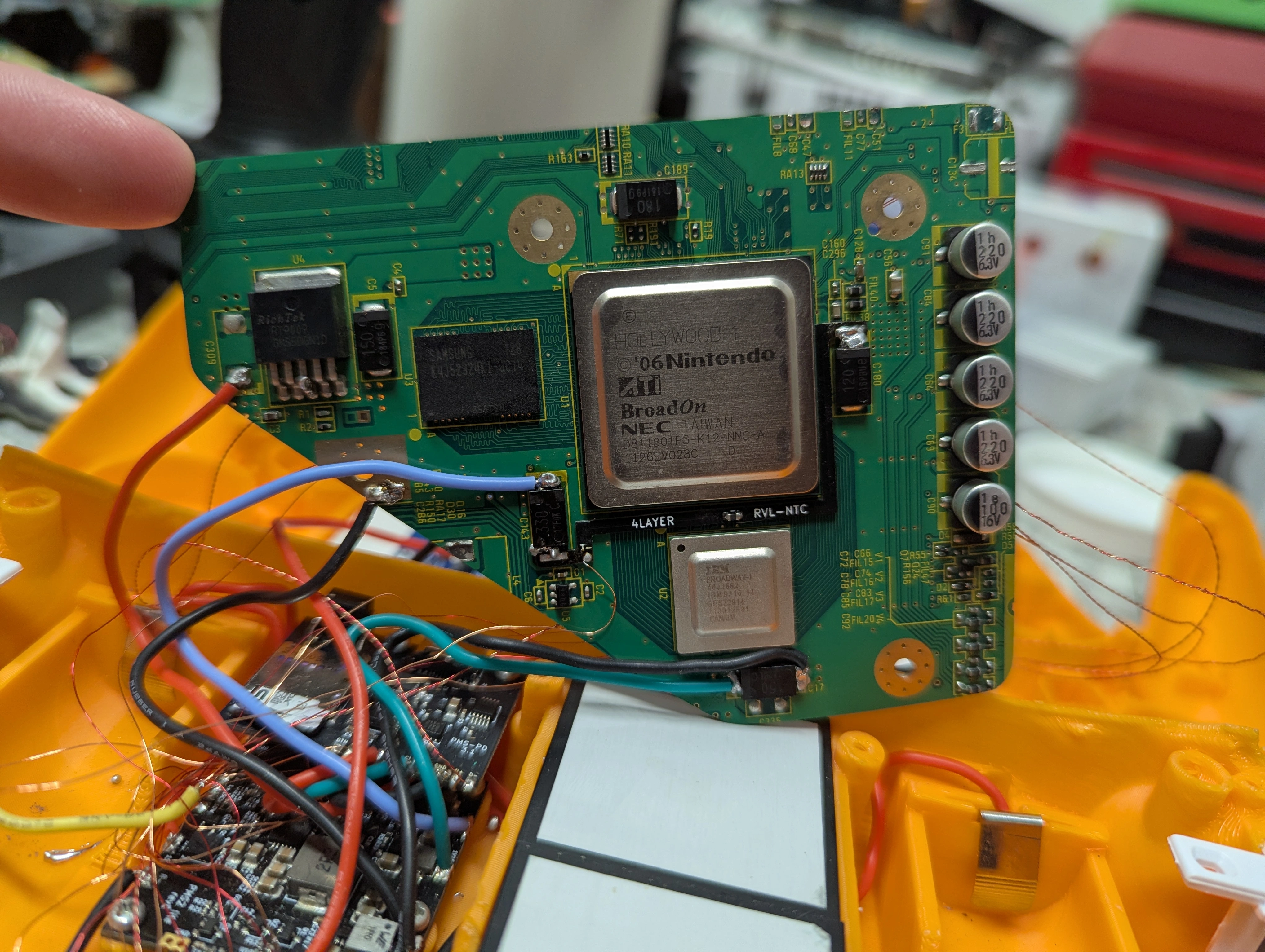

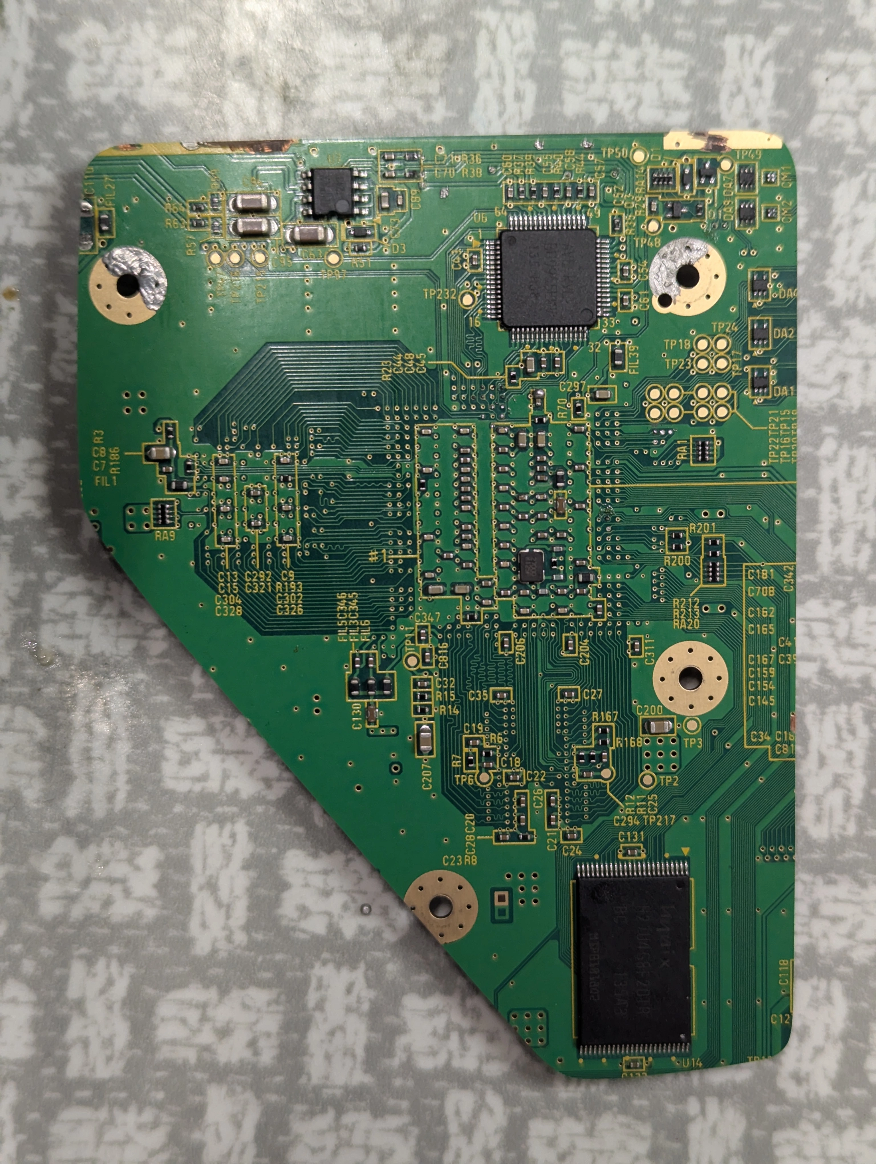

Hey guys, I'm pretty new to Wii portablizing and am building an Ashida. Today I wired up VGA and went to test it only to find a short between 1.8V and Ground. I've disconnected 1.8 from the PMS-Lite and looked around but can't seem to find the short anywhere. Any ideas?
Check that solder ball on the 1.8V LDO.Check that solder ball on the 1.8V LDO; it could also be the regulator itself. Try desoldering it and taking the measurement again.
