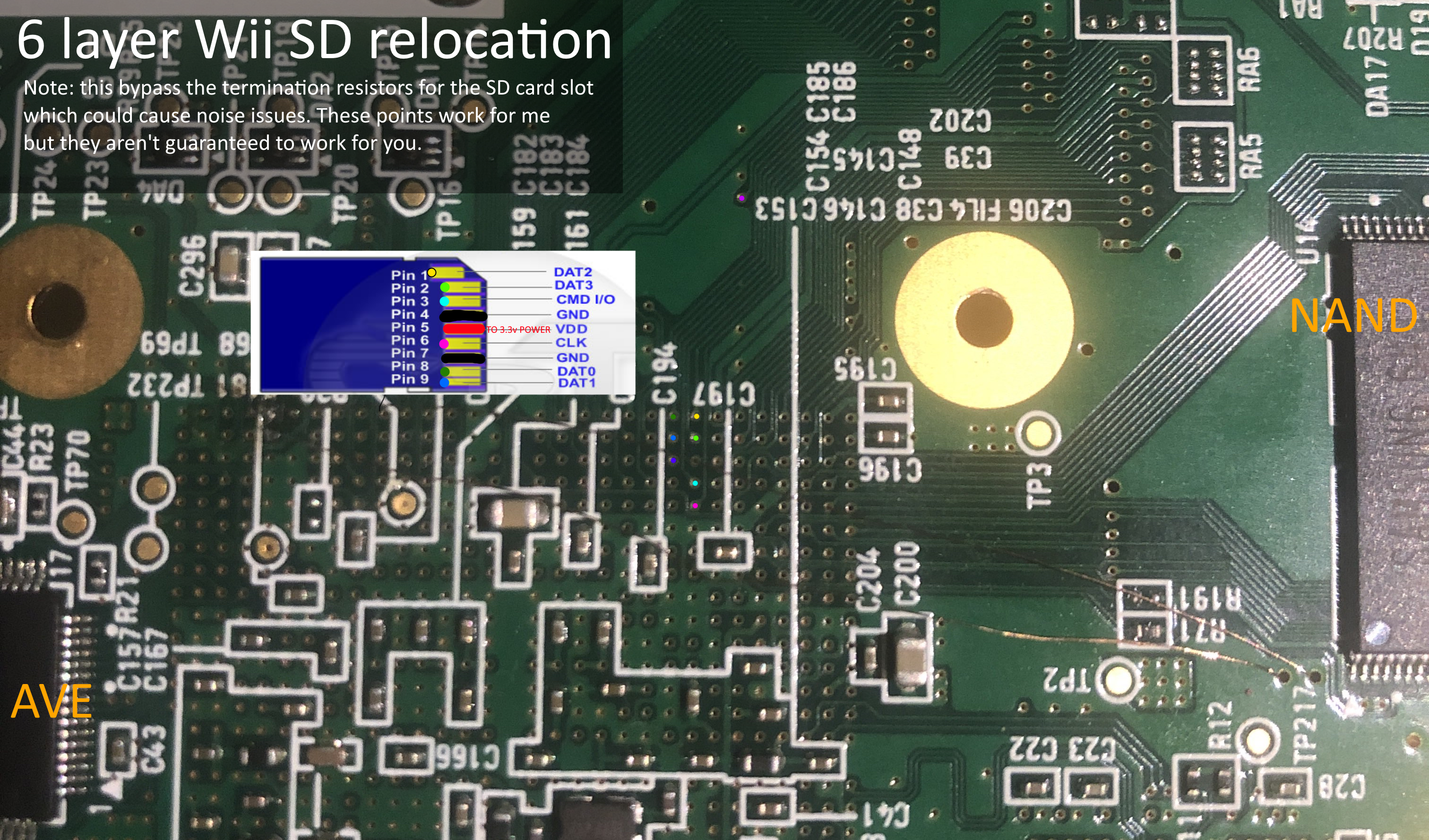

My Wii needed to boot into bootmii after trimming so I am posting the sd card relocation points here for anyone in the future that needs or wants to relocate SD.
This is a CPU-01 board but I would think the points are the same on other 6 layer Wiis.
I used the same color guide as the 4 layer guide so it should be simple to follow. I didn't need to short CD or WP to GND for it to work, but you may have to.
