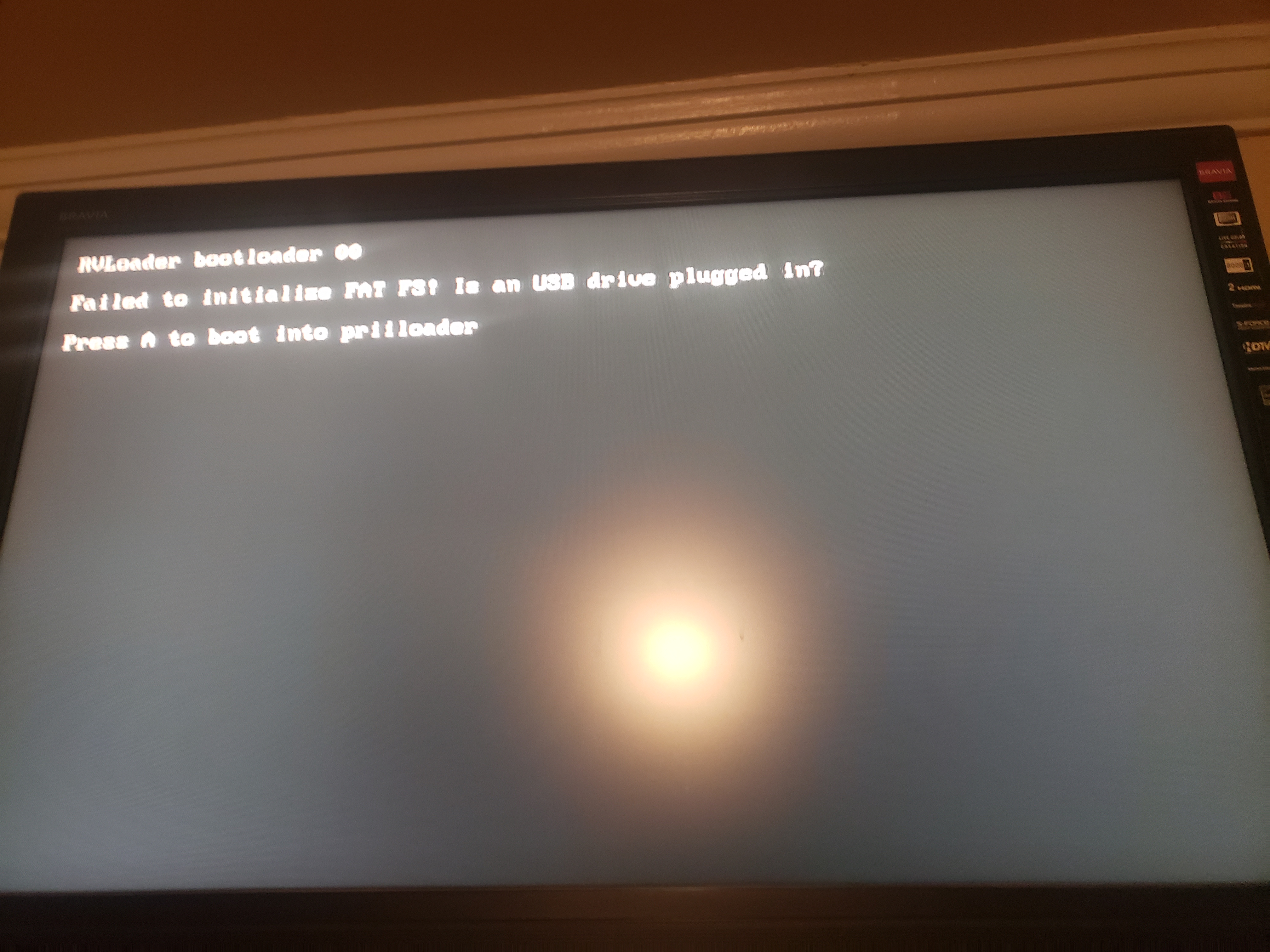

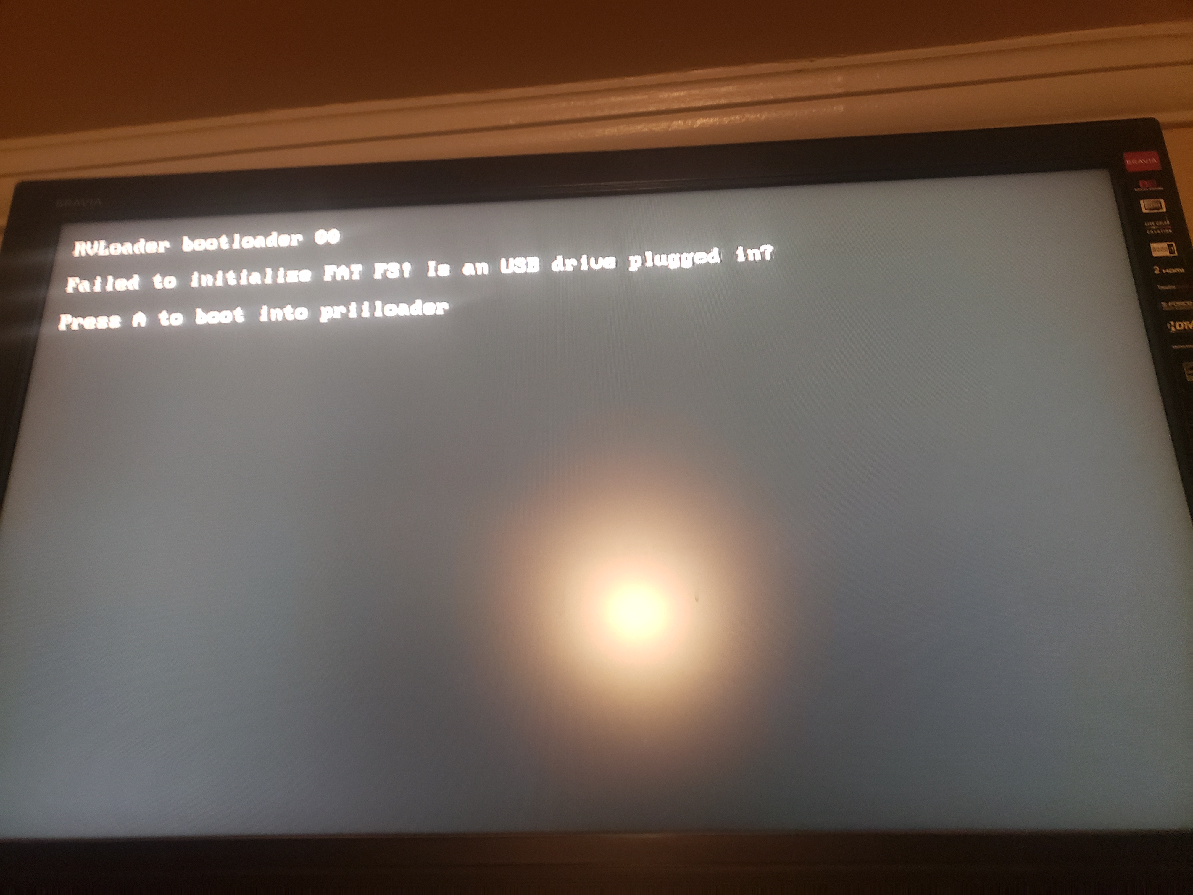

Hey guys im getting the same message another user posted. I built my Ashida, wired the PMS PD to the CM1 but im getting that error message. Using a SansDisk low profile thumbdrive with RV Loader. That may be the issue. Gonna replace it with a 128 Samsung 3.1 fit. If anyone has any other ideas let me know. Added a quick shot of my nightmarish wiring. …also im new at modding and may have made 100 other errors. Thanks
Be careful - A Samsung Fit Plus isn't actually small enough to fit in the PMS-PD 2 (though I did get it working with RVLoader). I tried, but had to switch to the SanDisk you're currently using and everything worked for me. I would check your wiring on D+/- before putting RVLoader on a new drive.
It was working pre-trim, yes?
Yes! The wii was modded to rv loader to make the USB just before the trim.

I almost had it working in the ashida case, i was able to charge and read usb through usb-c port to computer. i was mistakenly trying to wire both both cm1 and cm2 off the data + - I pulled the extras and got to a rv loader screen
… took everything apart to remove the extra wires. Putting it back i screwed up and started to put a battery in backward. Saw a fire pop. Reran power lines and got new batteries.
OK LONG (and a bit shameful) STORY DONE.
So i was happy to get back where i had been but couldn’t get the rv loader screen to come back.
That’s when I posted. But I now realize I can’t plug it on to a computer and see the USB anymore either. So… i may have done some damage. I’ll try to order another PMS PD when they are available. Hopefully didn’t fry the main board (getting good power readings from it). That one’s a bit pricier.
