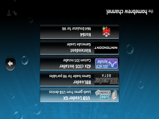

After I installed BBloader two years ago, my Homebrew Channel looked like this. Any ideas how to fix this?
It's anti piracy measure from Nintendo, it kind of is what it is, if you're using bbloader which is obselete or RVloader which is recommended there's no need to go to homebrew channel
Thanks for the reply. I actually don't use bbloader or RVloader that much, I prefer to use the homebrew channel. Do you think it's possible to fix this problem by reinstalling the homebrew channel?

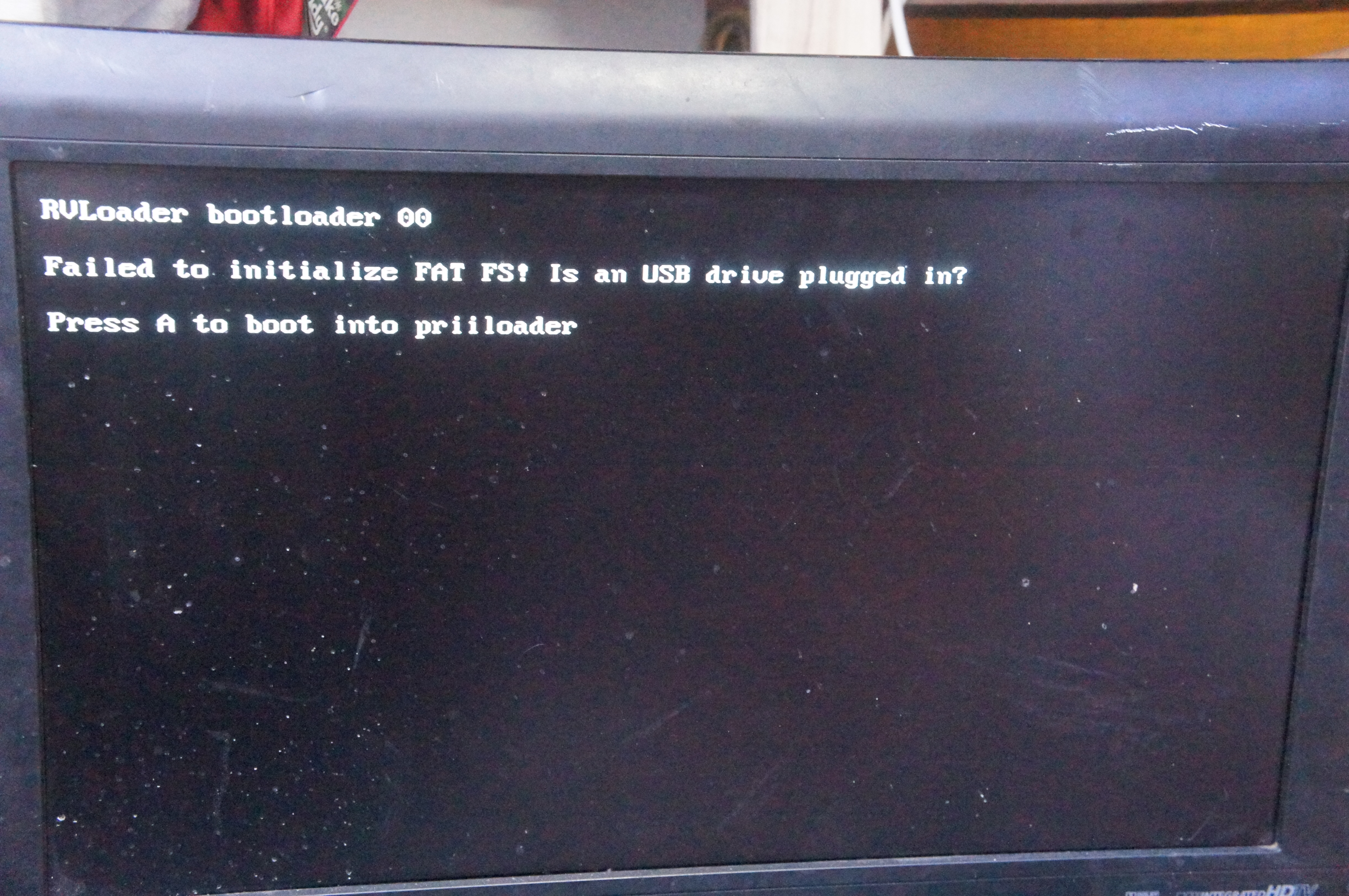

Well, pressing A didn't boot to it.
Right now I'm struggling to get GC games to appear, and get the Wiimote to not disconnect when Prime Trilogy loads.
Of course, default setting was "bluetooth off" and 1 on Wii mote = B for whatever reason...
