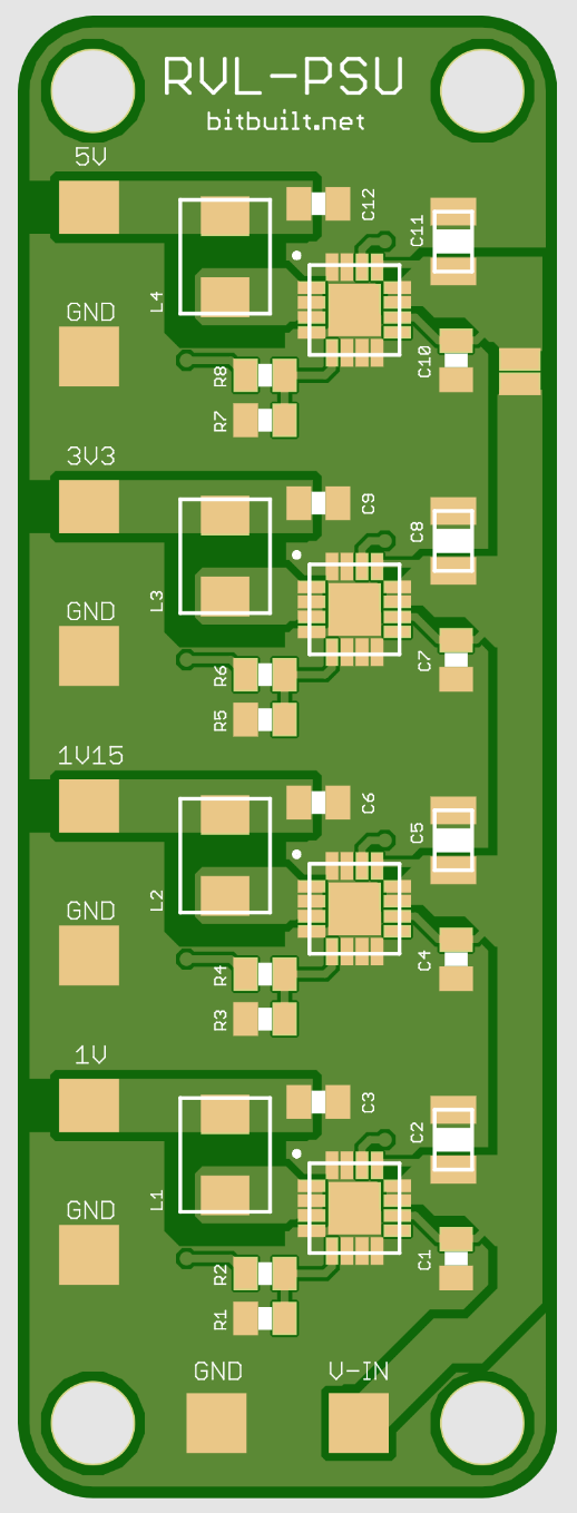

The RVL-PSU is a custom regulator solution for your portable and non-portable projects. It provides system regulators: 1V, 1.15V, 3.3V, and 5V. RVL-PSU does not provide any battery management. For projects involving batteries, it is recommended to use the RVL-PMS instead.
Improvements made from the previous version:​
  • Screw holes on the corner of the PCB for mounting in your enclosure
  • Optimized components and PCB layout
  • Solder pad jumper for setting power to the 5V regulator if it is not required for your application

All of the Reference Designators (Ref Des's) in the BOM (that I updated in my previous post) match to where the components go on the board (little white text next to all the components). If you're wondering how to orient the ICs, see the little white dot at the top left of the IC footprints. That should match with the marking on the IC itself. All other components on this board are non-polar, meaning that their orientation does not matter.

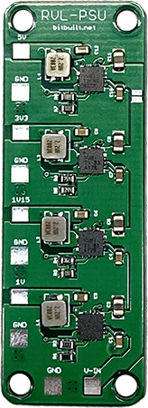

Coming in super late with this one, as I've been trying to get the RVL-PSU manufactured for my own hobby usage.
I ran into some issues with getting these boards manufactured with assembly (as opposed to doing them myself), since:
1) There isn't a CPL file that is included in this post that gives the coordinates of where the components should be placed
2) Generating a CPL file from the Eagle files in the OP attached .zip (RVL-PSU Eagle Files) actually leaves out the placements / designations for C7, C3, C11, R3, R6
I got the process started with a Gerbers upload to PCBWay, and I had to provide a CPL / BOM.
I used CrazyGadget's Revised BOM .csv file
I generated a CPL from the Eagle File, but then PCBWay told me I was missing designations
So I actually had to go through the eagle file, rename designations (since I think some were re-used and kept the same name, for example C7 would be named some shit like "C9" or C3 was labelled as "C4".) I've attached a few things:
1. A corrected Eagle board with the components named correctly such that exporting it should provide a CPL that includes all components so if you try to use a service to assemble they won't be asking Yo what the fuck where are components X Y and Z supposed to go?
2. A generated CPL from the updated eagle board... well it's more like I went through every line of the CPL that I generated previously and hand checked things were correct.
3. The fruits of this journey are pictured! Red PCB PSU! and I took a multimeter to it. It's outputting correctly!
Hopefully I didn't miss anything, but this thread was super helpful in getting me a huge headstart.

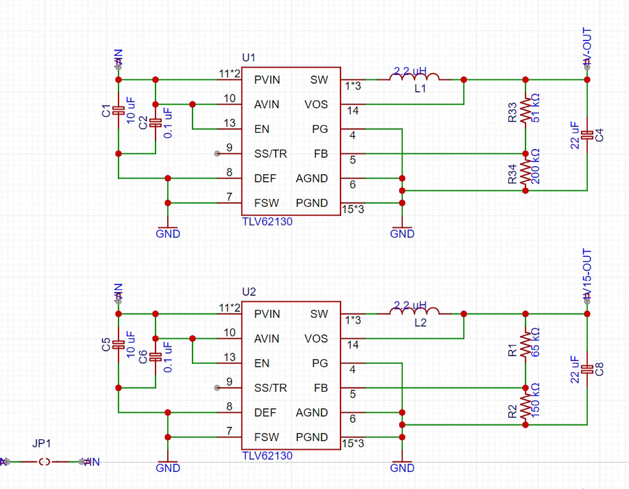

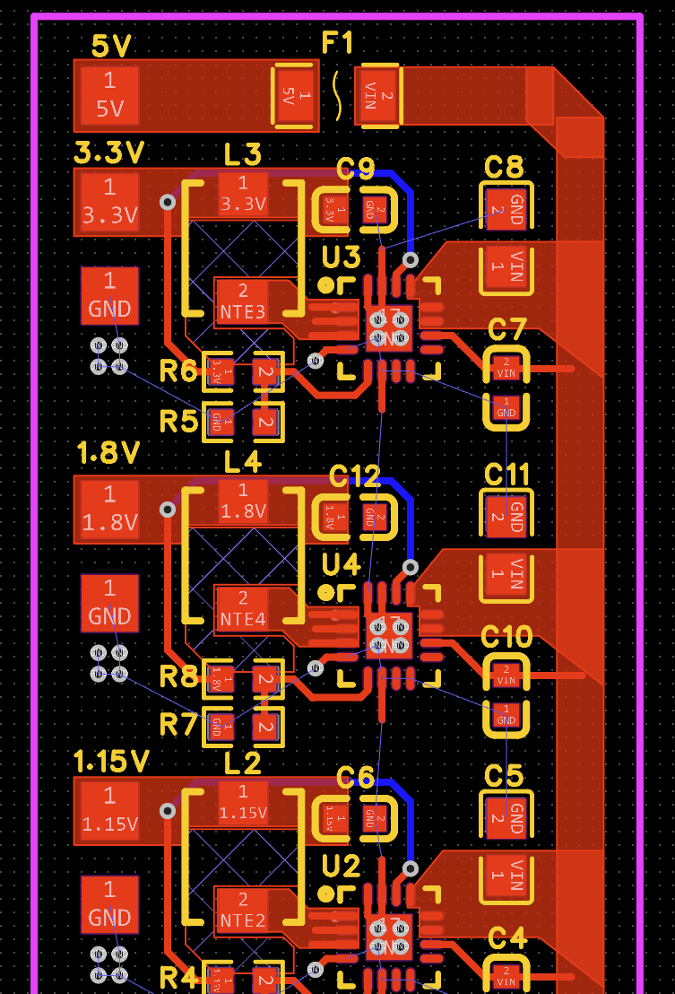

I apologize for my limited English. I'm trying to create a custom voltage stabilizer for the Wii, referencing Noah's design. Because my knowledge in this area is limited, I have a portable power supply that outputs 5V2A (approximately). I'd like to know if I can skip the 5V regulator circuit and just add a 3A self-recovery fuse.
Also, I want to add a voltage regulator here to provide 1.8V (removing the Wii's LDO), but I don't know how to calculate the resistor values. Therefore, I consulted CHATGPT, and it suggested choosing 18kΩ for R1 and 10kΩ for R2. To validate this, I asked CHATGPT to calculate the resistor values for 1.15V, but the results differed from the actual resistors in the RVL-PSU. This has left me puzzled. Is it because CHATGPT made an error, or is the output of 5V2A not suitable for the RVL-PSU?
If it's an error from CHATGPT, does anyone know what resistances should be chosen for R7 and R8 for 1.8V?
I want it to be able to provide 1V, 1.15V, 1.8V, 3.3V, and 5V. Please forgive my possibly very foolish confusion.
Attached are the reference schematics (Figure 1) as well as some of my rather foolish modification ideas (Figure 2).

Don't ask ChatGPT questions and expect correct answers. Especially about electrical engineering. The equation for finding the Rset resistor values for a given output voltage is in the datasheet for that specific regulator. It should be alongside a table of commonly used output voltages and their Rset values.
Also, 5v2A may not be enough to run the system in a stable manner. 5v3A will be more stable, and yeah you can skip the 5v regulator if you plan to use 5v as the input voltage.
