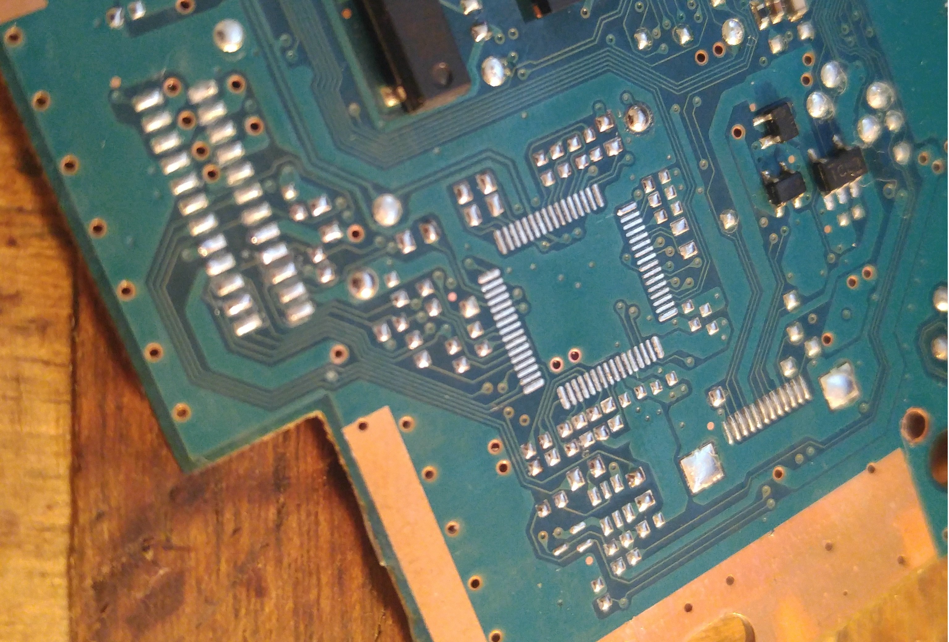

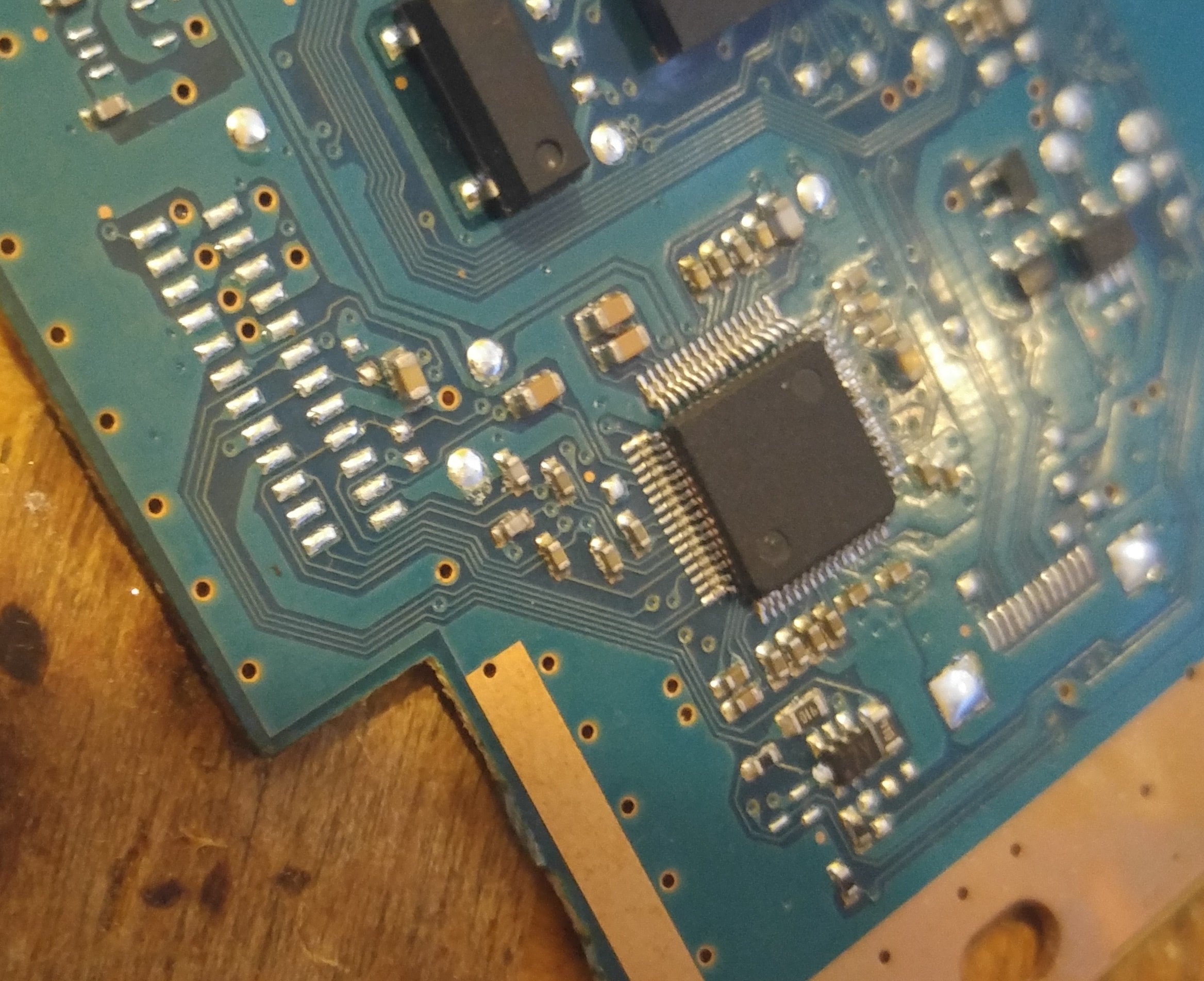

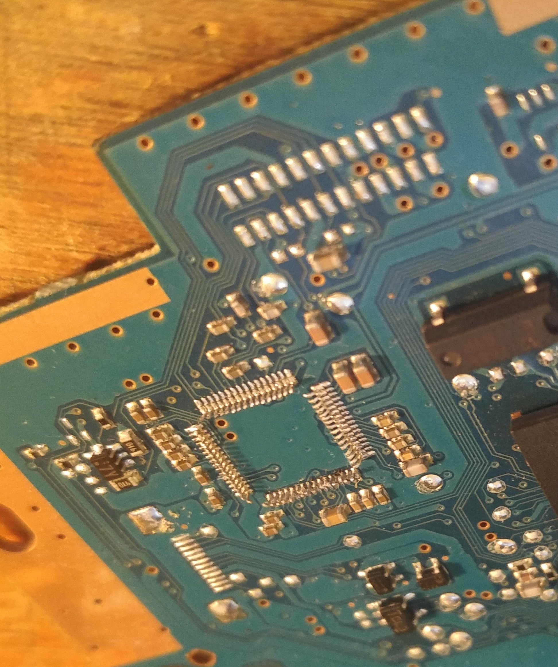

I was just preparing my board for trimming and I thought I'd post a little guide about removing ICs, provided you don't intend to keep them.
Cut the chip legs with a razor blade on a stick (or whatever they're called)
Pick up the main body
Desolder and clean the pads
PS: not sure why they all uploaded at weird angles
That's it lol, a craft knife!! and as an additional tip, you can make craft knife blades last longer if you own a whetstone
