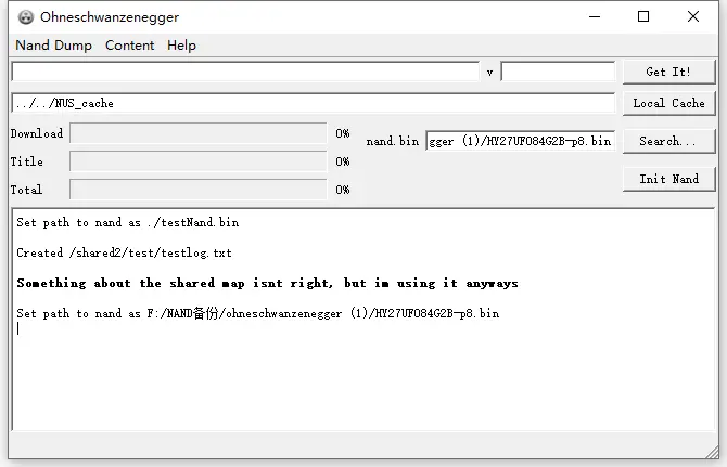

A while back, my Wii encountered the dreaded 003 error. I used a NAND programmer to read the Wii NAND data, intending to fix the 003 error using the ohneschwanzenegger software.
However, after importing the NAND, the software failed to recognize the data read by the programmer.
Unfortunately dumping the NAND with a programmer is not enough, as you're missing all the console specific encryption keys that you would have gotten through a BootMii dump. However, Error 003 might be recoverable through other means. I would give these WiiBrew articles a read and see if this would work for you. https://wiibrew.org/wiki/Error_003 | https://wiibrew.org/wiki/SaveMii_Dongle
