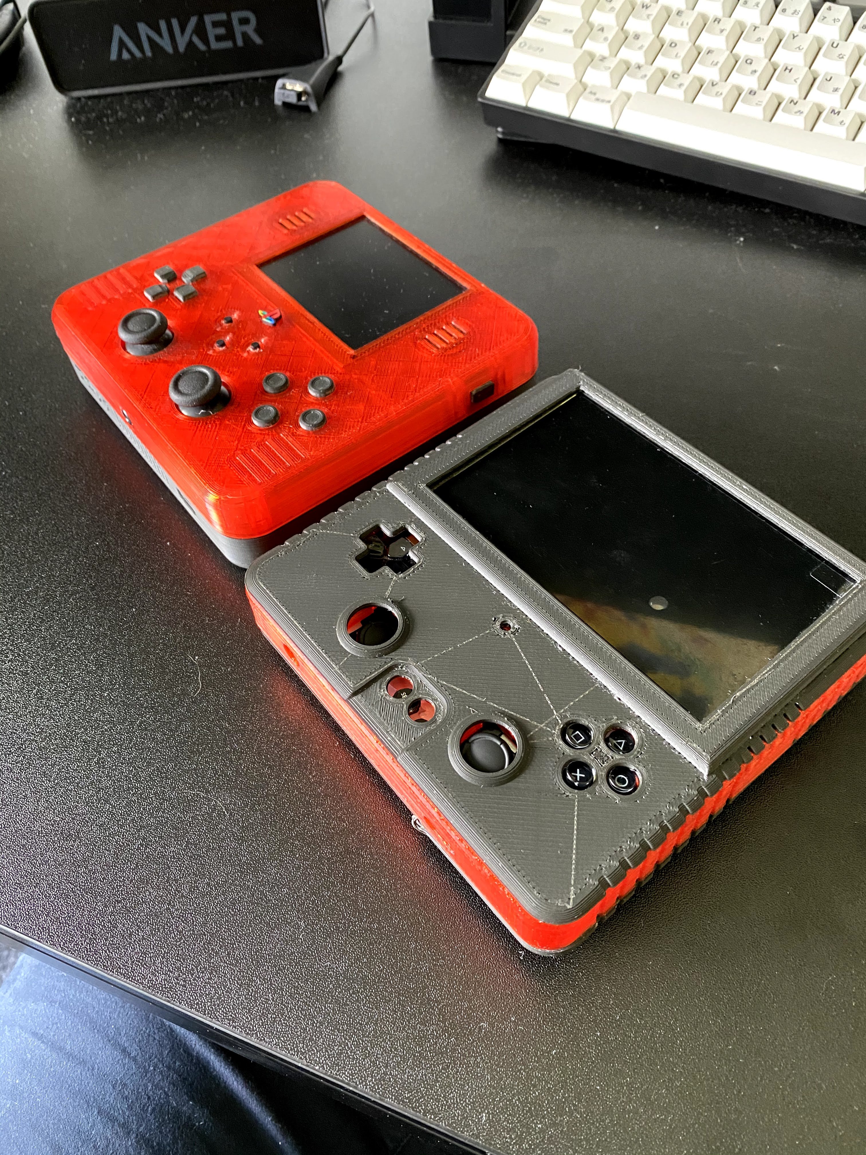

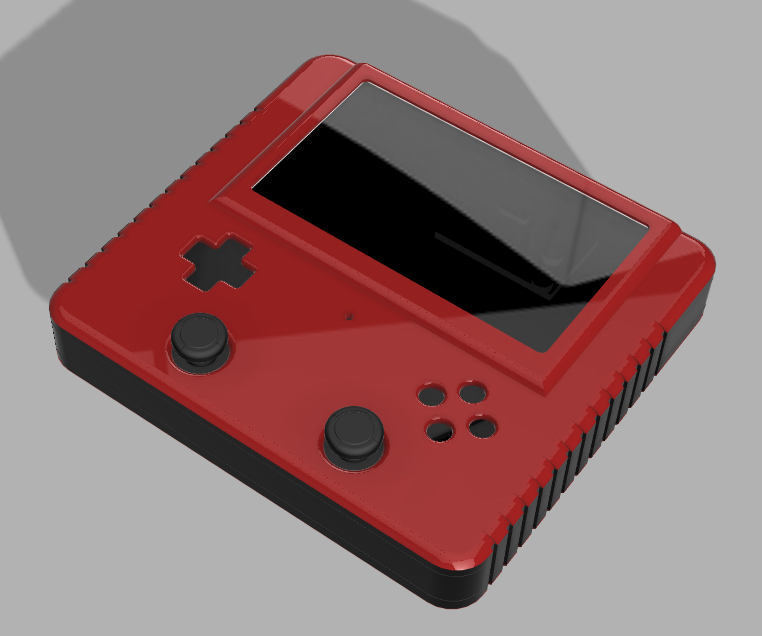

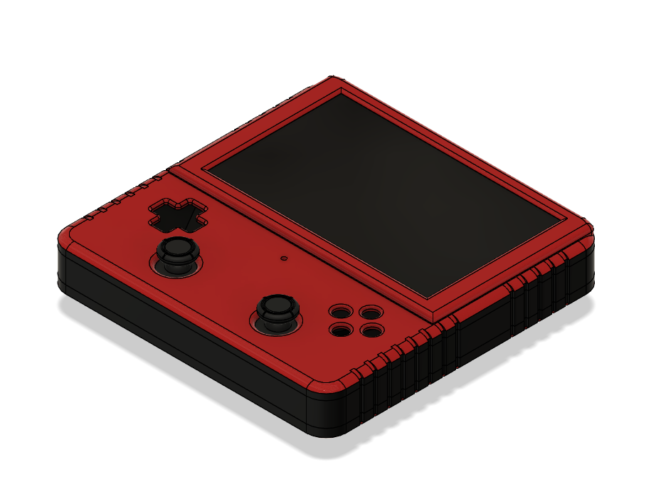

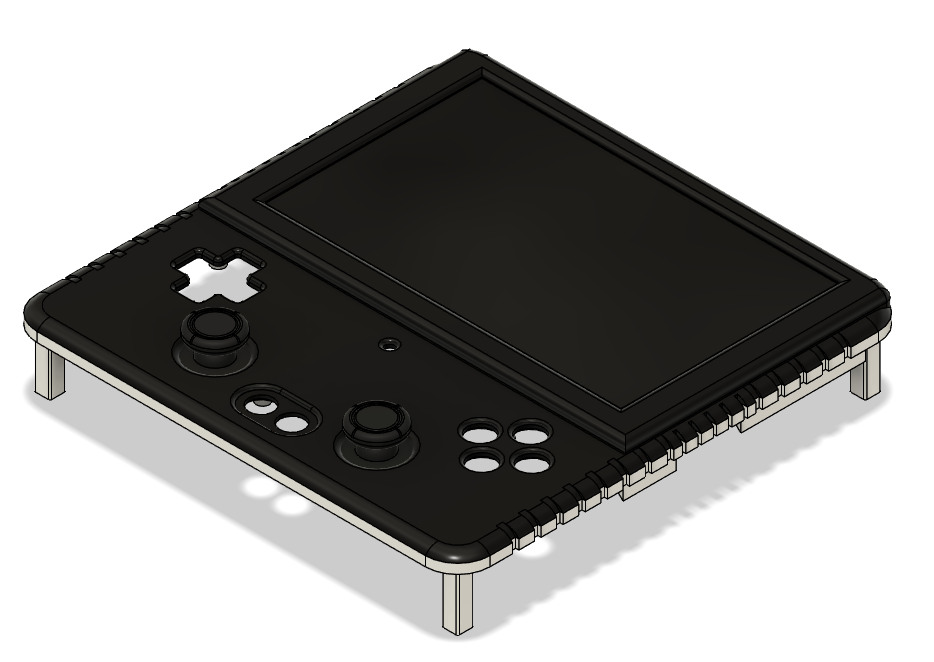

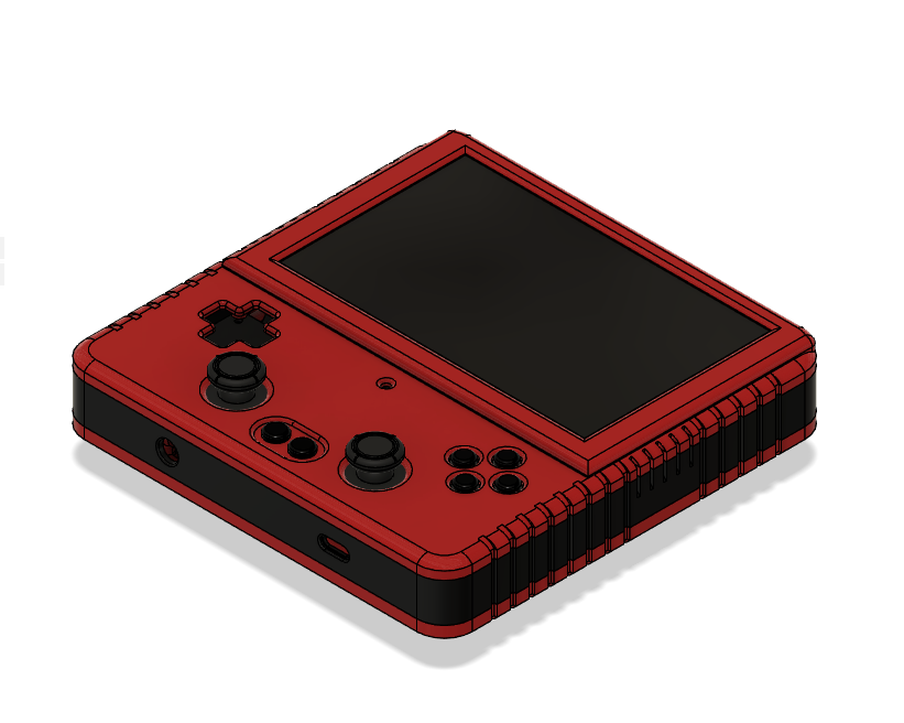

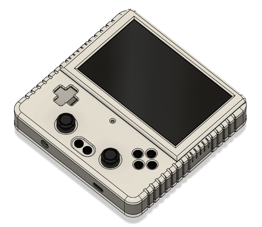

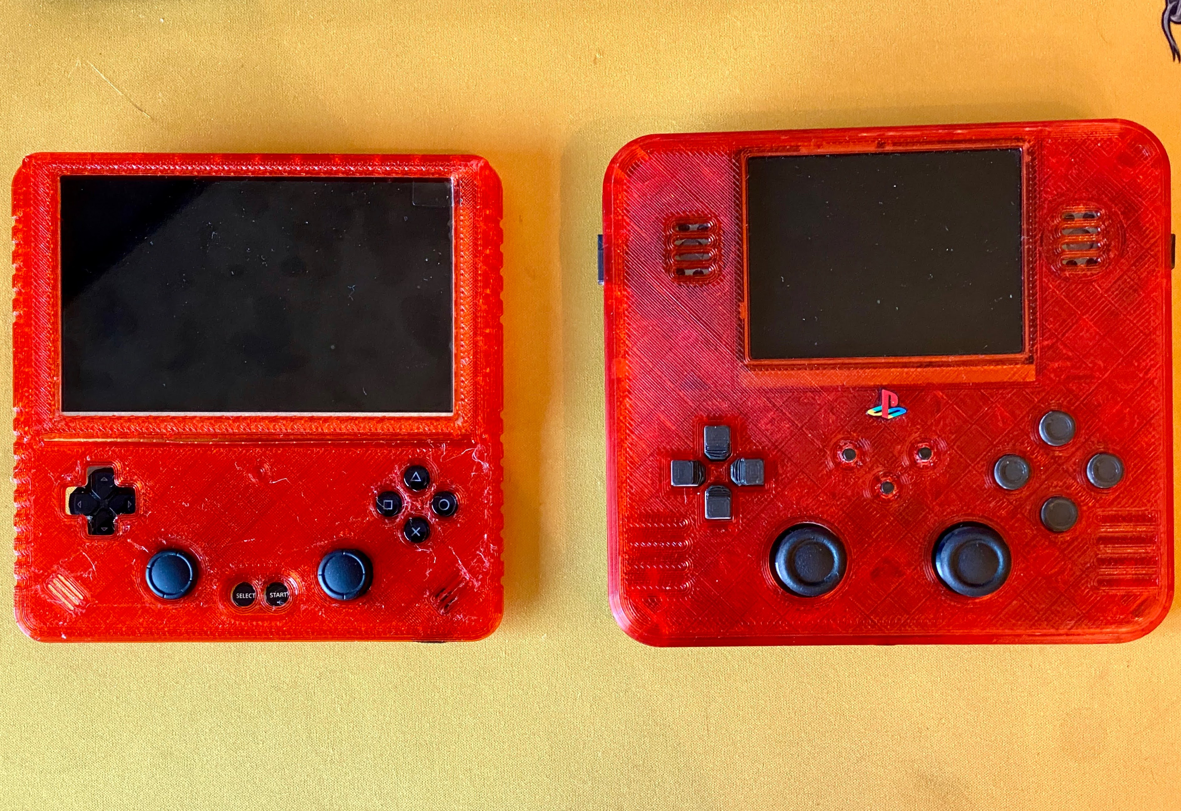

Here is the current look compared to the rev 1.
Rev 1 (Yeah i deliberately made it uglier in software)
Rev 2

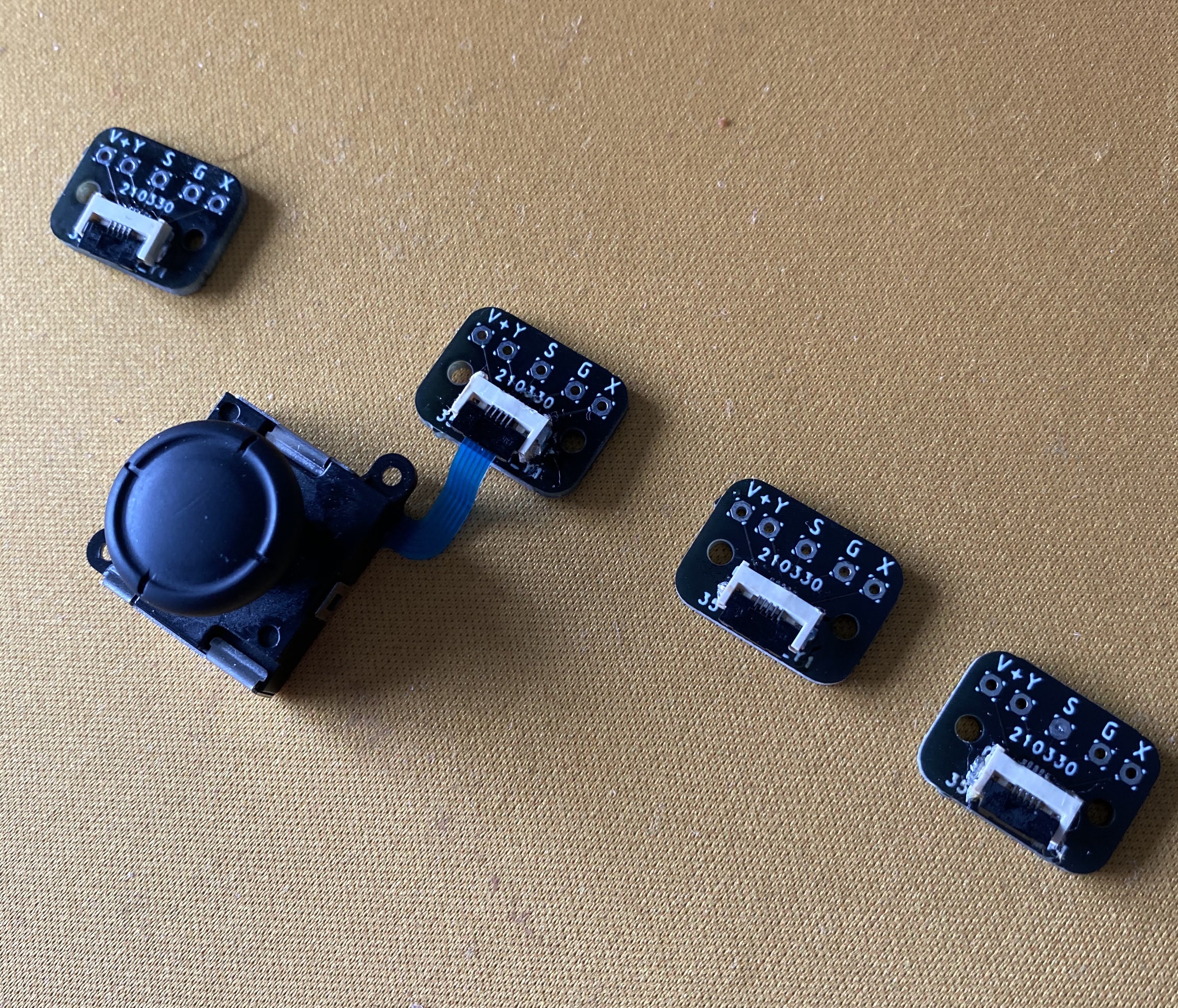

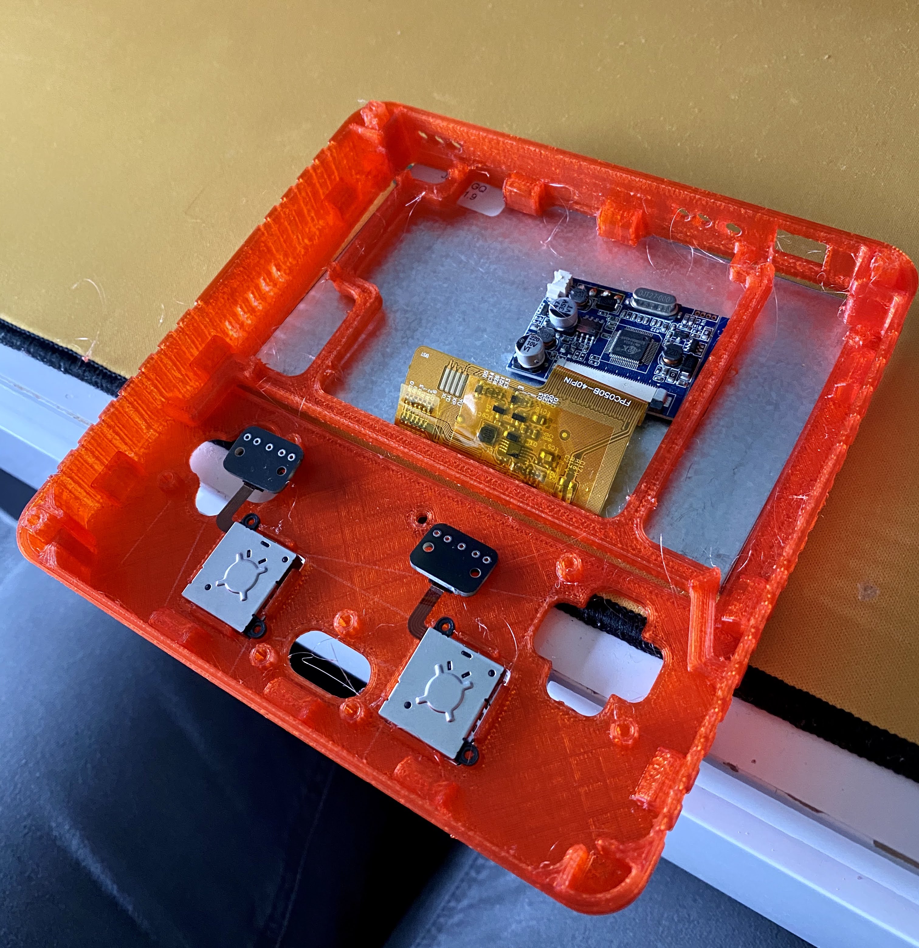

My first attempt at PCBs came in! Nothing crazy, just breakout boards for switch joysticks. This was also my first attempt at smd soldering and after some flux and a wick i got the pins cleanly soldered with no bridging.
I will go ahead and make some for the main controls too at some point. I will likely only do this for all but trigger buttons as i believe it's an unnecessary cost.
I decided to use these joysticks for a few reasons. The main issue being that my previous joysticks attached to a plastic mount and eventually the threads gave out and i had to resort to good ol' hot glue. Also, since the analogs were not mounted with solder they were also hot glued in and were slightly wonky and this messed with my OCD.

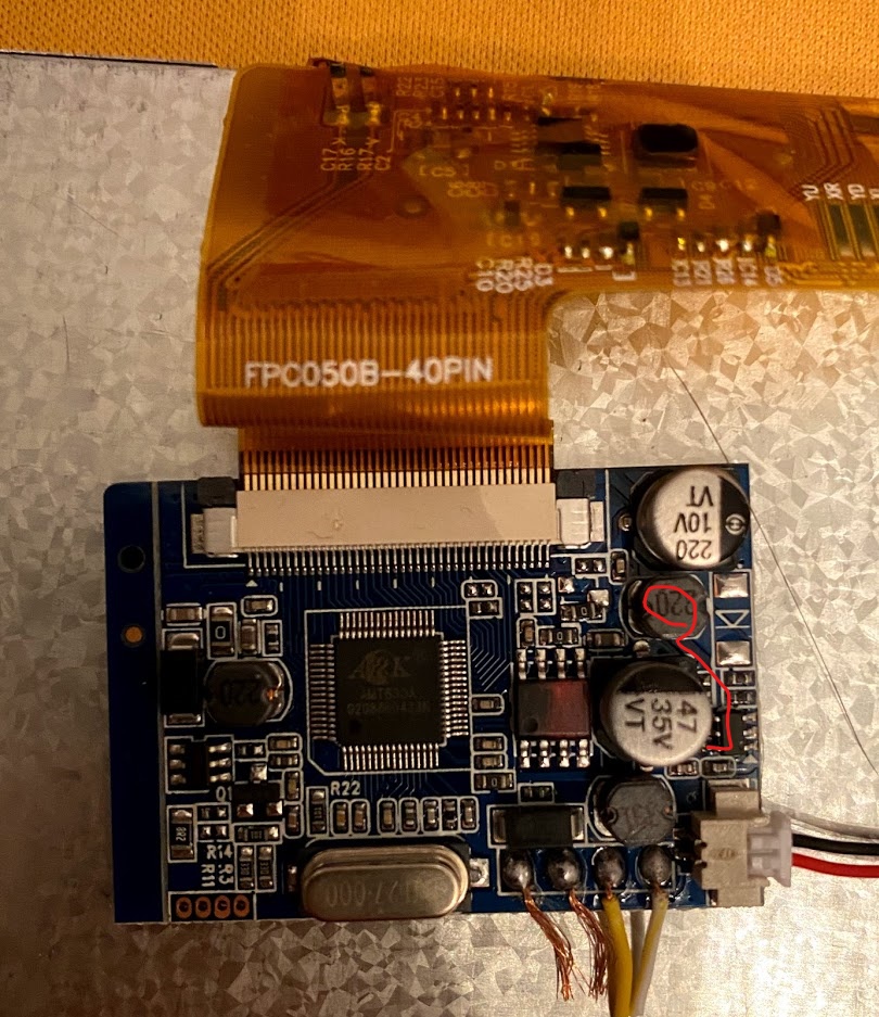

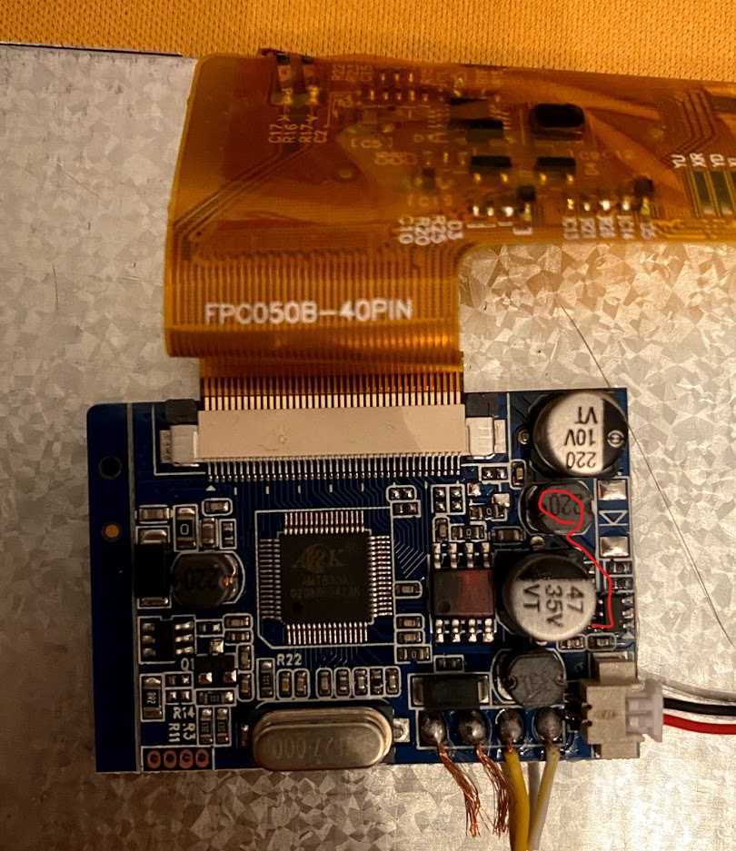

I also got hold of a very cheap 5" composite screen that I believe I can modify to 3.3v as the inductor outputs this.
I could not find the datasheet for any of the ICs but can confirm pin 4 outputs 3.3v to that inductor so hopefully this is possible, I could not find any 5v lines anywhere.
If i ruin it, it's fine, It cost like £14.

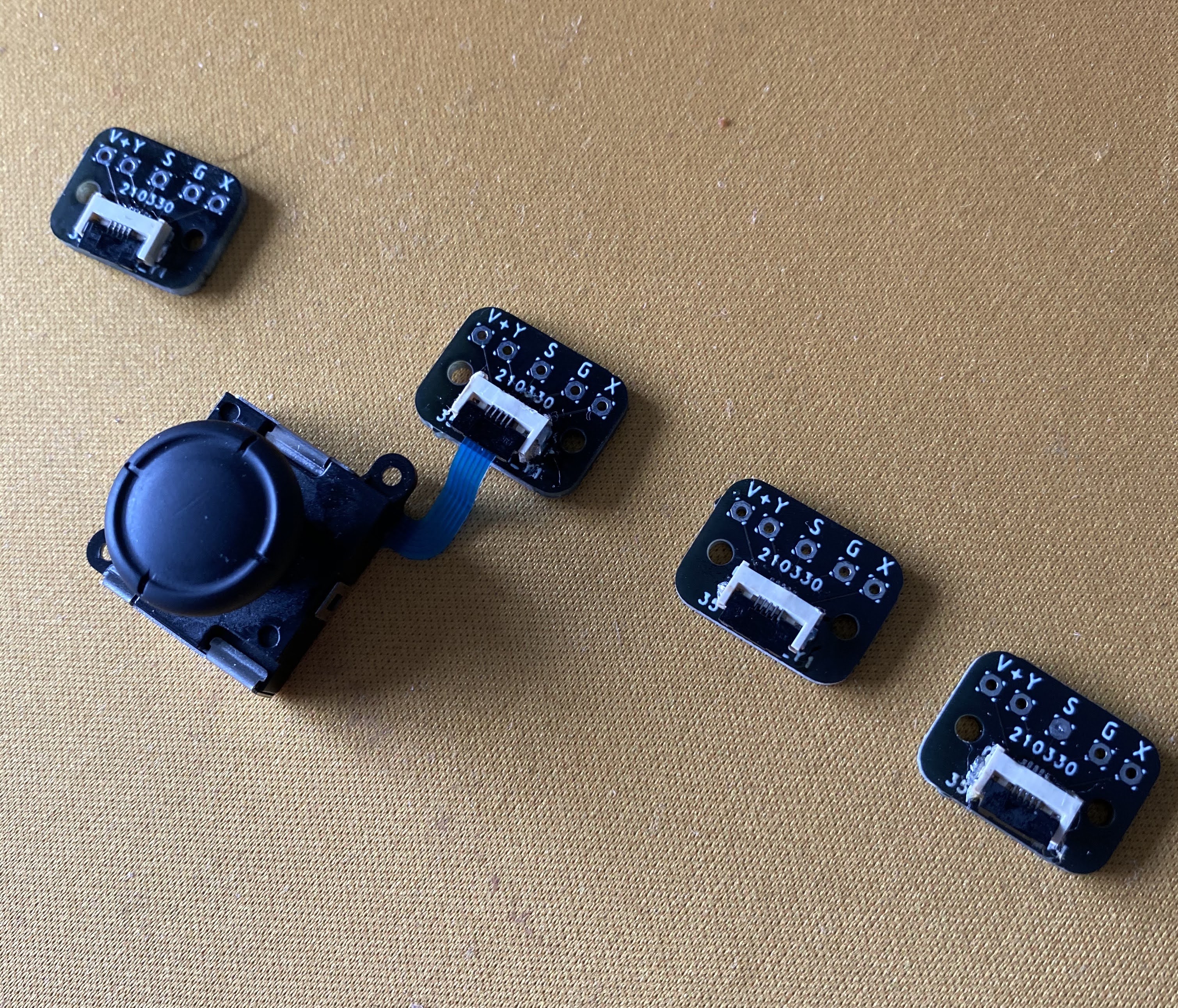

View attachment 16629View attachment 16630

Nice work!!!!!!!!!!!!.. I have a question related to the Analog sticks... How is the connector named? I mean, I don't know how to search the technical name of the socket use to connect the flex cable comming from the analog stick
Thank you!
The connector is a 5pin FFC connector with 0.5mm pitch. If you put that into ebay you may find them or you can search them up on digikey. There is a good guide on how to convert nintendo switch joysticks to be used on the forums too: https://bitbuilt.net/forums/index.php?threads/nintendo-switch-joysticks-on-other-consoles.2225/
You will also need a breakout pcb for them as well but that is a custom job

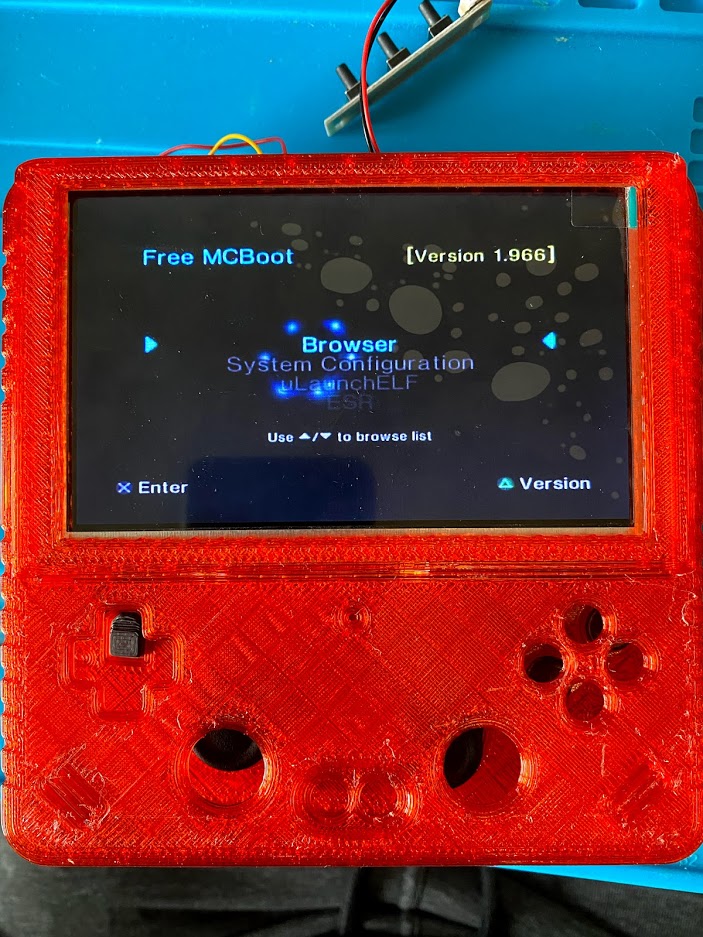

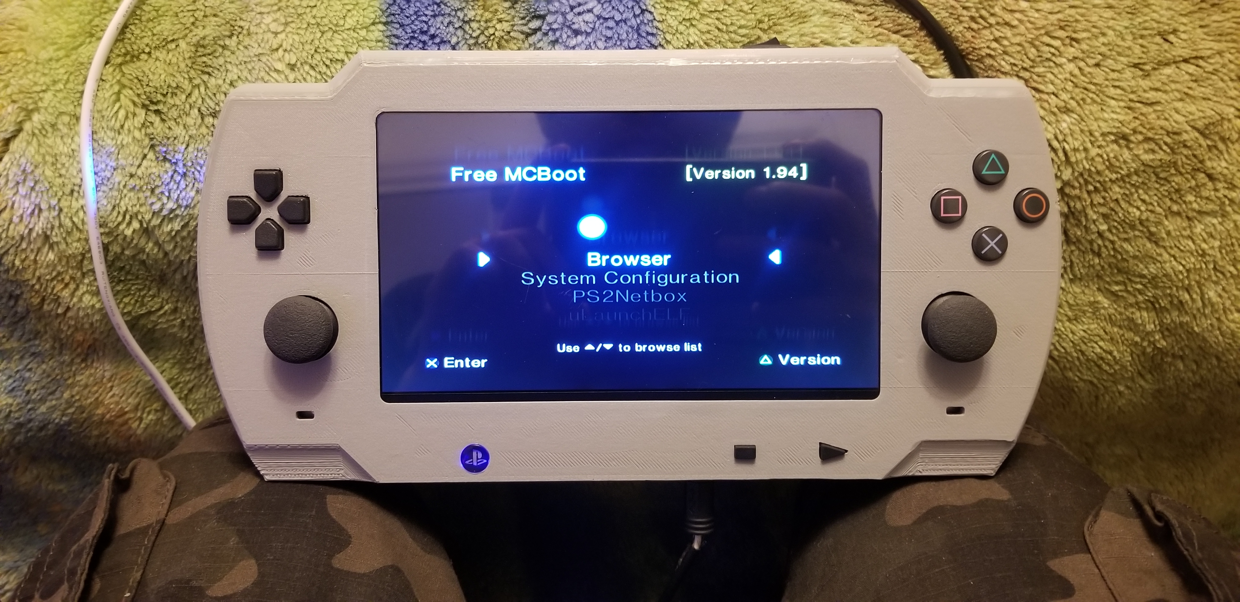

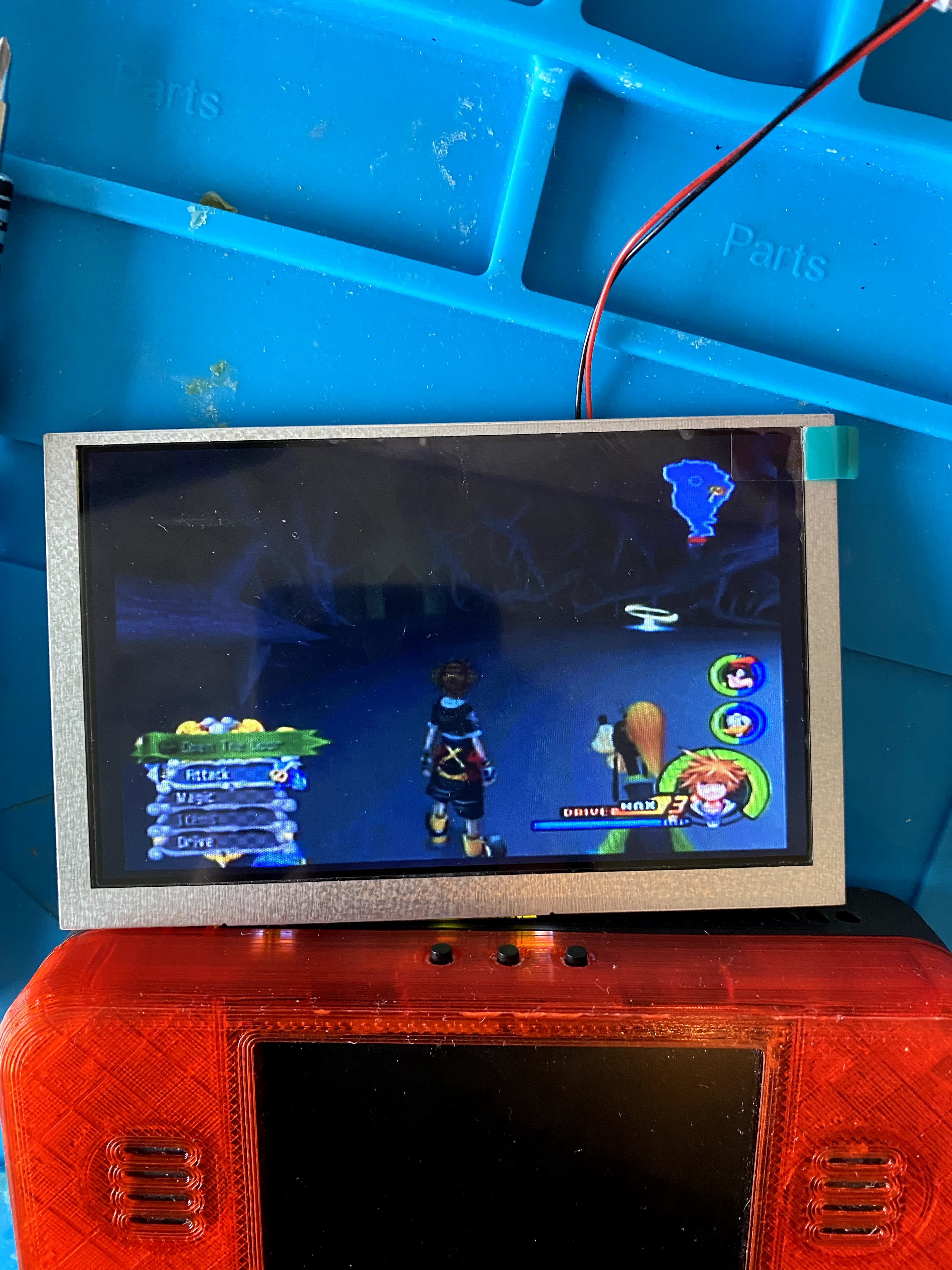

I haven't been doing much since life got kinda busy, but I have at least tested the screen and all works okay. Doesn't look bad for a cheap £14 screen!
It's still hooked up to the old revision but that gives a good idea of the front at least.

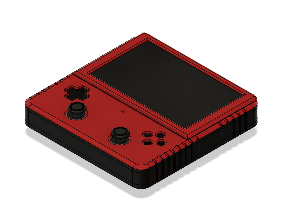

Only thing I've done with the CAD design is put the speaker holes on the side this time, I might angle the speakers at 45 degrees. It's hard to see but some of the ridges on the side are holes to let the sound through.

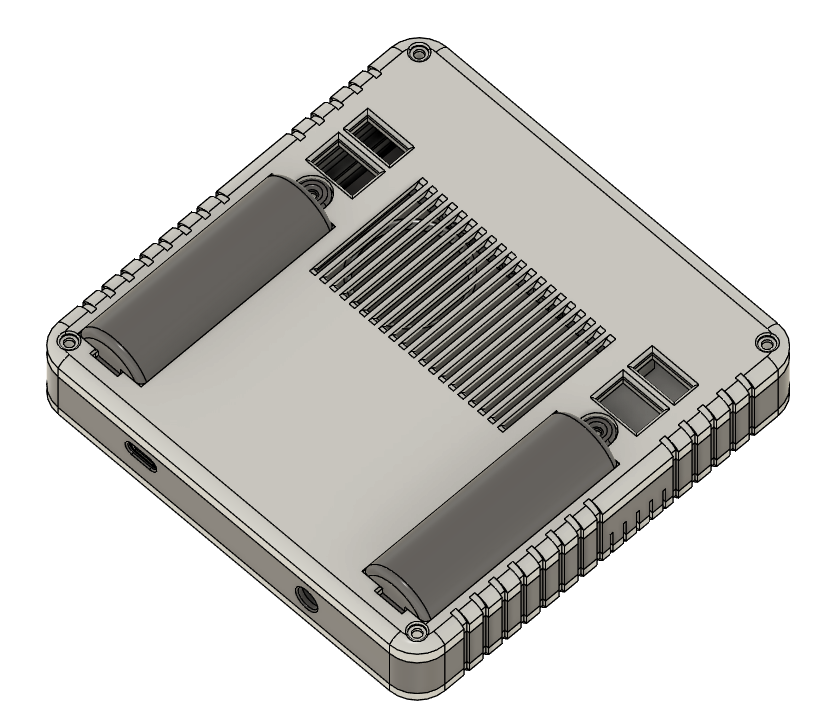

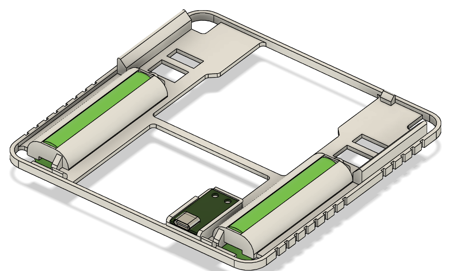

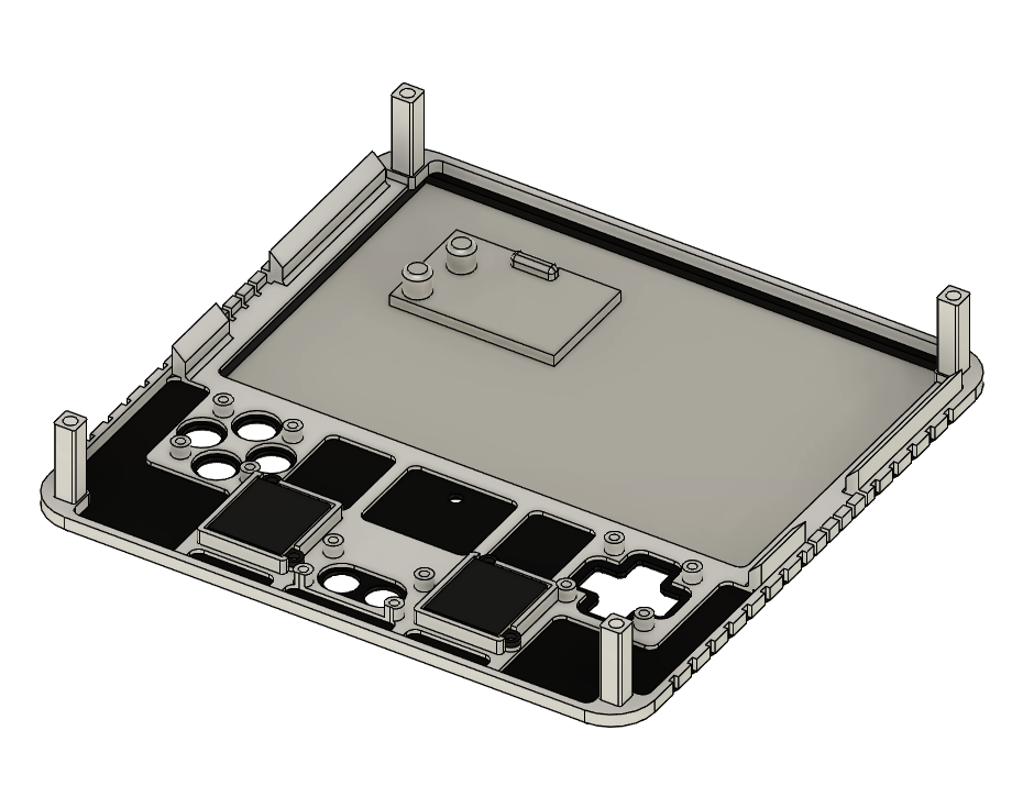

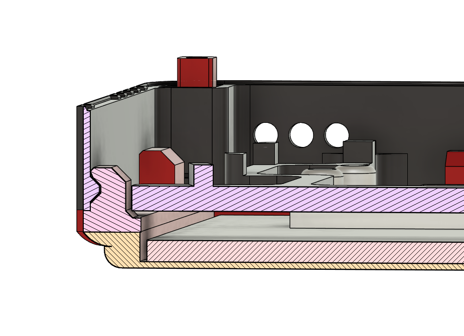

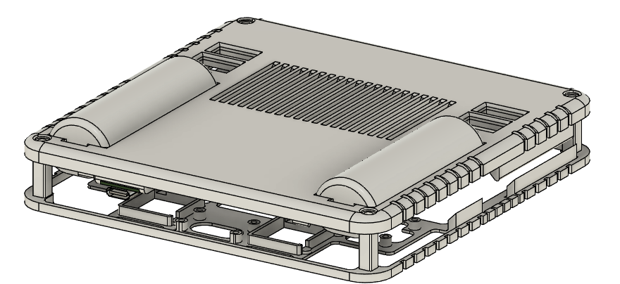

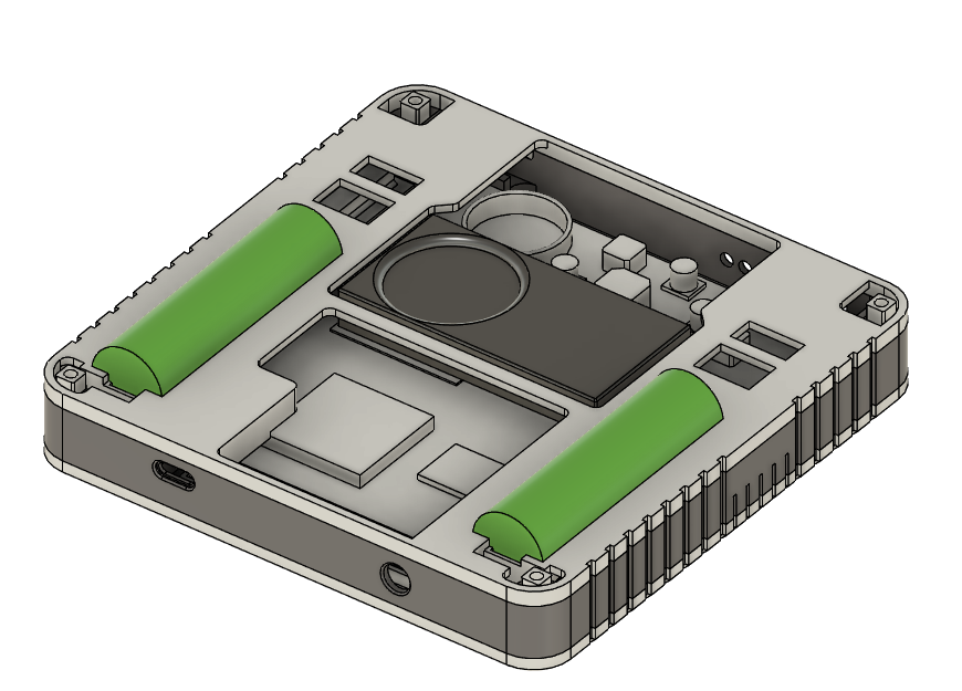

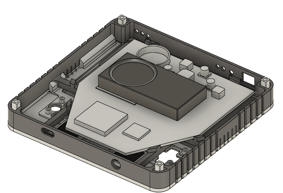

I thought I would give a quick summary of how the design is layered as I think it is pretty neat. I will do a much more indepth version when I post the final build in The Cutting Edge. The design is back loading so to get inside and repair anything all you need to do is unscrew the 4 screws on the back, I am hoping that is all the screws I will need to to keep all layers together well.
I like to think of it as a sort of 'Hamburger' design lol.
The system is layered as follows:
  • Front
  • Front Bracket
  • Middle Bracket
  • Back Bracket
  • Back
  • Battery Grips
Front Section
The front face is glued onto the white bracket, which I will have to do by hand most likely with a 5 min exoxy. The white mount has alignment walls so the middle bracket can slide in and not need to be glued. It also prevents my hands from bowing the sides in during use.
I kept these parts seperate as I wanted to be able to print as much of this portable with 3D printing in mind, which means flat sides. It also allowed me to experiment with more abstract designs without worrying about supports.
Middle Section
Here there is a bracket that keeps the motherboard from moving around when fully assembled. The idea with the middle section is that it isn't glued allowing me to slide it off during maintenance. Ignore the collision with the alignment walls lol.
Back Section
The back section again does not glue to the middle, but glues the to back plate instead. There are more alignment walls to keep it from bowing in during use and to keep everything square of course.
This is were most of the electronics will be mounted as well as the motherboard will be resting in this section.
As you can see here the 4 screw posts go straight through to the back piece that is glued to the back bracket.
All Together!
The outside hasn't changed much but I am experimenting with a old-school colour pallete as you can see :)
I have been test printing and optimising slowly, hopefully should have something wired up in the next couple months.

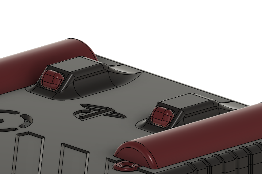

I still have the triggers to figure out, which will require a full test print so I can see if it's comfortable or not. I may attempt to glue on the triggers similar to the G-Boy so they work with the ergonomics of the grips
Thanks and sorry if that was information overload! :)

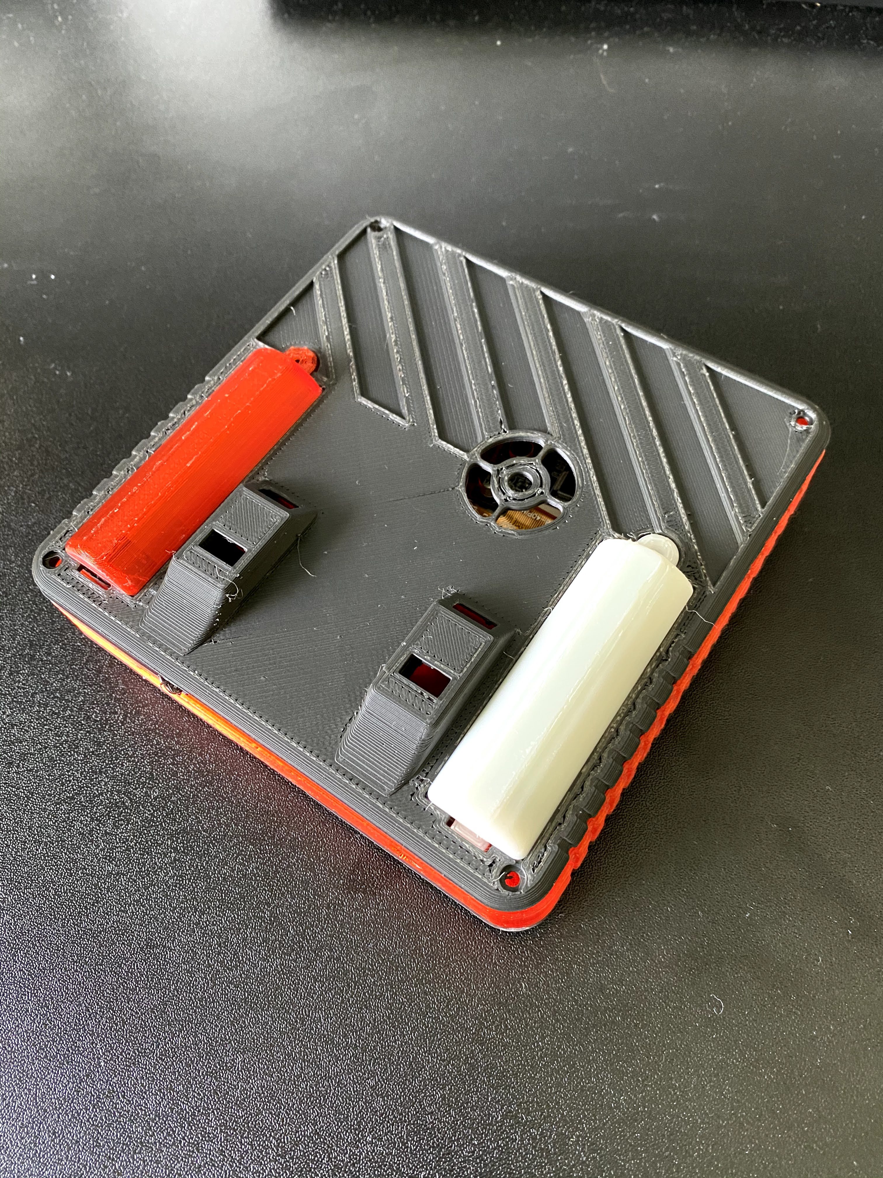

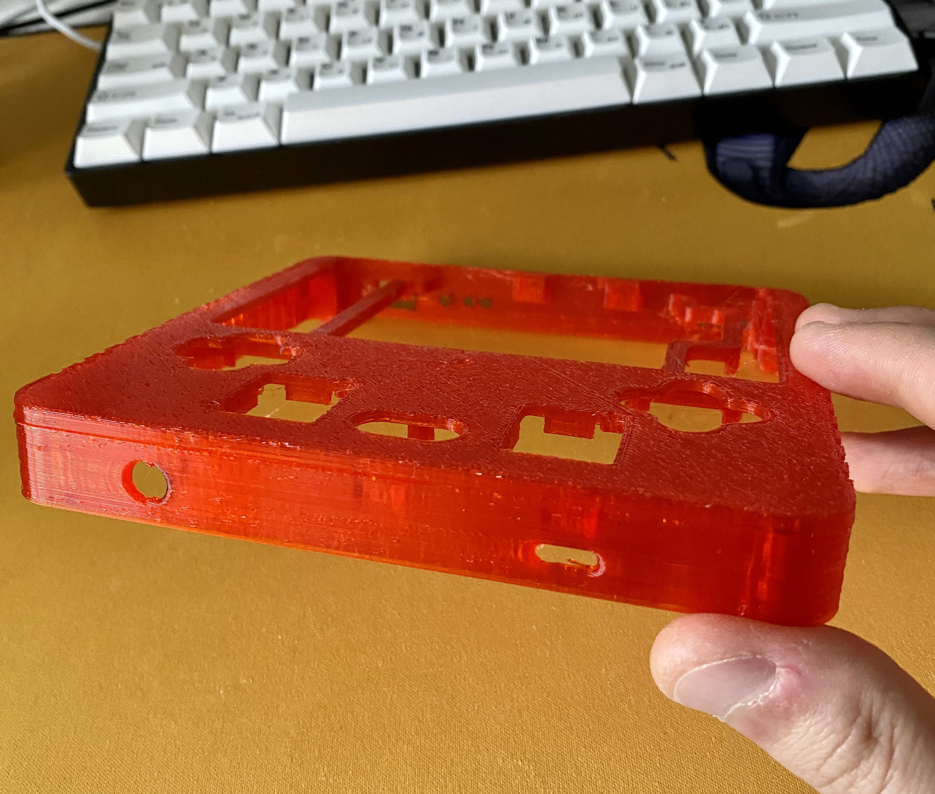

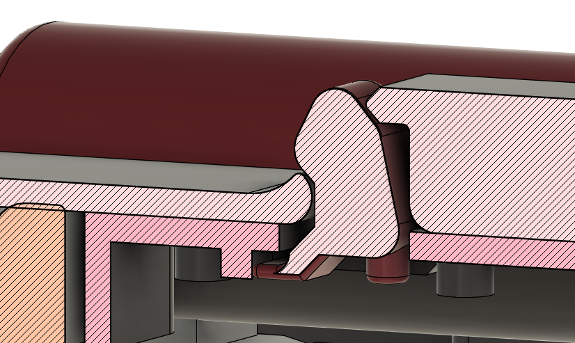

I realised that simply sandwiching layers was not enough! I had to resort to making some simple clips to keep the shape consistent along the edge. I was running into issues with gaps and seams between the brackets and these little brackets will help keep things tighter.
I did two test prints and it seems to help quite a bit. I was initally going to rely entirely on those 4 screw posts going all the way through the system but this works much better. It also helps stop me pushing the sides in with my fingers when im sweating it out on tekken or something.
Excuse the terrible stringing in this photo, I think my printer is in need of a new extruder before I get around the to final print.
Things are starting to take shape!
The rev 2 isn't much thinner than it's original design but it lightyears more comfortable despite it being a portrait system.
I have added a raised section for the triggers and bumps and feels nicer at the expense of more bulk, needs some tweaking but going for something similar to the gboy. I also really like the aesthetics of the back.
This is only a rough print with barely any internals. It will soon be time to gut the original ready for it's makeover.

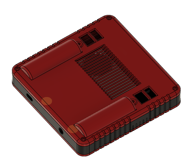

So, I took a small hiatus.
Anyways I am back with this project and honestly don't think it will take too long now (I said this was gonna be a quick project too!)

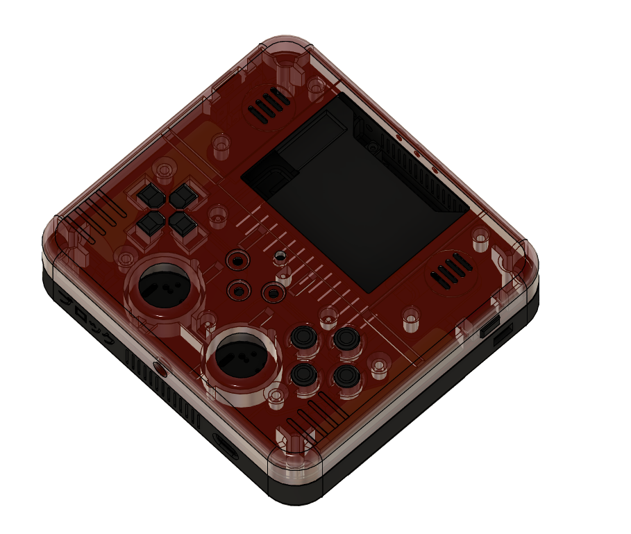

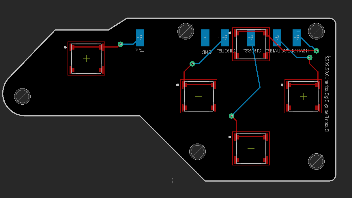

So after many test prints I think i've come to a semi-final revision of the portable now. I decided to make an unorthodox approach to the bumper buttons and added them to the face of the device.\
As for the triggers, I am experimenting with a rocker-style button which I am hoping will be comfortable to rest fingers on and add more grip to the device.

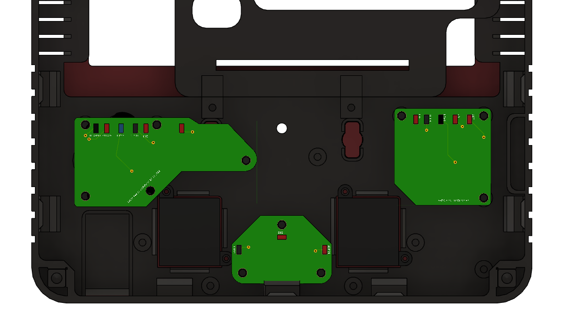

I have also been dabbling in PCB design, unfortunately I can't quite grasp the complexity of anything other than breakout boards so that's all I am going to attempt for now.
I have made button boards with breakouts for various controls on the ps2. I may add an amp board if I can figure out datasheets in future.
