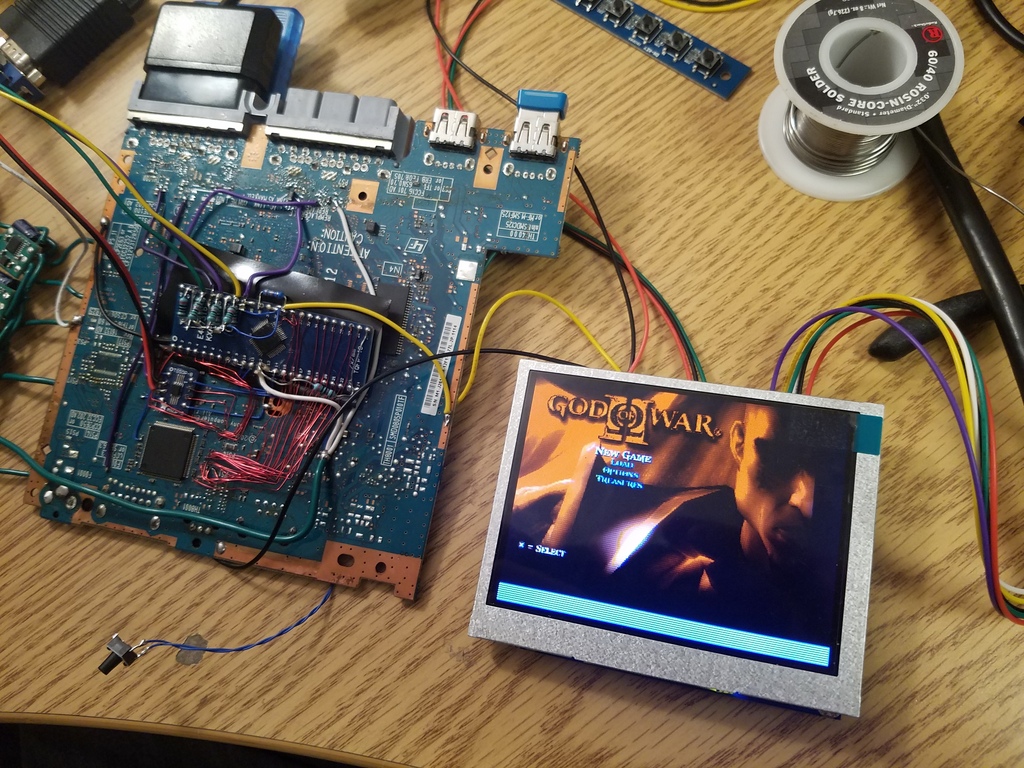

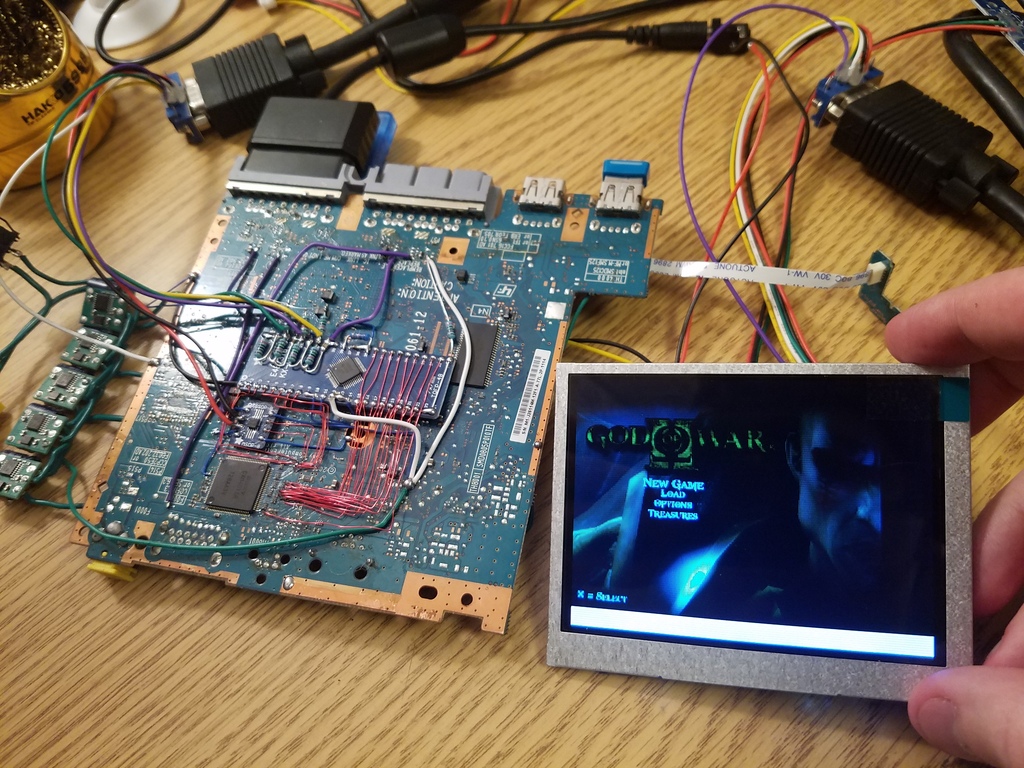

I'd like to add that I got the video dac mod working with all the pixels. For whatever reason, the red output was internally grounded after weeks of troubleshooting on and off. I put in a 12v to ground and that seemed to do it.
Weeks of troubleshooting this board have left my initially clean wiring a bowl of spaghetti. None the less, it is working. The colors could probably be tweaked a little better by setting resistors on the chip, I'll work on that next. Also, the bar on the bottom of the screen is a quirk within the 4" screen, it looks fine on other compatible VGA monitors.

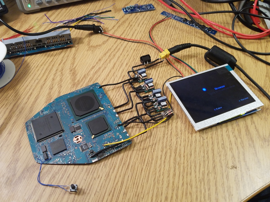

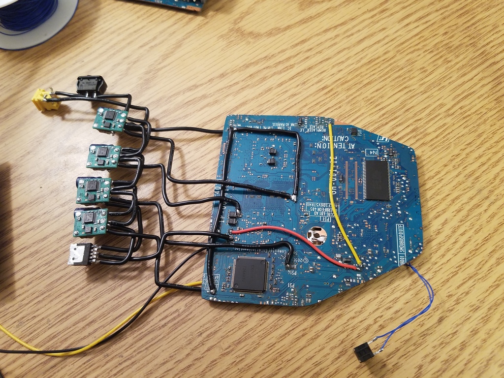

This is pretty much as far as you would want to cut without having to solder to a bunch more traces. I was having an issue where the board would not boot every time I turned it on. I narrowed it down to the 1.8v line(s) and with help from @Aurelio he determined the lines must be sensitive and therefore should be powered from a linear regulator. Since I don't need my Wiis anymore I hacked off the wii ldo and now it boots 100% of the time :)
I haven't wired up the peripherals yet because I will be going smaller very soon..
