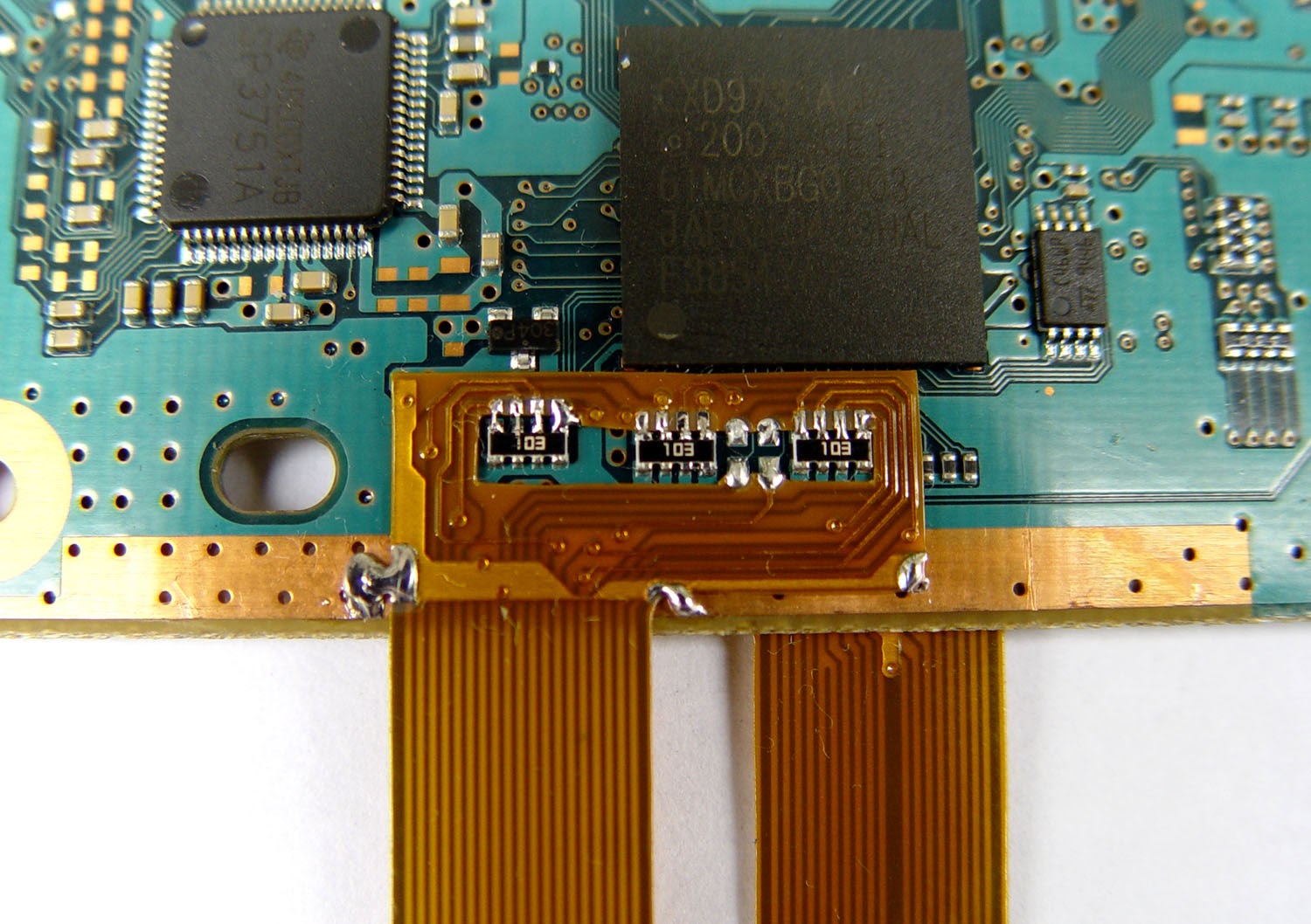

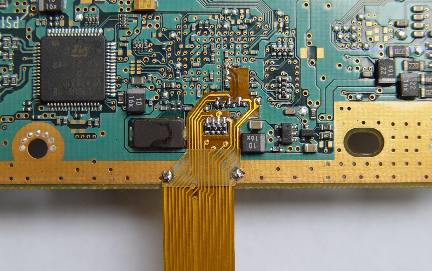

I wanted to start a project on a PS2 Portable using a 7000X Model as these models still contain the IDE connection points on the motherboard. People had premade cables to solder to these points to recreate the IDE connecter and then connected a Sata connector for modern drives. I was wondering if anyone has ever attempted this before. you can reference the attached images for the IDE connection points. I figured a small SSD would fit as I can get these in very small form factor. the sata adapter requires a 12v source to power the ide to sata adapter. If this can be done in a portable on these models it would resolve the speed issues that the USB has and would have a possible internal removable HDD that could be used.

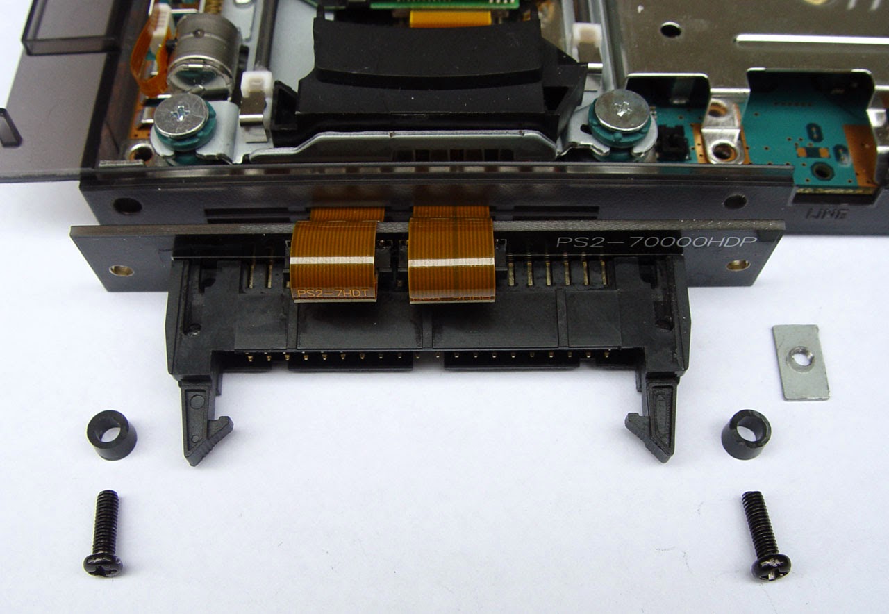

I can confirm that it is indeed possible to use a SATA SSD through a bridge IC to load games through OPL, I was however never able to make this work consistently. All the games appeared in the loader, but they almost always failed to load properly.

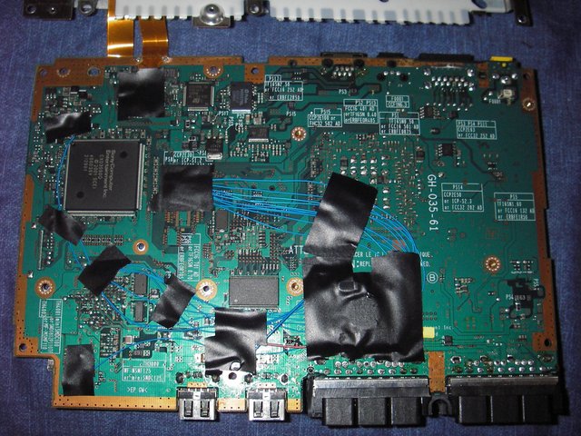

I haven't put any work into it for some time now as I'm pursuing more software based solutions to game loading, but I did try both the pre-made flex PCBs you've shown above, and a more DIY wire-by-wire method, which is the one that actually ended up working the best for me overall, it just wasn't very tidy looking.
Anyway if you want to pursue this route then I would be happy to offer any insights I might have, just know that the soldering skills required are a little on the advanced side. I also have at least one unopened pack of the pre-made flex PCBs if you're interested
