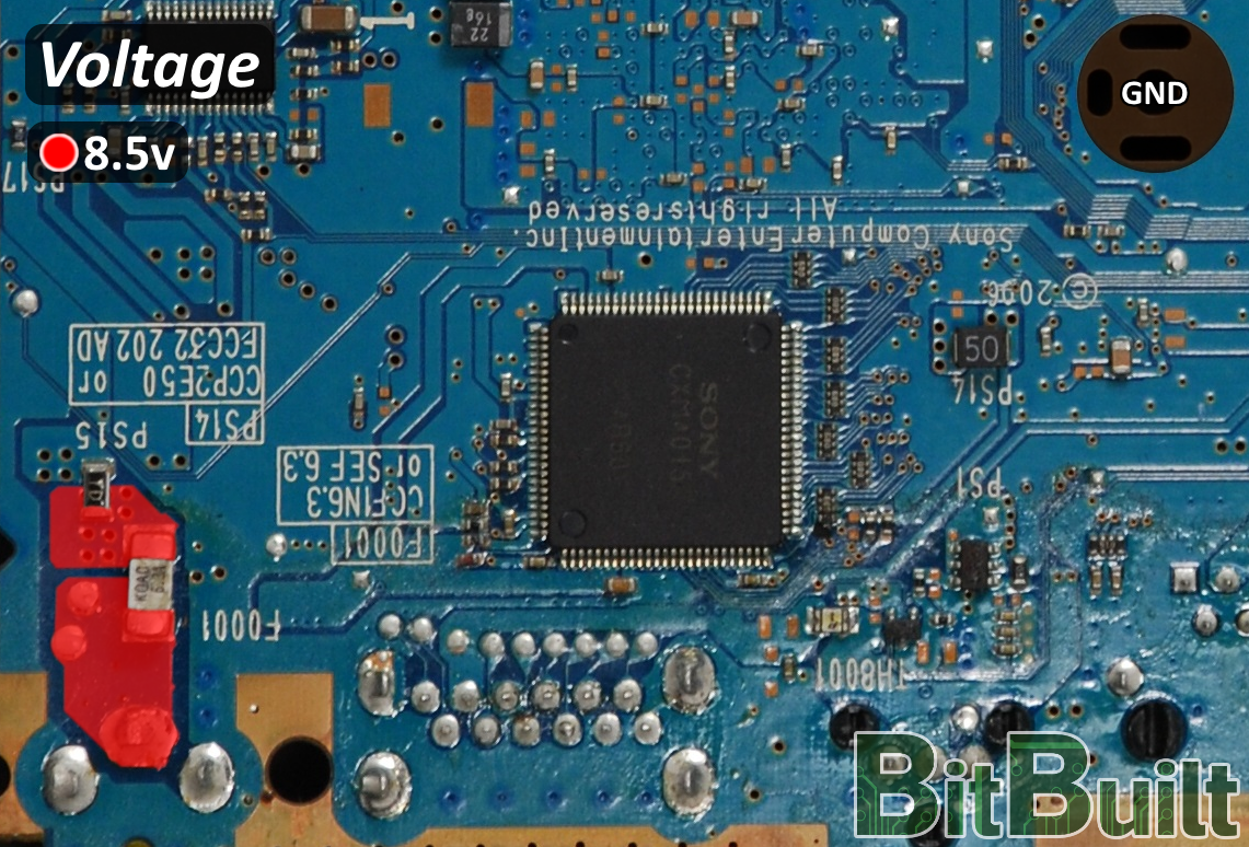

The batteries are brand new and i believe i soldered the positive and negative wires to the correct spot, (the 8v red areas in the guide), but it refuses to turn on. The PS2 isn't dead, because it turns on when plugged in. Sorry I'm a complete noob, kinda, sorta. I gave up on trying to portablize my ps2, and decided to come back to it. Any halp?

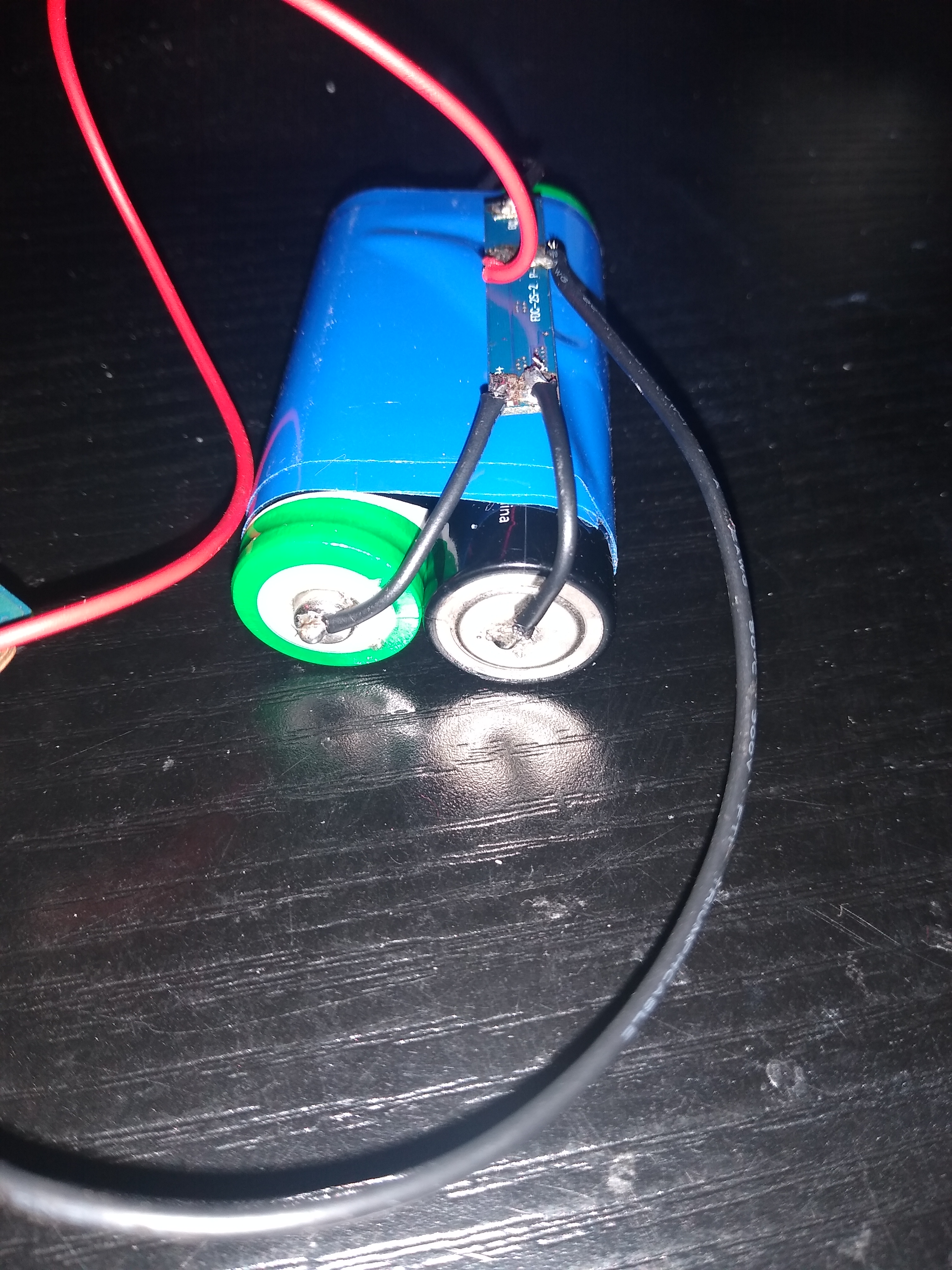

I used the standard trim so I'm not using the ps2 pms, just a 2S BMS for 18650s. Sadly my multimeter broke, so i have no way of testing, until i get a new one

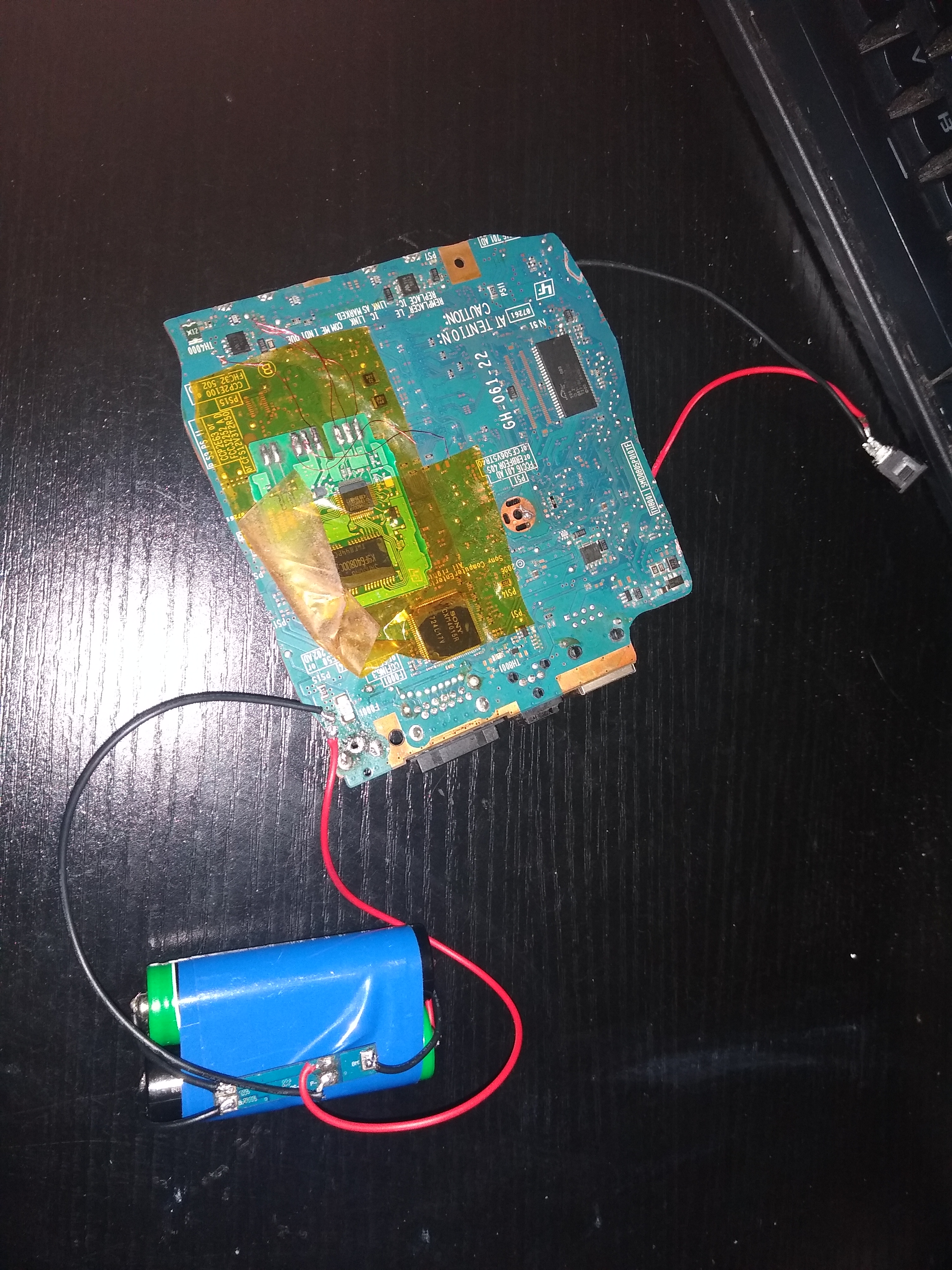

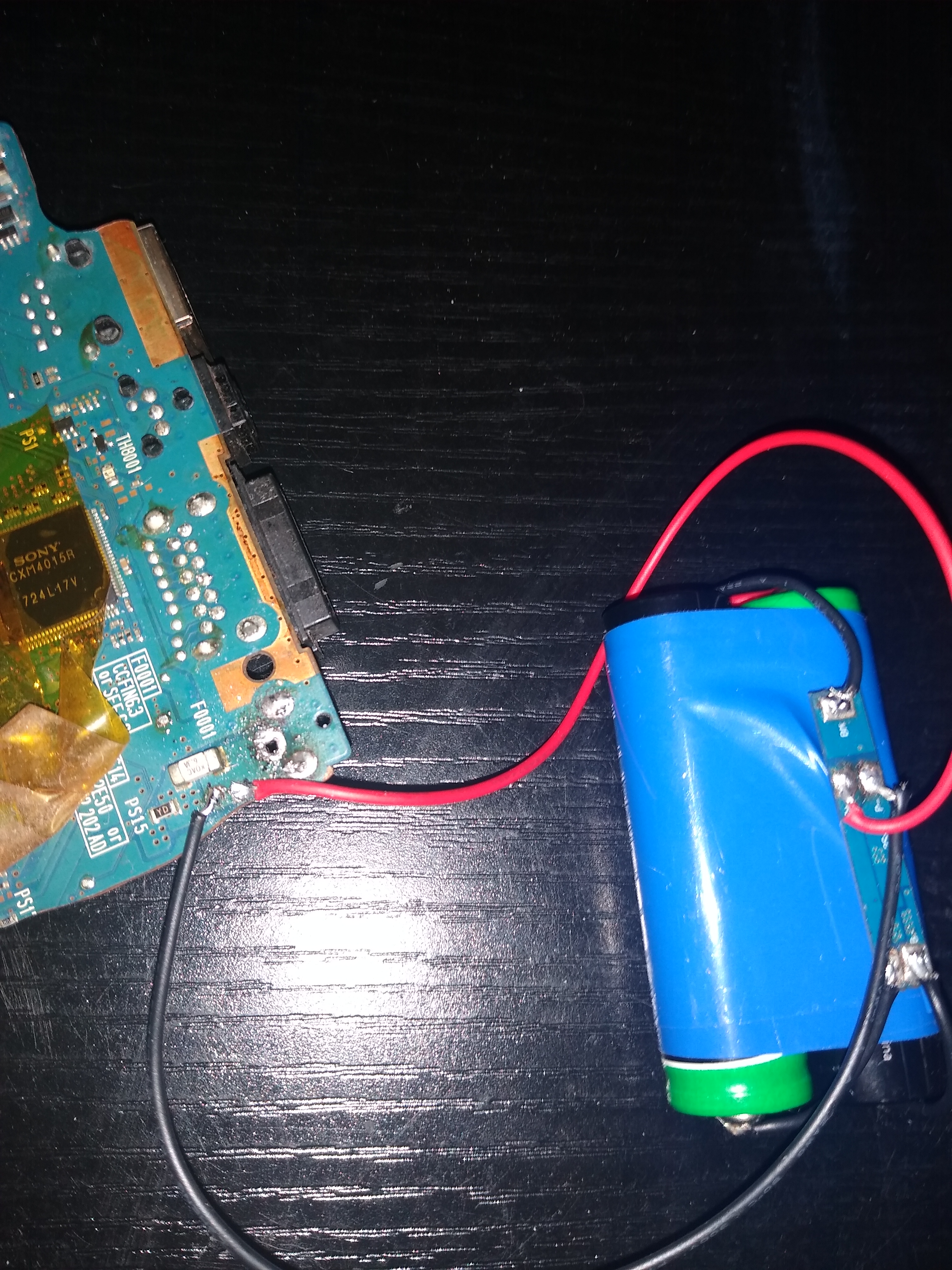

I'm pretty sure you have just wired ground and power to the same place which is not a good idea, the black wire should be going to ground.
Any of those bare copper areas can be used as ground or check the trim guide for pads. The red wire is correct though.
Edit: That also looks like a rocker switch for the reset button, it's probably better to use a momentary switch when you actually build the portable and use the rocker switch to cut power from the batteries when the device isn't in use.

Yep that's exactly what he's done.
You've soldered the positive and negative wires to the 8.5v line, you need to move your ground wire to a ground location.

Sorry for my noobness, but I'm assuming the ground wire is the negative right? (BTW i have my wires color coded. Red equals positive, black = negative, if you already didn't know).
Yes, ground is the negative wire
Can't see the other side of the board but I see only one set of power wires, to me it looks like the 8.5v relocation the the linear reg is missing as well
