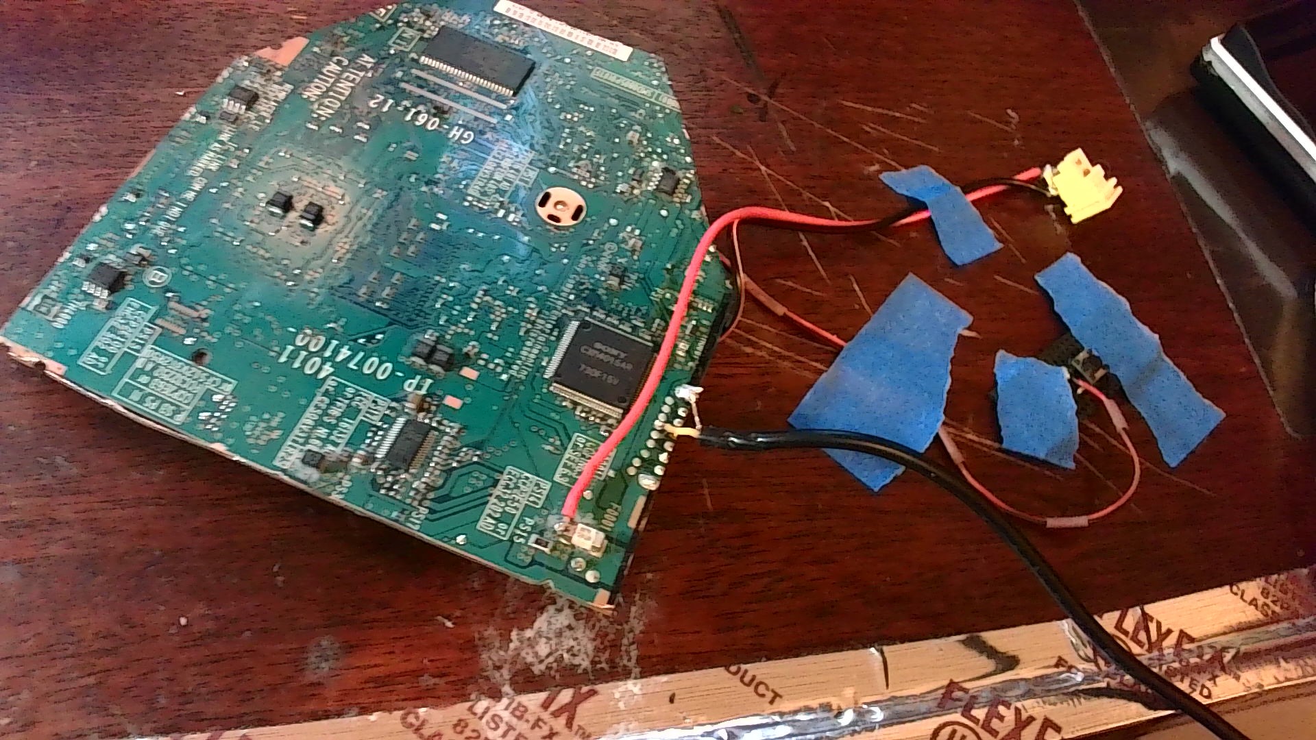

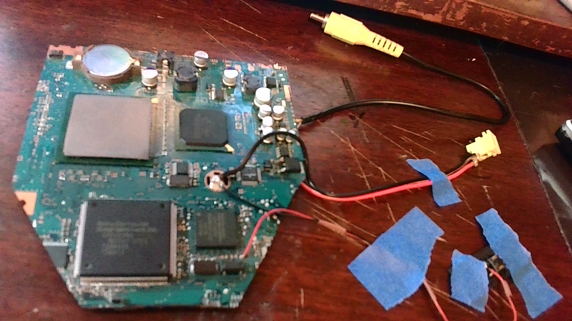

can't get ps2 to turn on after standard trim
Aug 17, 2021
40
6
i don't know what im doing wrong

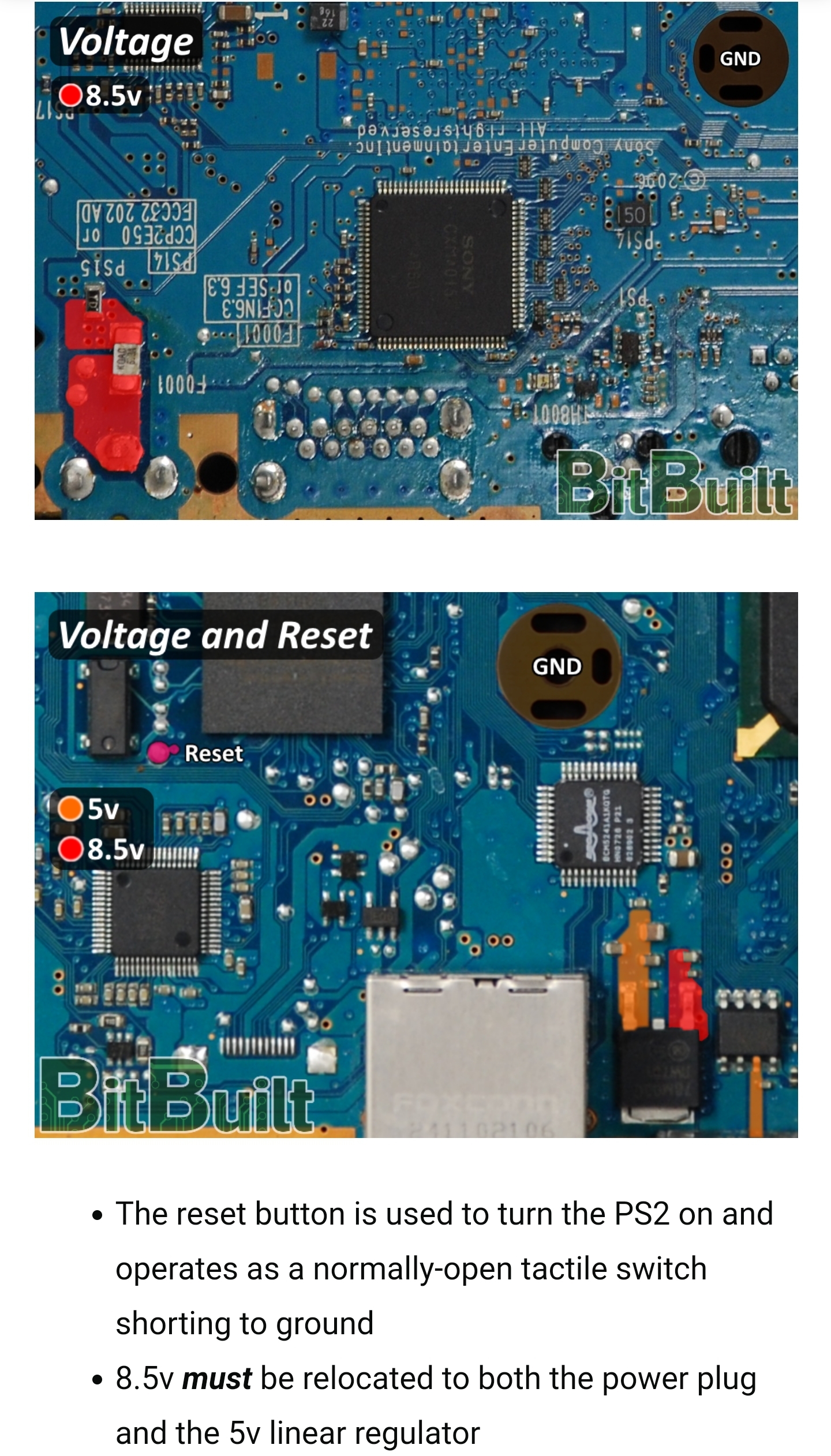

I would suggest reading over the guide carefully as you've missed a voltage relocation that the guide talks about. Also make sure all your edges are clean so there are no shorts, which means taking some sand paper to them.
**All components that are cut through need to be removed as well these will cause shorts and possibly kill the ps2
